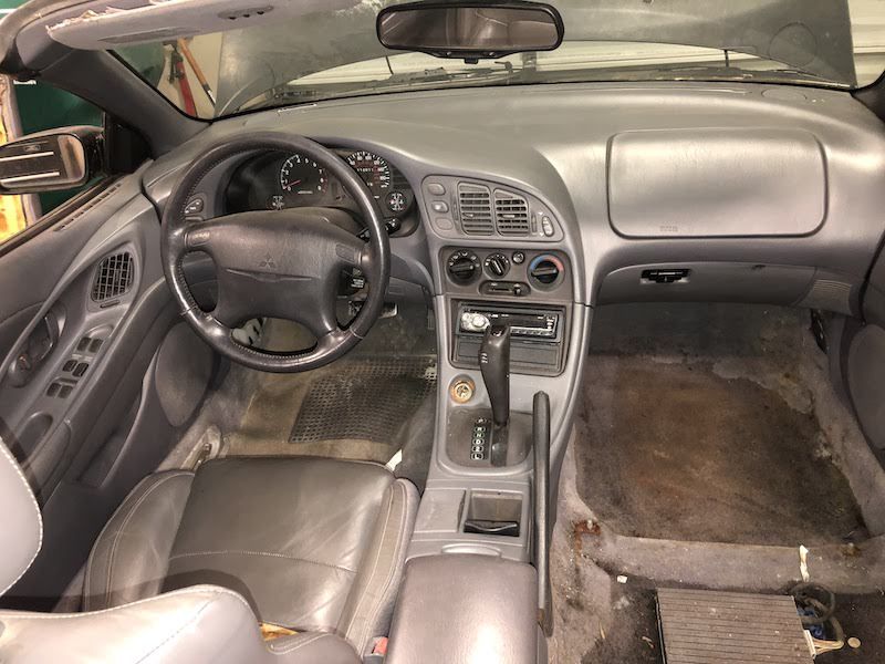

Interior is soaked from leaking top...literally standing water in the rear floor boards

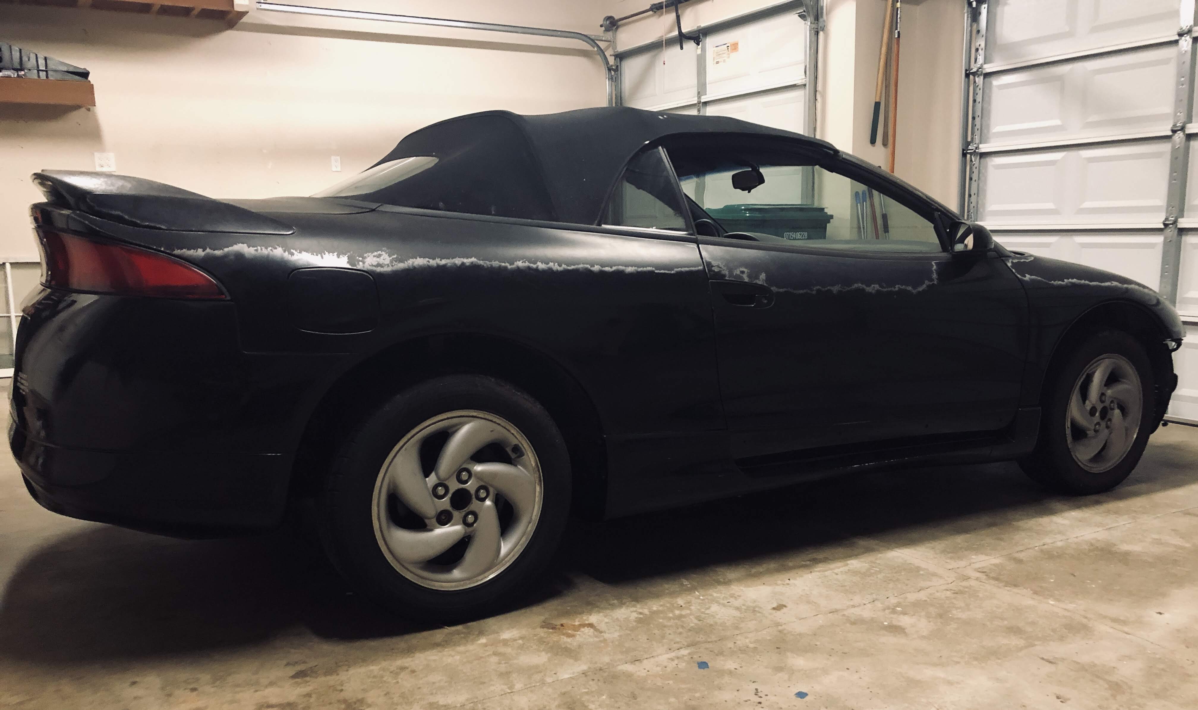

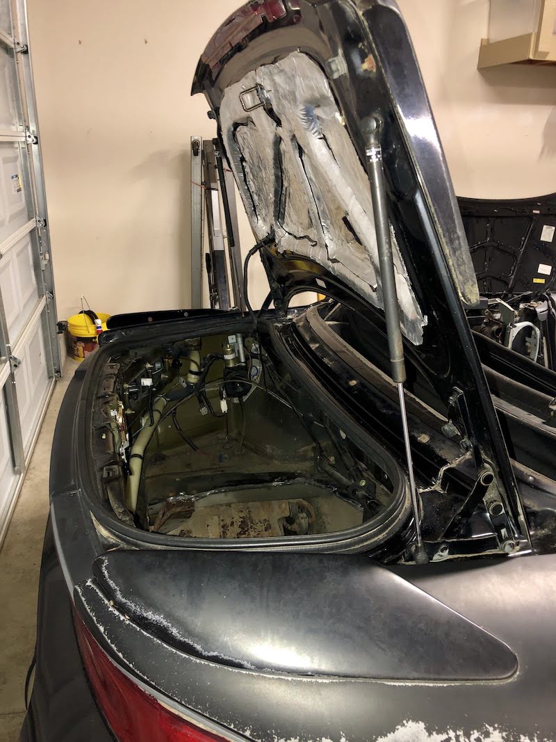

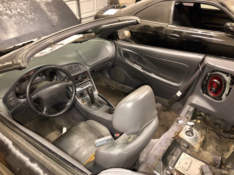

Got outside and gave it a quick bath and blew out all the little helicopter thingys that were EVERYWHERE. Its not perfect but I got most of the filth off, even though it still "looks" dirty because of the paint. I wanted to pull out a little bit of the interior so that it could start to dry out the standing water from the leaking top. I do have to say working on the interior of a Spyder is much much easier with having the ability to just remove the top. I need to take more pictures...again.

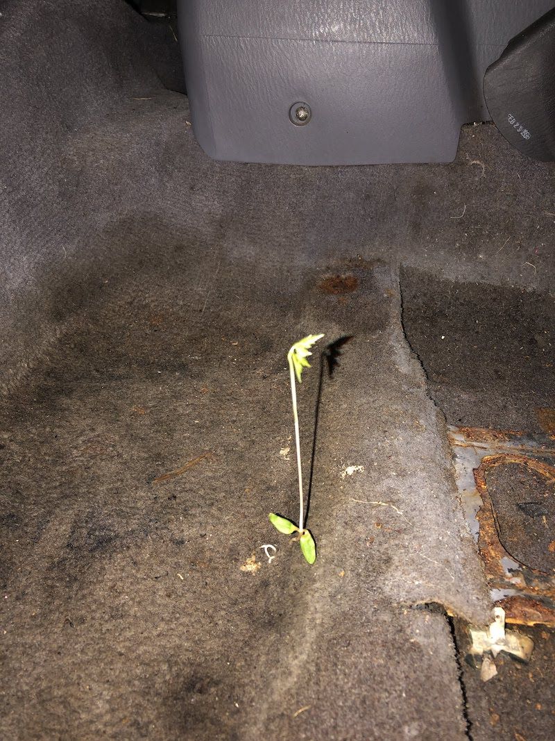

For some reason this picture is sideways but I just had to post it. Came out one night and found this little plant growing inside the car. Hard to tell from this picture but this is on the passenger side underneath where the seat would go. Going green I guess ;)

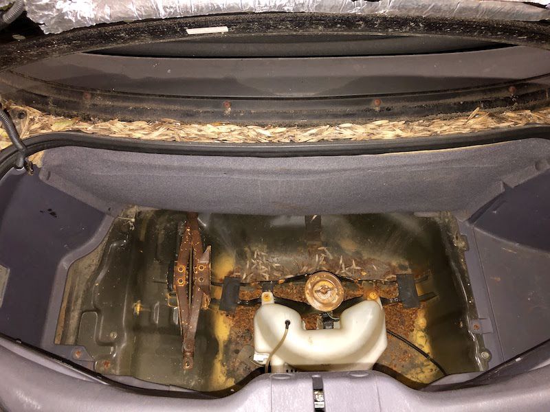

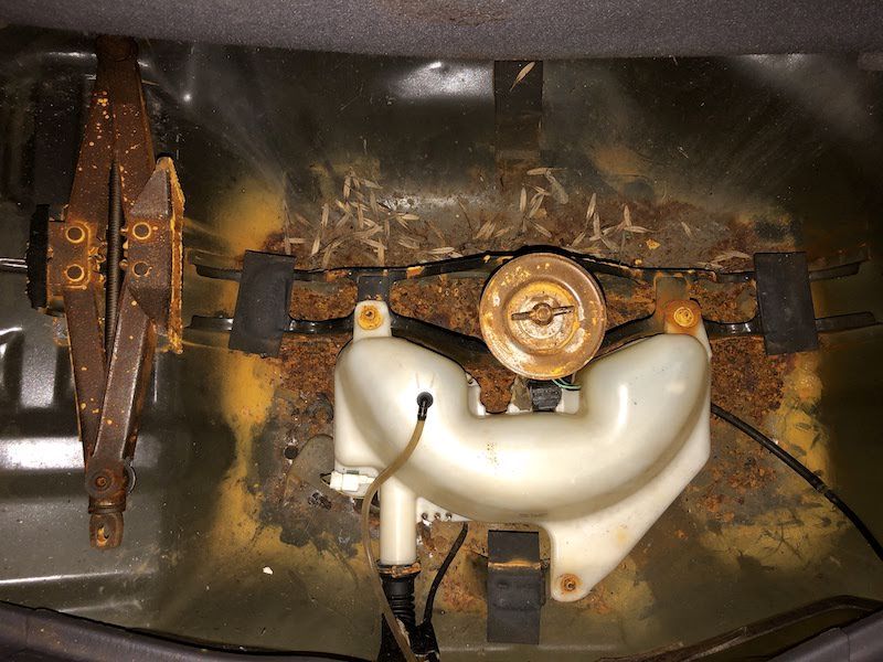

Trunk area dirty and rusty

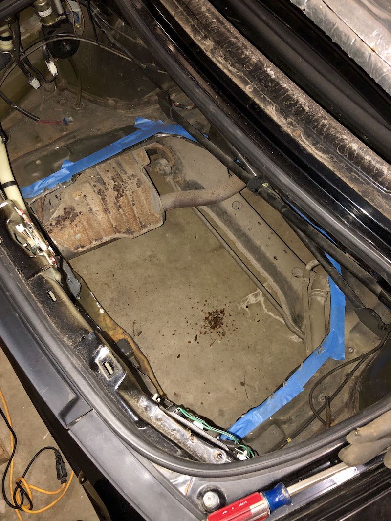

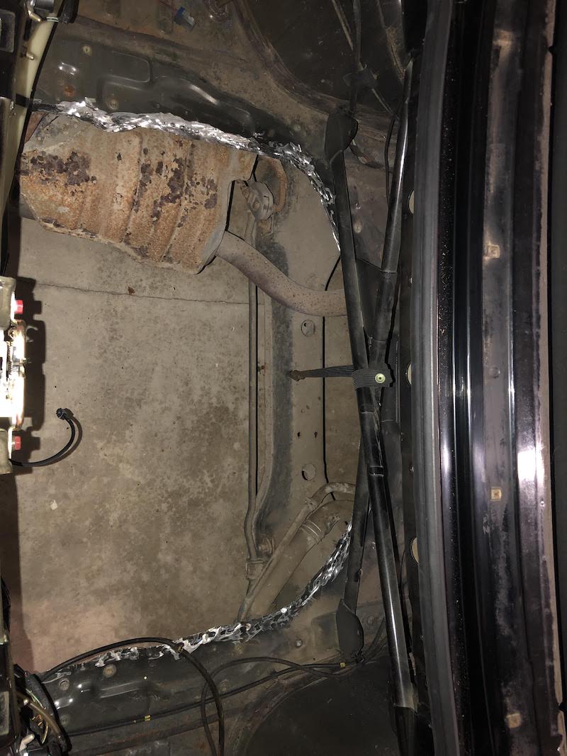

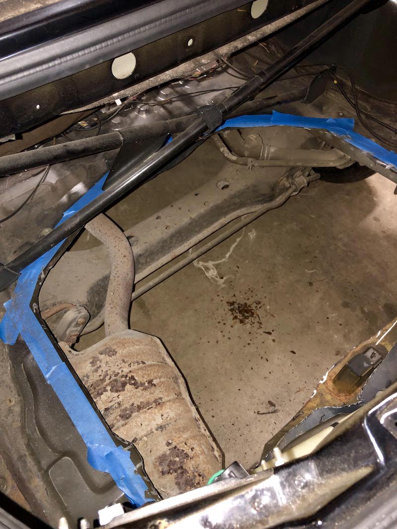

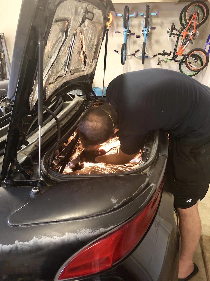

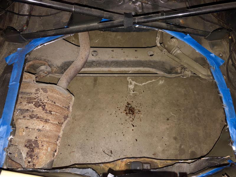

As you can see from the above images the trunk area had some rust. After pulling chunk after chunk off of the spare holder piece I decided I was going to just cut the whole thing out. I have always wanted to do work like this before but never really had a cheap car to do so. Here are a couple shots (don't mind my bald spot)
After trunk area was cleaned out
Doing some cutting
After
Started grinding down the edges to bare metal in preparation of welding in a panel. I still need to get in there and finish trimming things out, but just wanted the rust out for now.

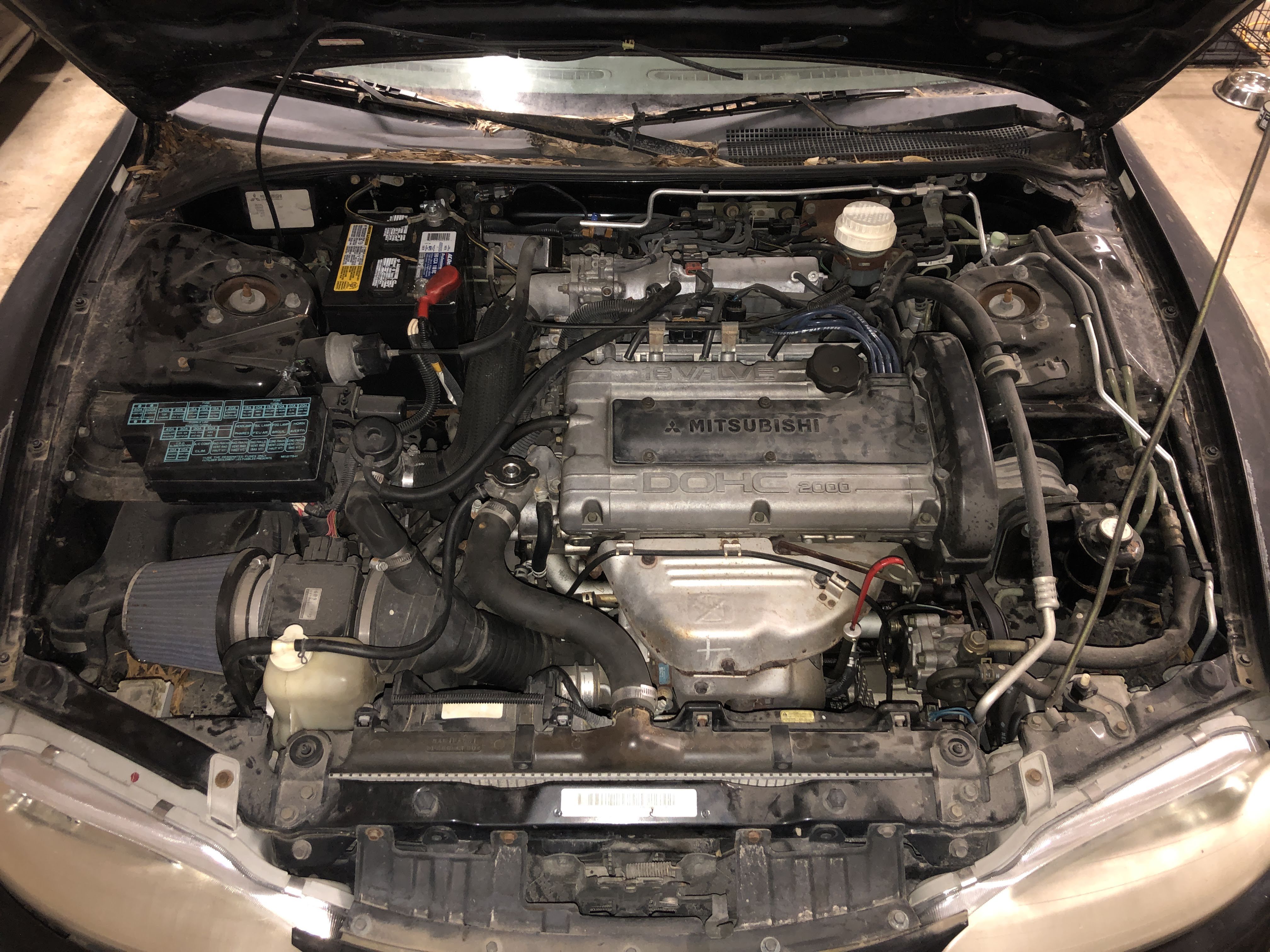

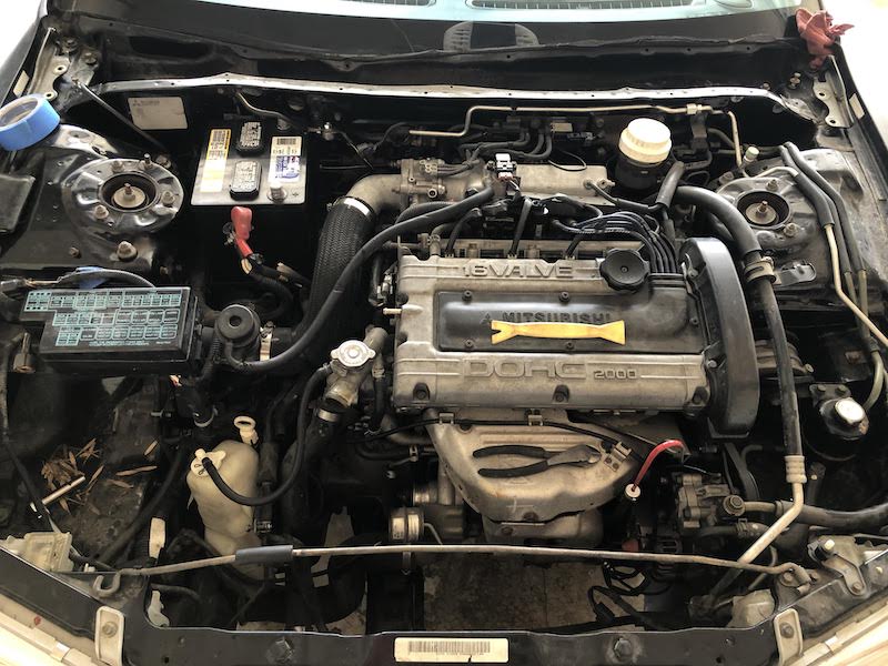

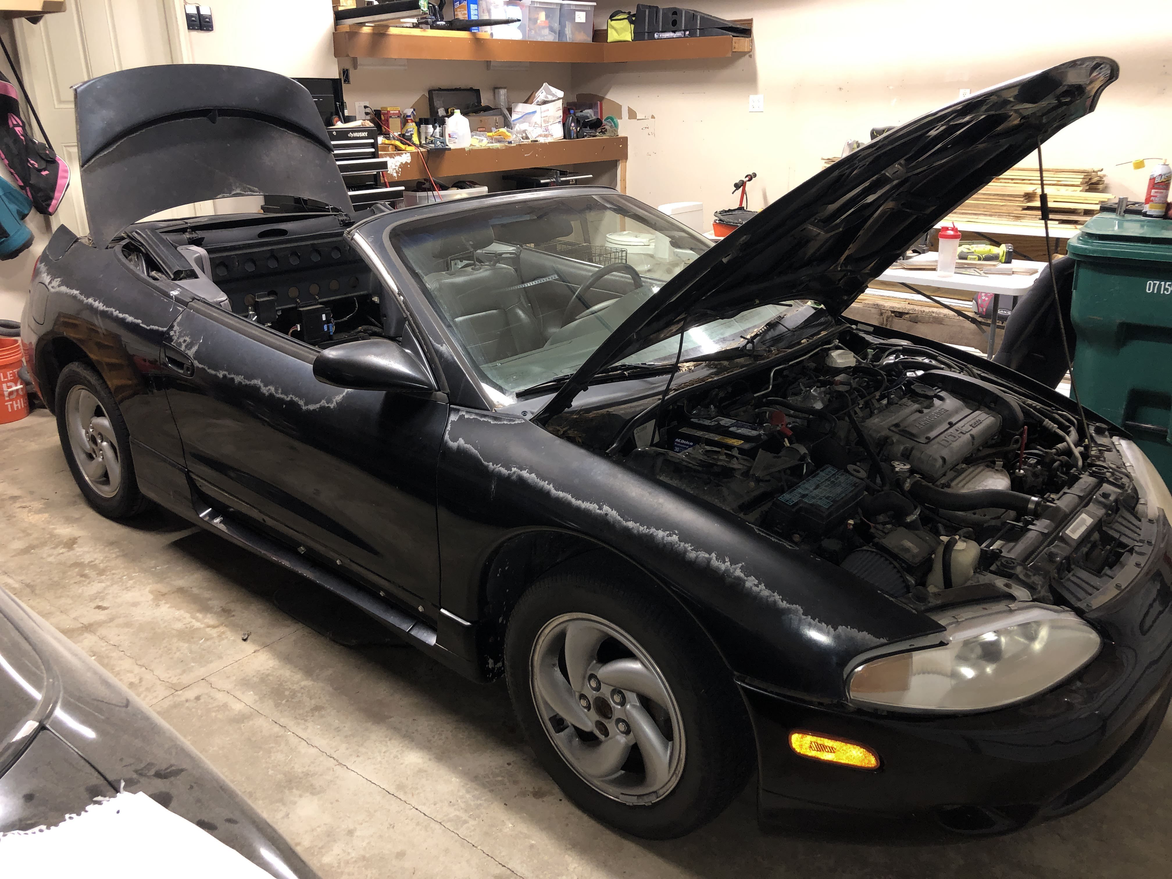

Finally is a shot of the engine bay. Few things to note is that the windshield wiper assembly was broken so I pulled it and have started cleaning that out. I went to a local pick n pull and got a good one so Ill be doing the final clean up, plasti dip the cowl, clean up and grease the new assembly and install after I potentially repaint the bay. You will also notice I have started pulling things out of the bay as Ill be pulling the engine in preparation of engine disassembly. More updates coming very soon.
