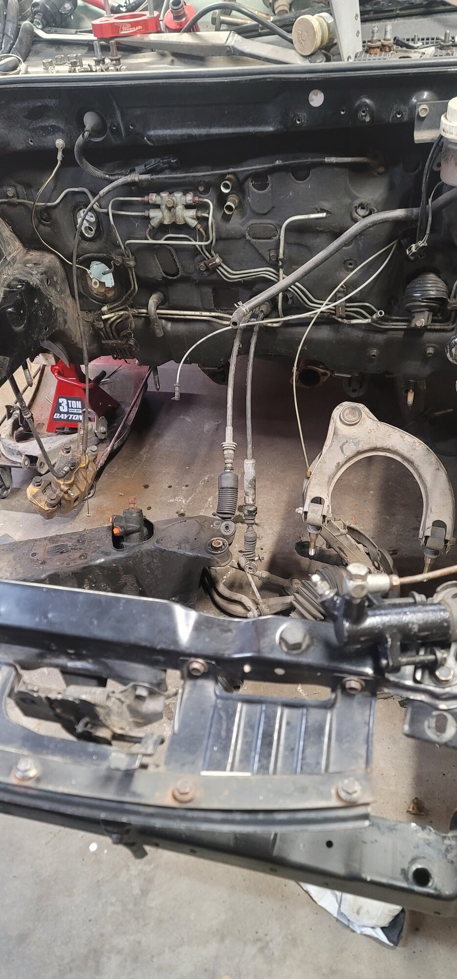

Tonight I got the front subframe ready to be dropped. I found out all 4 coils have been cut to get the right amount of drop so ill be replacing those. Everything seems like it's in good shape but it's all super dirty so I'm on the fence with either replacing it all or just cleaning it all up. Either way progress has been made within my stupid busy life.

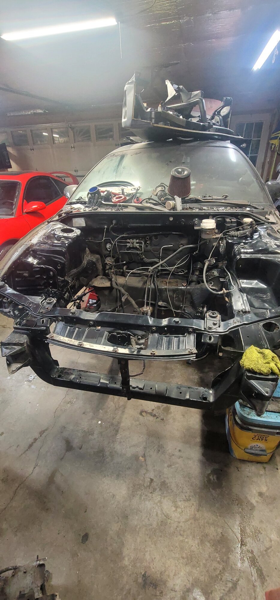

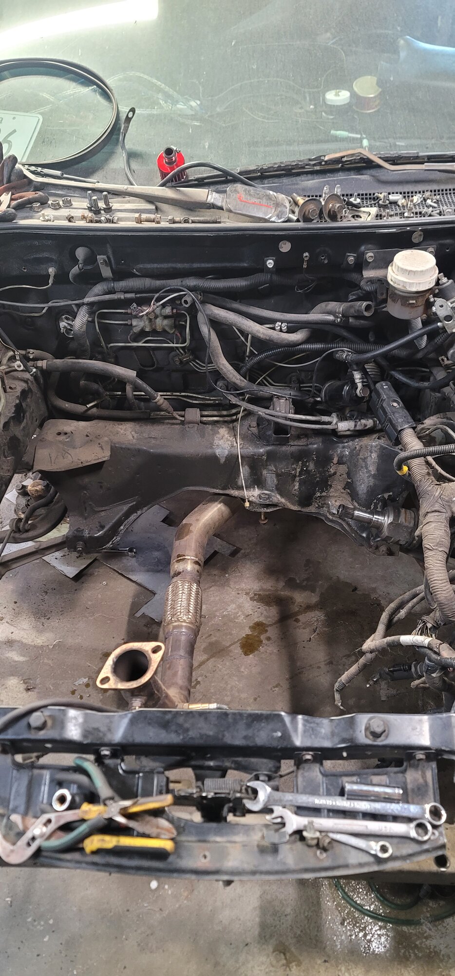

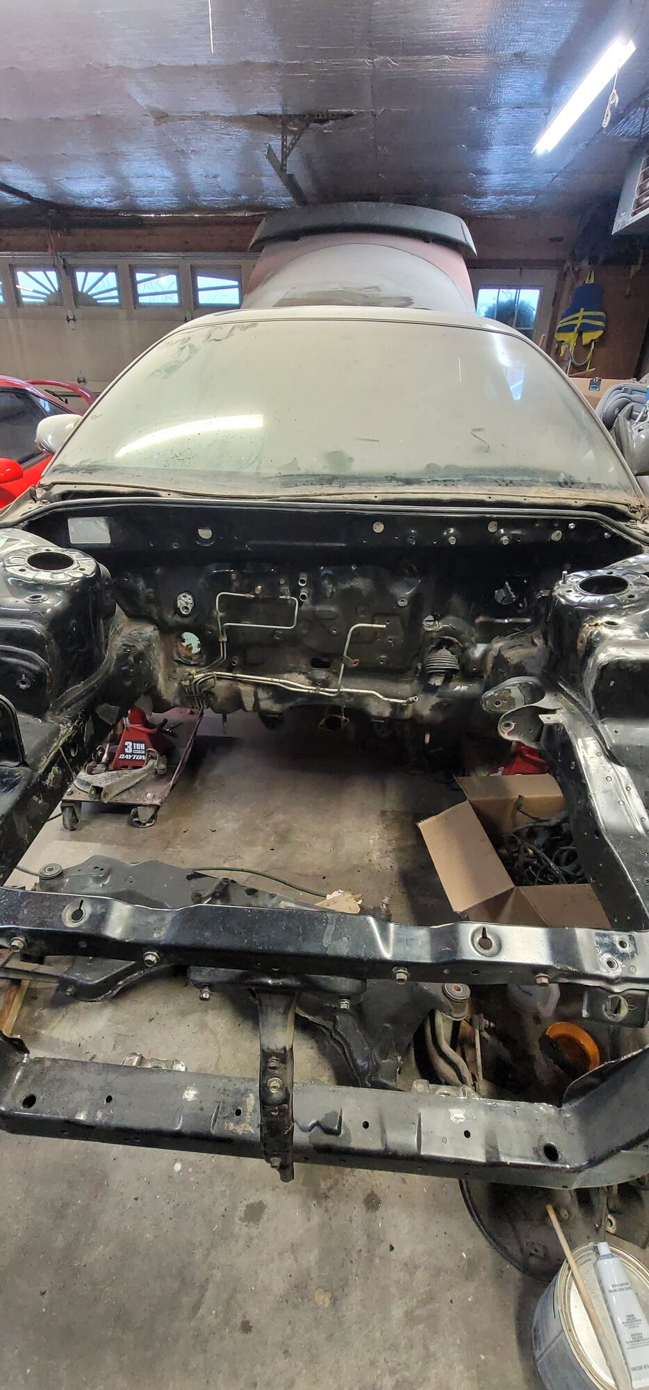

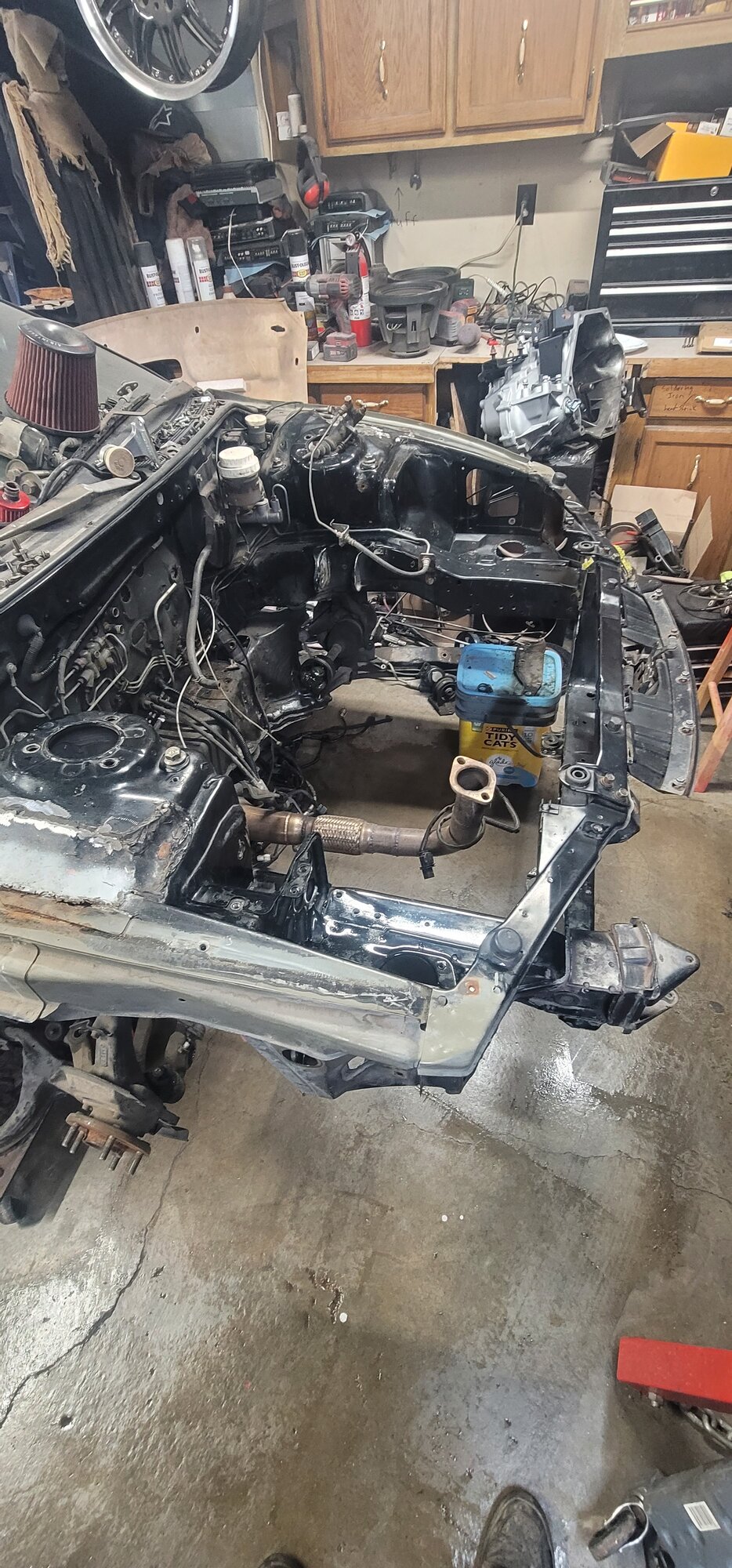

I finally had some time to pull the engine today. My next goal is subframes dropped so I can fully fix any and all rust. Then ill clean everything up and get things painted and or replaced. Right now I'm swapping the engine that was in my car into my buddies. I'll be using his stock never touched engine as the built replacement.

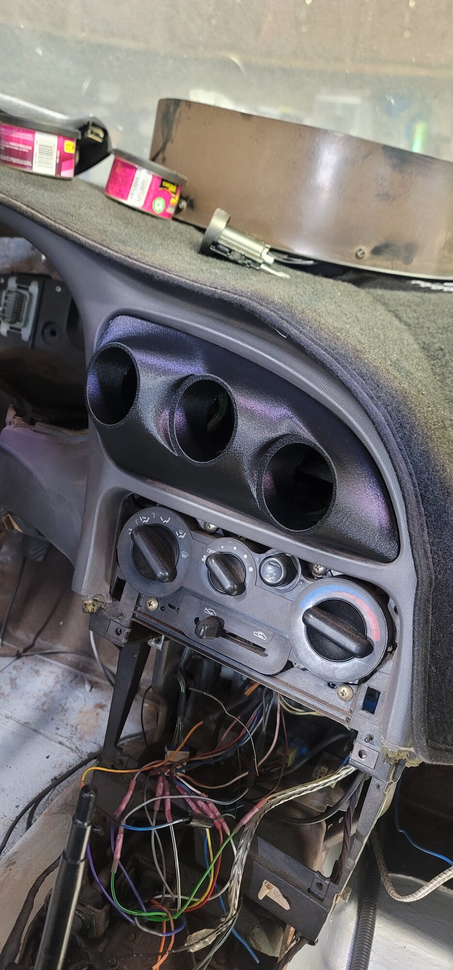

I'm finally starting to get some parts in. I decided to do the triple gauges in the vents instead of the 2 I was running by the stock gauges. It's a show car after all so it being a little flashy is sort of what I'm going for. I still have alot of rust to fix unfortunately but getting parts in for the build are definitely motivating me.

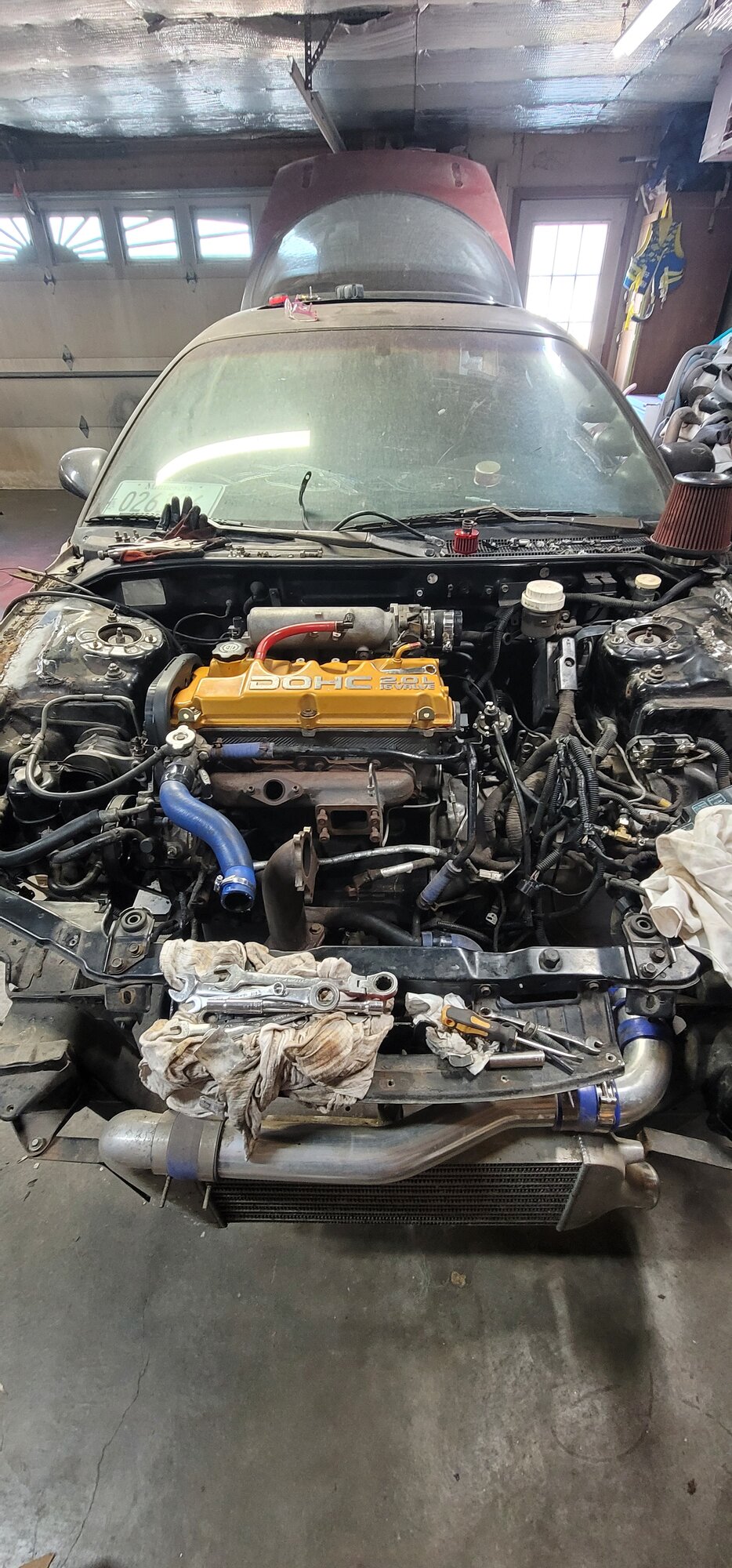

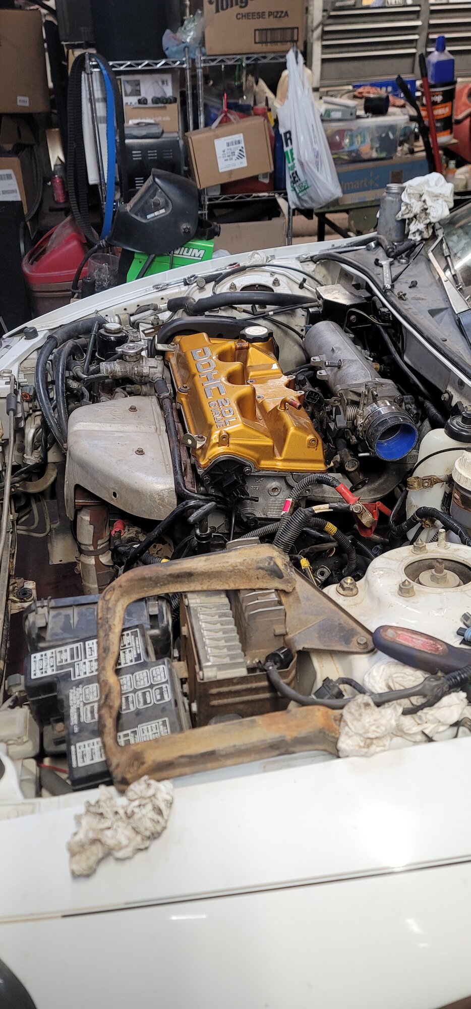

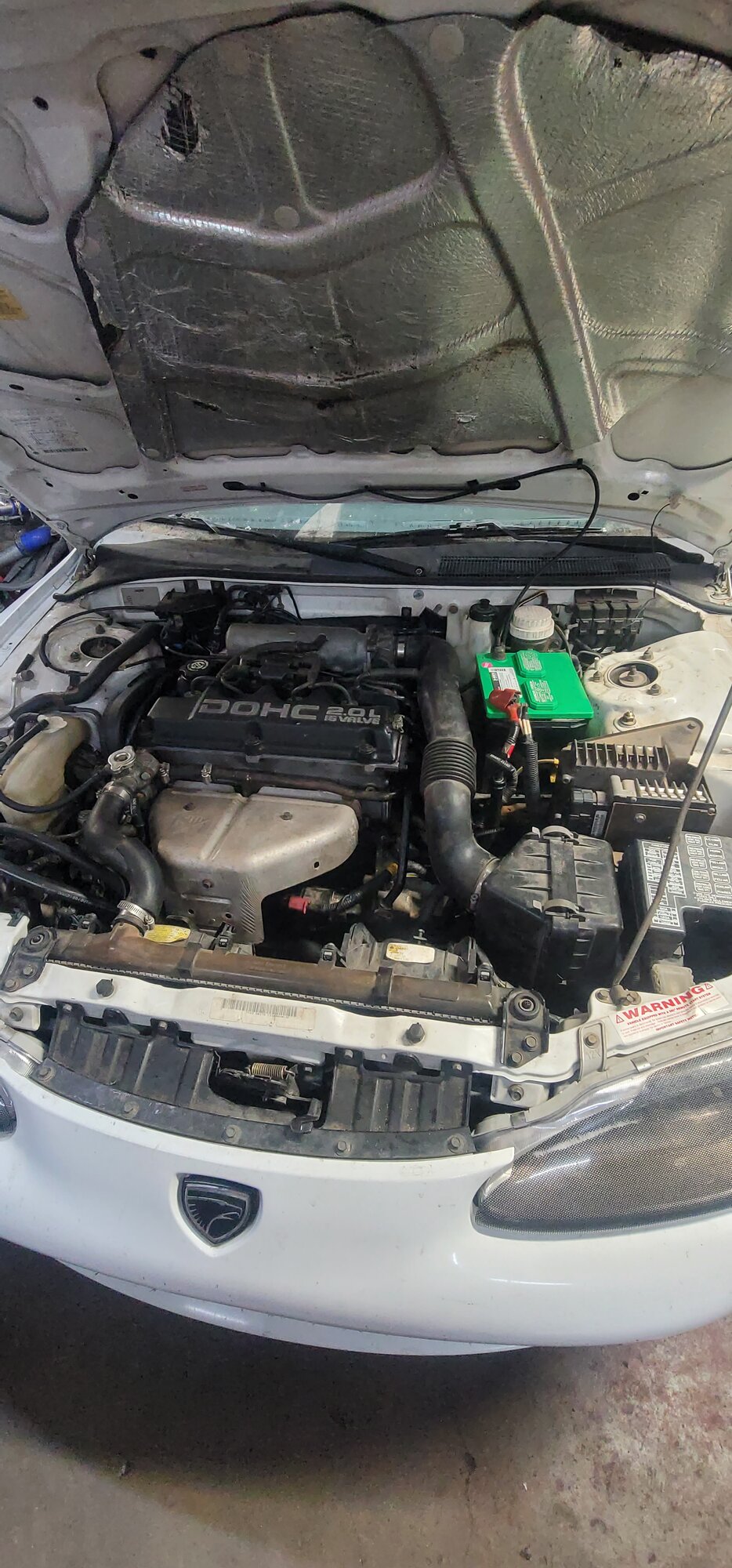

The second picture shows the engine that was in my car with the turbo now lives in my buddies wife's talon in a stock configuration. I ended up giving it to him for free since I don't know the history on it and I've sort of put it through the ringer. It runs great and now has zero leaks. It should have alot easier life moving forward. The swap actually went super smooth, I just pulled both engines with the transmissions attached.
I'm honestly just itching to drive my car again, I miss the manual. I also miss the 420a it's actually such a simple motor to work with and work on. Anyways now that I'm finally done swapping engines I can get back to working on my car. Not really much of an update. Just showing what I've been up too.

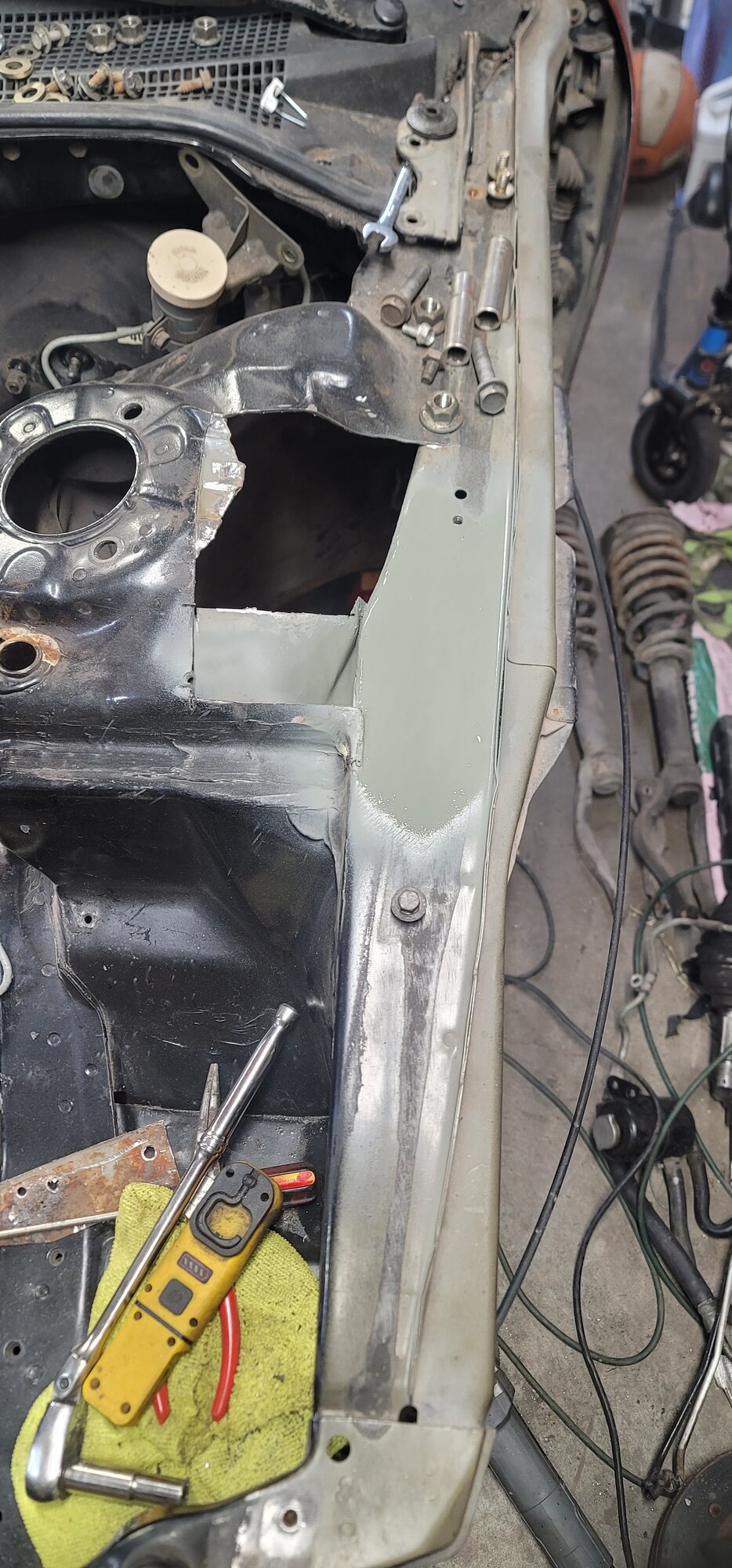

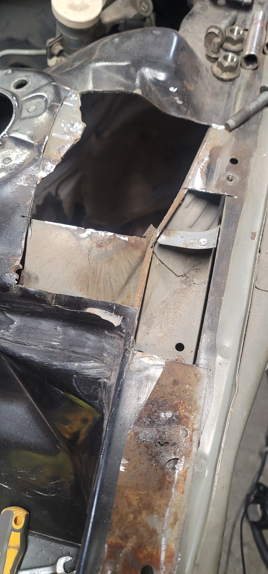

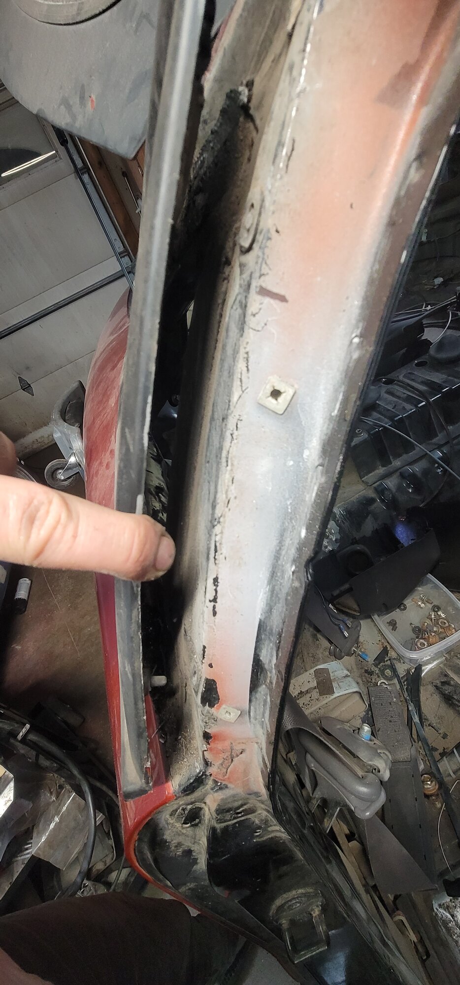

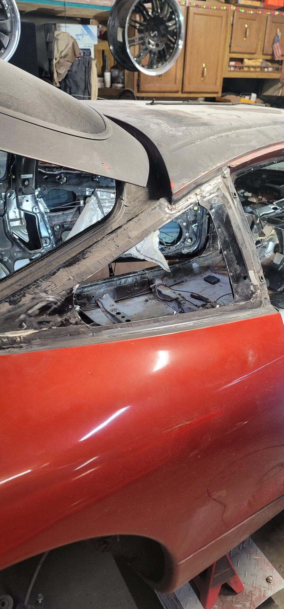

Alright so I'm back to wrenching on the rusty rs and man I feel like I made a ton of progress today. Im finally attempting to fix this roof from that dreaded homemade sunroof job. If I get it how I like ill be happy if it fails then im cutting the roof off my talon and thats that. As to how I'm fixing it I'm using panel bond and creating a lip down the same metal thickness and then ill panel bond the "plug" I cut out. I'm not sure how it'll look or what I'll run into but I'm giving it my best, and crossing my fingers. Of course I'll have to bondo the seam and any imperfections unfortunately.

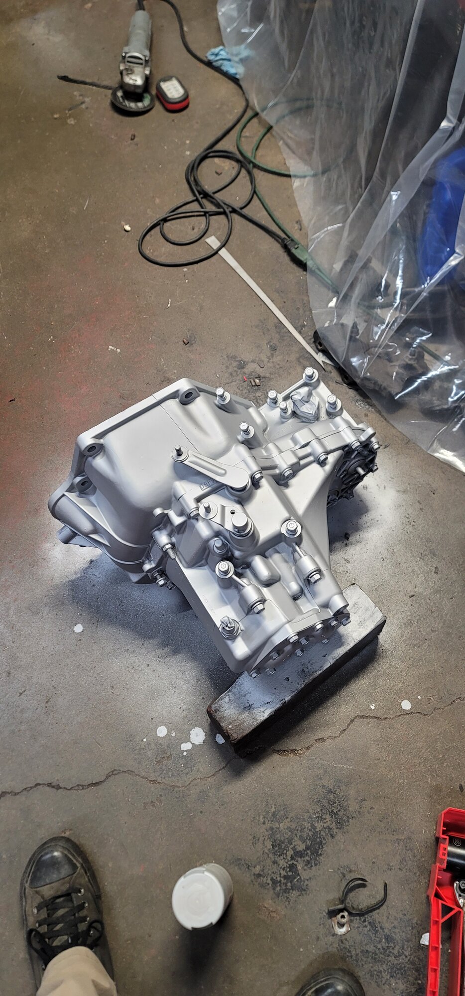

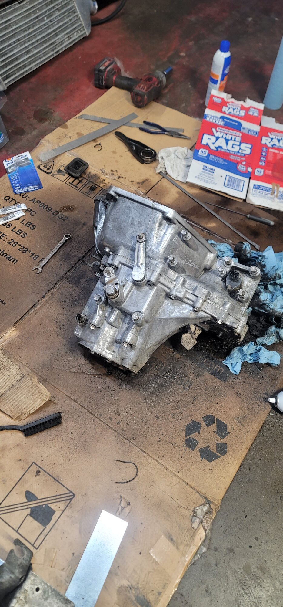

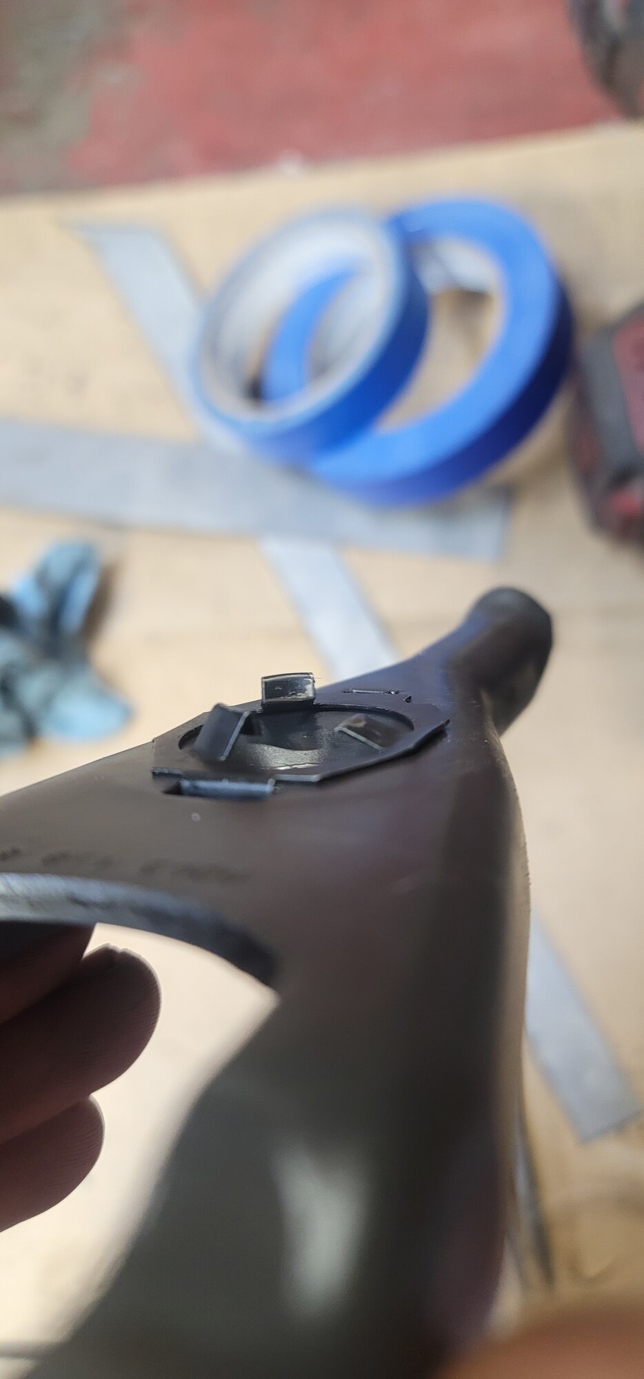

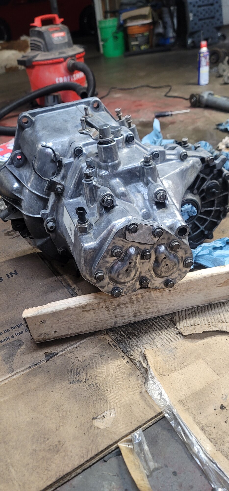

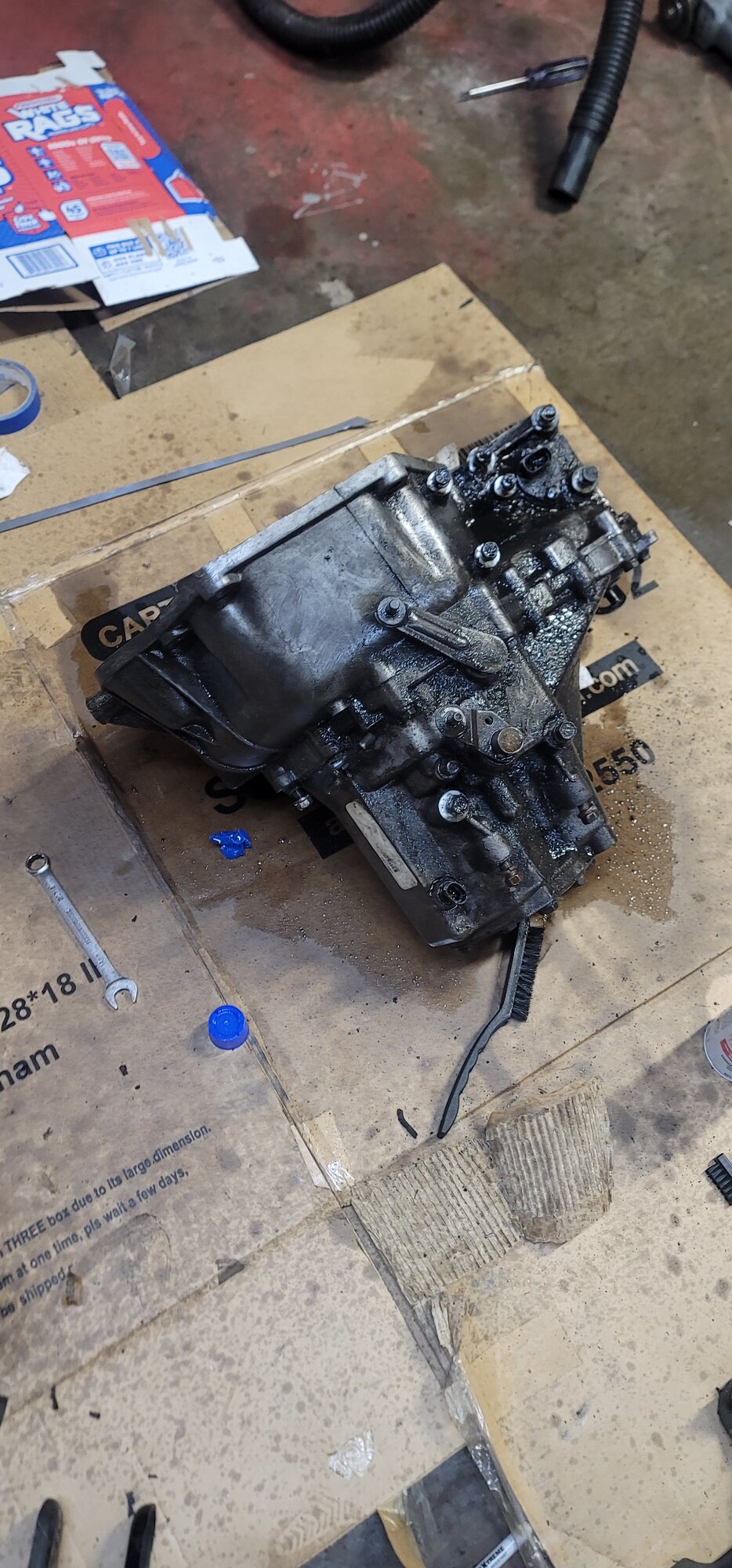

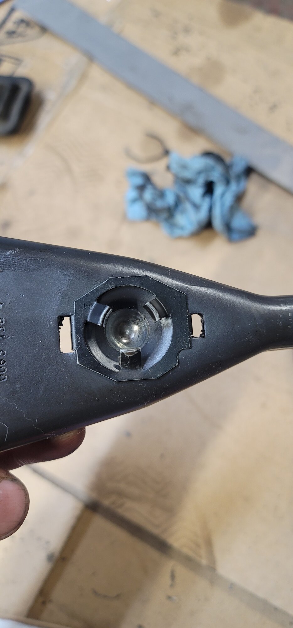

Next on the list was the absolutely gummed up trans that's been staring at me for a few weeks. I scrubbed most of it but there's still plenty more to scrape off. I did notice on the fork 1 out of the 3 hooks that attach to the ball is either broken or is it normal to be shorter? I'm guessing it's broken and ill have to find a new one. Either way I'm super pumped to be getting this much done in an evening. The transmission will be getting painted but I'd like to make sure it's pretty spotless first.

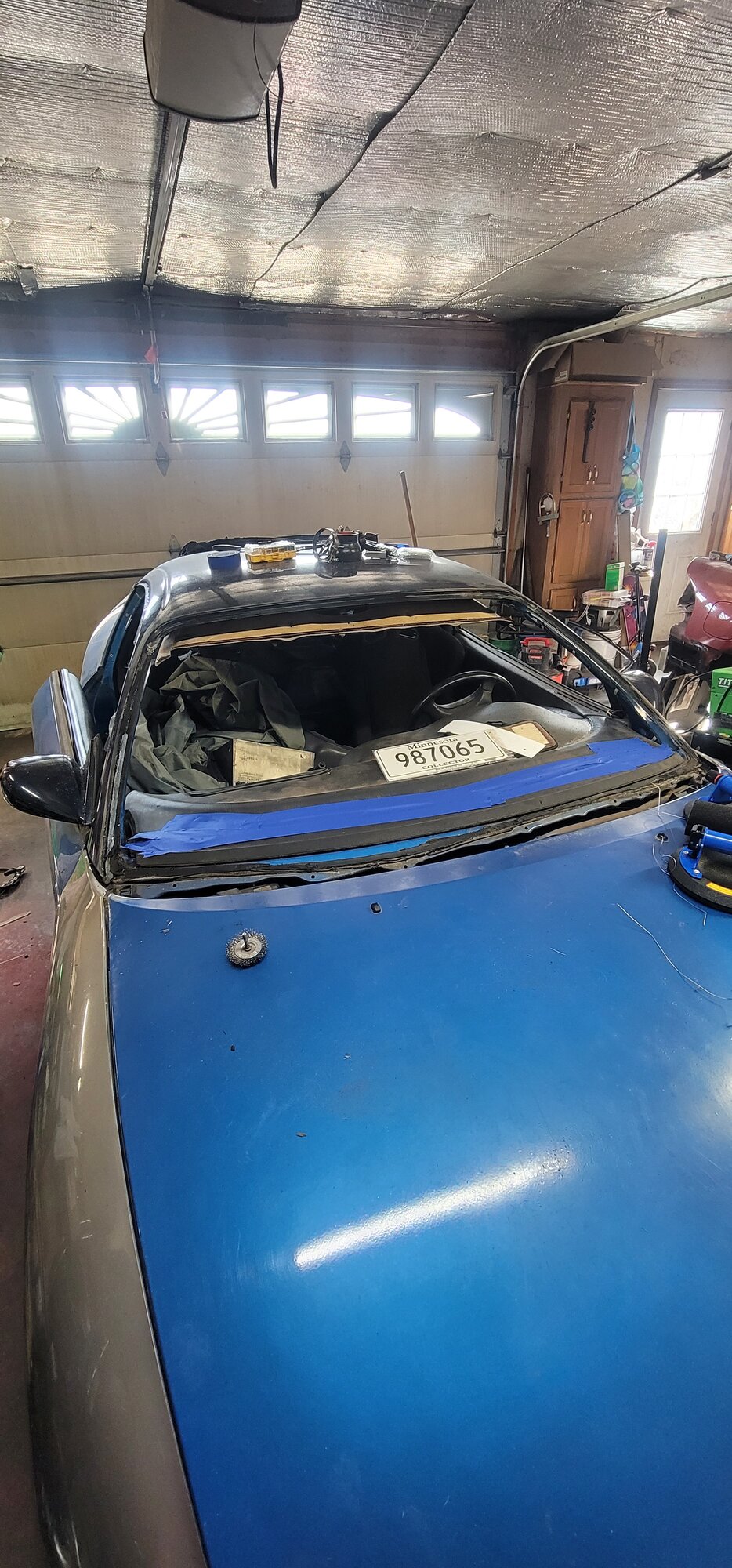

Today I got the windshield out of the talon in preparation for the roof removal that's soon to come. I've decided to use this car as the doner only because it does have some rust in areas and I'm just not real happy with the front end swap I did. There's alot I wish I would have done differently but that's okay because it'll be donated for a good cause. I'm just waiting on a special tool to remove the rear windows. The dash will also move over the the rs. I didn't know how mint it was so I'm super happy about that.
I was able to start painting the transmission. I'm also starting to strip the talon so I can cut out anything I need for the rs. It's going to be alot of work but the rs has alot of history and meaningful value to me so that's why I'm doing this.

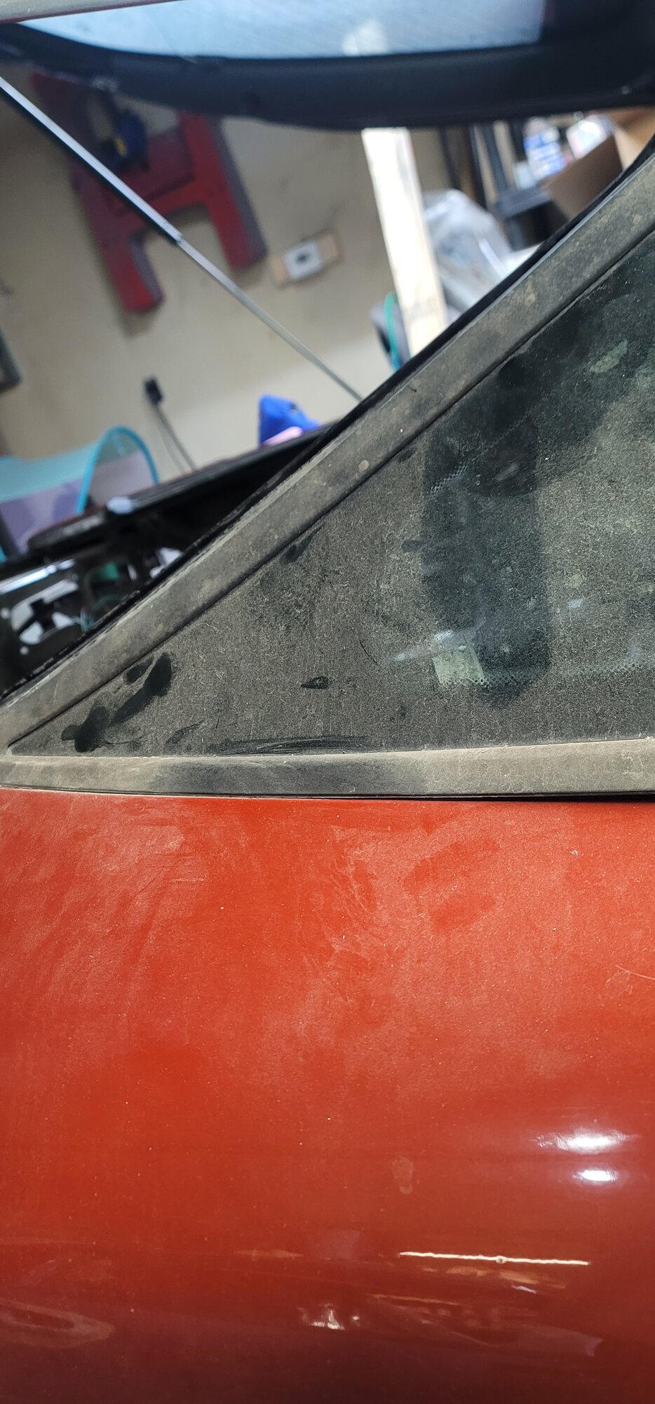

So aside from cleaning up parts and sanding and painting brackets, I've still been picking away at these windows. I honestly have zero clue how you body guys or glass guys get these out. I've bought special tools to get these out and dang it's been wrecking me. Anyways I'll get them eventually when I get a chance.

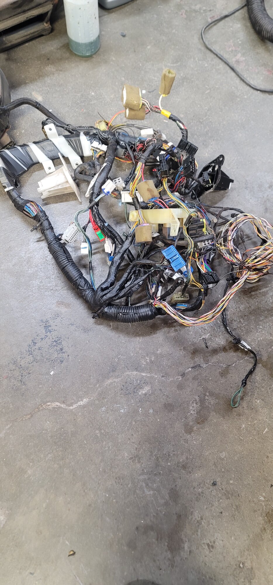

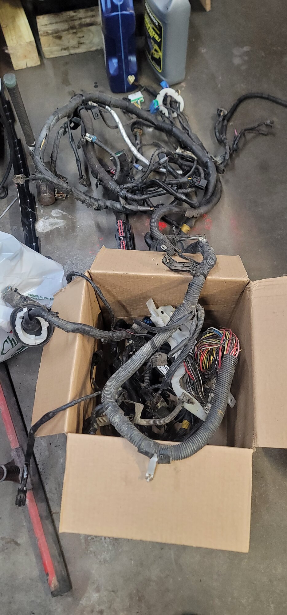

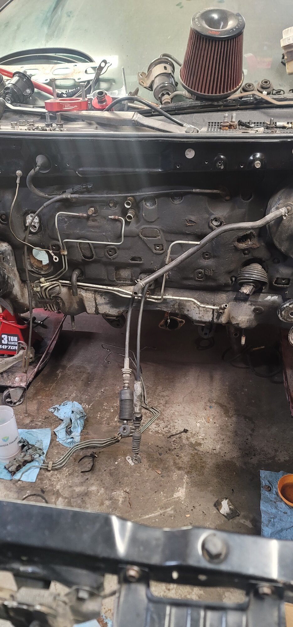

I'm working my way from front to back now since it's winter. I ordered a used harness off ebay and since I'm going to be re painting the engine bay, I decided to remove a bunch of stuff like the harnesses. I'll be sanding and fixing rust in preparation for the repaint. After that I have everything I need to rebuild my 420a that's been sitting in the corner. I will be scrubbing every part that I can along the way. If everything goes how I want it to by spring, I'll have the doner car back in my garage so I can continue the roof skin swap. I'm trying to keep things organized.

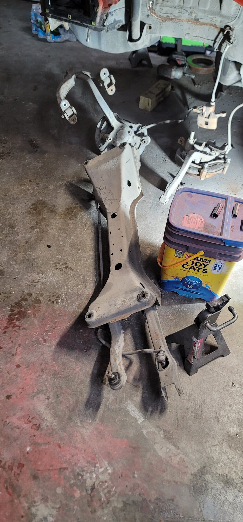

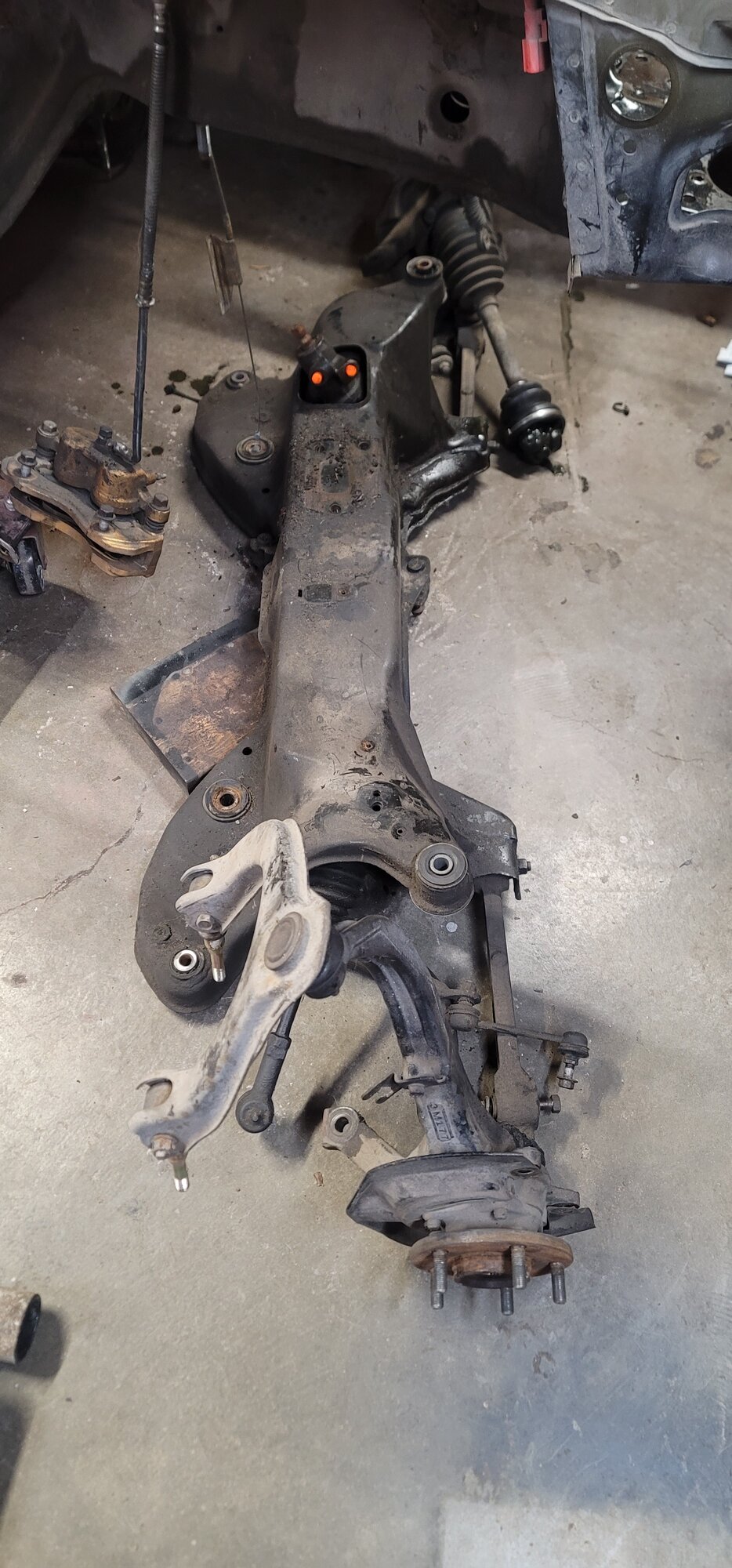

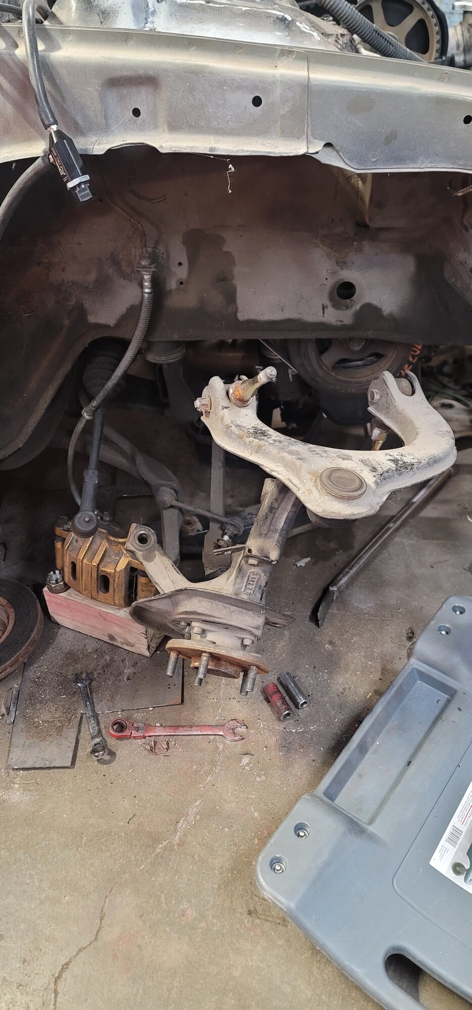

I'm making some really slow progress but it's progress. I got the front subframe dropped and boy did it fight me. I don't think it's ever been dropped and there's about 230k on the odometer. Everything is going to be getting a deep clean and paint.

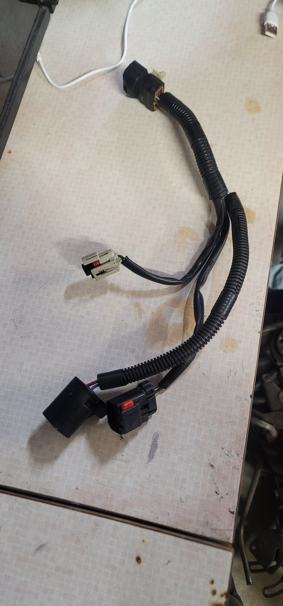

The other wire harness I ordered came in today. I'm going to slowly clean and restore all of it. I also ordered those zip ties with the clip so everything snaps in like factory again.

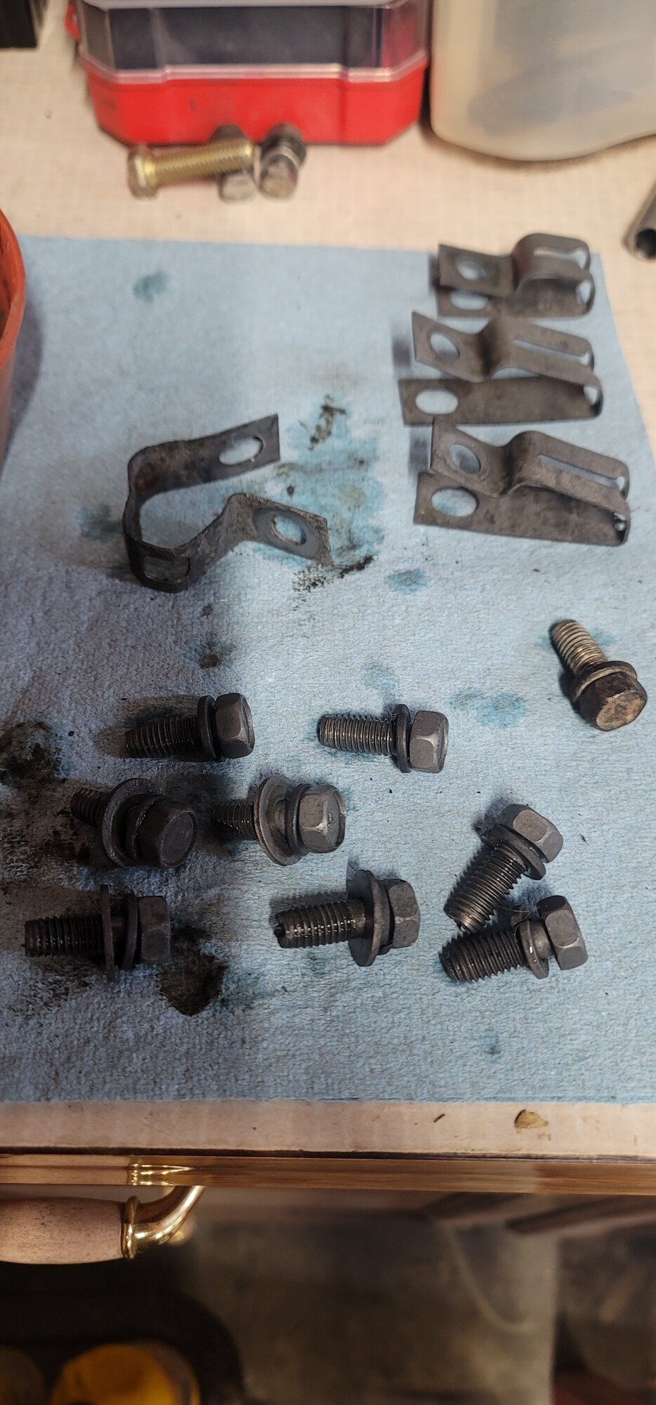

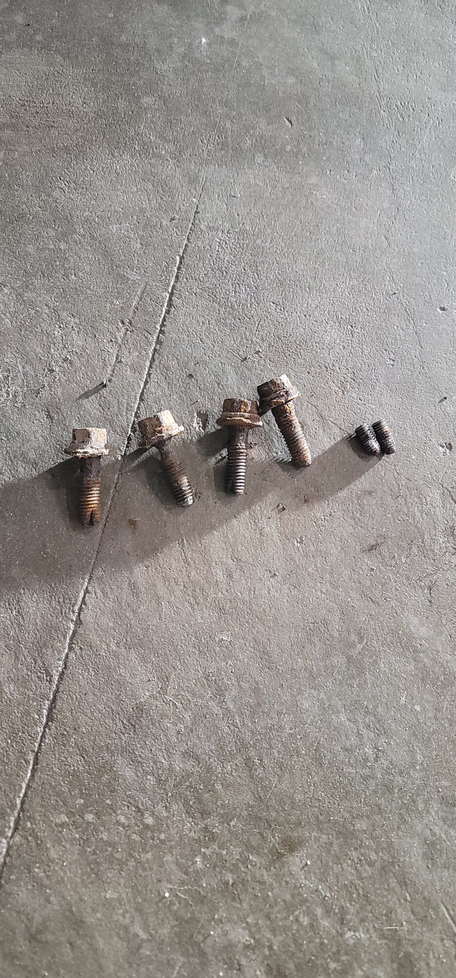

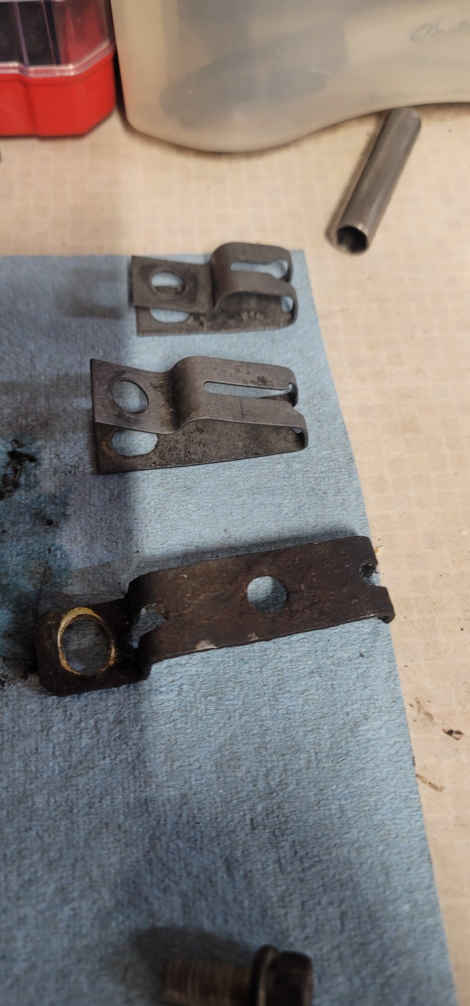

With all that out of the way I did drop some very rusty bolts and brackets into some rust desolver over night. They actually looked like I pulled them out of the titanic before they were cleaned up. I will say they did clean up really nice, aside from some pitting that is out of my control. I also cleaned up the subframe a little but under some of the spunk, there's rust, so ill have to figure out what kind of paint I should use that will hold up.

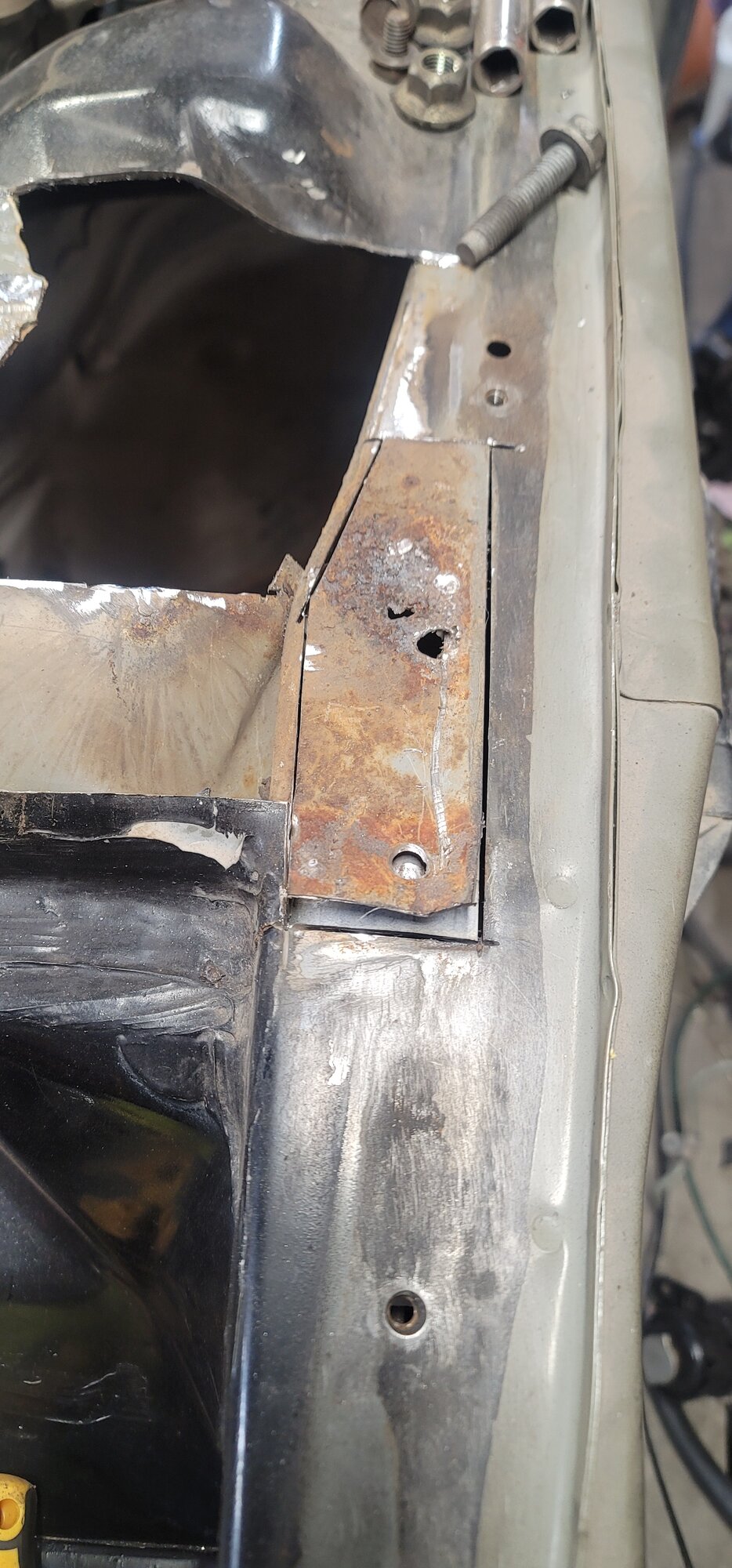

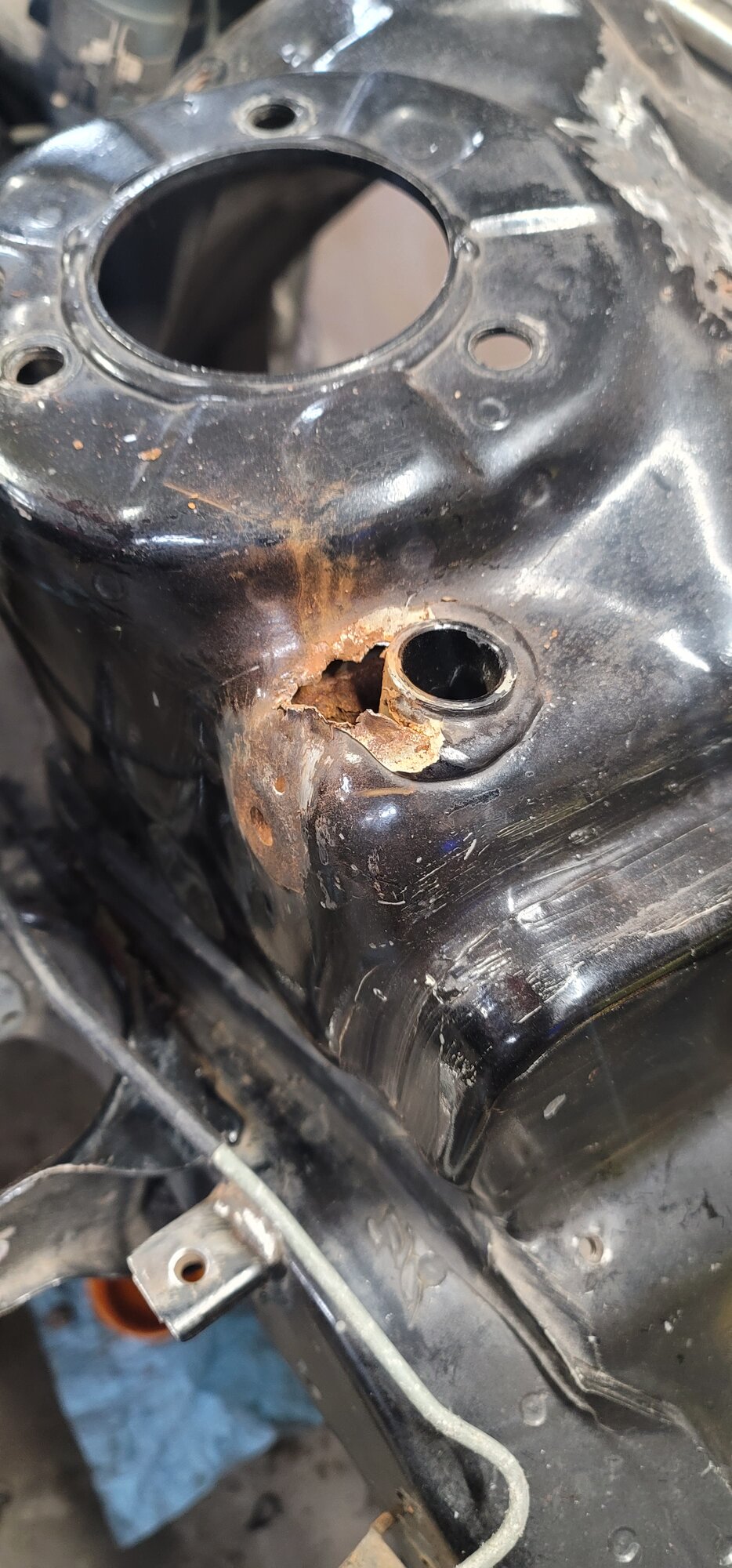

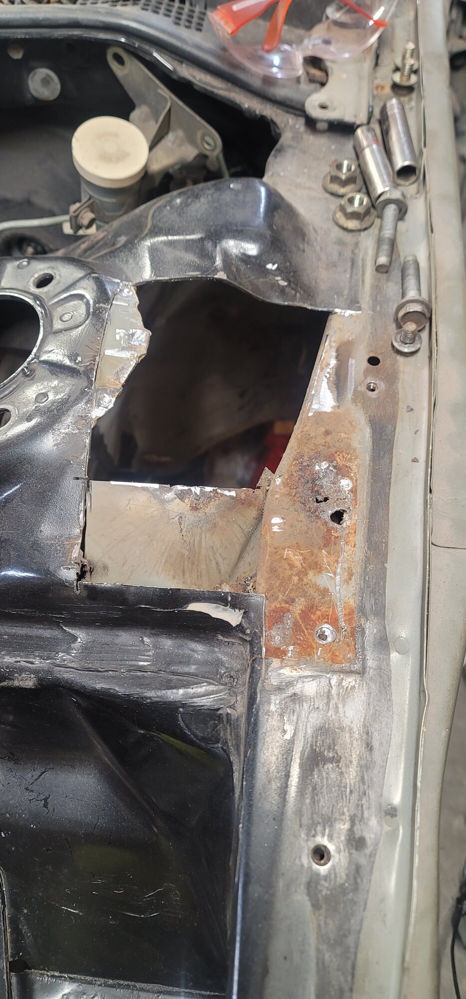

I started to tear into the rust where I don't necessarily need my doner car to fix. You won't see it but I'd like it to be as nice as I can make it. So far I'm pretty happy, it could be better but I'm not mad.

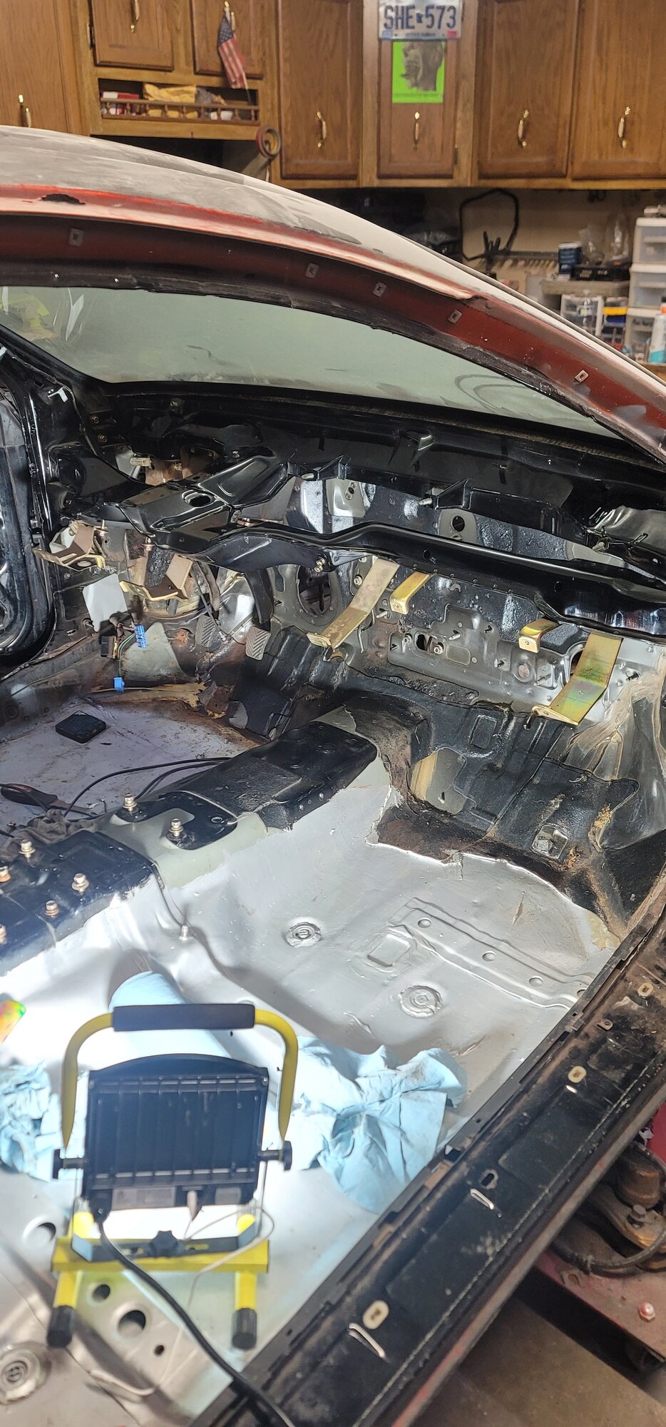

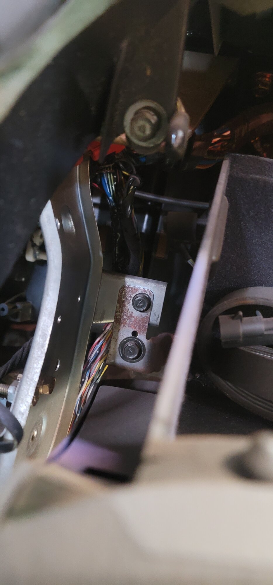

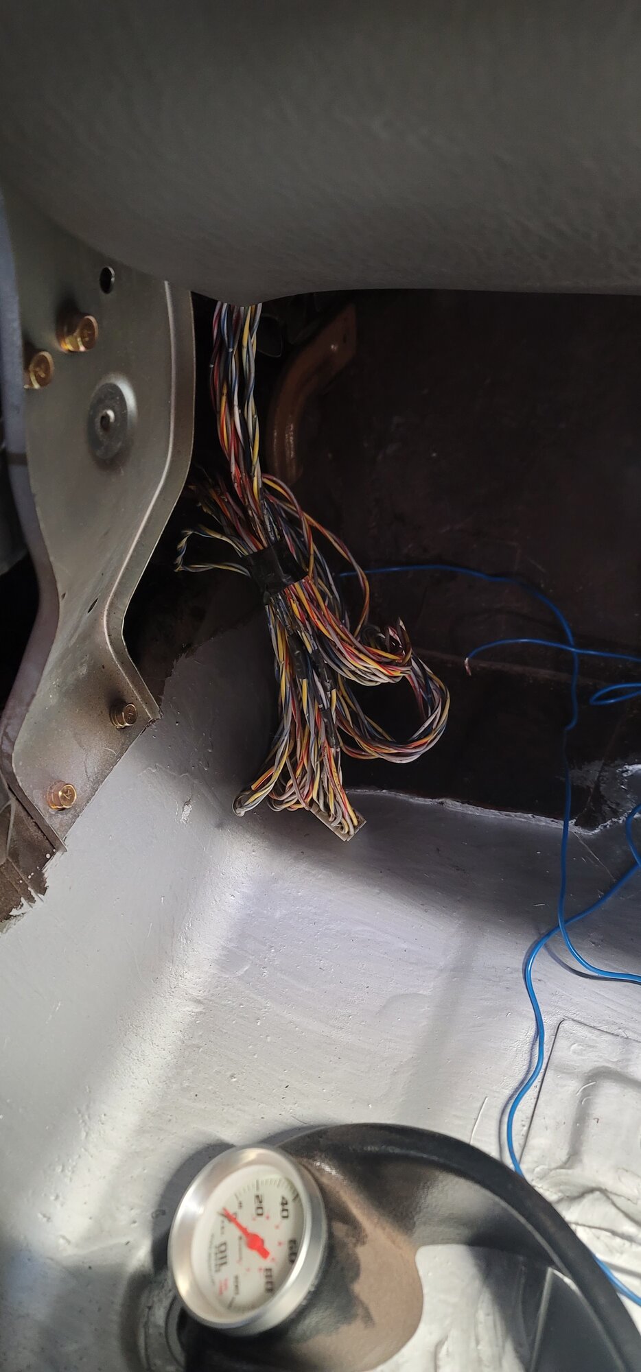

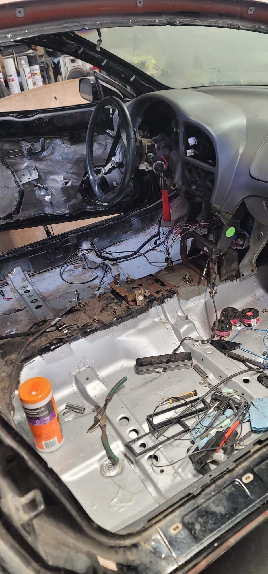

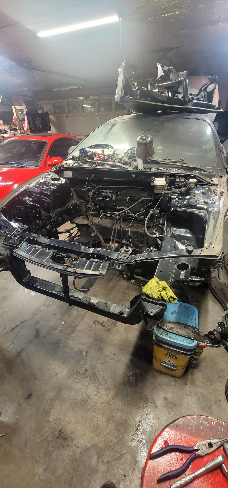

Pretty big update on the rs. I spent most of the day disassembling the car from front to back. Bolts are snapping left and right and the cancer seems to keep growing as I dig in further. That's okay though since I have a rust free doner. There's not one thing that can get me down. I am a little concerned about how hacked up the wiring is after I got the dash out. I swear my gsx is the only eclipse I've ever had that didn't have fricked wiring. I'm going to see if I can't snake the one out of my talon and use that instead since it's in better shape. Anyways my next step is to get the windows removed and get that roof skin peeled off.

I'm also going to steal the strut towers off the talon, it makes more sense then to artistically try to patch what I have. I could do it but then again I have rust free ones.

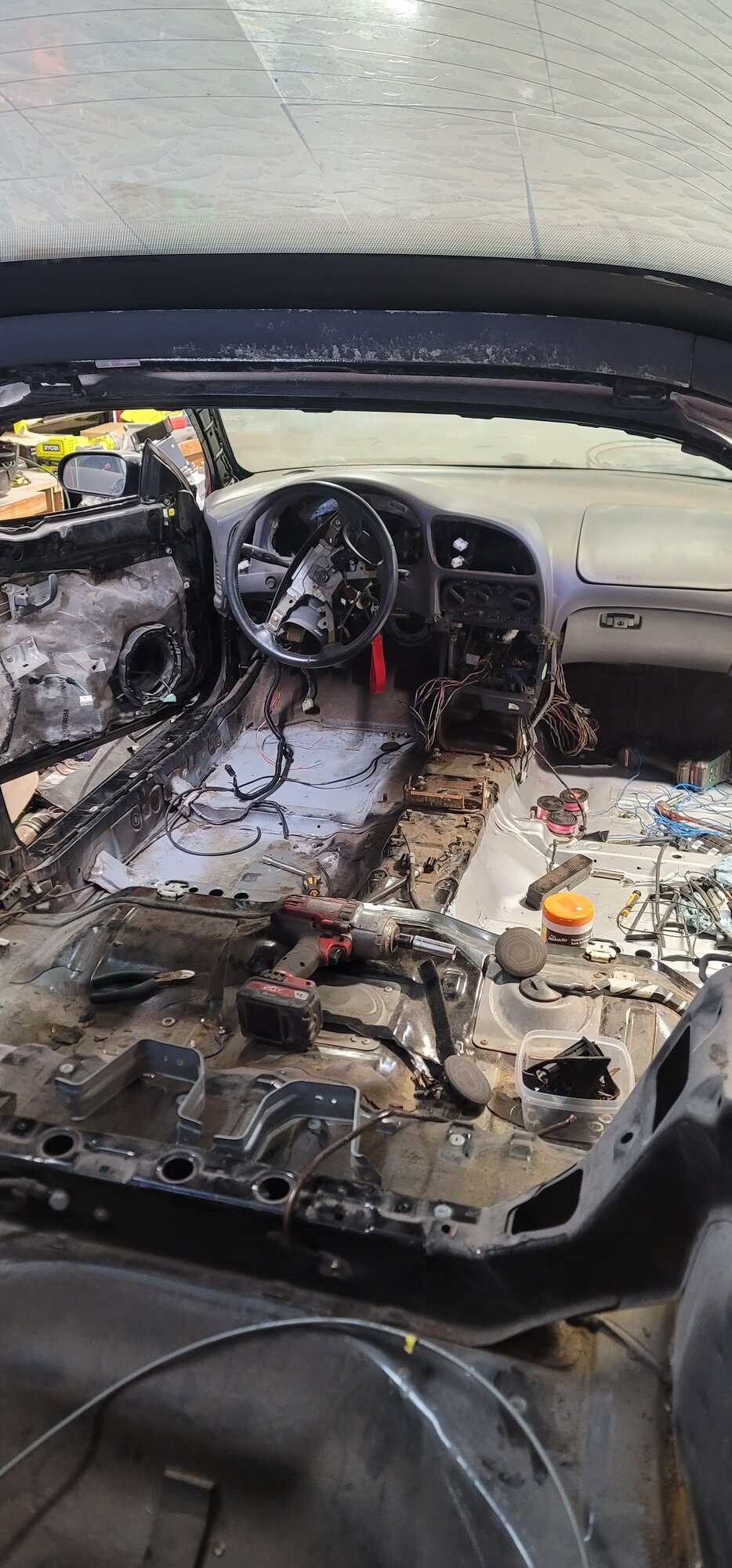

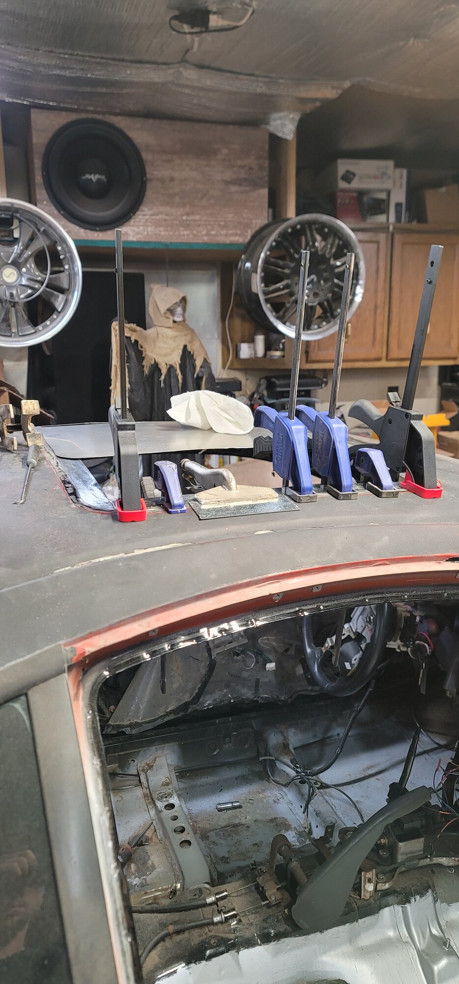

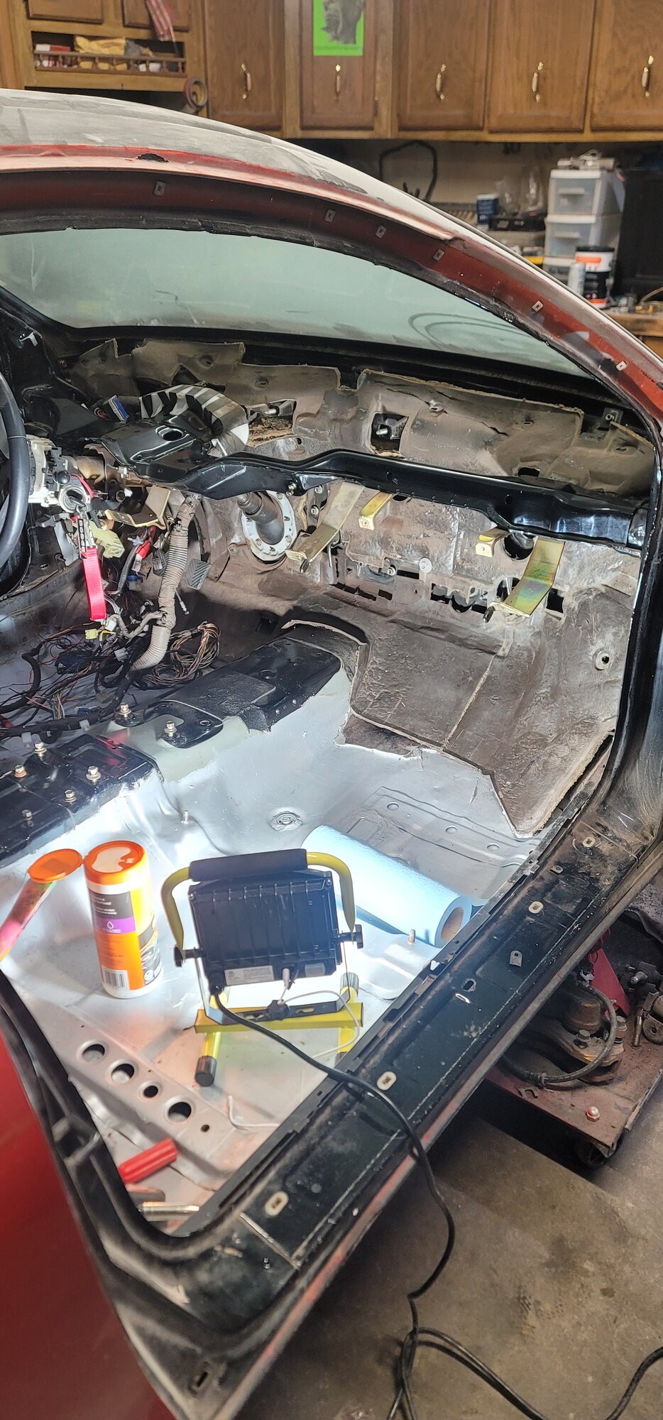

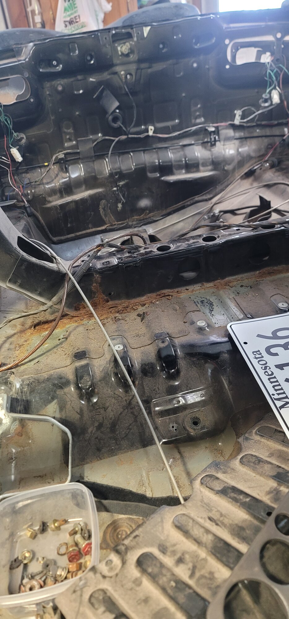

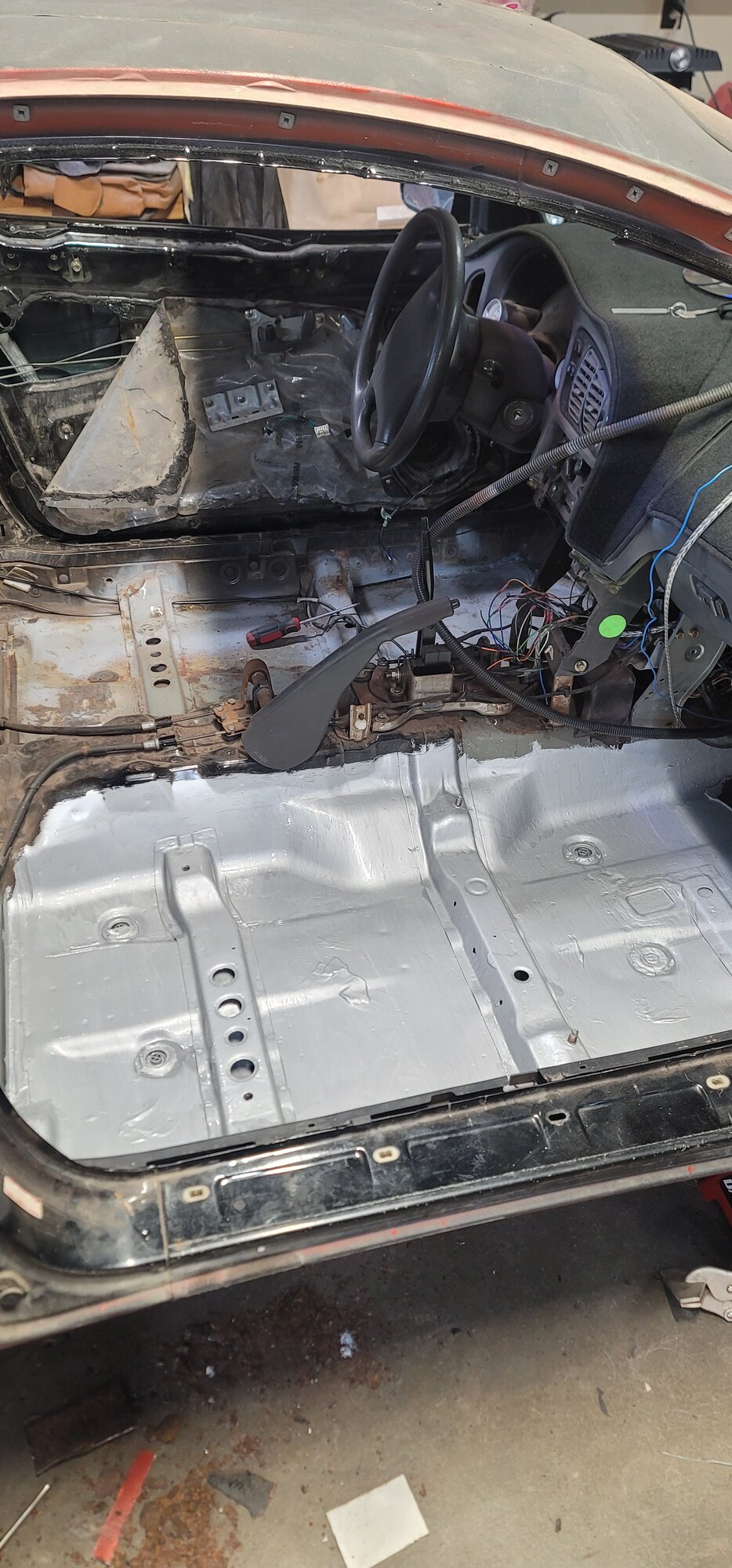

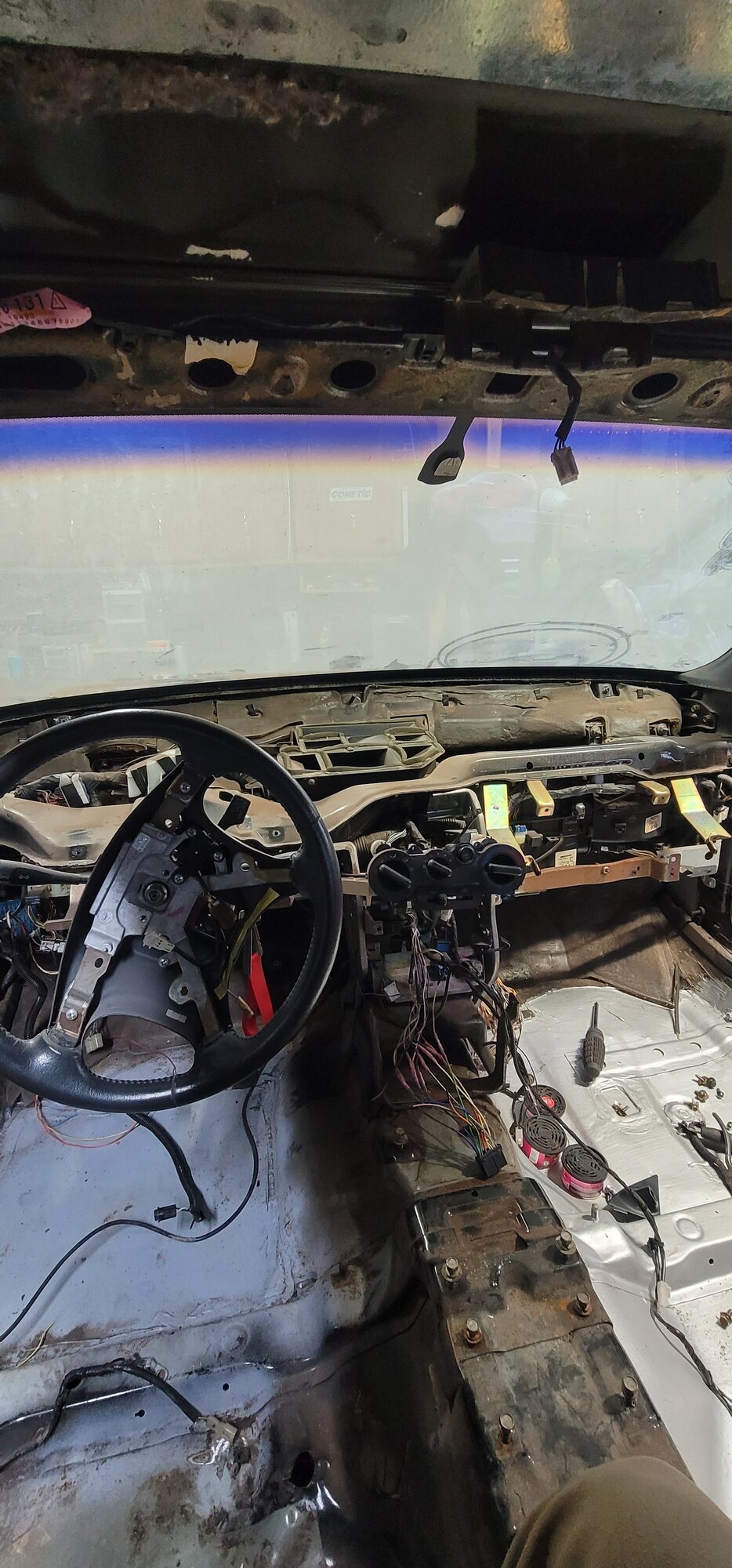

The interior of the car is pretty much fully gutted at this point. I removed just about everything. The next thing to remove will be the other rear quarter window and the front windshield.
I got the rear subframe dropped which was pretty easy. No real fits on stuff tonight. I did get smart and started using heat to get bolts out. All the bolts I snapped I just heated up and threaded them through with a pliers. It was all very easy surprisingly.
I'm going to make some sort of contraption to get the car up higher and so I can't strip the car inside and out easily. This thing is getting the complete works and it actually is making me excited. I'm going to push the limits of what I can do.
