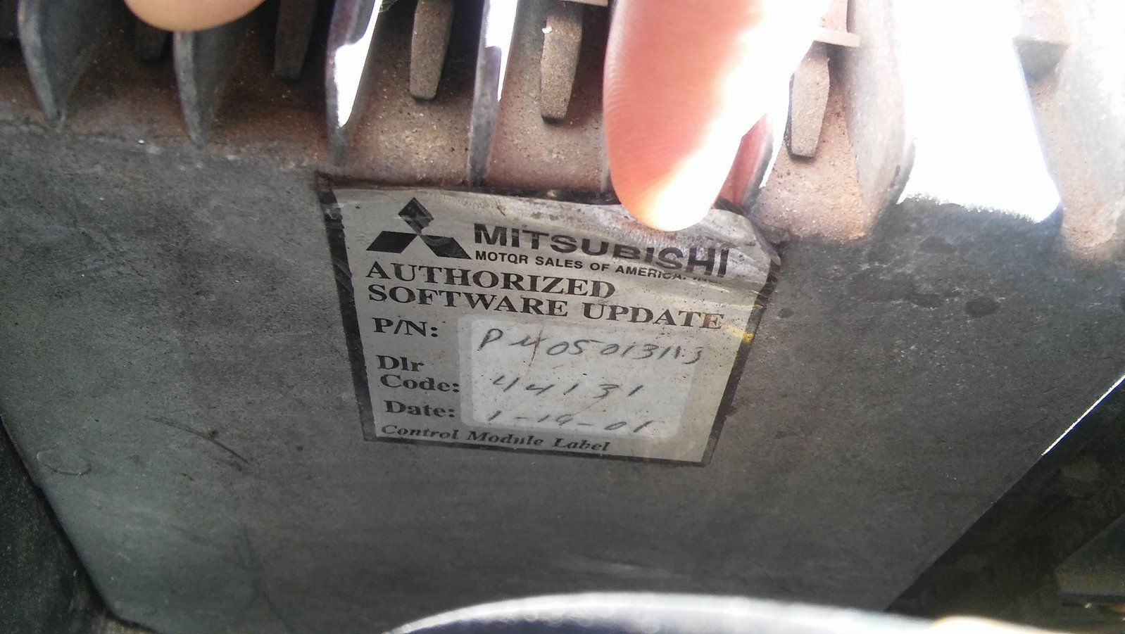

what kind of pcm work did you have done, in market currently and stuck between afx ecu and ms2

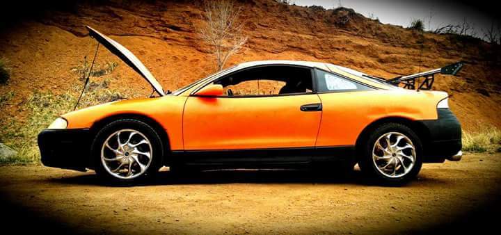

don't worry keel, I'm sure megasquirt is compatible with your car so there is hope. love that you posted a lot of pictures of your whip I'm going to follow and track your progress, ill be profiling my baby soon, putting exhaust on now and shes prettier off jackstands haha
It's smaller because it's a 95 ecu which is only obd1 compliant.
It also has 20 pins less which attributes to why it's smaller.

Okay I understand the 20 pins less but I have two plugs under my dash. I'll take a photo in the morning. If I hook up an obd2 scanner and run it as a 1996 gs It tells me my codes. I have always been confused about this. But what is the best plug and play way to go?
Plug and play for the 420a as far as a tuneable ecu goes doesn't exist. You would have to go with a megasquirt or AEM FIC and wire it up if you wanted to tune.
From what I have seen and read (I've never owned a 95) the ECUs weren't fully OBD2 compliant yet meaning they still met all the OBD1 requirements but not all the OBD2. Auto manufacturers had to be fully OBD2 compliant by 1996. So 95 are almost like a stepping stone you can read them with an OBD2 code reader but they don't have all the things a 96+ would have for codes. That's what I have been able to piece together.
