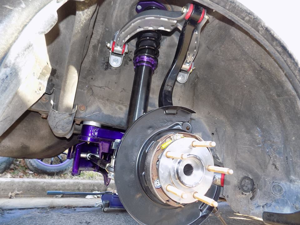

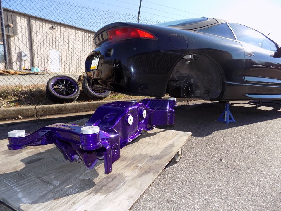

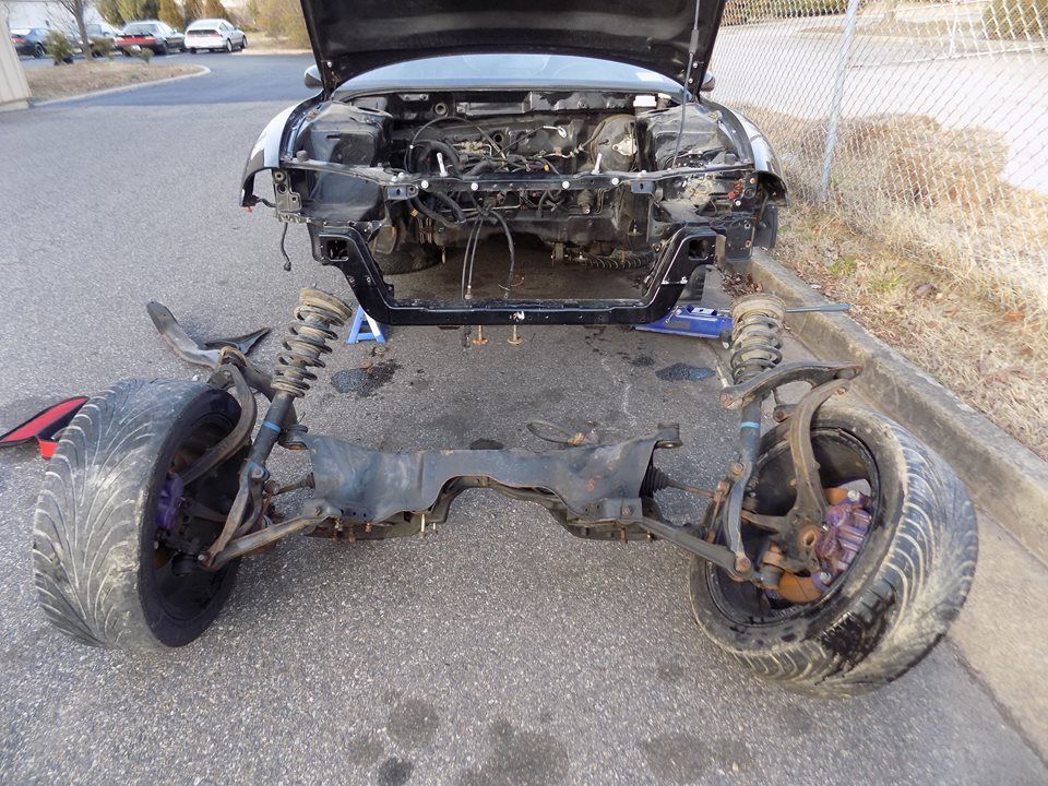

With the temps above 40 and the sun out, it was time to get to work on getting this rear end back in today

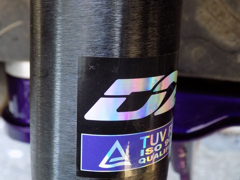

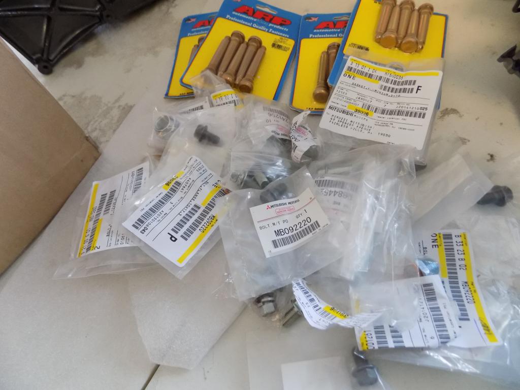

D2 Coilovers, Paul Volk toe arms, ARP extended studs, OEM hubs and bearings, ES bushings, Adam Proto solid bushings in the subframe.

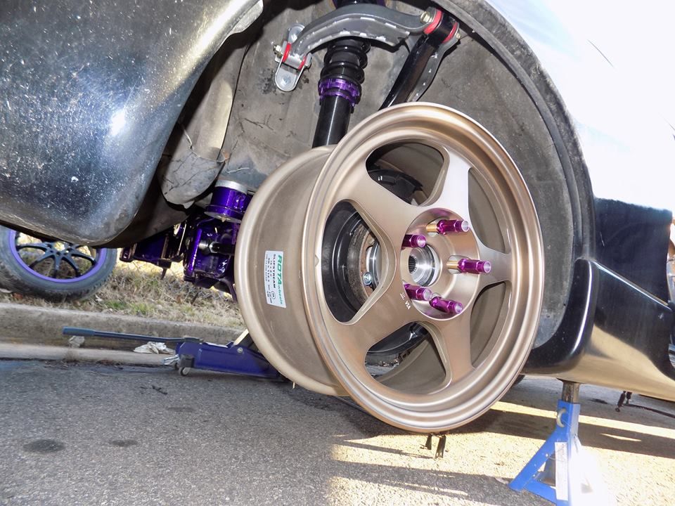

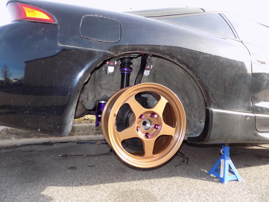

Of course I had to mount the slips on to see what they would look like and to my surprise I actually like the bronze so I may be stripping the paint and powder coating them bronze instead of my original plan.

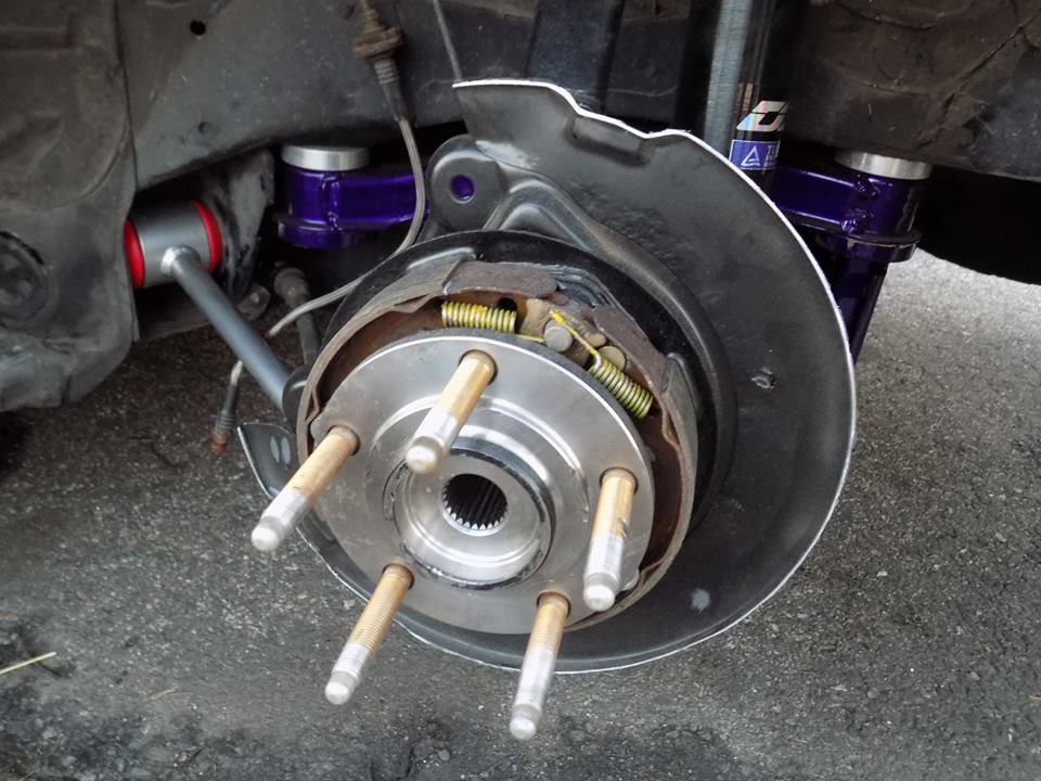

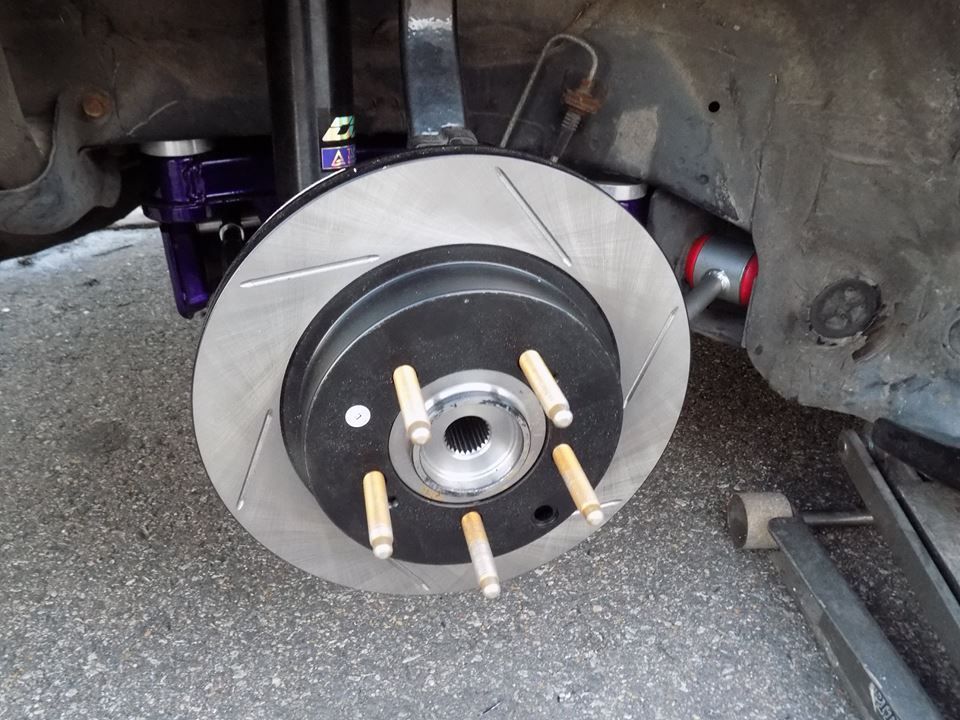

Had to modify the factory dust shield to fit the evo rotors on them since I forgot about this before installing them on the hub:

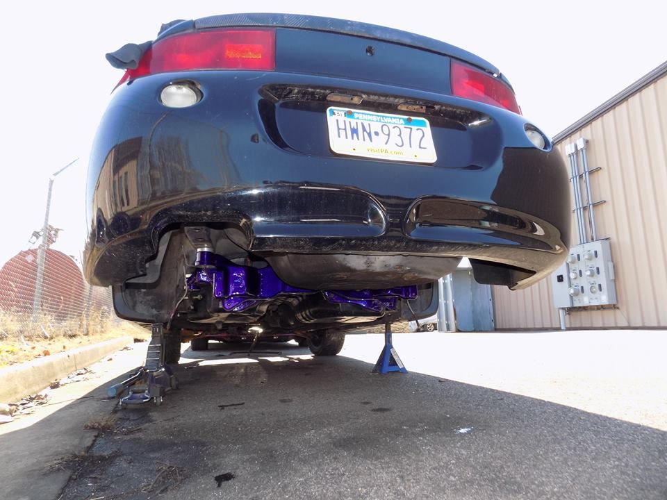

Powerslot Rotors installed

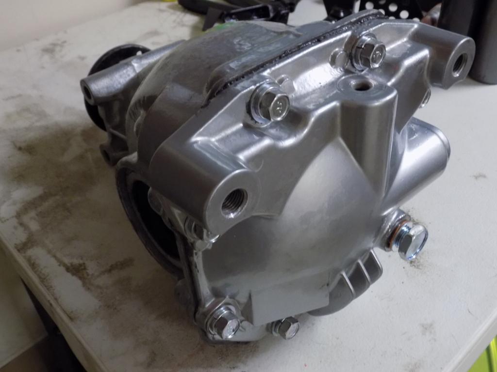

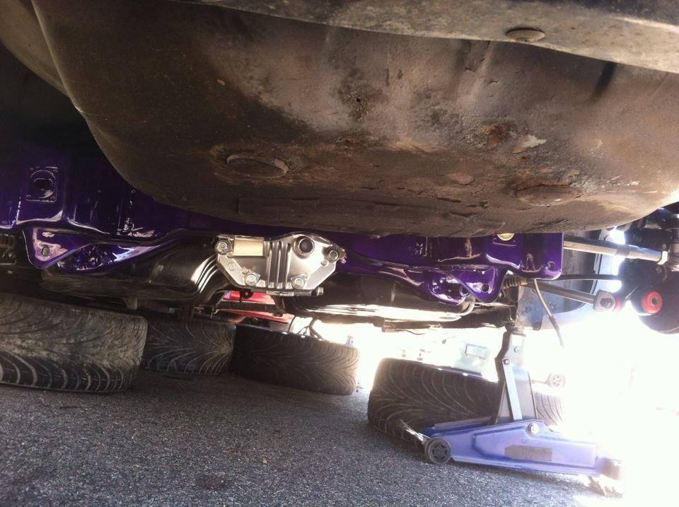

Rear Diff Installed
Currently working on getting our rear axle situation figured out as we have quite a few but every outer cv shaft is damaged in one way or another. Sway bar will be going on later this week along with new brake lines and mounting the tires on the slipstreams since we just got in some Dunlop Direzzas for them.
