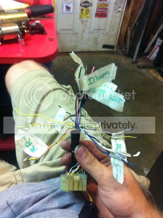

---First, you need to get the wiring diagram for the 3000GT unit. it's the left one, with the 2-part connector, they are white. the 2-wire black square one is the steering wheel controls which I am not trying to use....yet...
http://www.3si.org/forum/f6/factory-hu-conversion-92-93-a-518405/
---then u need the one from the Infinity stereo in our cars:
http://i108.photobucket.com/albums/n18/califorever503/stereowire2g.jpg
this one helps:
http://www.the12volt.com/installbay/stereodetail/1543.html
the RR and LR are the same wire colors on both harnesses. the RF & LF are both Wh/Blu, Blk/Blu, so just use the pins locations like the Rear did for the front......outside is Right (6&14), inside (5&13) is left.....
I just cut and spliced into the stock wiring...if you ever need an aftermarket stereo, just get a harness connector for a 1993 3000GT :)

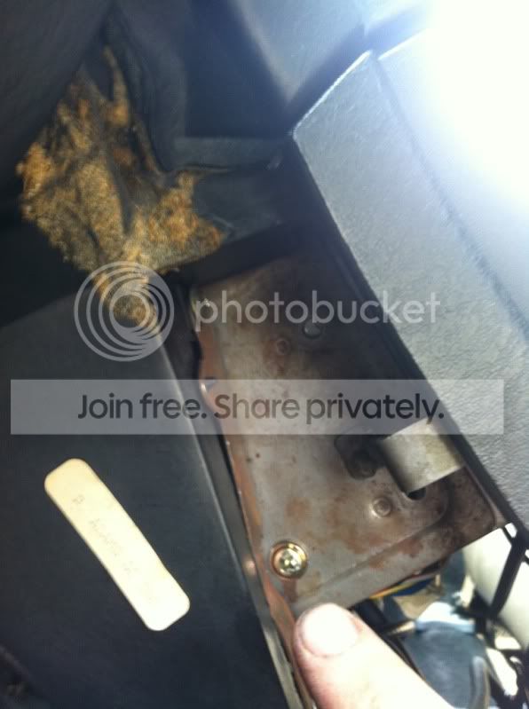

After you splice in you will need to mount the radio into the STOCK side mounts. the holes actually lined up perfectly on the far bottom screw, so you still get 2 OEM mount locations!

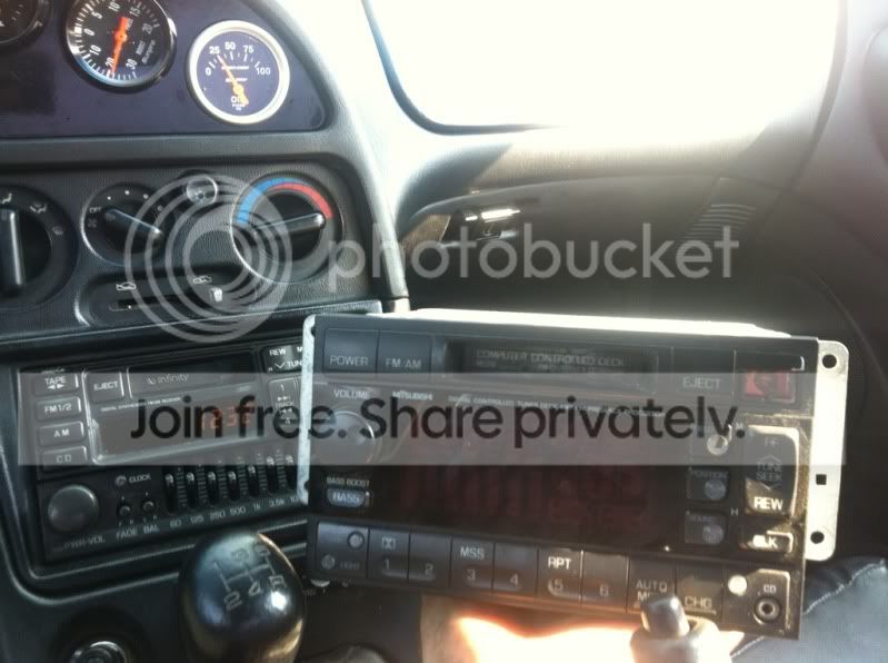

plug back in the battery and enjoy your AUX-equipped Mitsi 3000GT stereo! and it sounds great!
best $25 I have spend in awhile!!! iPod works great :)
i THINK the F&R are somehow switched in the HU. i have more sound in the back and when i change the zone to the front it favors the rear. I will redo that, but otherwise it works 100% fine. IMHO best alternative setup. that old school equilizer dancing around is the bomb!
