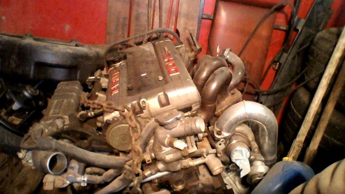

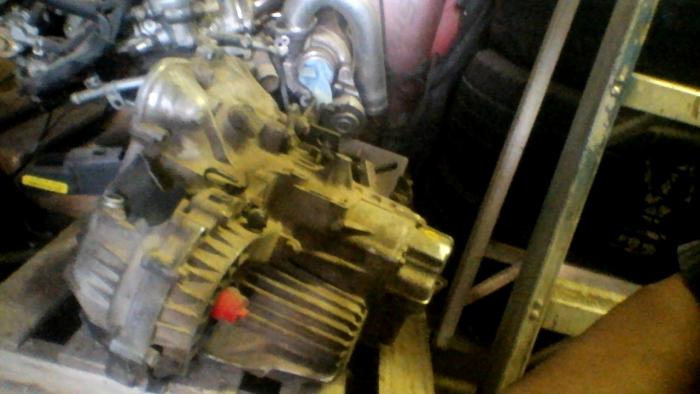

Ok, lets start out with the known history of my Salvaged1Gdsm. I bought the car back in Jan. of 2012, did a bit of maintenance on it to get it to a very reliable state of being then once the car's performance/reliability stayed consistent, i researched and planned out my build. I started acquiring parts locally around Mar./May of 2012, acquired a low mileage '92 GS-T longblock that a local salvage yard found for me out of Kentucky in May of 2013 and then all my gathered parts collected dust all the way to present.
Parts acquired so far-
'92 GS-T longblock
Slow Boy Racing Manual Boost Controller
custom equal-length exhaust manifold

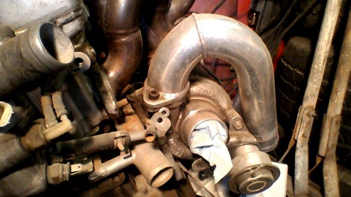

a genuine MHI Lancer Evo 3 TD05H-16G turbocharger
TiAL 41mm External Wastegate (maybe it was a 44mm, i don't remember, i underlined it because i traded tsi20gawd for the part below)

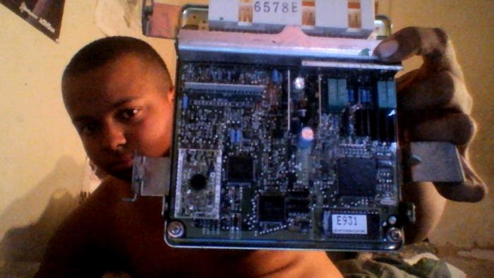

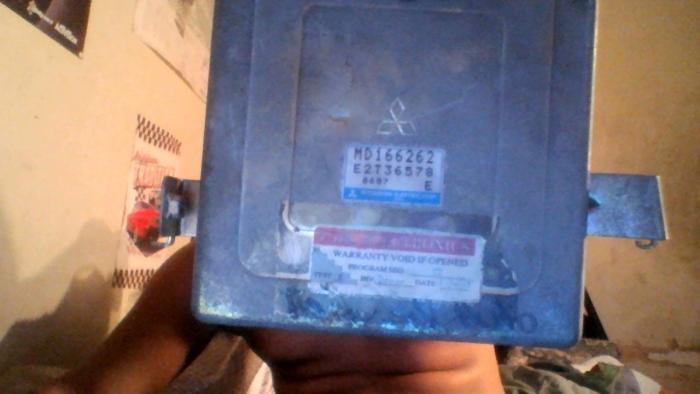

91+ EPROM ECU
'92 GS-T 5-speed transmission

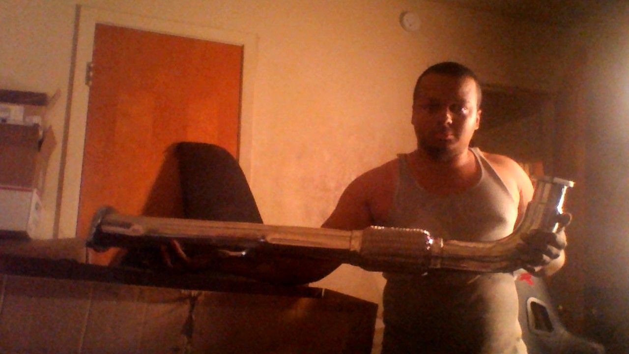

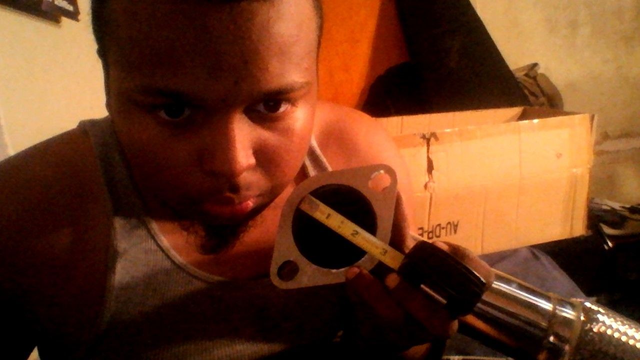

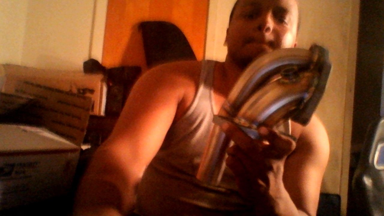

Punishment Racing 2.5" o2 housing with VTA wastegate dump
Punishment Racing 3" Downpipe (in transit)

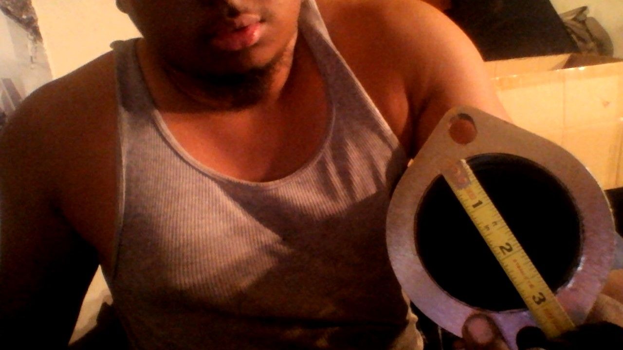

Punishment Racing 2.5" to 3" o2 Housing (it maintain a full 2.5" ID 'til right after its downward bend then expands out to a full 3")

I'll start looking for a place to store the car (and tools to pull the motor and tranny) as soon as i get my E36 M3 back from the body shop, meanwhile i'm gonna be searching online for GS-T specific engine harness pigtails, injector resistor pack and a good knock sensor. Once i have a place to accommodate a car, tools, and adequate work space, i'll pull my motor/tranny/harness to clean up the bay and prep it for the new motor/tranny/harness to be dropped in. I'll be making a completely new wiring harness from scratch using my factory harness/ecu as a guide and i'll add the 7th MAF wire/injector resistor pack/knock sensor wiring in as i go along.
EDIT: o2 housing finally came in today and the downpipe is due to arrive on monday.

I remember doing this conversion back in 05' Do yourself a favor and find a good turbo engine harness. To do the swap correctly to make it run you're going to have to rewire the injector resistor pack in, an extra wire to the Maf, and wire for the knock sensor. I hate hacking up harnesses. If I kept my 93 Eclipse GS that would have been the next thing I would have done to it.
