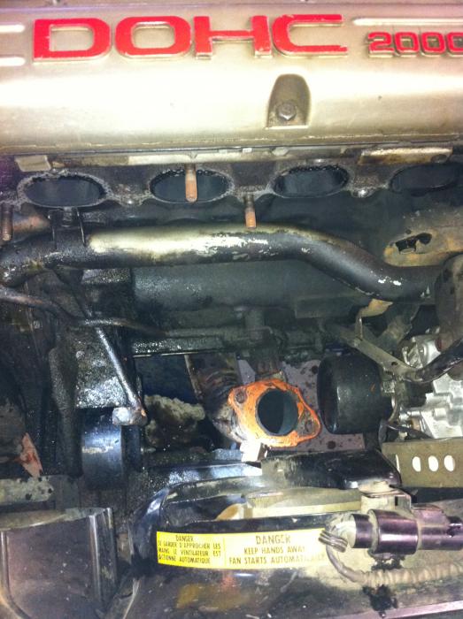

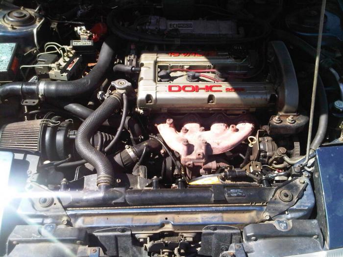

So i just started to get into the swing of things with the "dsm" worldi picked up this little beauty for under a grand, few things wrong with it. it leaks oil from the oil pan from previous owner stripping the bolt holes, he broke 2 studs off for the manifold. he said that is was a 14b turbo running 14psi boost which was highly unlikleyas i could only get 4psi out of the turbo, totally shot. he took the muffler off and i drove it home right off the o2 housing.
the day i picked her up:

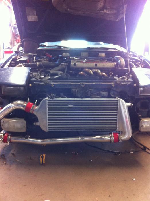

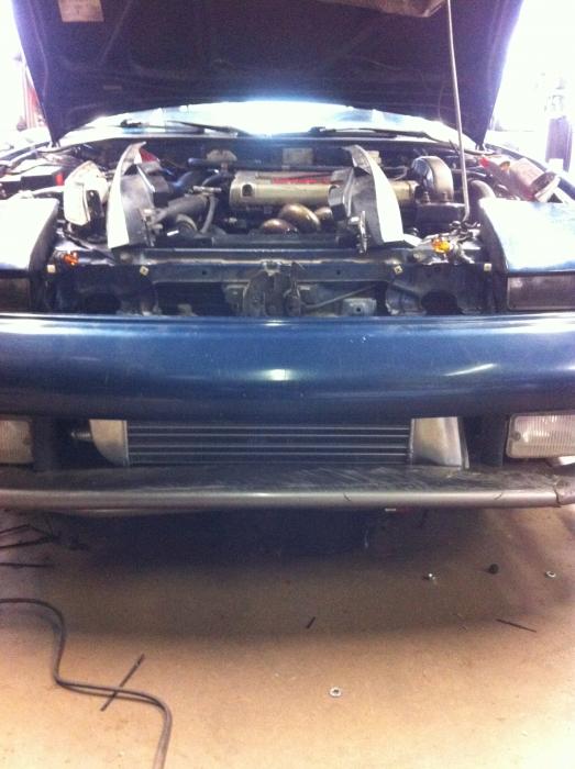

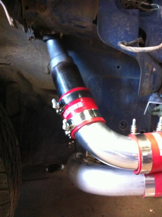

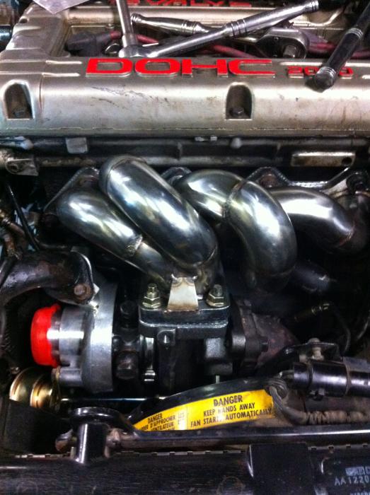

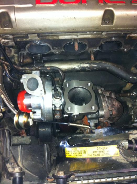

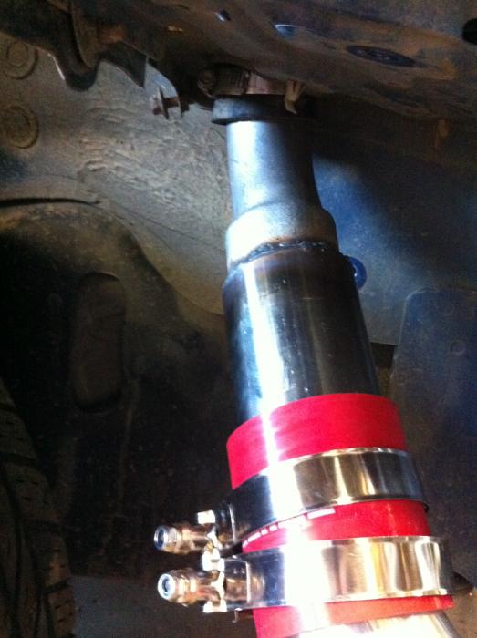

since im new to this whole forum posting things and dont know how to post texts under pics i will just say, i bought a 16G turbo new manifold a FMIC kit with some customization
what i did was remove the old mani and turbo and put the new stuff in, then put my FMCI on.

looks like a ebay turbo and manifold...that fmic looks like shit also. Another DSM soon headed to the junkyard.

Looks like your intercooler is on upside down bud. And just a friendly f.y.I. before you get too far. Don't buy ebay stuff. It will only cause more problems later on. The tubular manifolds are prone to cracking and most of the time the turbos can't be pushed past 10psi.

I agree that the fmic is on upside down. Good luck with the first build, and very nice car!
