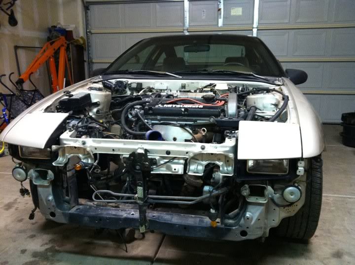

First picture with car in Arizona, we took front valance off to load on and off trailer.

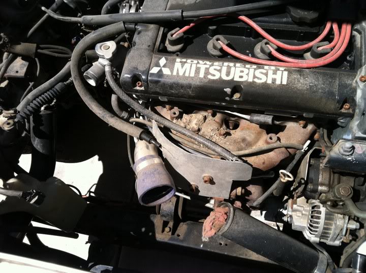

Engine shots with about 3 years worth of grime!

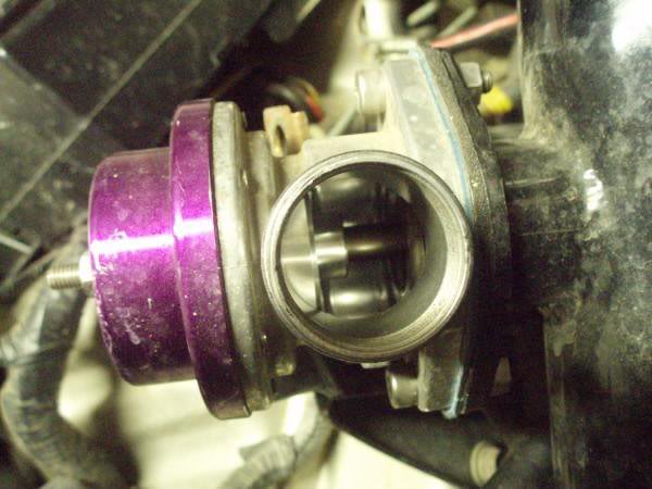

Very dirty shot of the Greddy Type S BOV

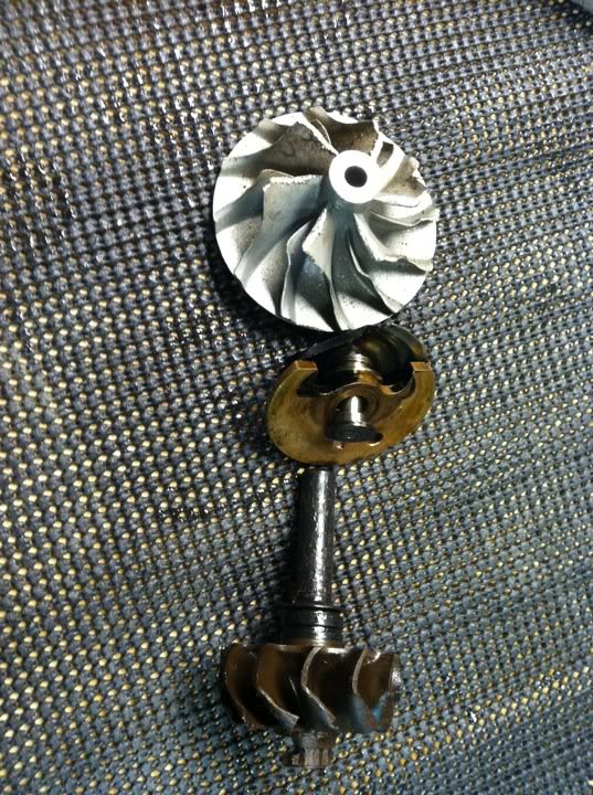

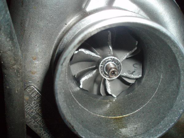

My shelled out eBay Big 16G. This is something I really should have read more about 4years ago when I bought it. Although I think it was a lack of oil from the head oil port that caused the catastrophic failure

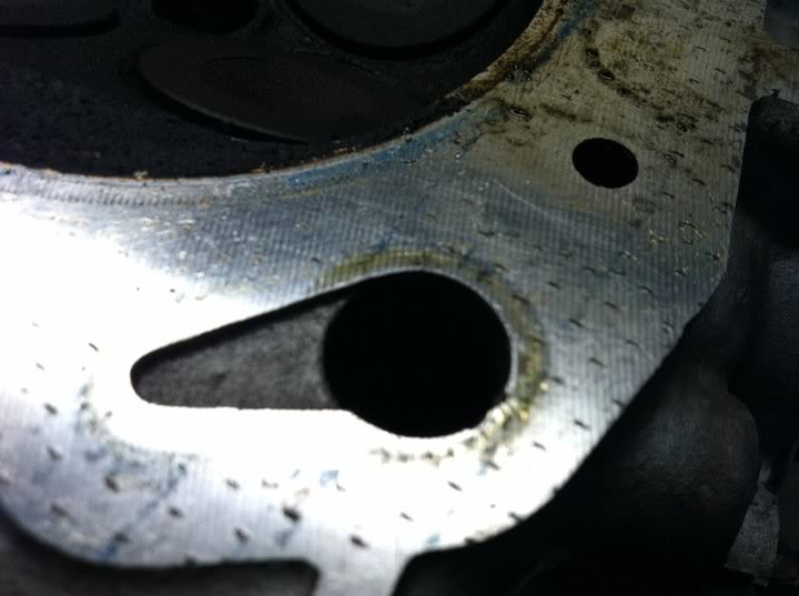

This shot is from the head I installed after burning up my 2nd head gasket. The head was milled down and thus made my oil port very shallow, from what I later read on this site, this can also cause terrible lifter tick.

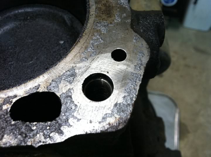

Engine block view of oil port

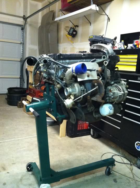

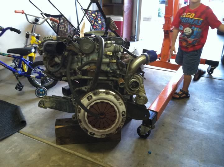

Engine pulled with some help(I know, he is not wearing safety toe shoes:shhh:)

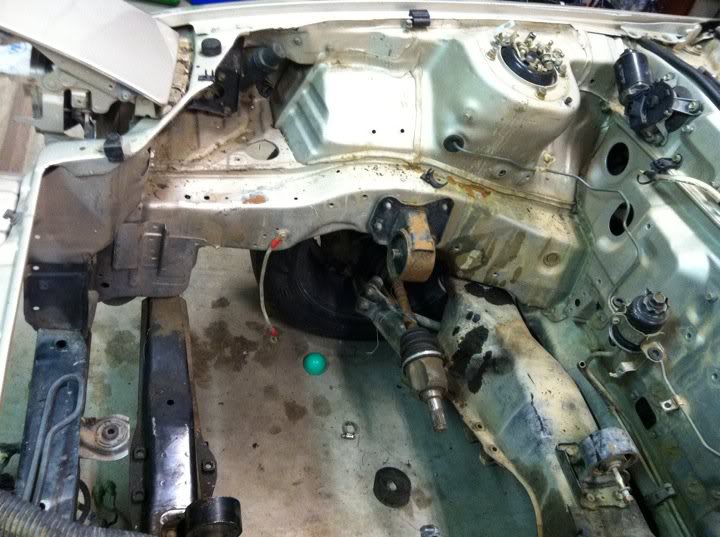

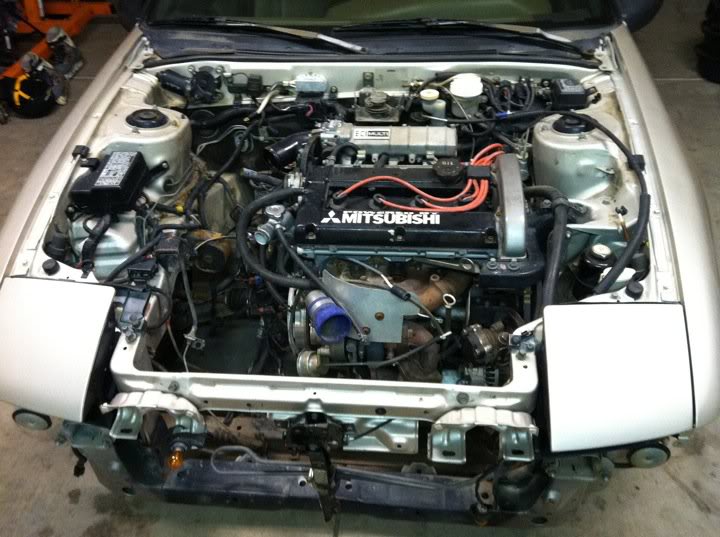

Start of stripping/removing engine bay components
I have since removed my interior and removed/cleaned up the left-over sound deadening material using Goo-Gone. I have also removed the dash and all related wiring harness'. I plan on doing an engine bay wire tuck to go with the shave.

On the Oil port on your head, make sure you do the porting mod if you are going to get a fresh head. Its on the site somewhere but that will help aleviate the high oil pressure/lack thereof.
