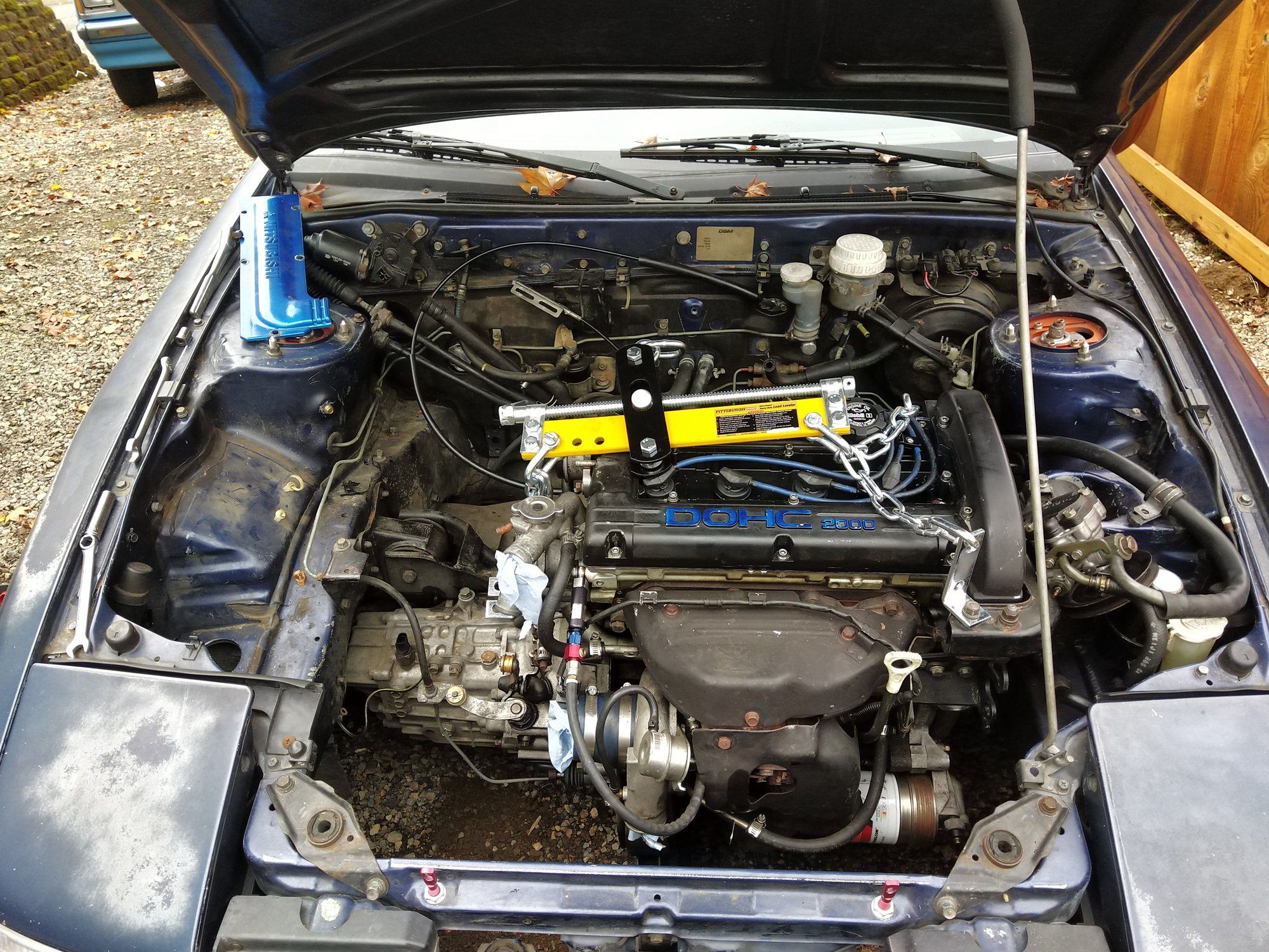

Prepped more of the Talon today for the engine/tranny pull. Forgot the rental place was closed on weekends so I'll have to wait a couple days to rent the cherry picker.
