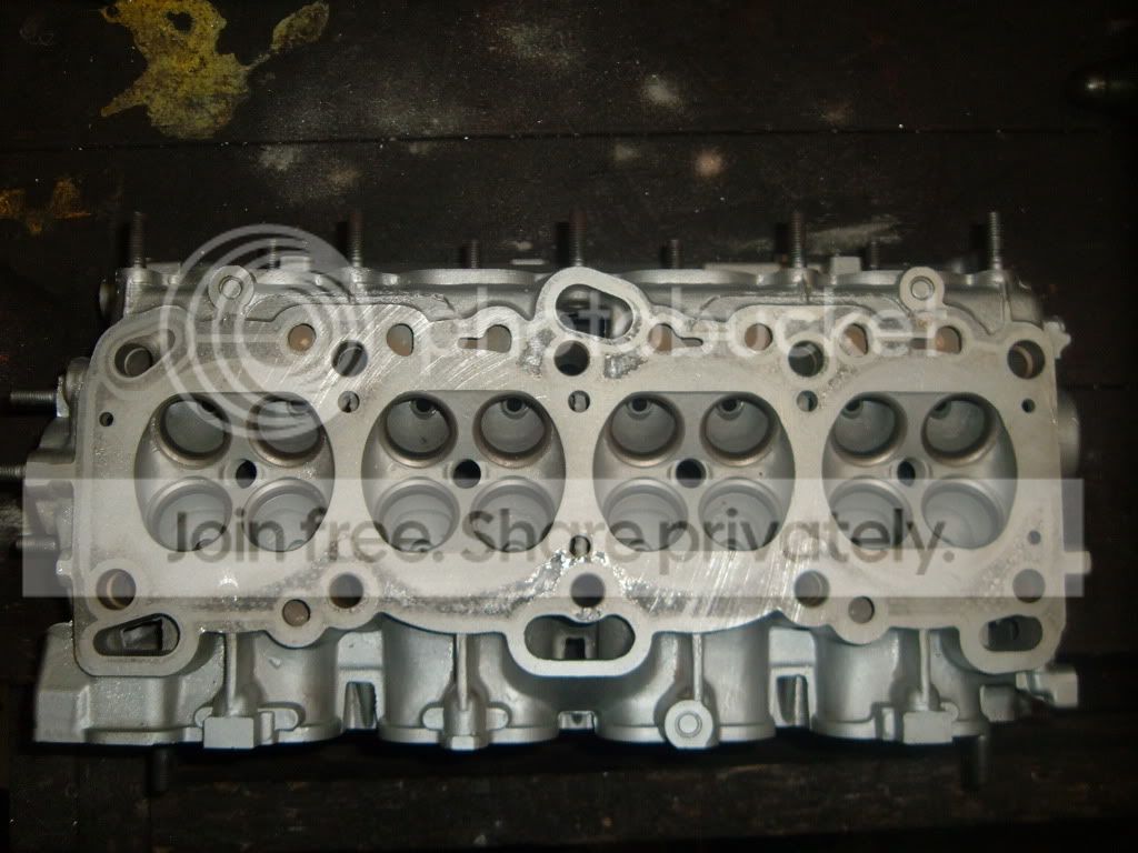

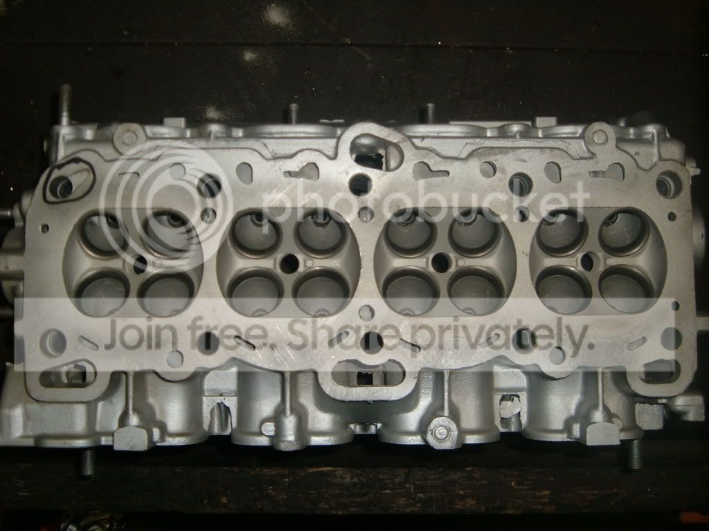

Head #200 (This series of heads will start with 200 and count up)
1G
Head markings 2.0/8
8mm exhaust corner studs
Oil port mod NEEDS done
I-F 5.198 E-F 5.197
I-R 5.196 E-R 5.194

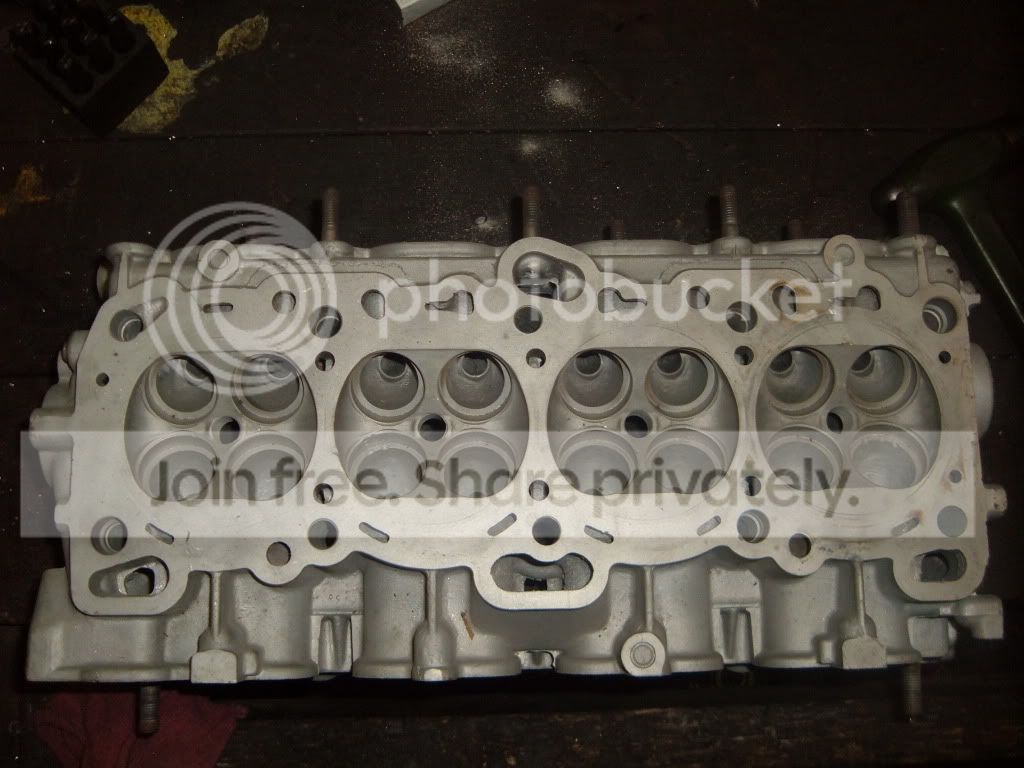

Head #201
1G
Head markings G6/1
10mm exhaust corner studs
Oil port mod done
I have rebuilt this head once before
Head will receive 16 bronze guides
16 new seats
Head has been ported
I-F 5.190 E-F 5.190
I-R 5.190 E-R 5.190

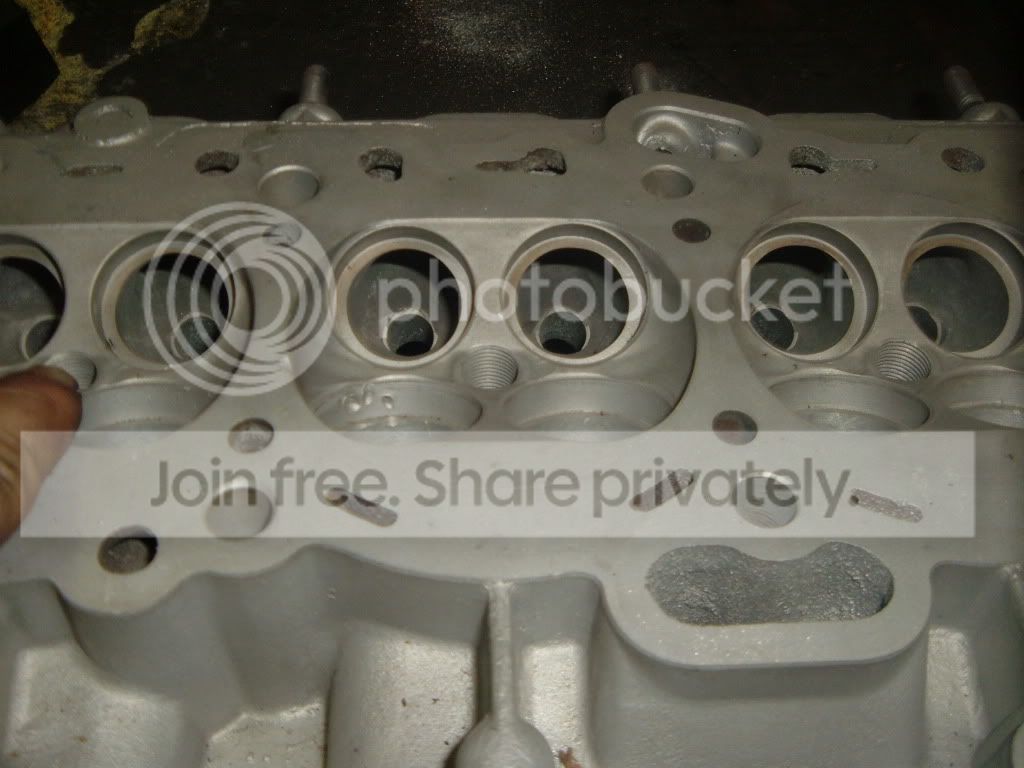

Close up of guides and seats removed

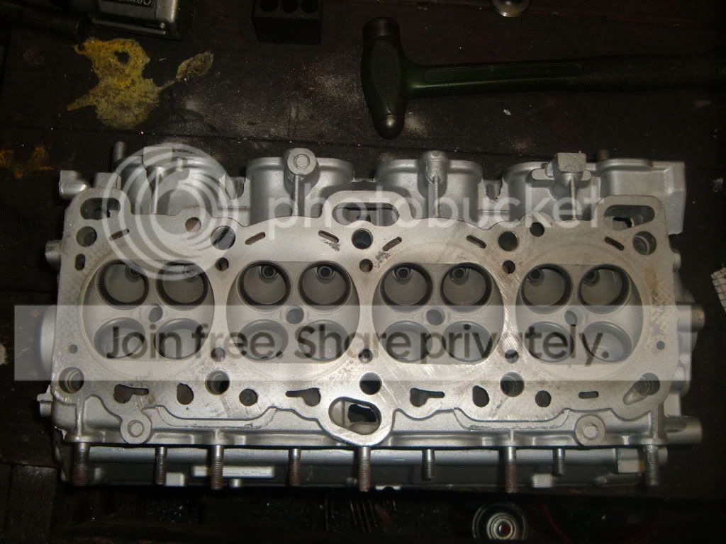

Head #202
1G
Head markings G6/5
8mm corner exhaust studs
Oil port mod done
Needs 8 exhaust guides
I-F 5.167 E-F 5.166
I-R 5.166 E-R 5.165
This head is well past service limit, but can be used with a thick head gasket and adjustable cam gears, or work well on a high compression non-turbo engine.

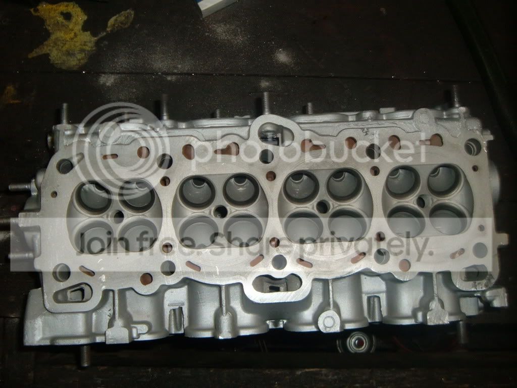

Head #203
1G
Head markings none/smooth
(I think this is the Hyundai head)
Oil port mod done
I-F 5.188 E-F 5.194
I-R 5.188 E-R 5.194
Head #204
2G
Head markings G6S/7
Oil port Mod done
Has broken exhaust manifold stud
I-F 5.200 E-F 5.199
I-R 5.200 E-R 5.199
Head # 205
2G
Head markings G6K/3
Oil Port Mod Done
I-F 5.191 E-F 5.192
I-R 5.192 E-R 5.190
Head #206
2G
Head markings G6K/1
Oil Port Mod Done
I-F 5.195 E-F 5.195
I-R 5.196 E-R 5.193

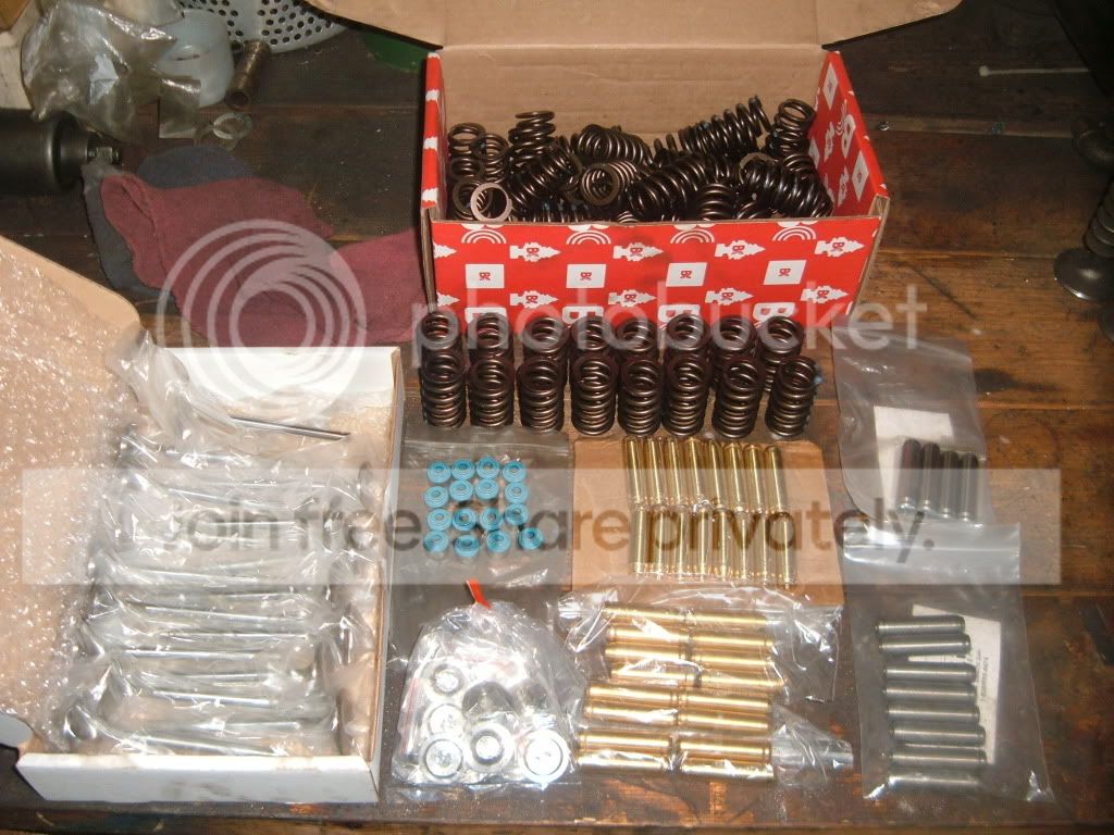

Some of the Parts I will use
