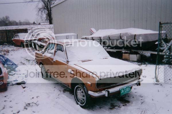

The day I bought it. No idea how long it was sitting there, but I rescued the little guy.

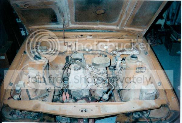

Original engine. That didn't stay to long in here.

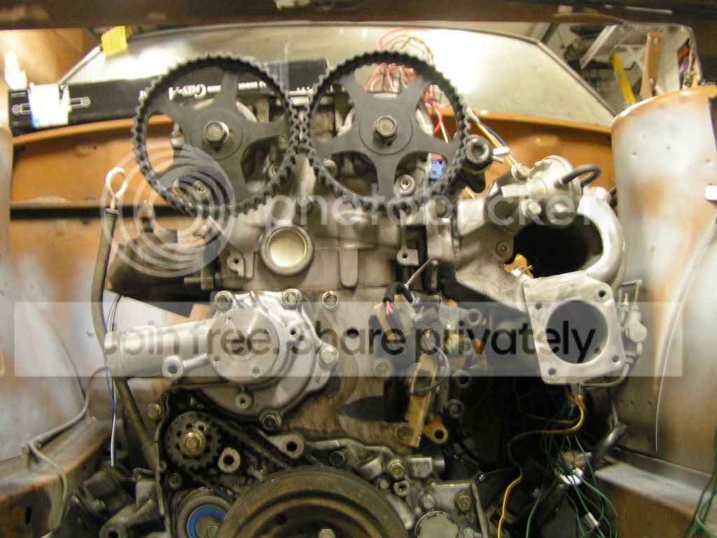

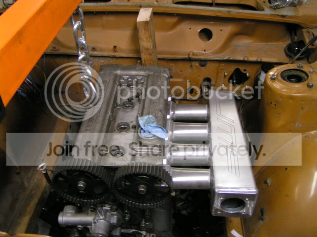

First attempt with a JMF intake. I didn't have enough room with the brake master cylinder, so I stayed stock. Kinda.
I had my friend Jack at jackstransmissions.com take a stock 1G intake manifold and cut it at the flange. Flip it 180 degrees and put it all back together. I hope it works, cause it looks awesome.

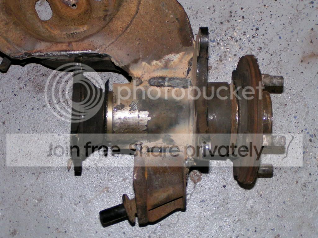

I also undertook the effort to swap in Z31 5-lug hubs and CV axles for the rear. It will eventually pay off, but the work involved was pretty extensive. Good thing my stepdad is a good welder. I couldn't have pulled this off without him.

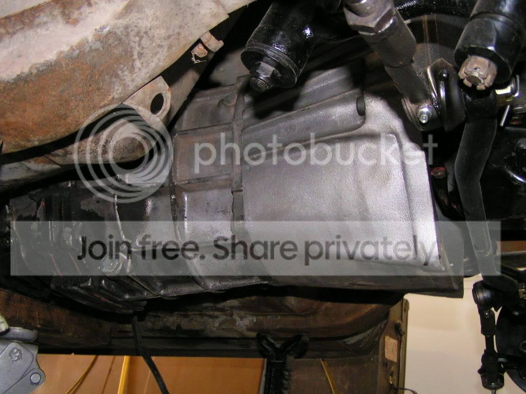

R154 transmission with a Billhousing. Yes, Billhousing. This swap would not be possible without this part. It's pretty straightforward, and all the parts between this and the 4G63 are off-the-shelf. Bill Hincher is responsible for this great thing. He's also got these for Toyota W series and GM Auto transmissions.

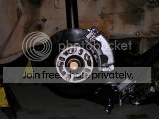

These are 2 piston Q45 units. These are the 4th set of brakes on this car and the only set with pads and lines attached since the stock set came off. These are bolted to S12 V6 front struts with Z31 spindles and slotted rotors.

Just a question. Did you ever consider the Toyota 4 piston calipers from there 80 model trucks? I only ask because that's what I will be using on my '79 datsun 810 coupe.
Cool build, I actually considered putting a 4g63 in my 810, but fairly certain I'm going to go with the 3.1L straight six stroker now.
- Chris
I had a set of those 4 piston calipers. They are HEAVY. I saw no real advantage to using them. Even using these 2 piston units is probably overkill for most cases. I've seen lots of people running Z32 4 piston calipers and some running custom Brembo setups from Mario Lozano of TSR. You can run what you want, but most of it's for show.
