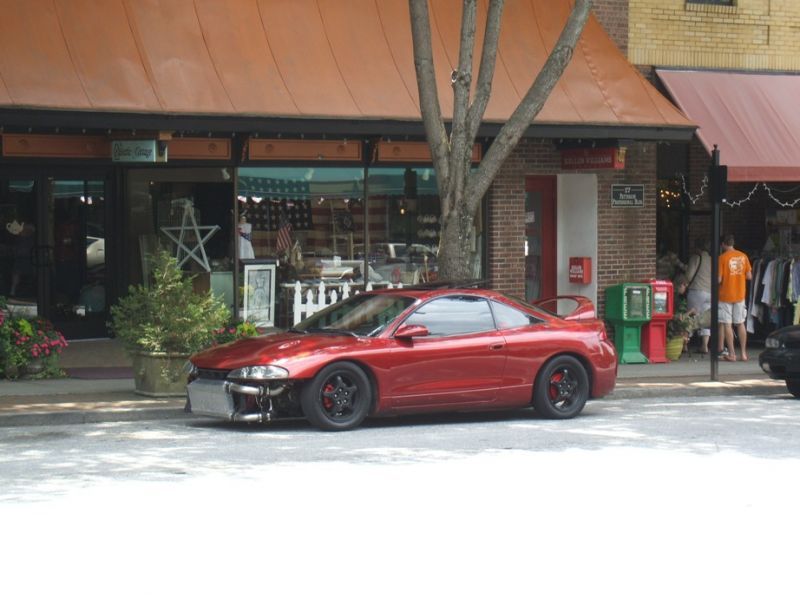

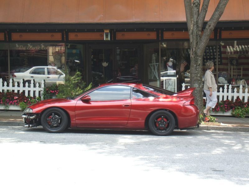

Engine Bay:
Front:
Side:
Rear:

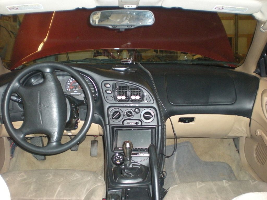

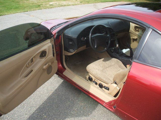

Interior:
Early July 2012 I put my fans on a switch, installed pioneer double din CD player and painted the rims black.
The next thing I did was hood spacers by SickSpeed to vent the hot air from my engine bay and pull cool air through the intercooler

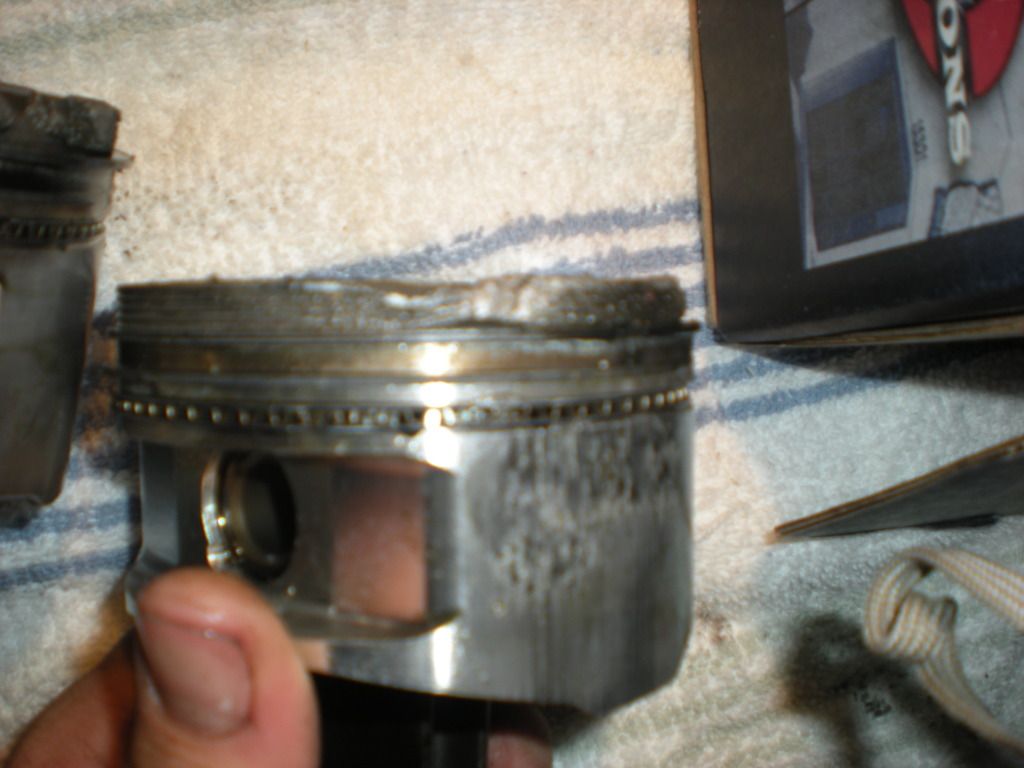

Found pieces of the piston chipped away just at the top of the piston towards the back of the dome. I'm going to try to take the piston's out this evening then replace them with some new JE Asymmetrical FSR piston with seal pro rings so I will be able to push high boost without so much friction. Hoping to be good @ 20+ psi on 8.5 compression ratio.

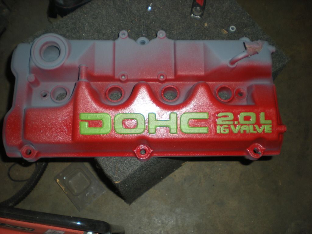

Painting cam sprockets

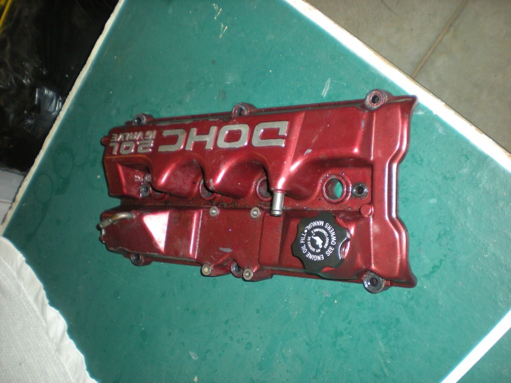

The valve cover was worn out
So I got it sandblasted, High heat primered then sprayed with a bright red,
once i Had it taped up I sprayed with high temp flat black paint (4 coats)
I have peeled the tape off and it looks amazing, will be posting pic soon. I have now put another 3 coats of gloss on to really make it pop out at you.

Ok so I'm replacing my piston's with je's new Asymmetrical pistons, I took the pistons out today and found the culprit to my blow-by. And most likely my low compression numbers, 150 psi give or take 10 across the board.
The walls are not scared, slight slight ridges barely feelable with the fingernail. A good flex hone to the wall and we should be rockin :D
