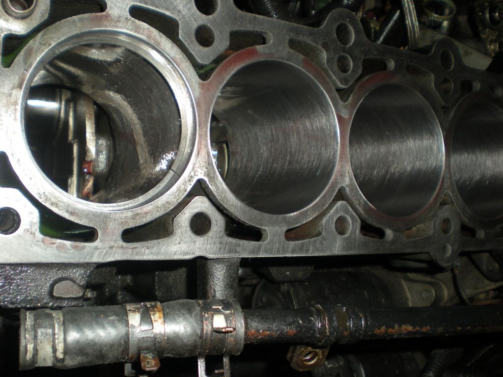

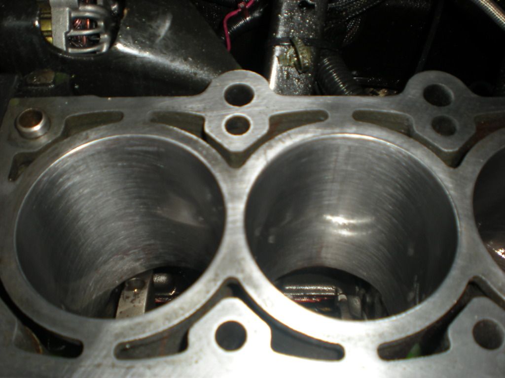

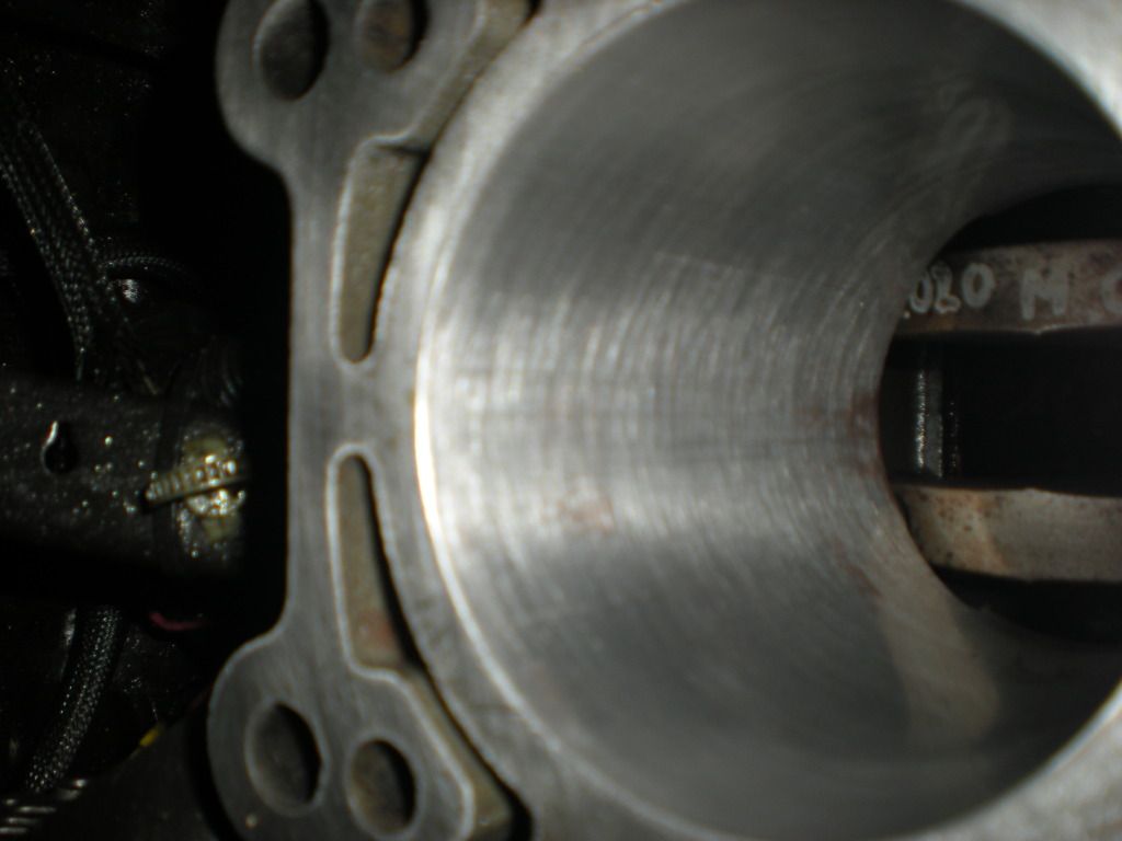

yea it looks like it got hot.. and possibly some Det.. No good. IMO, why dont you have a machine shop look at it.. I know you already ordered the stuff (newb move), but id hate to see you get it all back together and stil not be right because the tol's are not correct.. Any idea on ring gaps? How do the rod bearings look?

Any way, should do the trick.. if your crank hasn't suffered. How did the bearings look that you took off? How did the crnak look, did you Mic it to make sure its still in-round? This will determine how long your builds going to last..

Hope it works for you, but he odds are kinda stacked..sorry..you may get lucky, but luck runs out. I have a feeling (based on experience) that it will run for about 3K before you spin a bearing assuming your crank is in decent condition, but with all the Detonation.. I doubt it.. I also suspect your bearing were pretty tore up.. post a pic up, that will help.\\GL!

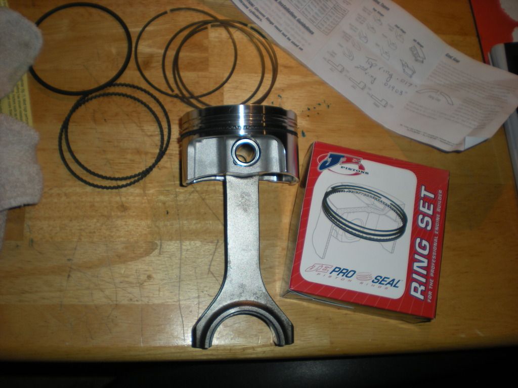

Yesterday I put the new pistons on the connecting rods.... those c-rings are a beeotch to get seated until you figure out a method. I'm going to go pick up a feeler gauge to ensure appropriate ring width.
theres no book on what to set the ring gaps to.. its based on experience an application.. This is where a machine shop comes into play.. Any machine shop should be able to get the bearings. they arent rare or anything,, hell even napa can get them.

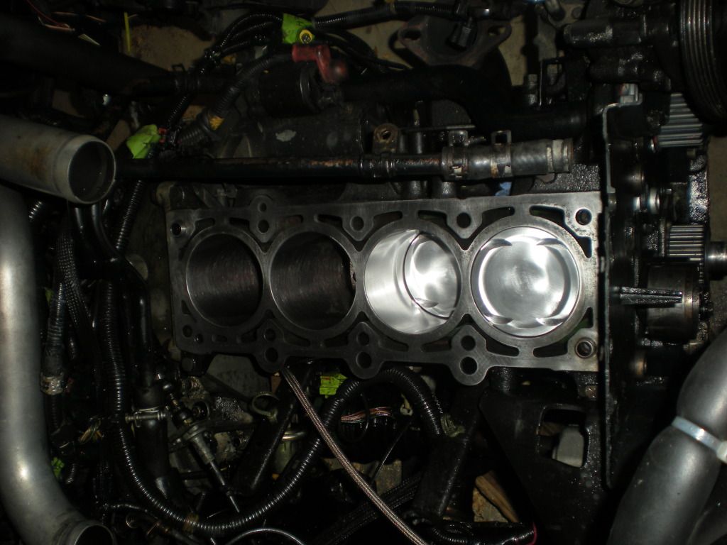

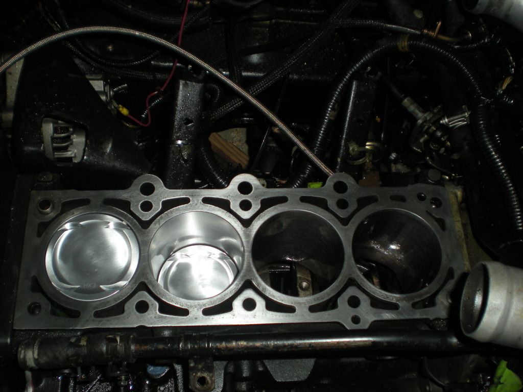

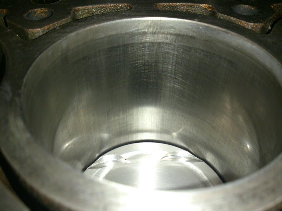

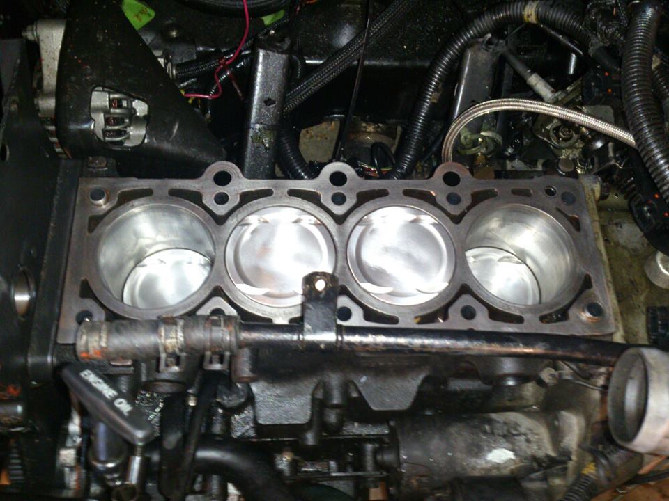

got three pistons in but, broke the 2nd compression ring on the fourth piston, waiting for my ring to come in from JE tomorrow then back on the build. Here are some pics up till now.
The cylinder walls are coated in red break in oil in case you are wondering and there is a minute amount of lint in there but that was all removed before pistons were installed.

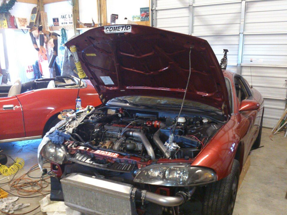

I finished my build today I have a lot of pics to post, it started right up first turn of the key!!!!
I finished my build, will be posting pics soon!!! Thank you everyone for the help and my stupid and pointless questions. My car started on the first turn of the key, I let it idle for 30 minutes... i'm going to change oil and oil filter again then put some easy miles on it
