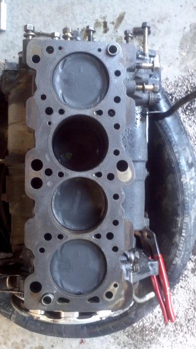

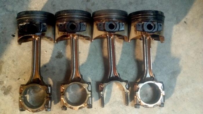

here is what the rod bearing looked like when i took it off piston 2 and the shards in the oil pan.:ohdamn::ohdamn:

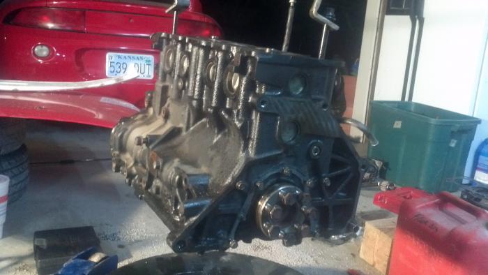

underside of the engine

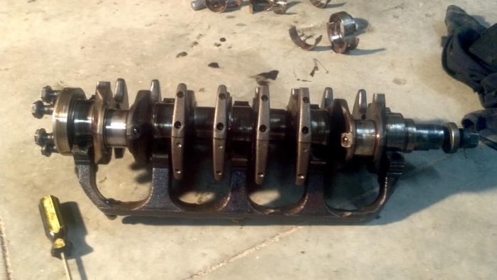

what do you guys think about the crank? think its good our is the picture not good enough to tell. i know it will need to be turned but think its worth rebuilding or just throw in a 6 bolt? :hmm:

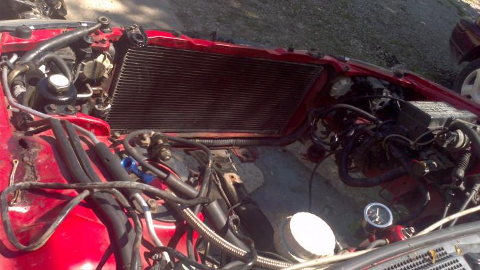

Then comes the First day of the tear down as of today starting with intake, radiator, wiring, axles.
thats all i got for day 1 of the tear down. comments and advice is more than welcome and wanted!!!! :thumb:

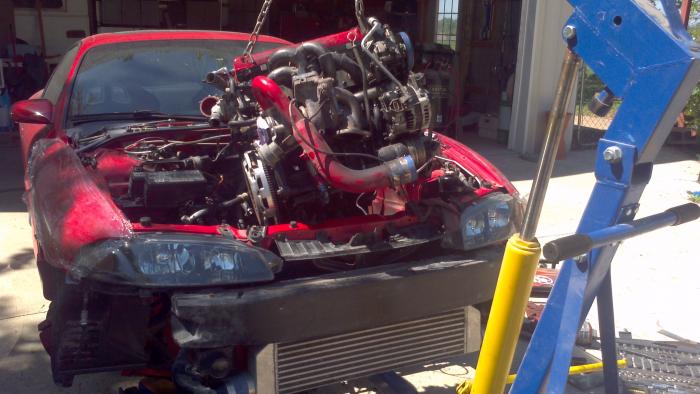

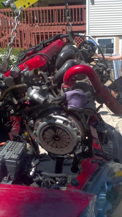

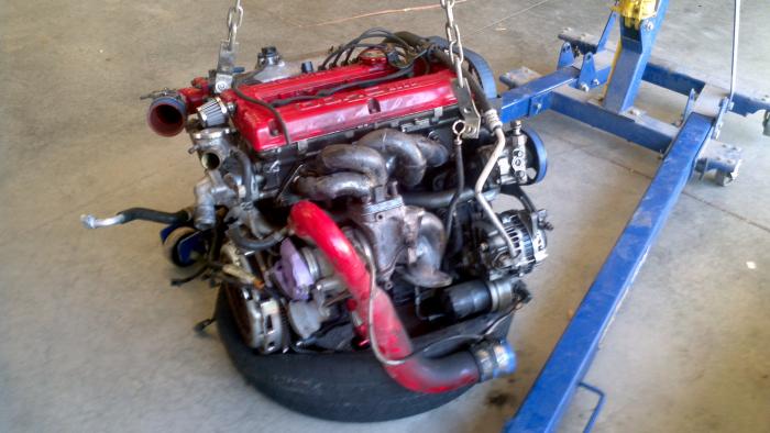

pulling the engine

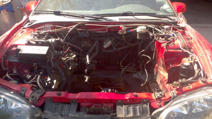

here is what my bay looks like empty haha

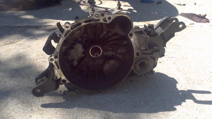

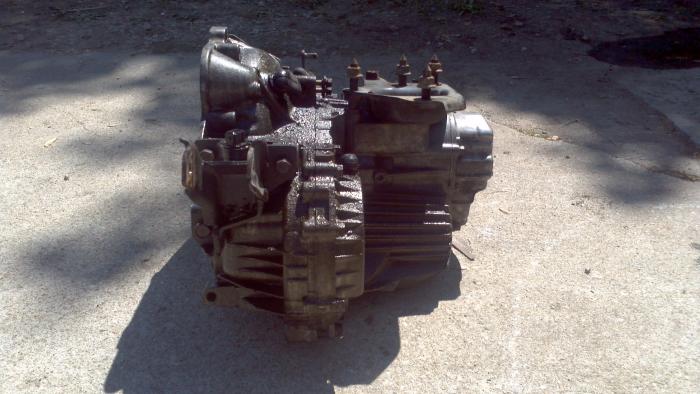

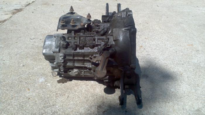

dirty little transmission haha :p

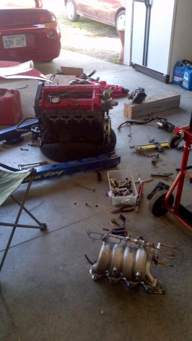

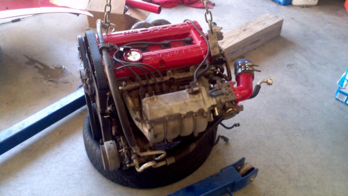

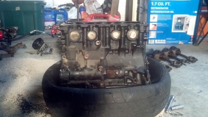

start of the tear down!!! :D but I dont have an engine stand :banghead:

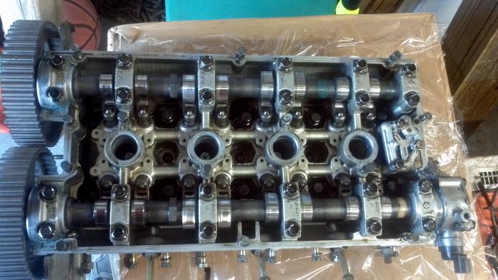

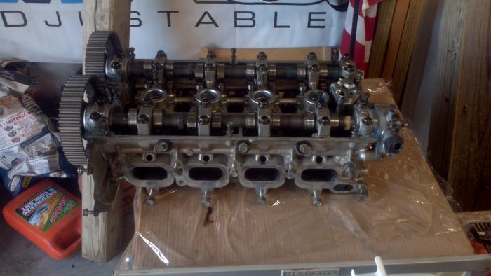

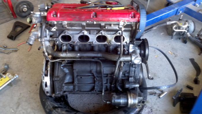

start by taking off the header and turbo, then manifold, to timing covers, then timing belt. F**K YES!!!!:hellyeah:

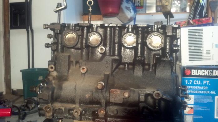

then here is finishing up with taking head off, girdle, crank, and finally pistons!!:pray:
day 2 clean up worked on the eclipse for 12 hours today!!! talk about dedication;). tell me what you think everyone!!
