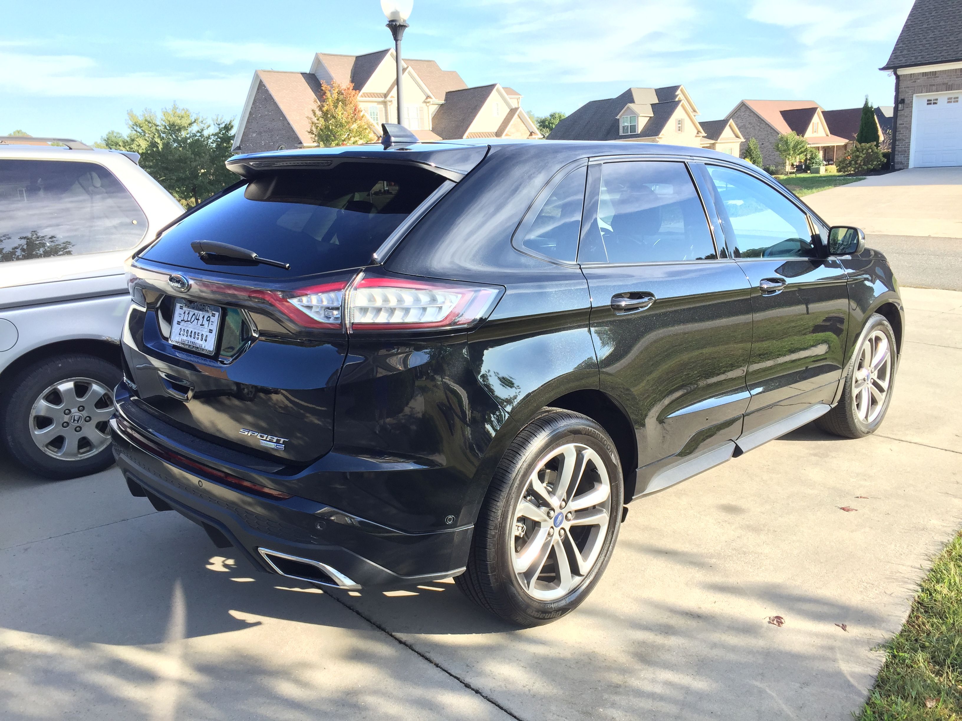

2015 Ford Edge Sport AWD
Just the beastly daily that sadly replaced my old eclipse. Has the same 2.7L TT engine that’s in the F150. Plan is to eventually get it tuned, drop in filter, and run 12’s. :)

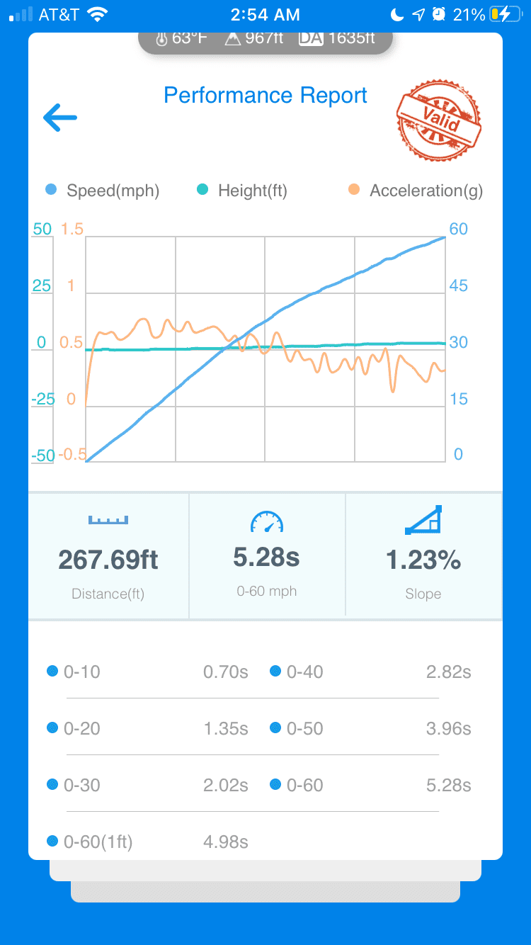

Recently got this heavy SOB tuned. I'm actually really happy with its performance considering it still gets 26mpg on the highway fully loaded and towing a tow dolly. The tuner comes with custom gas mileage and towing tunes too so I'm super happy. 0-60 in 4.8 seconds isn't exactly world-beating but it's enough to surprise a lot of other vehicles on the road. Also, ignore the slope % and all that. I have it mounted weird so it always throws the reading off.

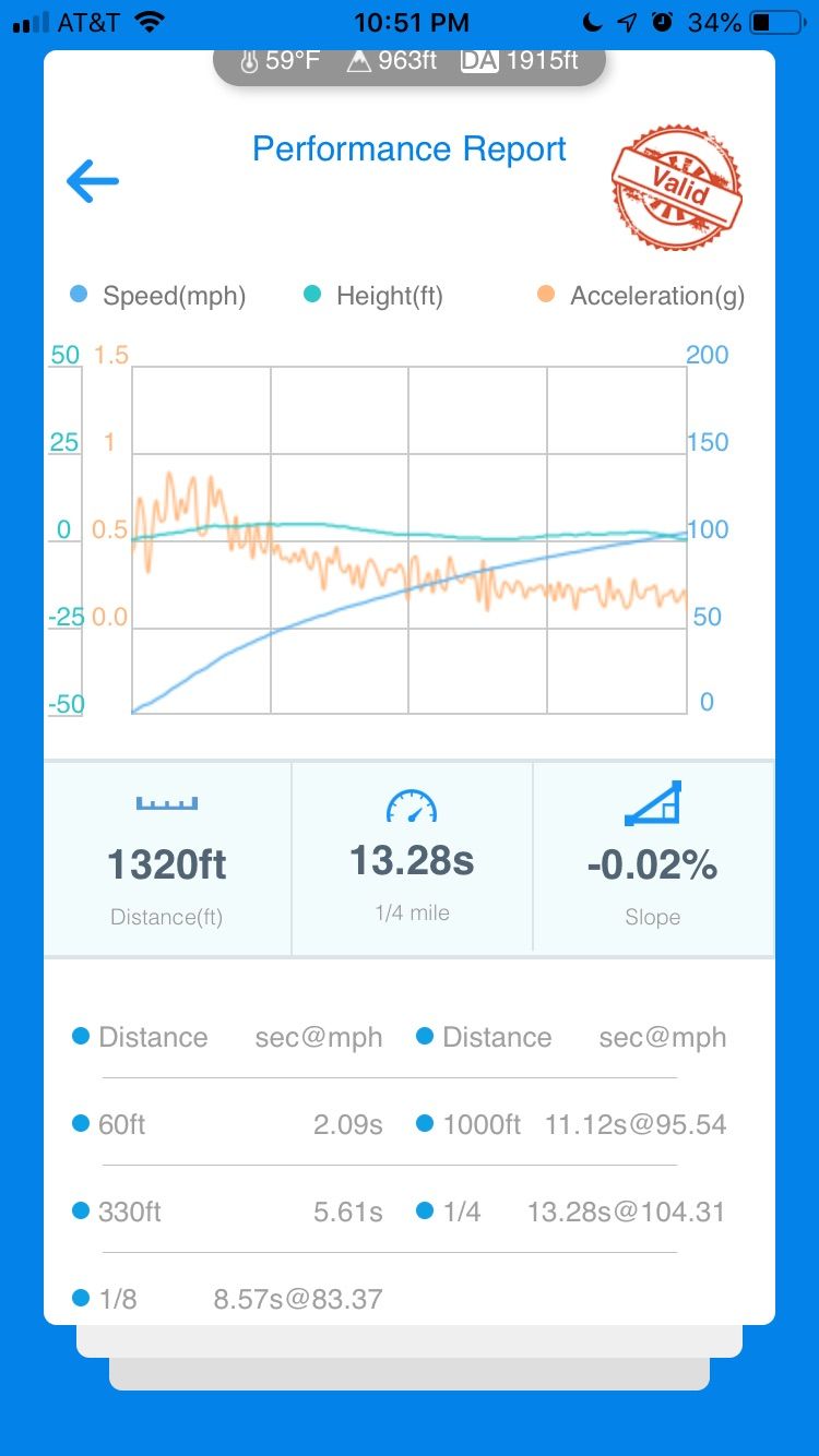

Back from the dead post to update this with a 1/4mi dragy run on 93.

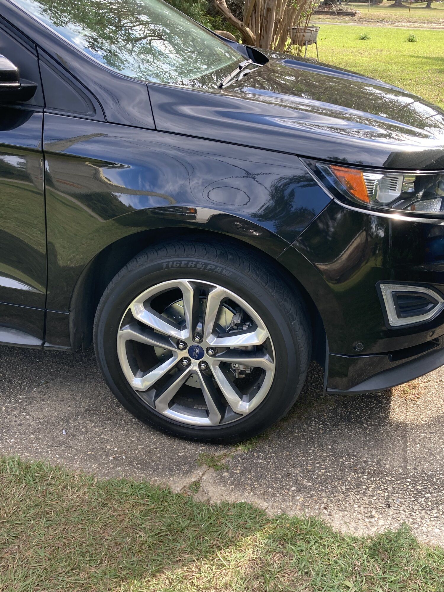

tigerpaw 245’s on all four corners aired down to 20psi and even on 93 it can’t get traction to save its life. On e30 it’s an awd burnout machine. 13.2’s on a very old unrevised tune and nothing else is awesome for this traction-challenged 4400lb family CUV.

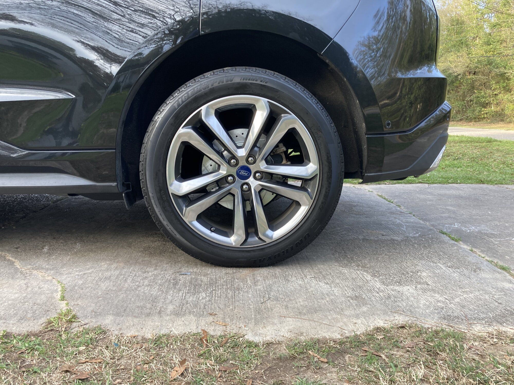

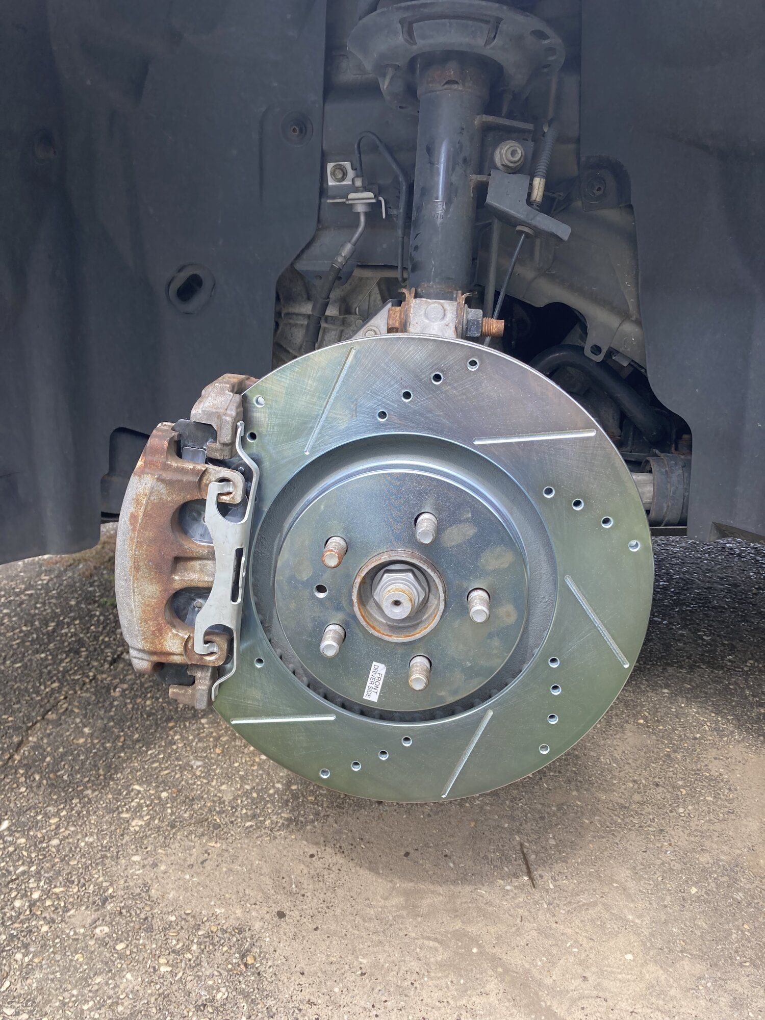

Front brakes needed changing(160+ MPH braking warps the stock 13.5” rotors. Just a random factoid ;) ) so I upgraded to the powerstop Z32 kit. I’m waiting on the rears too but I went ahead and threw on the fronts because they needed it bad.

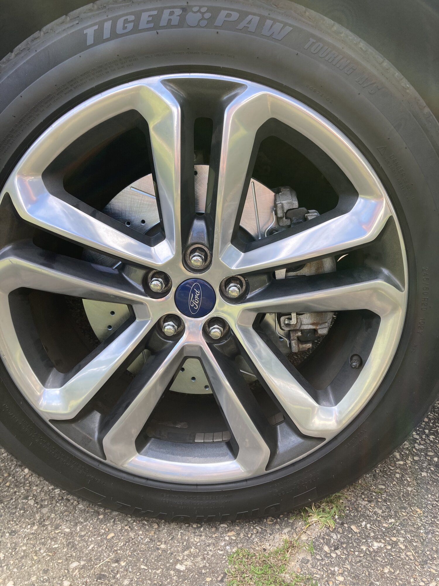

Just finished bedding them in and honestly I think it looks great. It definitely needs the calipers painted red asap though.

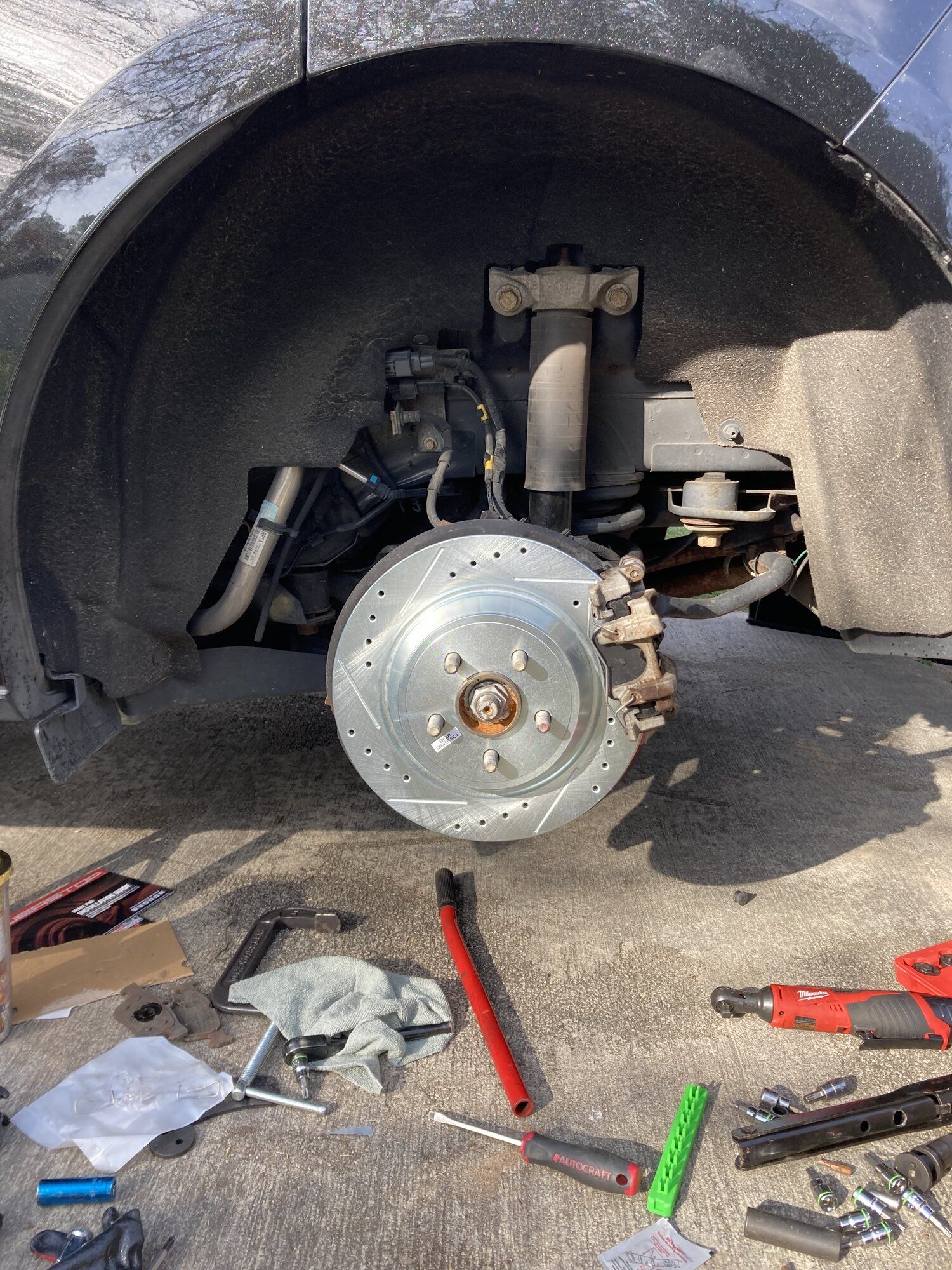

On God I f**king love working on this vehicle. Ford did legit everything they could to make this car easy to work on. The Edge uses the same style of rear ebrake as the 1G DSMs do(threaded piston) and not drums on the inside of the disk. I was dreading this, but ford is so amazing they thought of something.
1) you put the rear ebrake system into maintenance mode before doing any kind of work.
2) what this does is thread the ebrake rod all the way closed so the piston? Can be literally pushed in by HAND to compress the brake piston fully. Legit by hand. I heart this god d*mned heavy grandma suv beast.
I did all this in like 30 mins - 45 mins total elapsed time including eating in the middle of it, and jacking/lowering the vehicle. Seriously.
But yeah. I think it was definitely time for rear brakes. Lol.

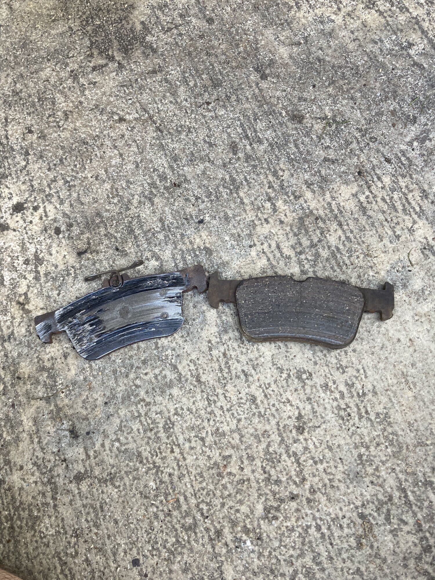

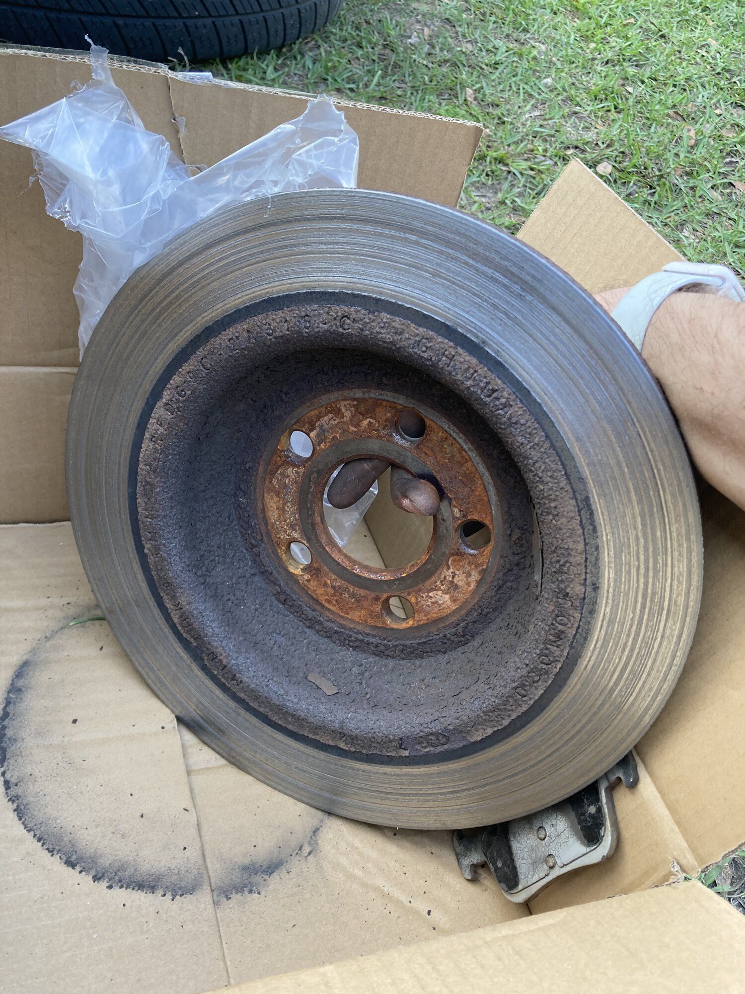

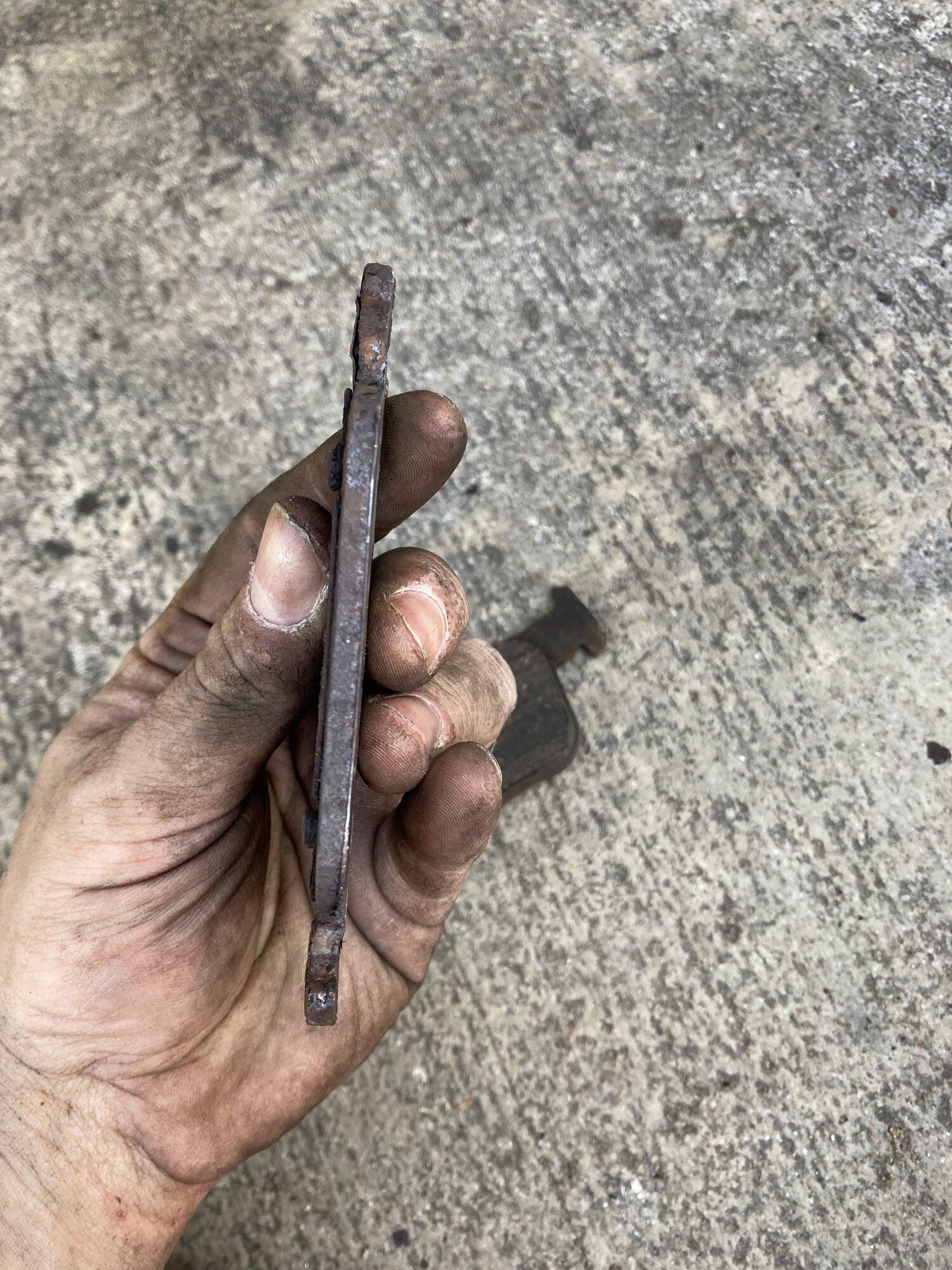

The passenger side rear(pictured) had like no grease left on the slide pins so it got stuck in that position. That’s why it’s unevenly worn.
Aaaand all done! God it looks good.
I didn’t paint the calipers because the paint takes like a day to dry and 7 days to fully cure and I need to bed the rear brakes in asap(plus it’s back on 93 octane tune so I wanna do some 12.9’s on these tigerpaw baldies. Lol). But yeah. If I could adapt these brakes to a dsm I swear I would. It wouldn’t be hard. Just find a rheostat that will work with the motors on the ebrake portion of the caliper and the OEM ebrake would work as normal but with no cable. And they’re like 11” rotors or something massive.
