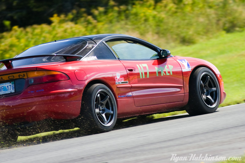

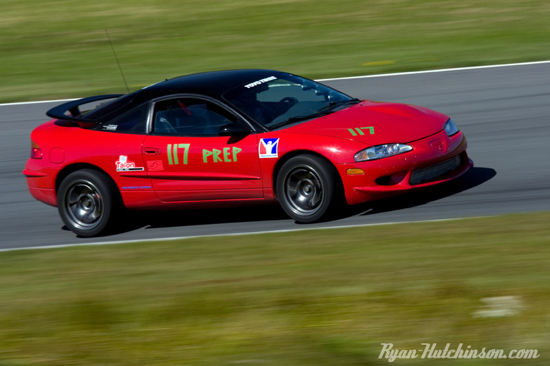

Here are some photos of the Talon at the event:
