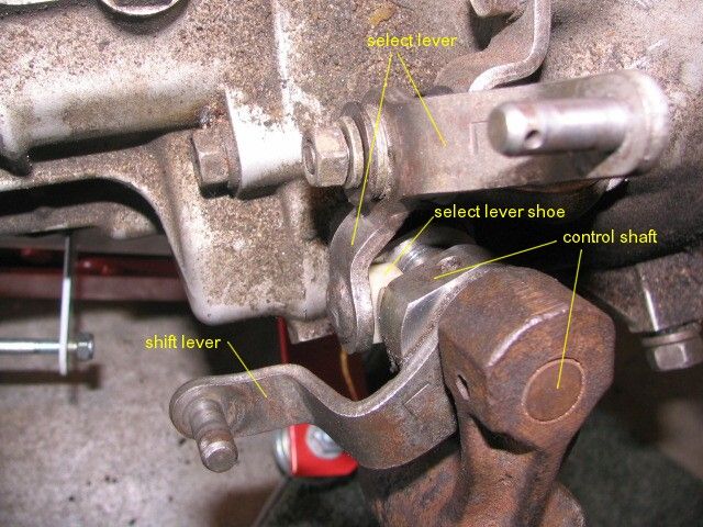

Ok I'll try and find it and see if it's there and the condition it's in. Thanks
I looked for the shoe but never really found it. I did notice the the gear shifter in the car the bushings seemed to have a lot of play. Is there. Rebuild kit for it? And also if I take all the cables off the trans how would I get it into 1st and 2nd gear manly? I haven't been able to figure out the right combo yet

I got all new bushing for the shift and still no luck. I guess next I'll take the select level shoe off and measure it. When I'm in the car and watching the shift cables the select lever cable will move backwards and the middle position but it doesn't wanna move forward.

I can pull up on the shift linkage at the trans but can't get it to push down. Am I suppose to be able to push down on it

So I took the select lever bracket off and was able to push down the shifter and get into 1 and 2 gear so the problems is in the bracket
There is a little white rectangle piece that's on the lever and I'm wondering if it is suppose to sit a certain way. It got dark before I could mess with it. I'm use to working on trucks these little cars are different for me
I got it fixed. To fix it I unhooked the select lever cable and made sure the shifter in car was in neutral. The cable was about 1/4" longer than the stud on the select lever so I adjusted it and it fixed it. But now I got a new problem with injectors
