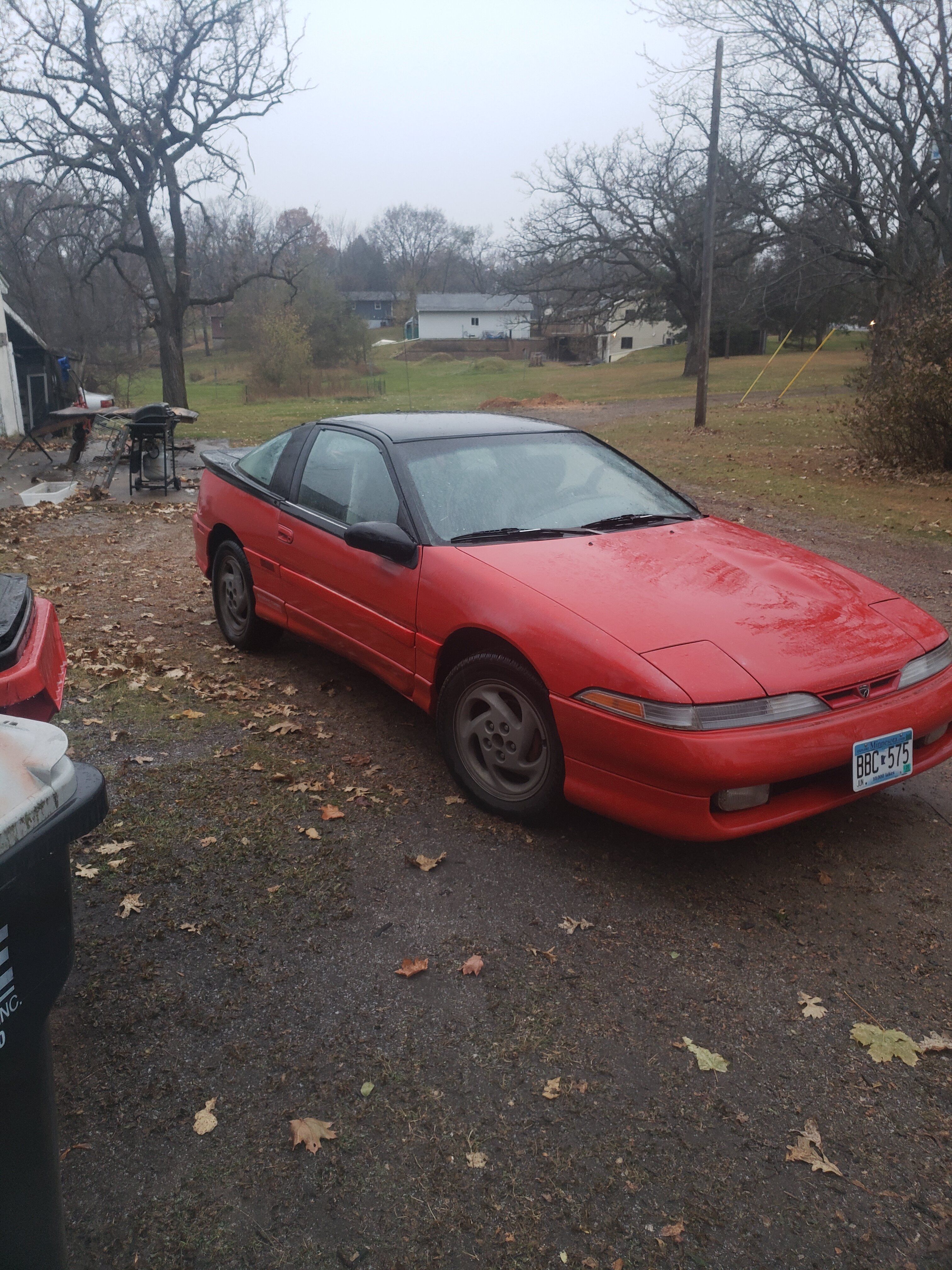

Purchased Nov, 2019 with exactly 125,000 miles when I got back to my house after purchasing it off a Craigslist add from Wisconsin For $3,5k. As far as I could tell, bone stock.
Had a few issues,

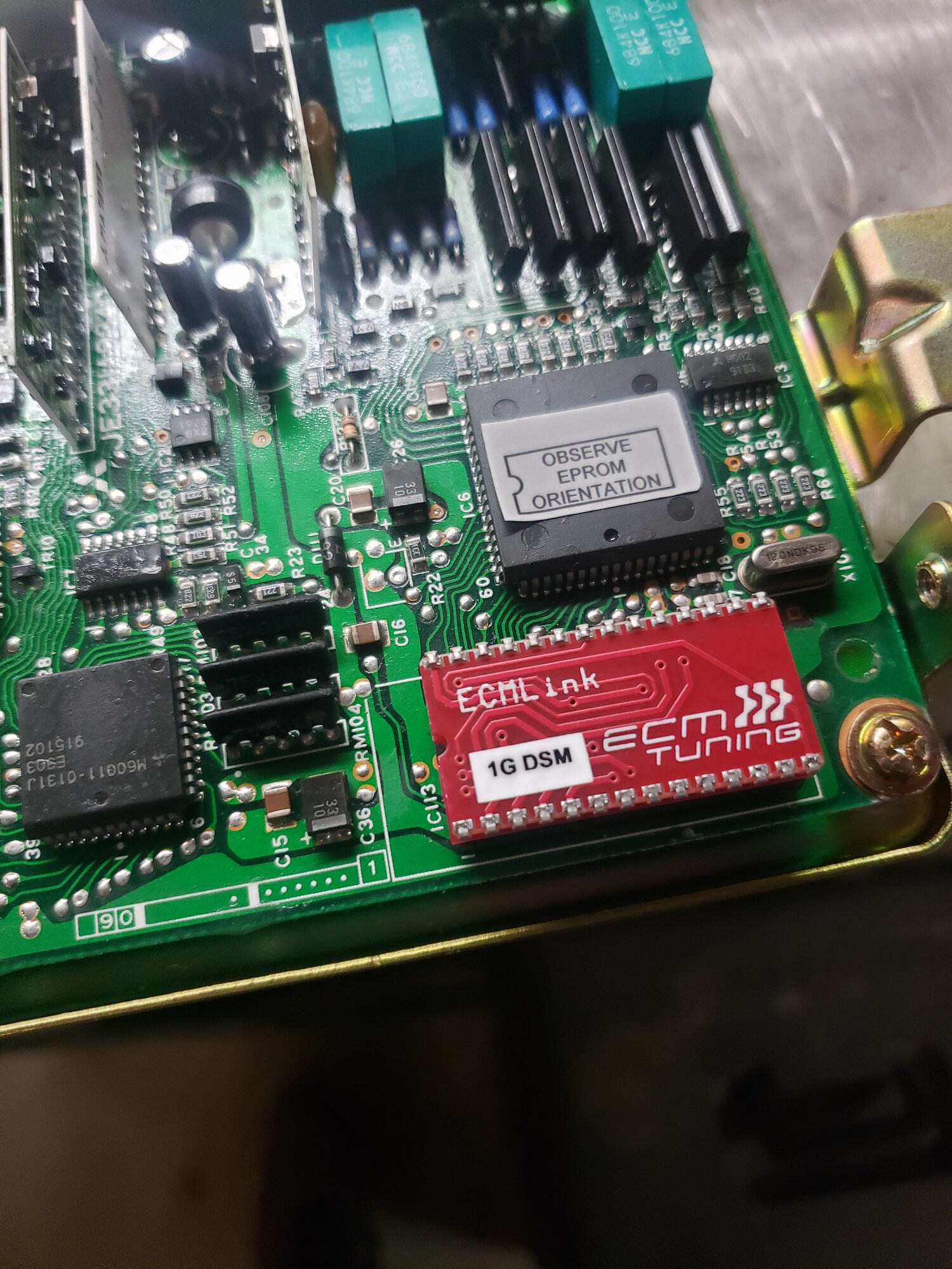

April 2020, installed DSMLink. ECU was sent to ECMtuning by previous owner to get capacitors replaced (supposedly, looked good to me). Installed Deutchworks 255lph, 850cc injectors and a fuel labs AFPR. Stayed MAF for now.

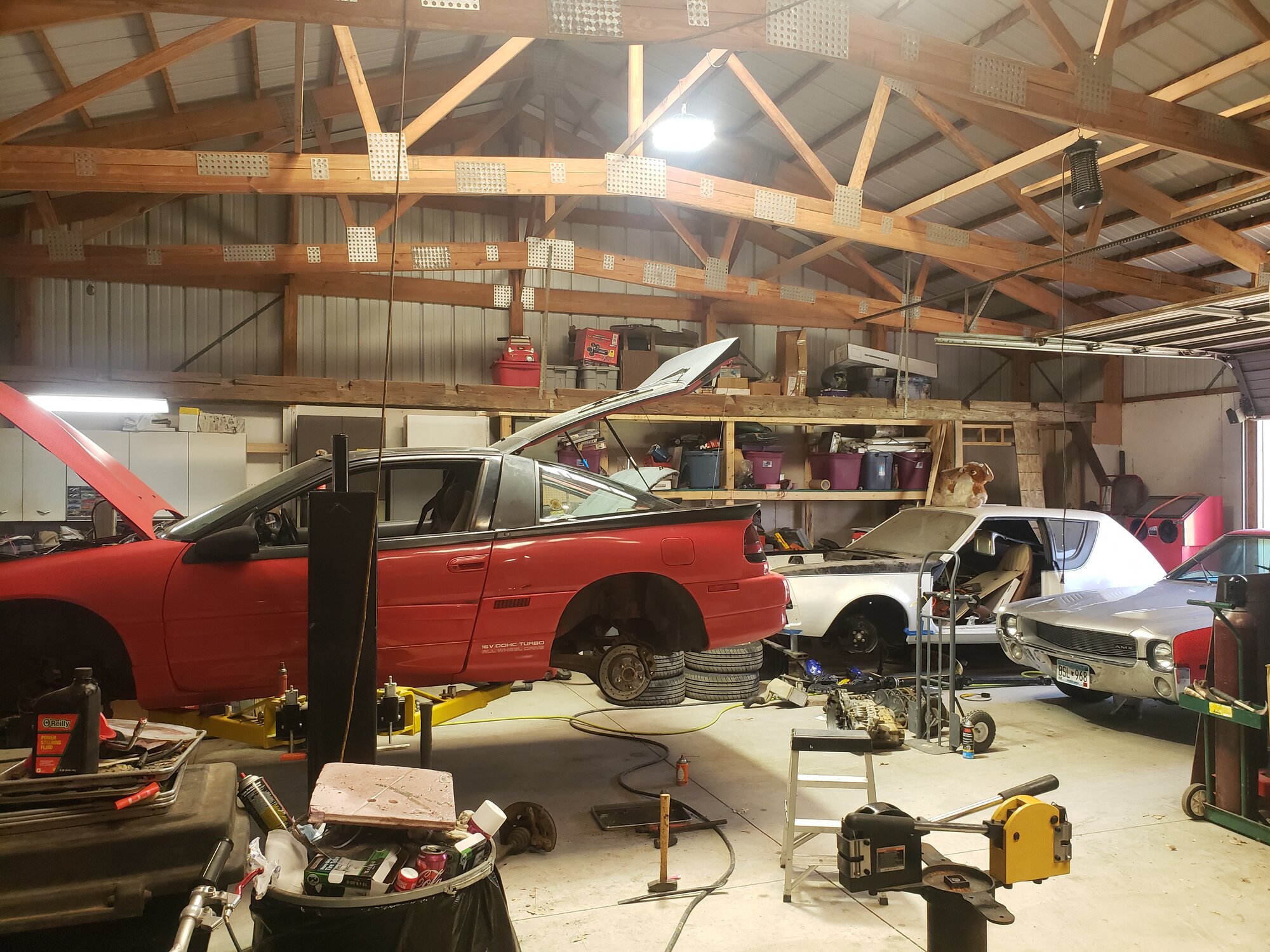

September 2020,

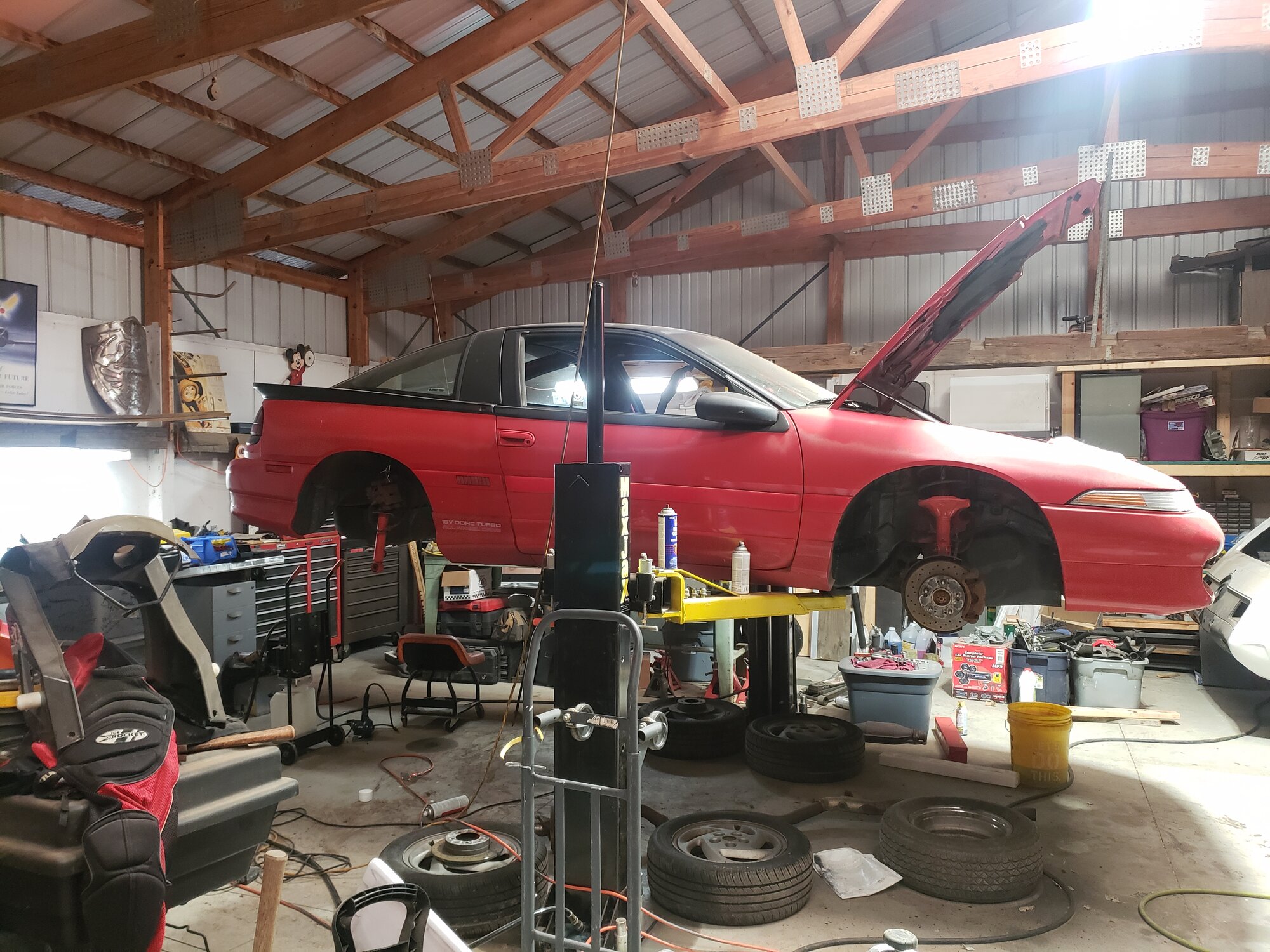

Pulled rear suspension to refresh/rebuild. Also rebuilt driveshaft, Installed solid carrier bearing mounting bushings. Installed KYB adjustable struts on all 4 corners. Also replaced noisy rear center section with an even noisier B1H center section with LSD.

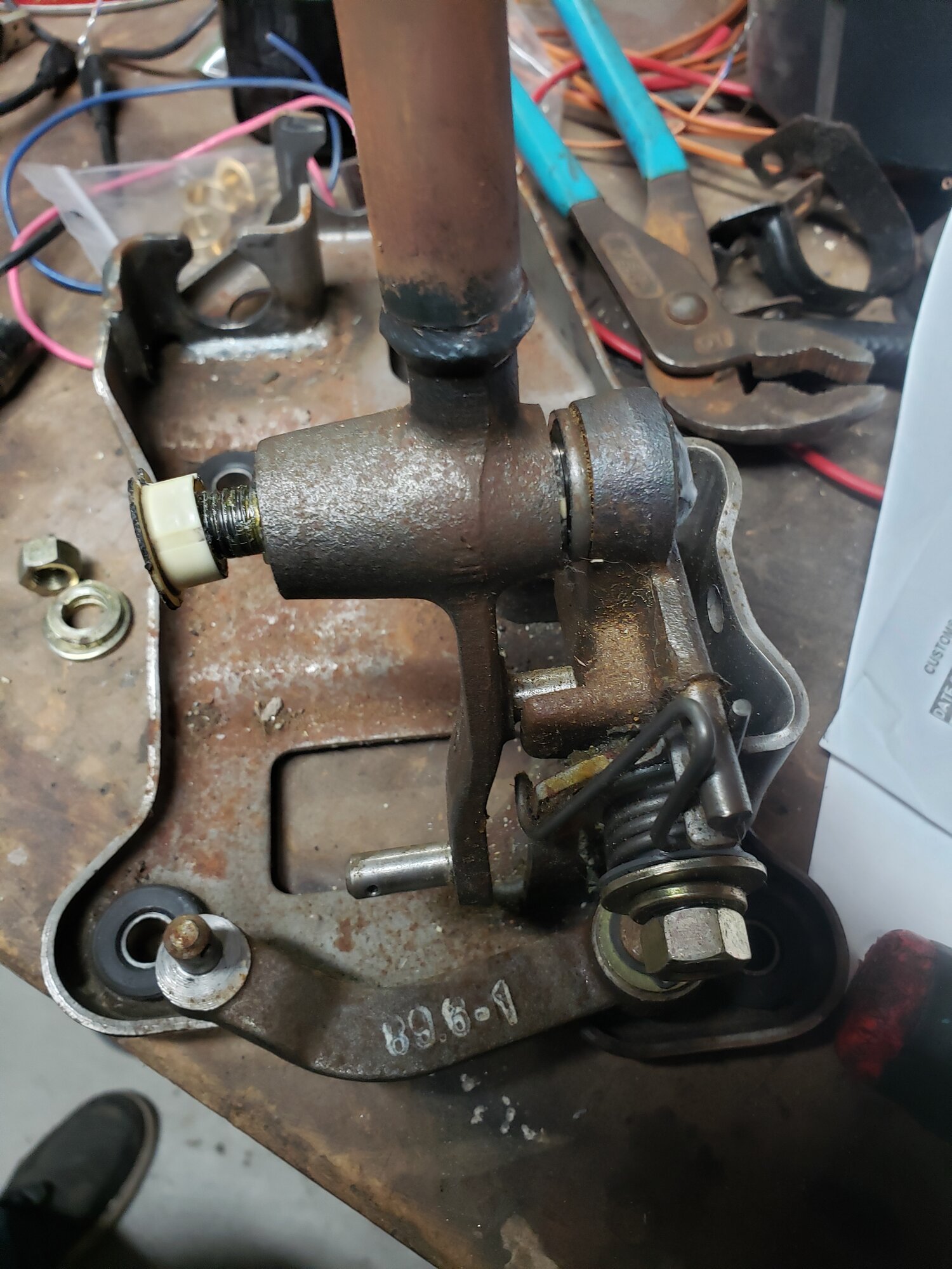

Rebuilt shifter. (Only picture is pre-rebuild unfortunately. Will grab one next time center console is removed.) Used a rebuild kit with brass bushings. No more slop, nice shifter feel.

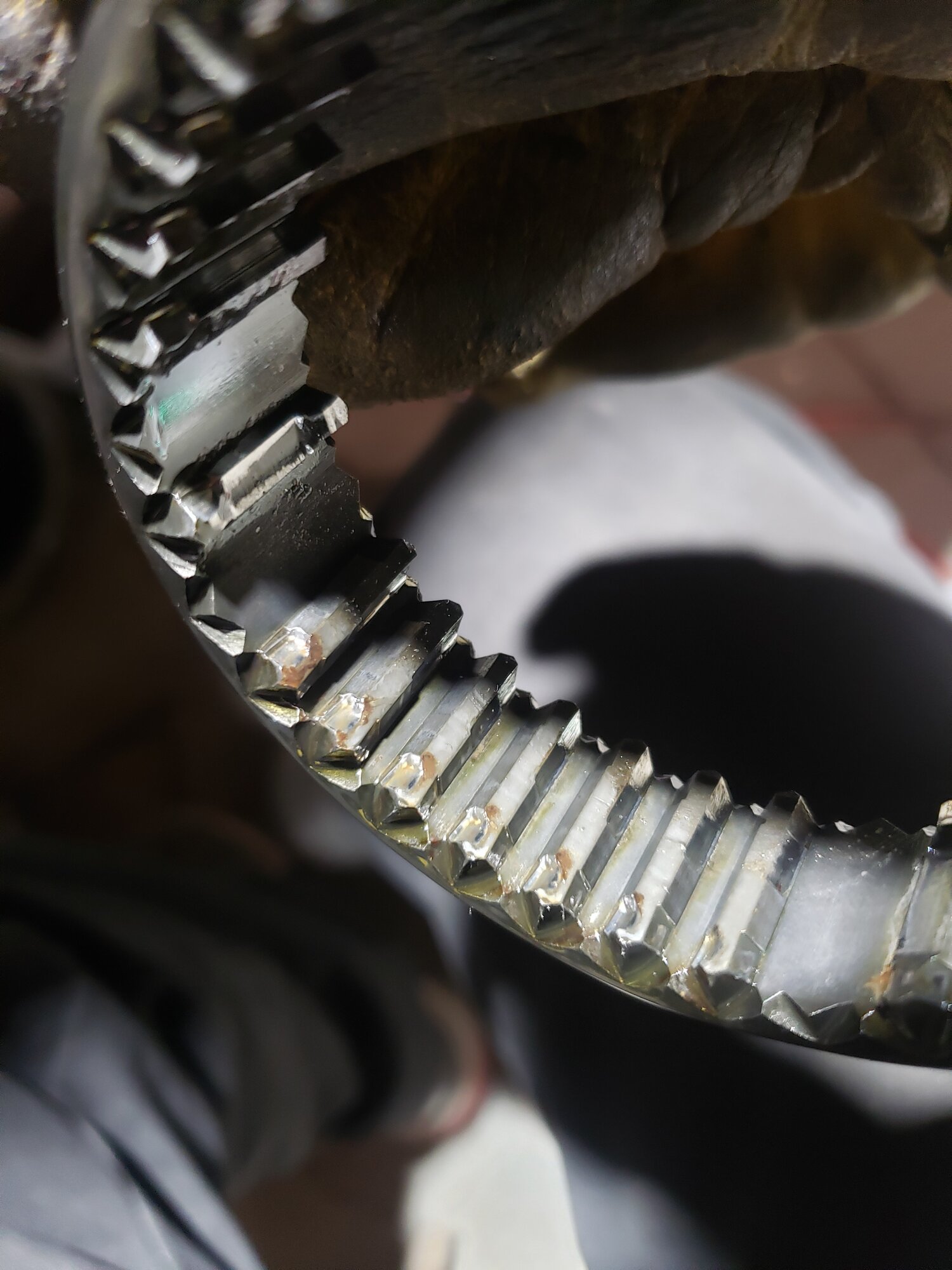

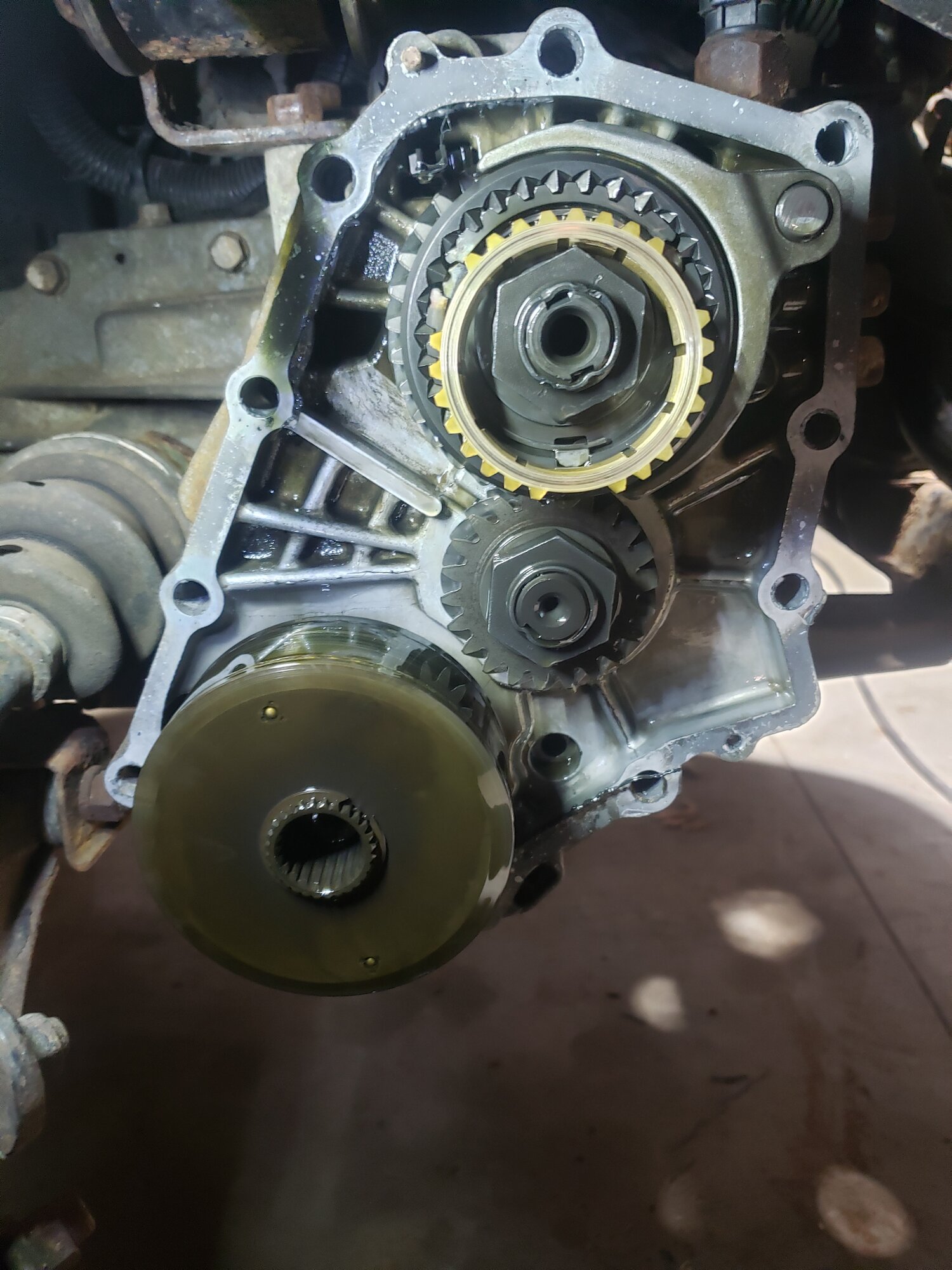

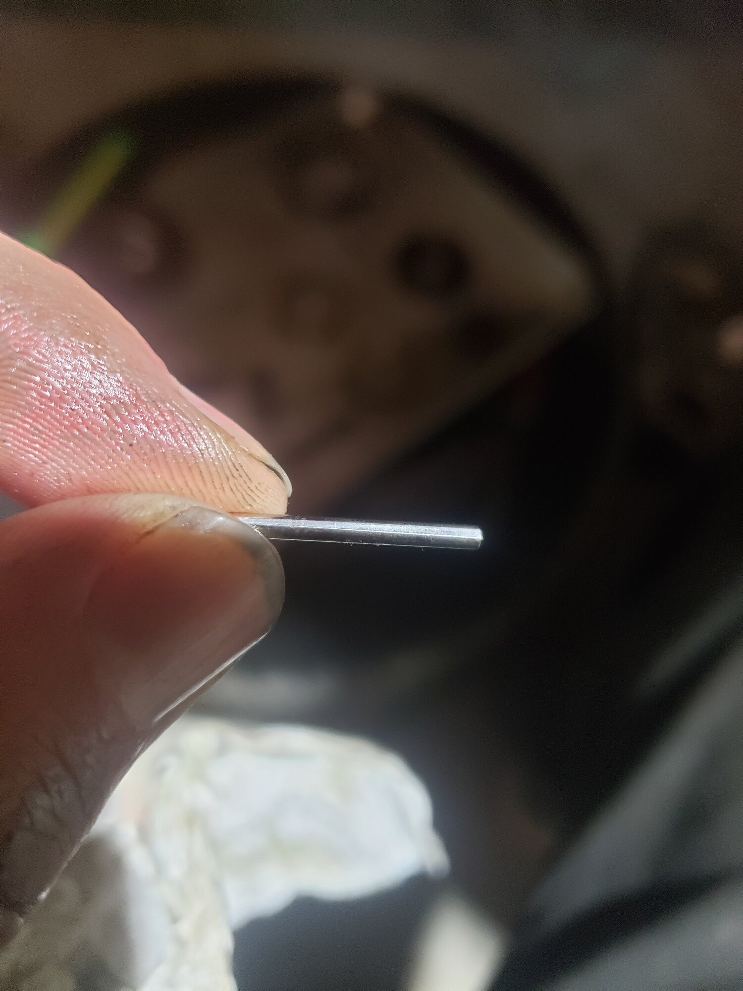

Started to get a entire car shake at ~65mph while in 5th gear only. With discussion from this forum I was led to remove the end cover off the transmission and inspect everything. Found out that the needle bearings for 5th gear had flat spotted. Replaced and all is good with 5th. 5th gear synchros on the other hand...

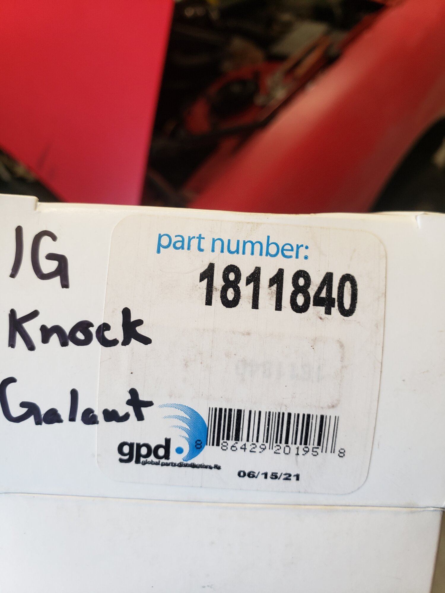

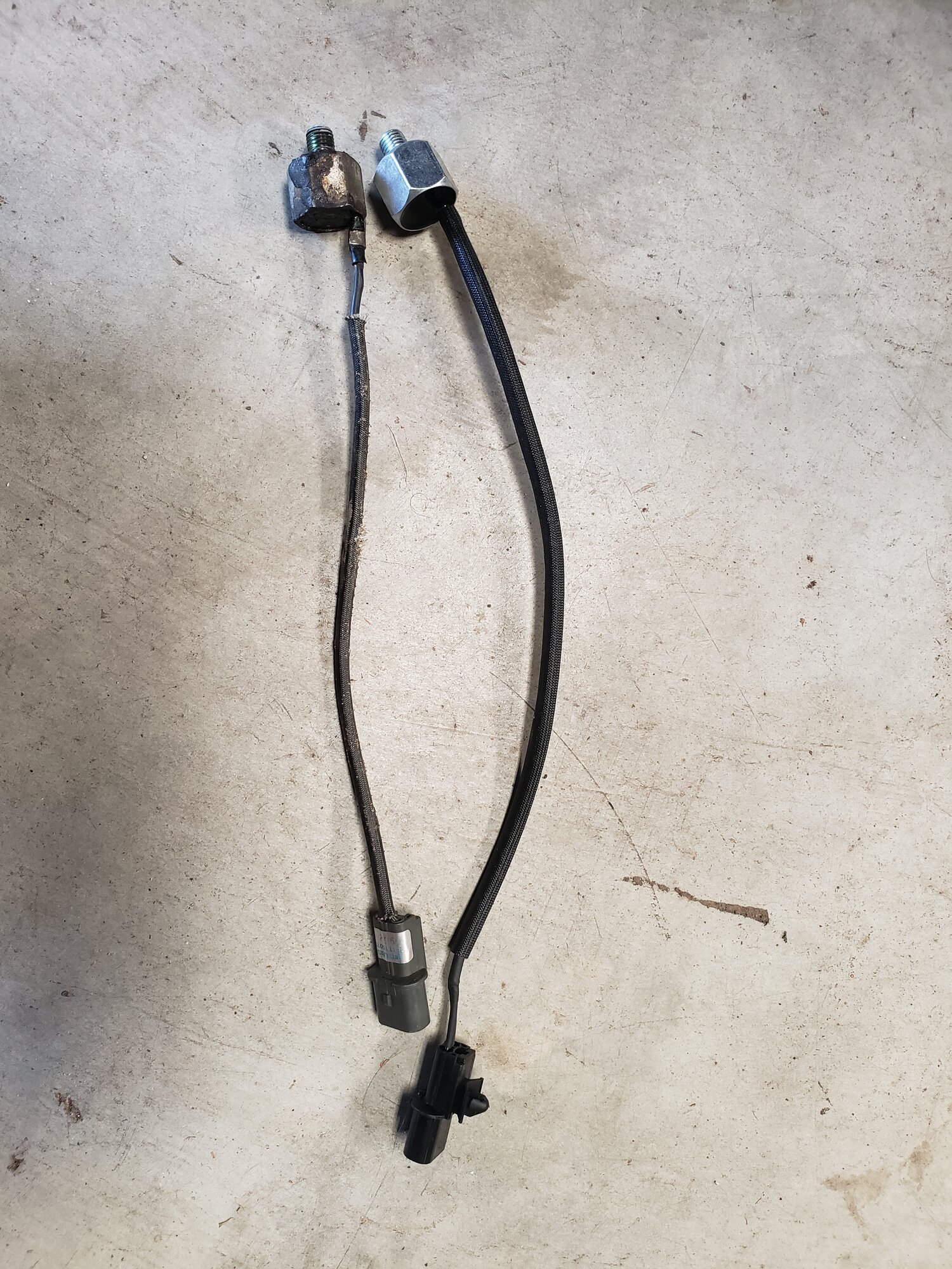

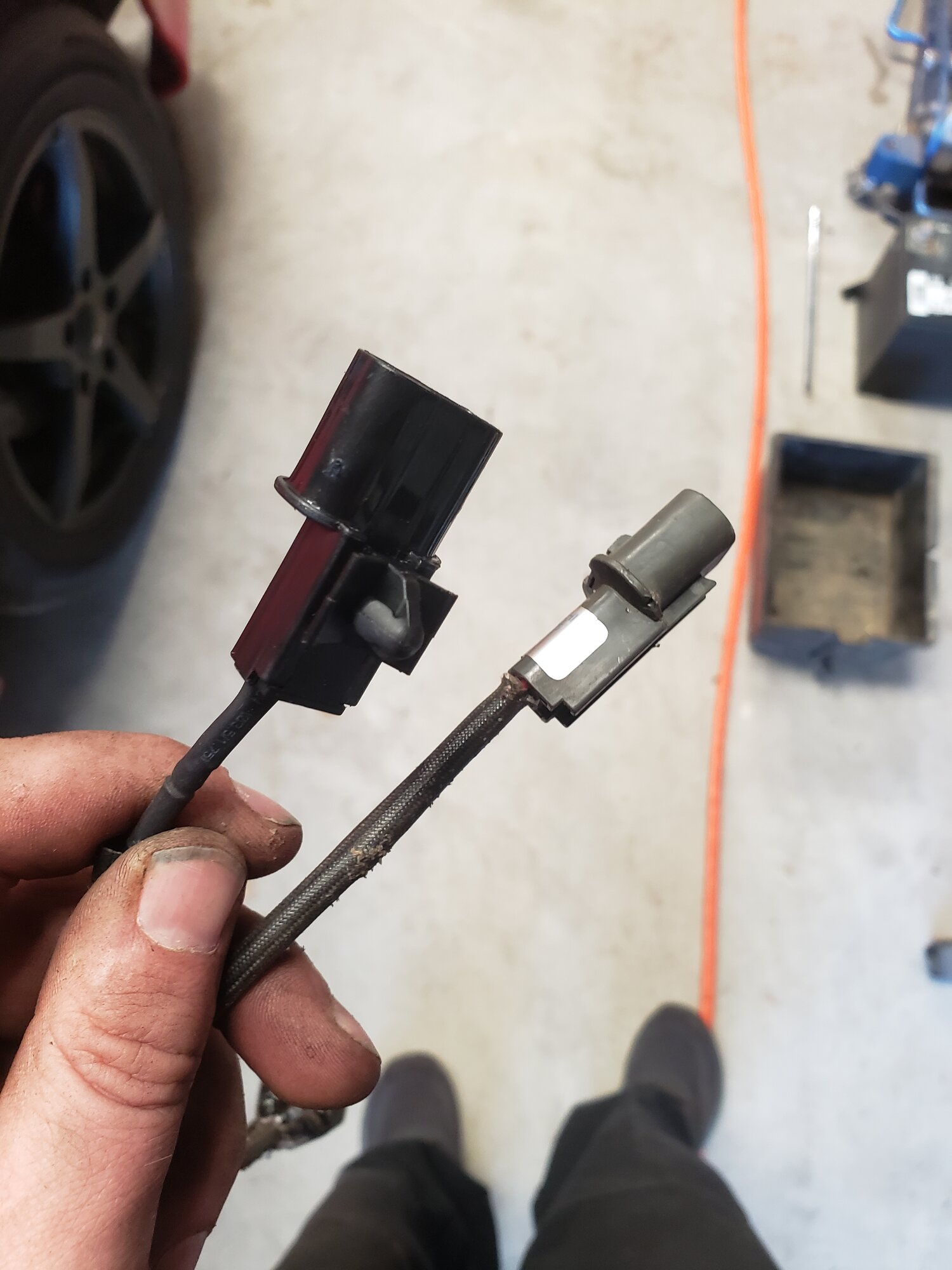

Replaced knock sensor looking into phantom knock issues. Stock one was gooey so replaced with one from same year Galant. The lead is slightly shorter and the connector had a tab that needed to be cut off. No issues so far.

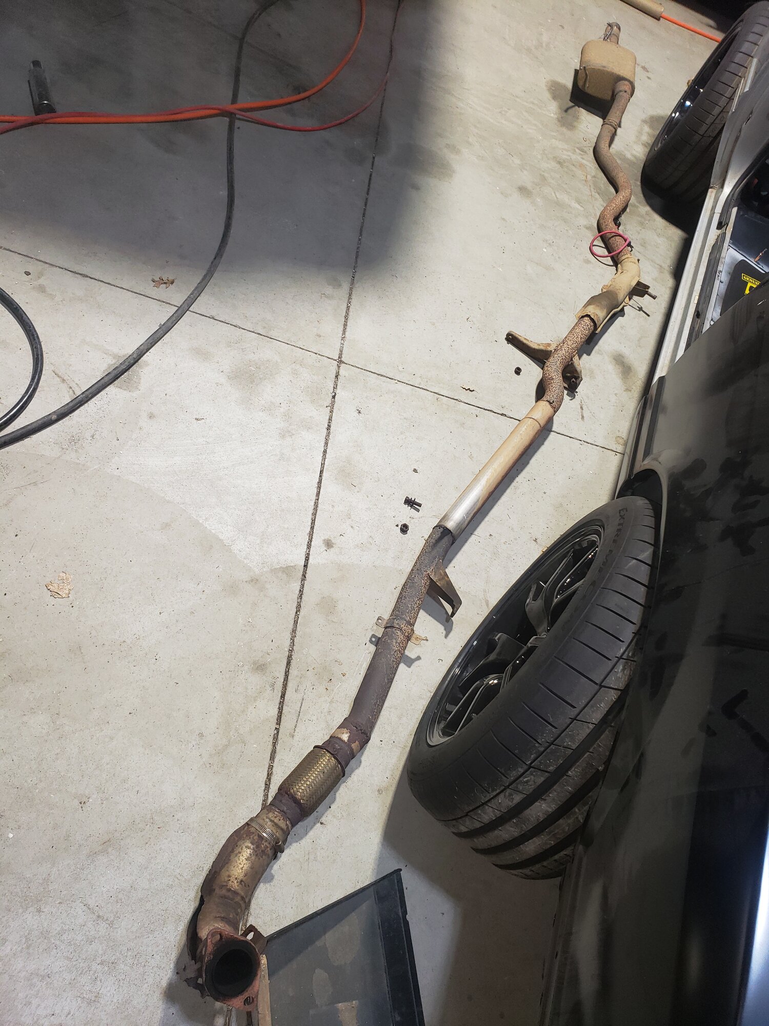

Old exhaust:
Cat delete done be myself previously. Insides had broken and rattled.

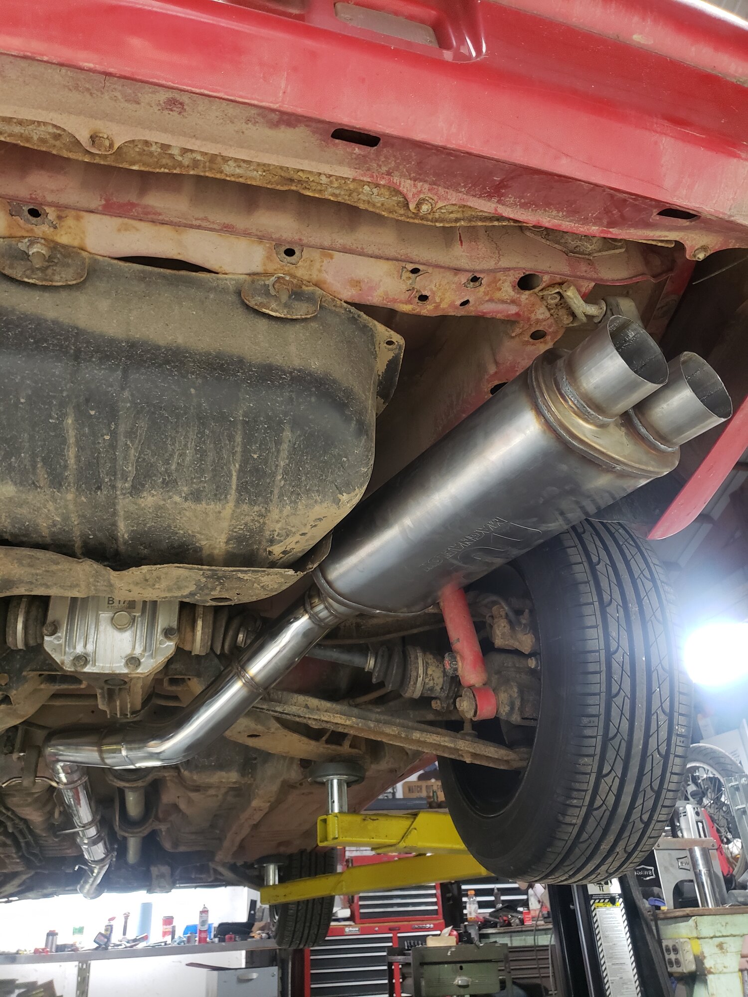

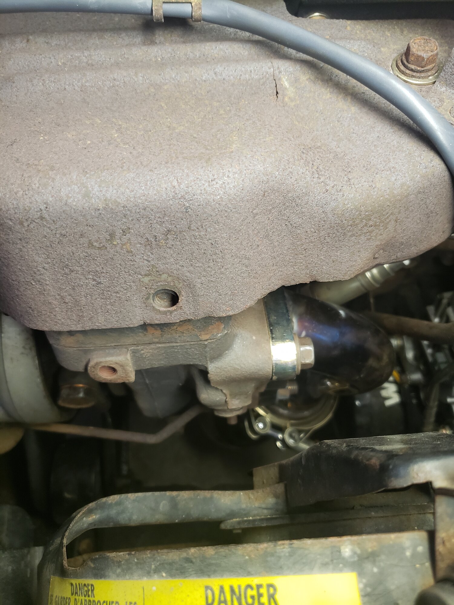

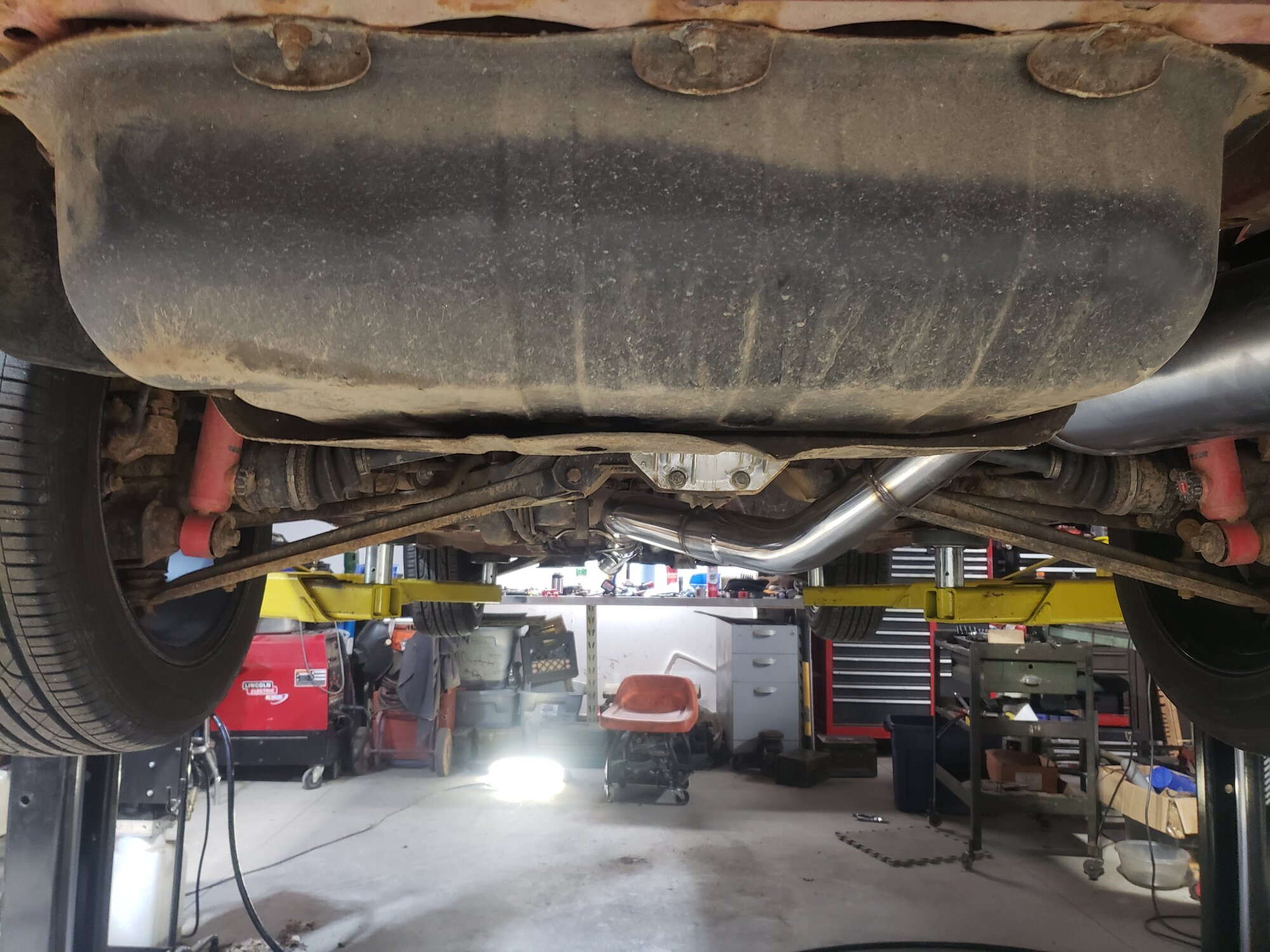

New, Stainless turbo back. O2 housing and down pipe were from RTM racing, Modified to have a V-band connection. Initially was a flange connection, but it did not line up anyways. Magnaflow 3" 1 into 2. Have since installed the tips to extend past bumper.

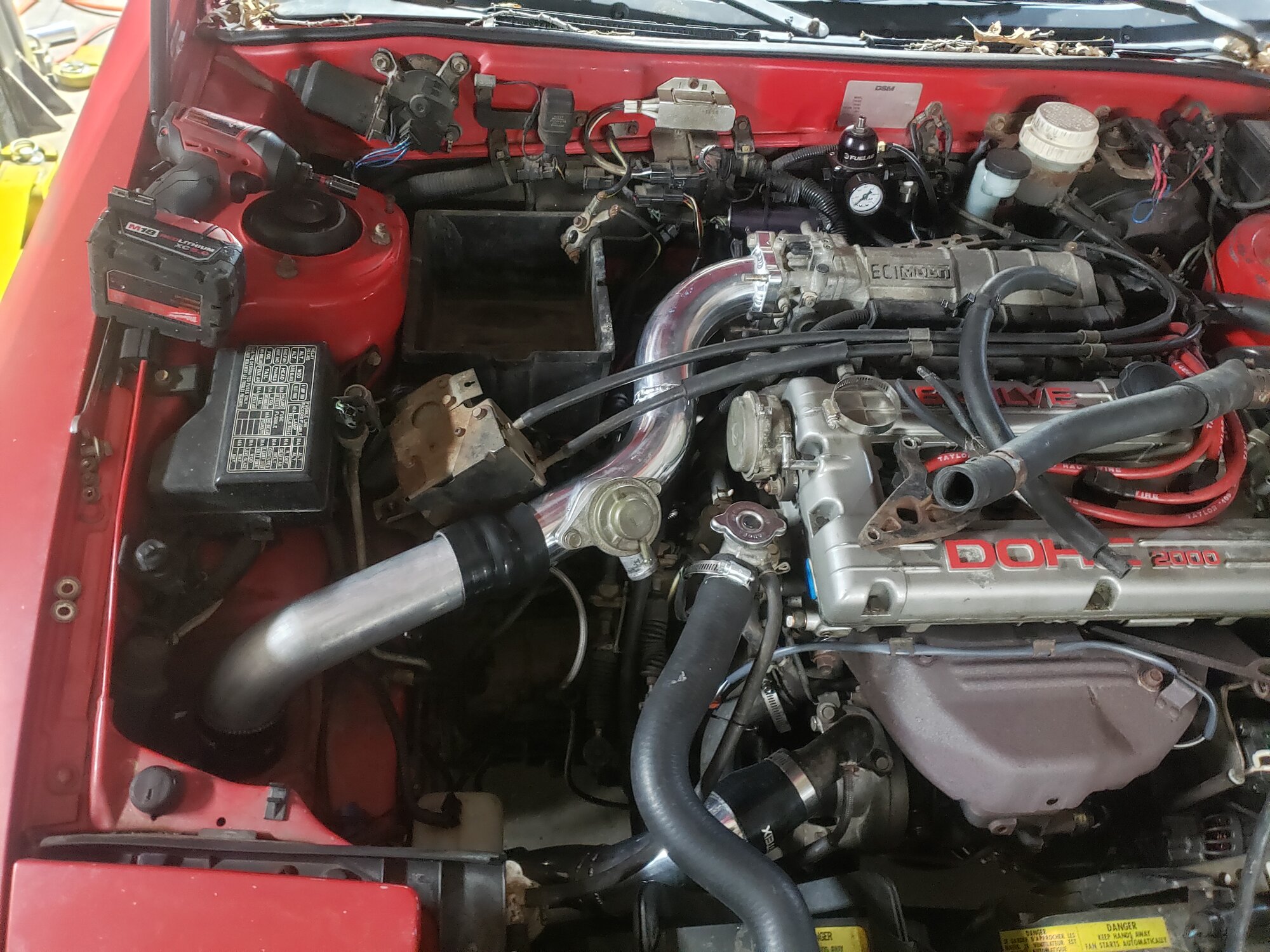

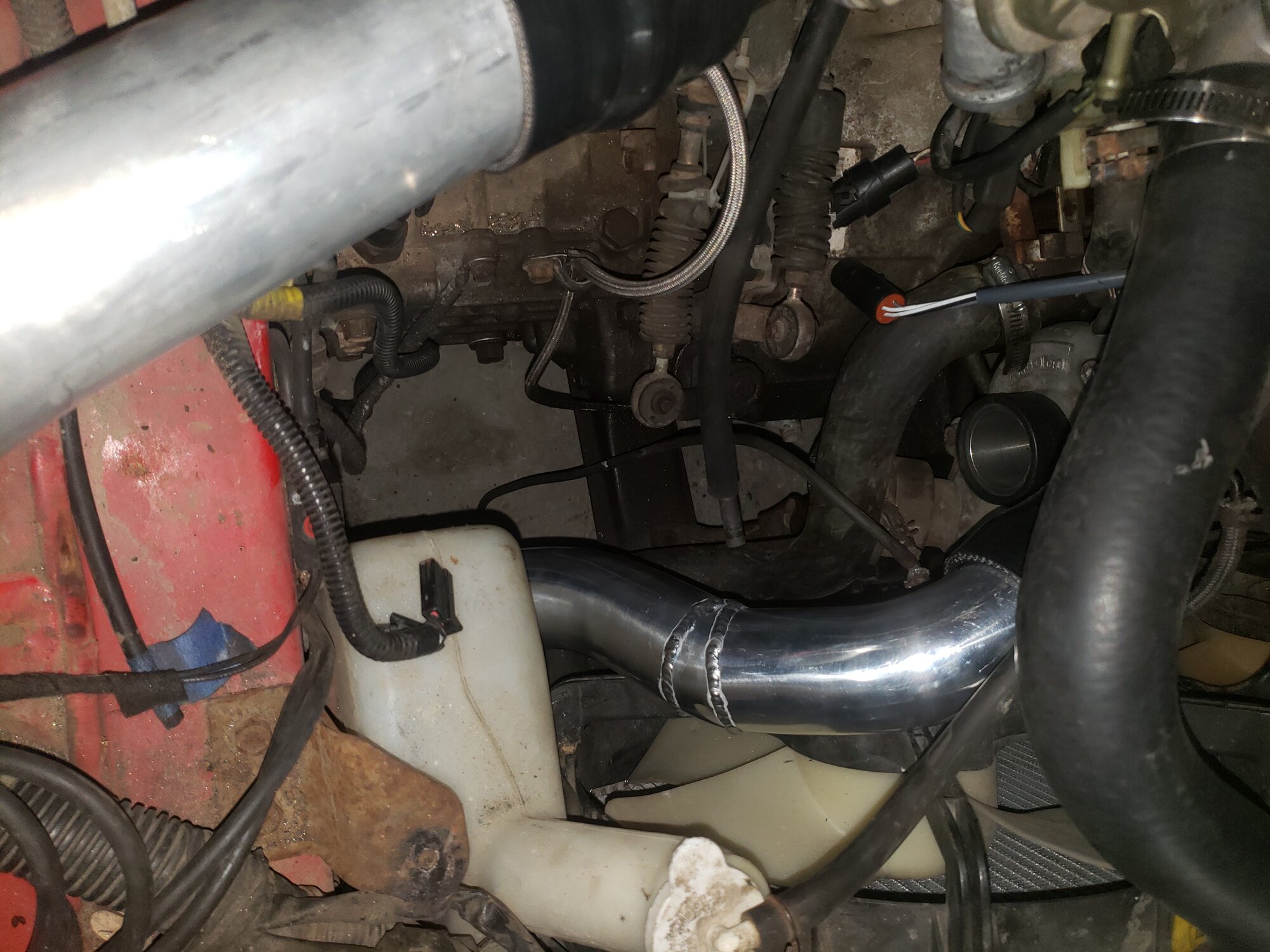

Same time I changed all the charge piping to Aluminum 2.5"? tubing and silicone couplers. I also changed the side mount intercooler in/ex pipe sizes to 2.5". Easier to remove and weld new ones on vs buy reducing couplers. Still need to remove and powder coat these. Along with the valve cover. someday...
Changed over to speed density at this time and installed a MAC valve for boost control through ECMLink.

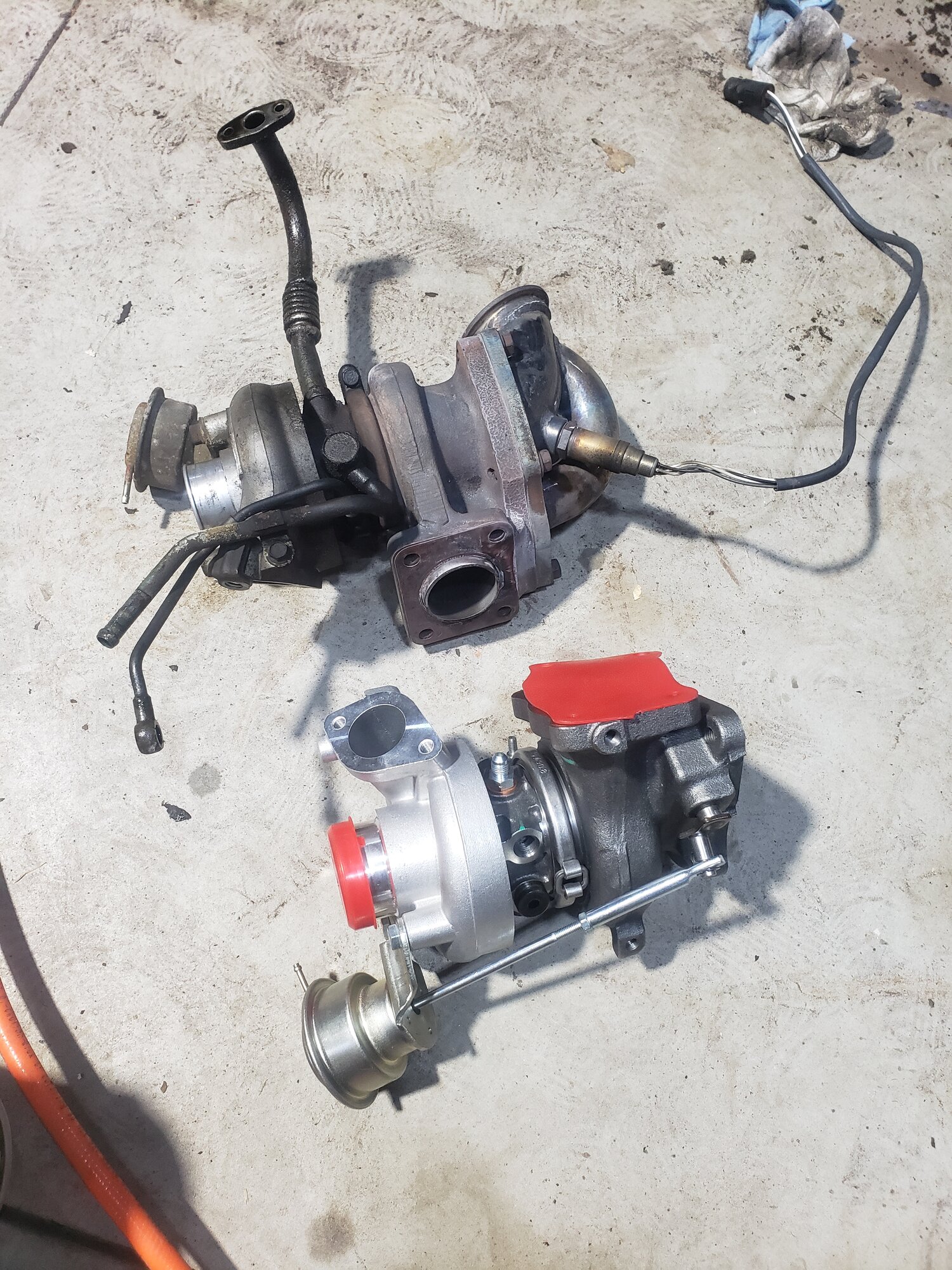

Stock turbo quit wanting to spin, so replaced with a 16g from RTM.

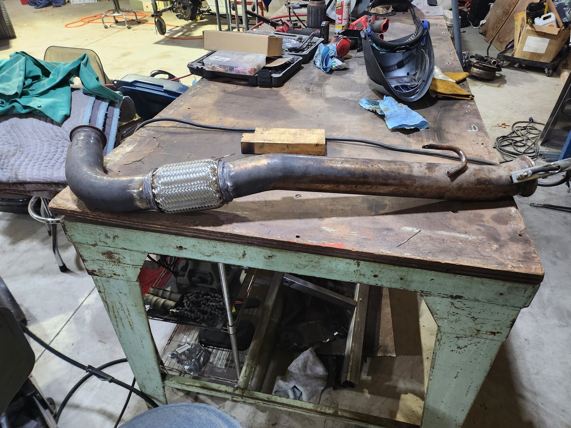

Replace flex pipe on downpipe due to leaking.

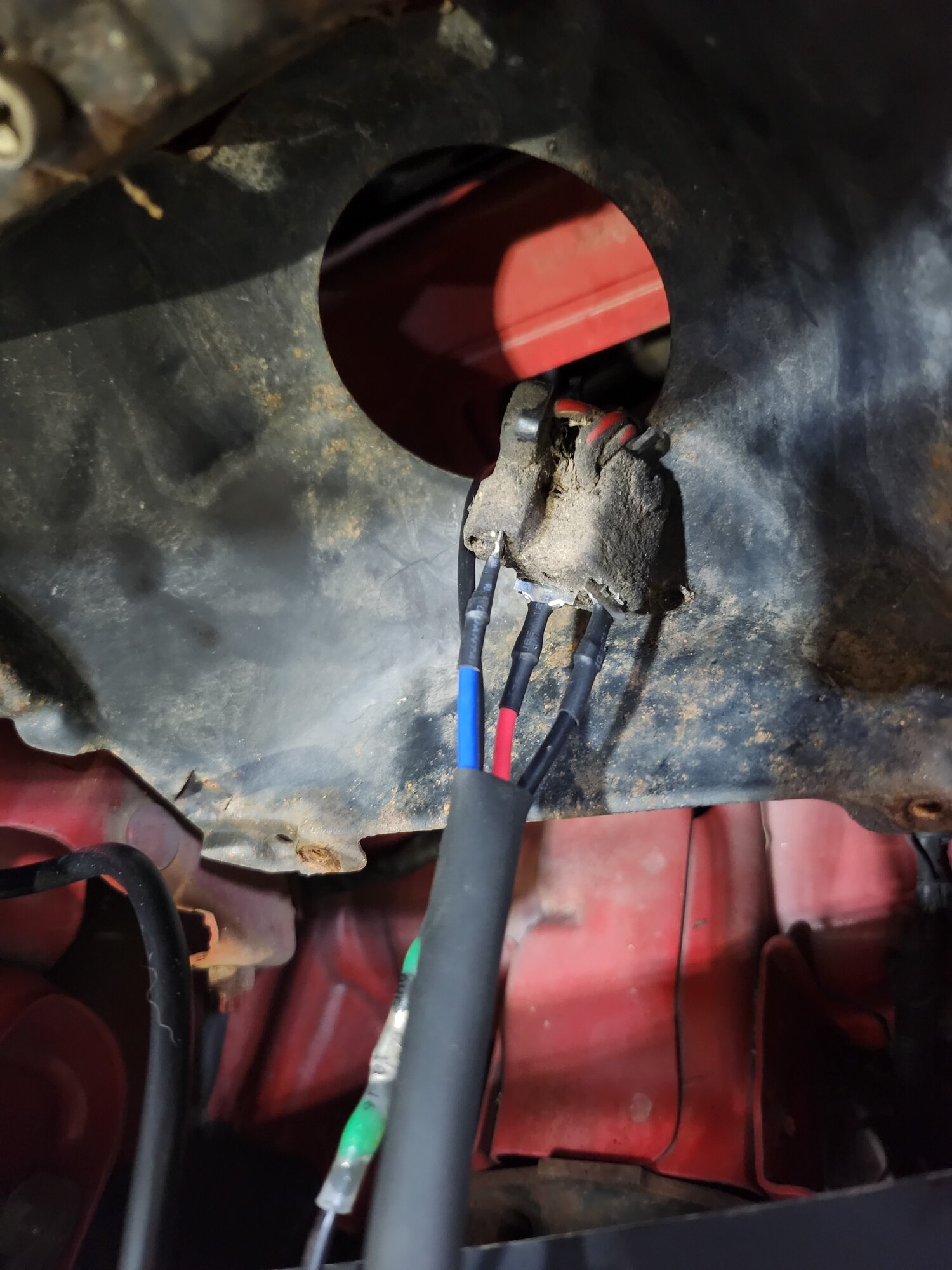

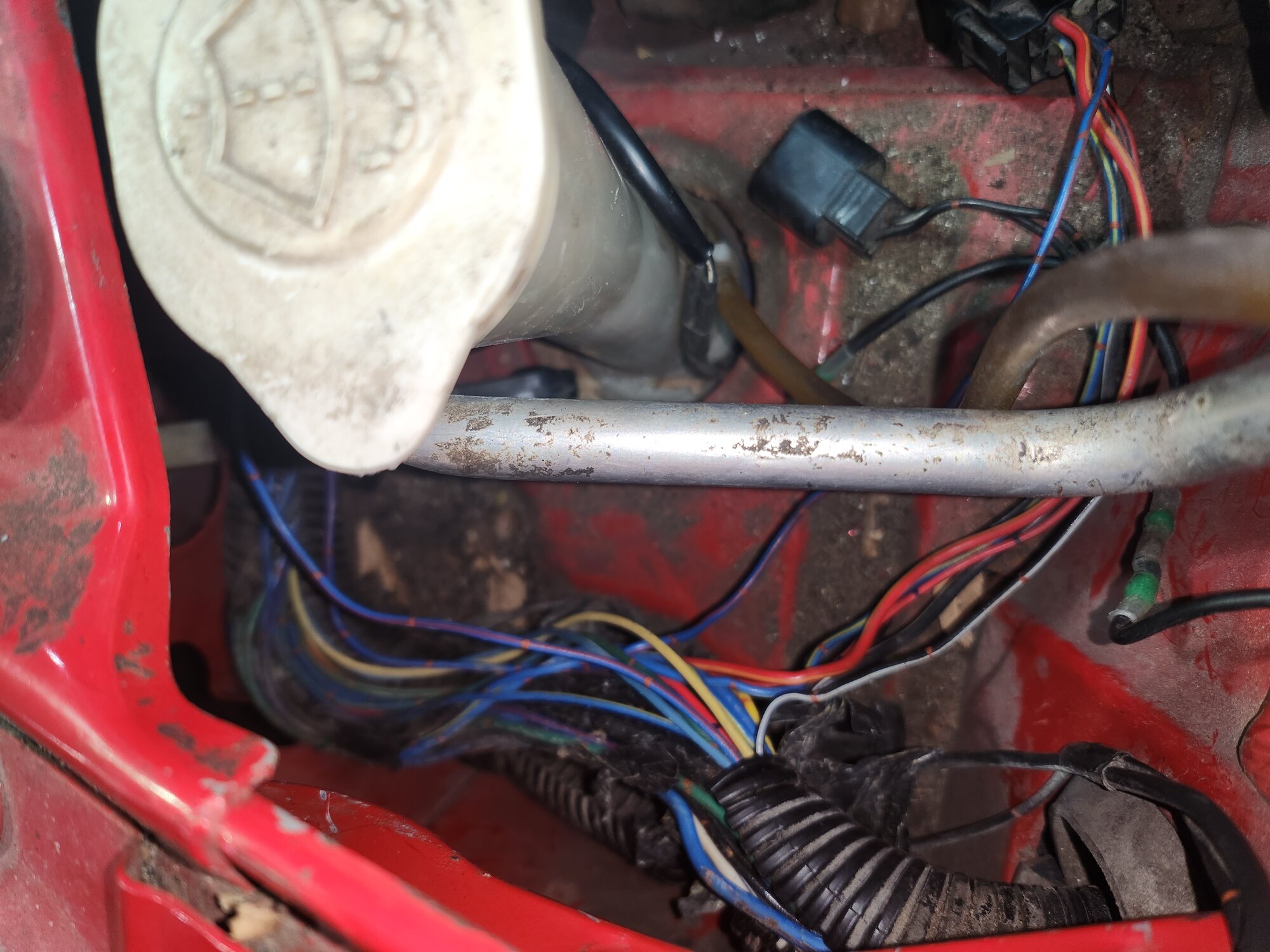

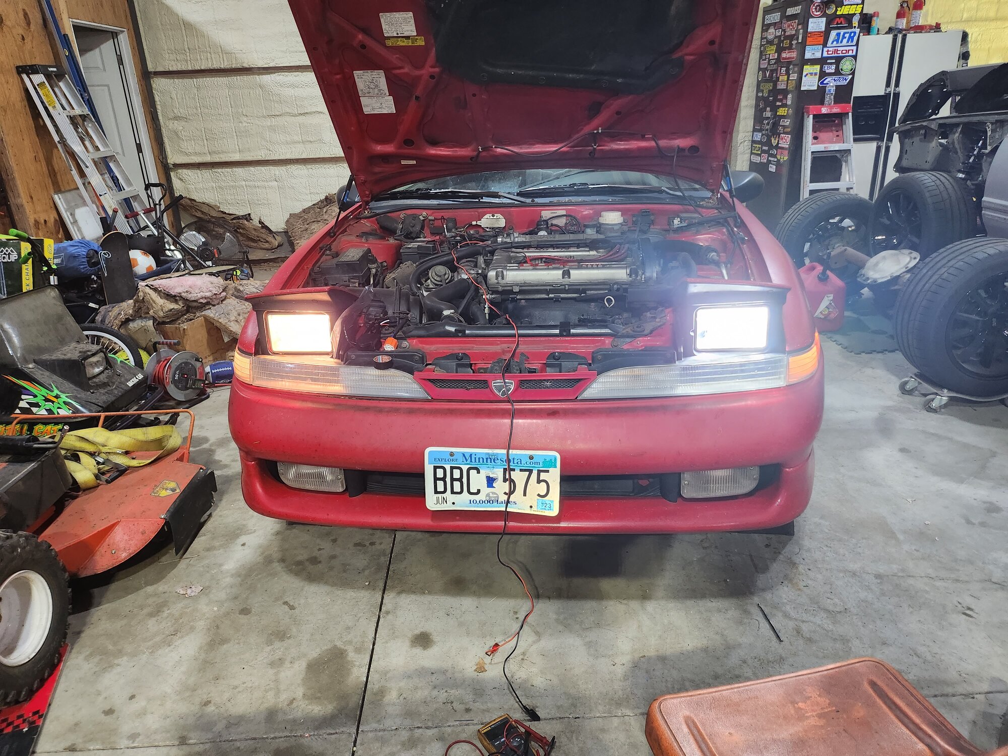

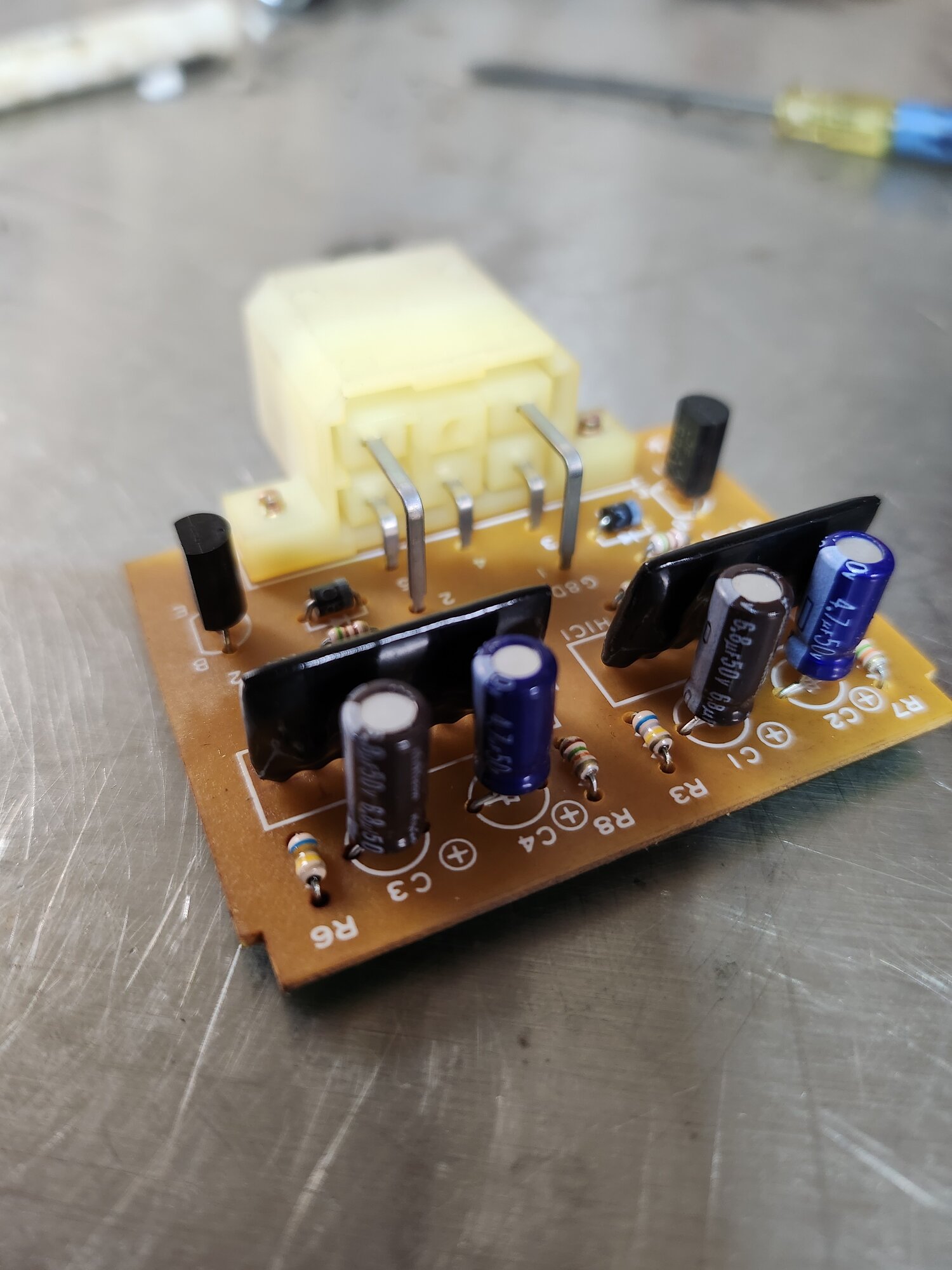

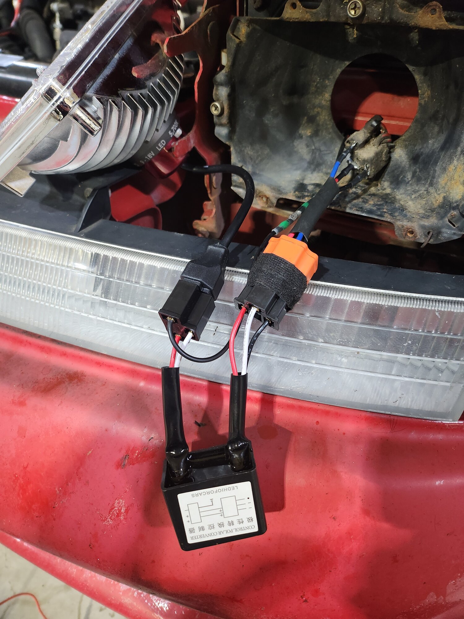

For the last year or so, only the passenger headlight would pop up/down. So I replaced the caps in the headlight control unit, not the issue but didn't hurt.
Turned out to be a bad splice in the wire for powering the headlights down. The splice was hard to get to, hiding behind the washer fluid bottle filler neck. Repaired and everything works great. Also lubricated all joints.
