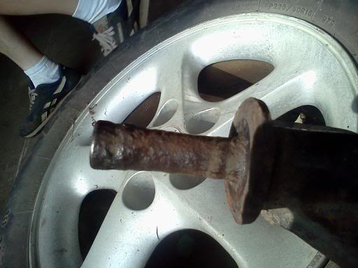

When I did the bushings on the front I found that the rear pin was rotted out like the ones in this thread. (Mine weren't quite this bad but they were loose and rusty)
downsized_0801111605-jpg.448902
I actually changed the bushing first and had issues much like you're describing and went back and replaced the LCAs on both sides so that the bushings fit correctly and that fixed the suspension moving under load.
