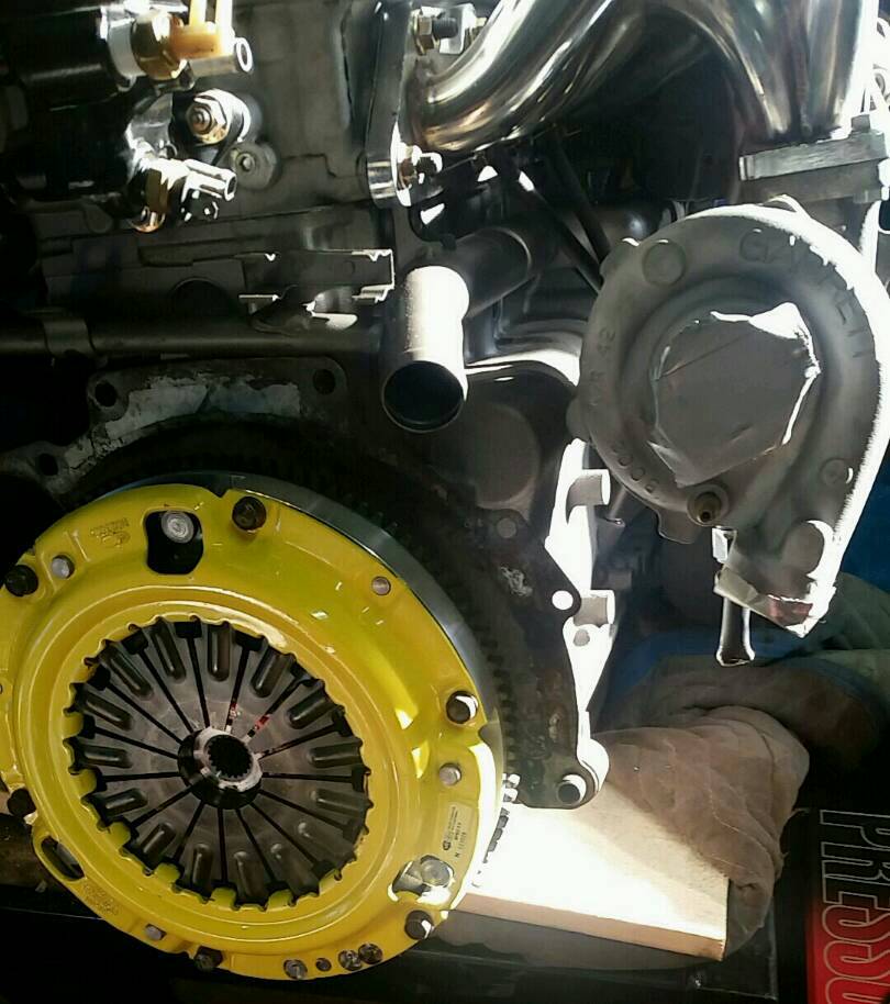

I recently purchased this 91 Talon Tsi from a friend that I work with. The only thing assembled is the motor, every thing else is in pieces. I'm just starting to put it together. Here is a pic of the motor. I'll be adding more pictures as I continue assembly, and drop it in the car. The motor has had some work done at a local machine shop and has yet to be started.

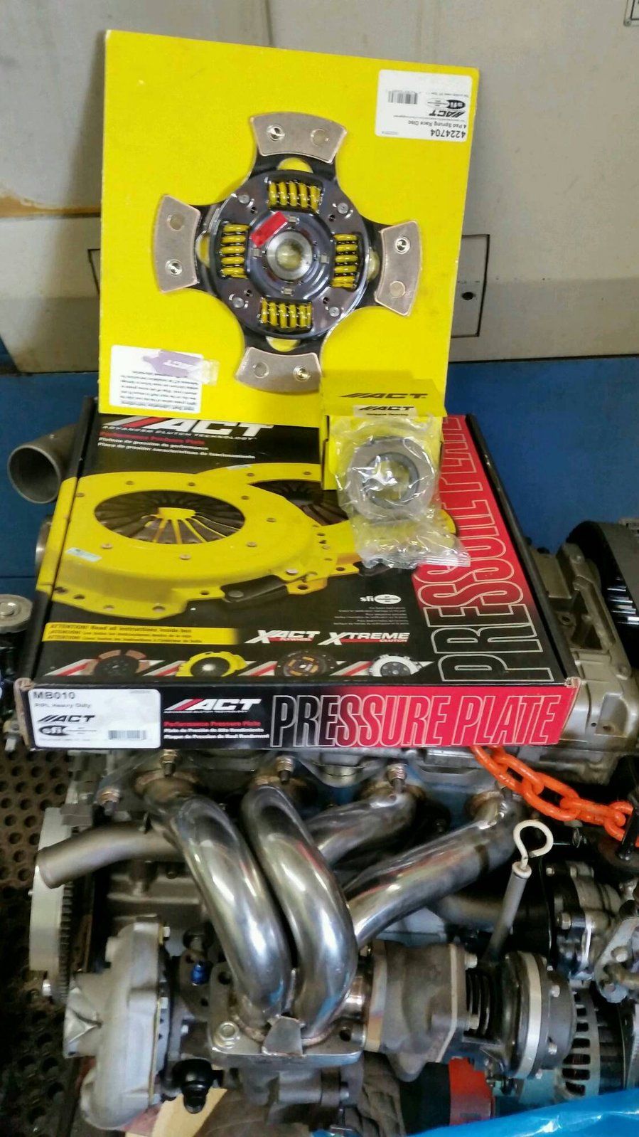

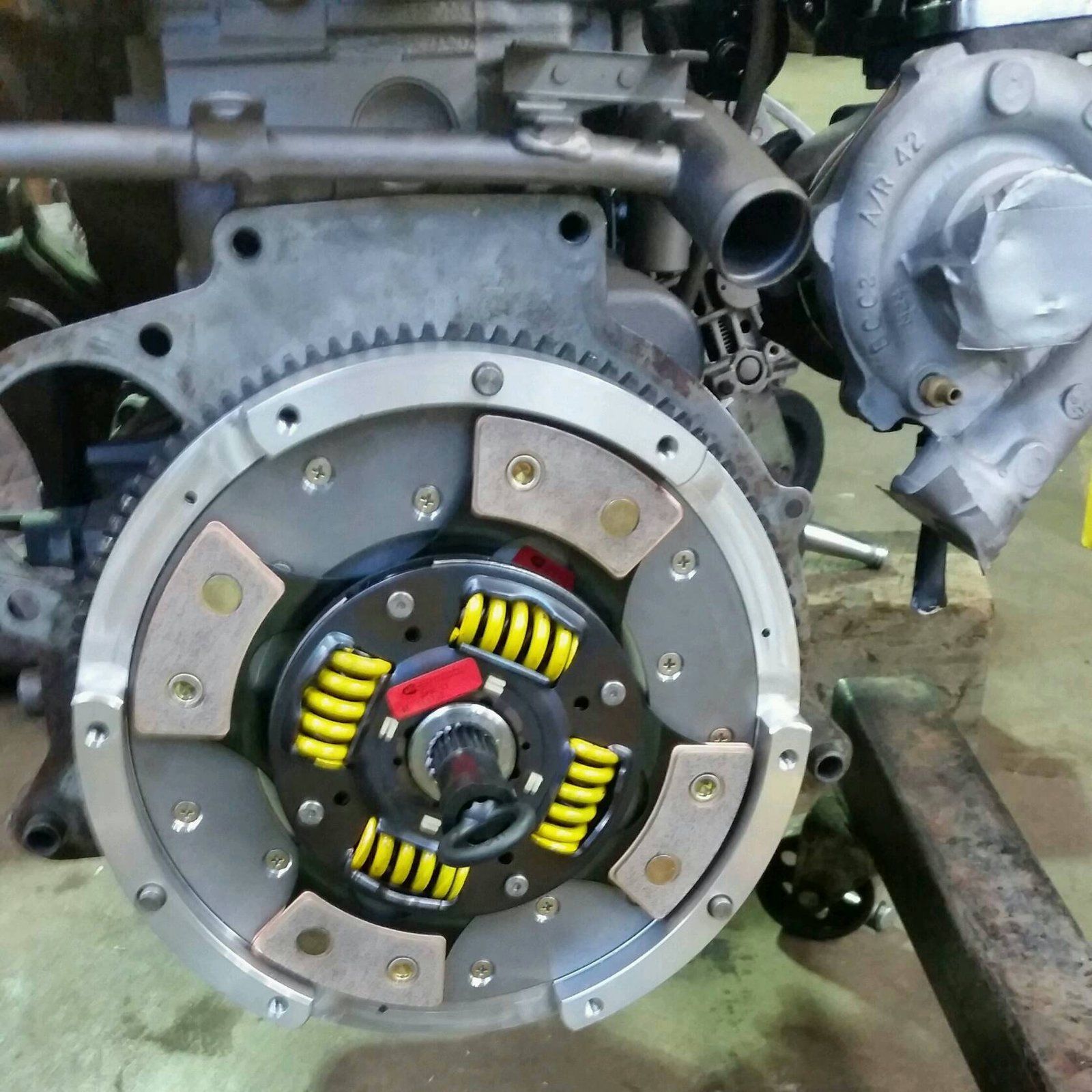

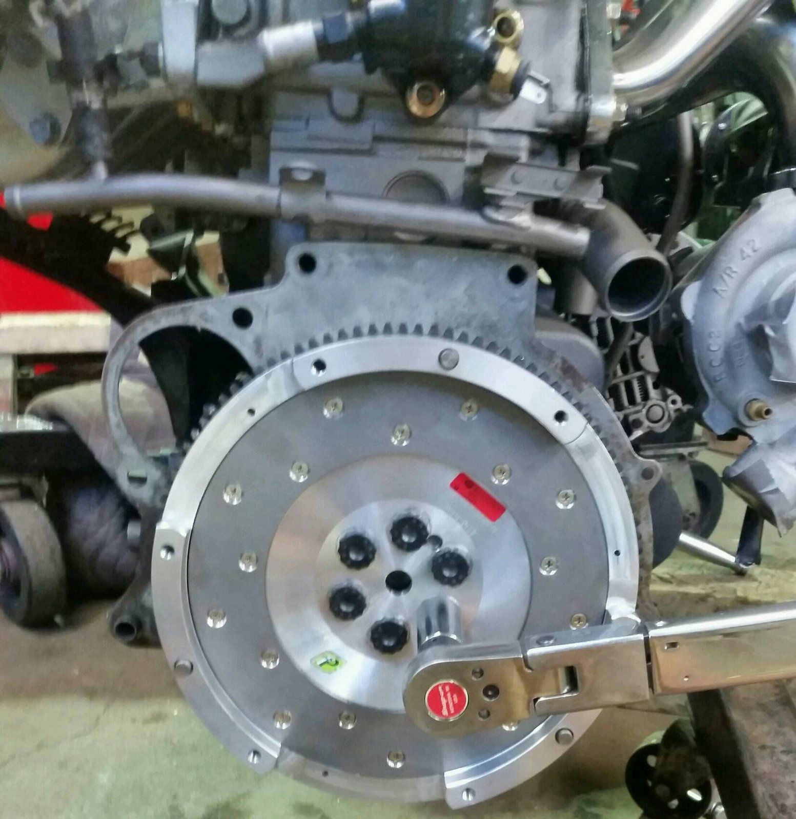

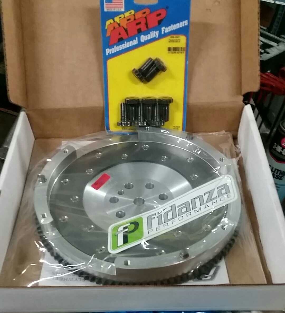

Earlier this week I got the flywheel and clutch bolted on I'm using an 8lb Fidanza flywheel, ARP Supra flywheel studs, that I had to shorten on a surface grinder, and a ACT heavy duty sprung 4 puck , 415 torque capacity

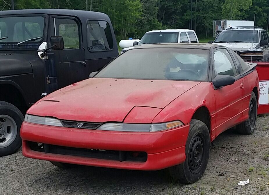

Well, here it is, its been sitting in a warehouse for 5 years and it finally sees the light of day, pretty dusty. Going to wash it up on the 4th

I got it washed and waxed over the weekend its been sitting for a long time and looks good washed up. There is so much I want to do to it, but at the beginning of July in Michigan I just want to get the motor in the car and drive it. For right now I will be using the stock intercooler and stock air intake setup. I have all the workings to do a GM maf setup but would like get dsm link before I do that. I ordered an OEM timing belt tensioner from STM , hopefully it will be here this week.
