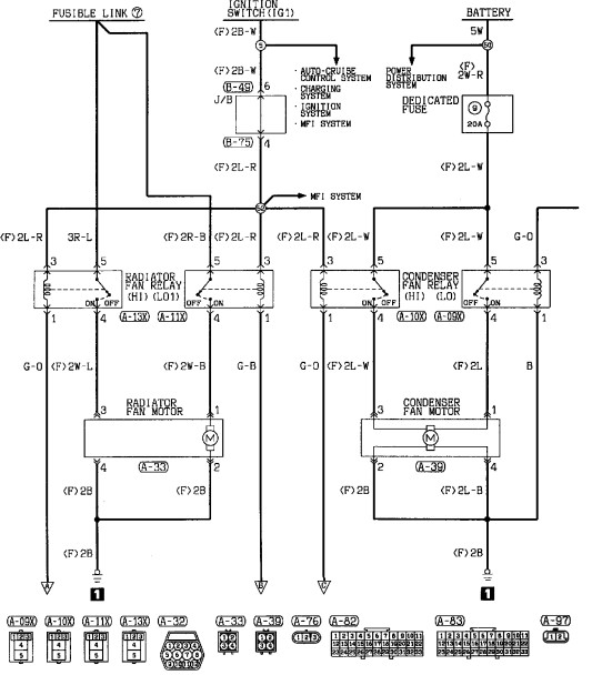

Found a wiring diagram. It's not the greatest but better than nothing. It is for a 97 so may be slight differences
This is the online thread the diagram came from.
