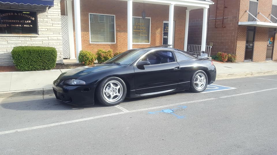

So now I present to you, my "NEW TO ME" 1997 GST,
160k miles
Original paint,
Original rims (tho they are badly done, spray painted silver) wouldn't be hard to clean up
All factory lights work, fog lights, passenger side visor mirror lights, under dash lights
Power locks work, power windows work, sunroof works
Tint looks like it was done on a dirt road behind a dumpster, but I'm taking it off
Interior is in almost perfect condition, one tiny cigarette burn in the driver seat.
Also, here is a list of mods that was already done to the car
  • Garrett Big T28 Turbo
  • Mishimoto Intercooler
  • Greddy Type S BOV
  • Forced Performance DSM Race Manifold
  • Brian Crower Stage 2 Cams
  • Megan Racing Cat-Back System
  • HBC Manual Boost Controller
  • AEM Wideband Boost Gauge
  • AEM Wideband Air/Fuel Gauge
  • KYB AGX Struts
  • Eibach Springs
  • StopTech Slotted Brake Rotors
  • Goodridge Brake Lines

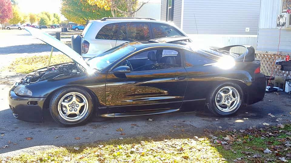

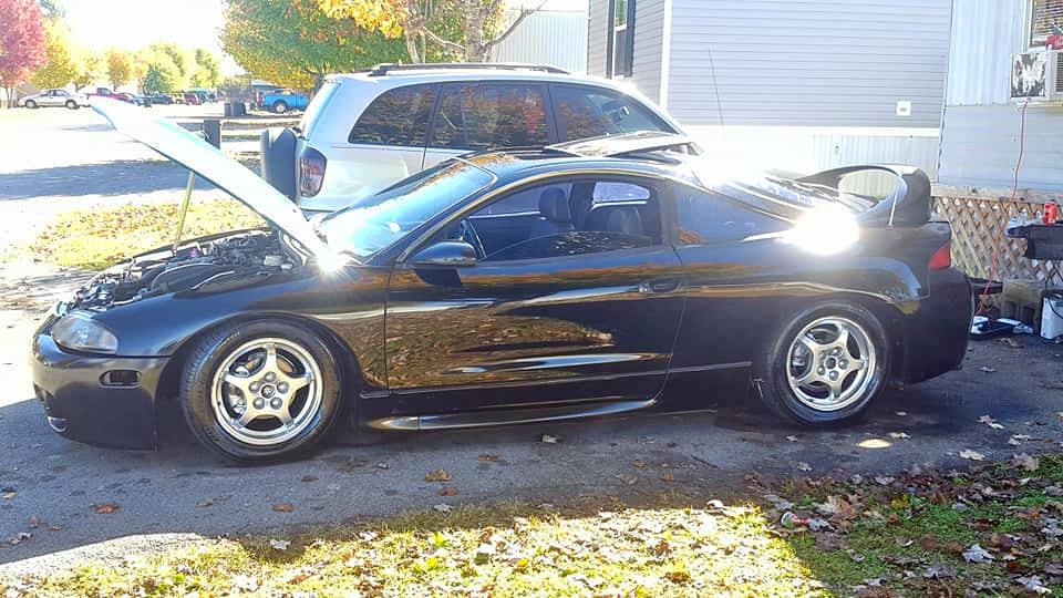

Quick Update
Got out there this weekend and attempted to bleed the clutch, woke up this morning to no clutch fluid in the reservoir, I also attempted to bleed it by pushing in the slave cylinder and holding it, I could hear what sounded like air escaping from the slave cylinder somewhere, so that leads me to believe Slave Cylinder is toast, local parts shop has them for $26, gonna buy one and get it put on this week and hopefully clutch part will be fixed.
Also put a set of Sony Xplod 12s with an Emmerson 800w amp that I've had for years now, sounds great inside the car and rattles stuff off the walls in the house, but vibrates the car really bad, so gonna have to get some dynamat or something else for it.
So for now, after I get clutch fixed,
I have a small oil leak somewhere, noticed the bolts that goes to the oil return pipe from the turbo was backed out some, but they wouldn't tighten, so either someone used wrong bolts or cross threaded them, so hoping that's where the oil is coming from and I can fix that easily.
Also flex pipe is damaged because the car sits so low, gonna fix that next and hopefully that takes care of the CEL and the black smoke coming from the exhaust.
I took the recirc hose loose and capped the port and man oh man, that Greddy Type S BOV is a beast, even just going like 5mph and shifting to 2nd it blows so loud, but I hooked the recirc hose back up.
That's all for now and hopefully soon I'll have it running great, back to work tomorrow and will mess with the car again as time and daylight allows.

Could be the master cylinder too.
I put a new master cylinder on it the next day after I got it, because it was leaking. So far overnight and all day today the fluid hasn't leaked out, maybe I'm just not use to whatever clutch is in it, I know the 96 mustang I sold before I bought the Eclipse had a stage 3 clutch in it and that thing was super super strong when you pushed it in, took all my leg force to get it in, this clutch is very very squishy and easy to push.
And I bled it until fluid kept coming out each time.
There is a very small amount of pressure in my clutch pedal. But it works decent. I think these hydraulic clutches were designed to work with ease. So they actually have a ton of pressure, you just don't feel it. I thought it was weird too the first time I drove mine.
Well that works, clutch lets out at very bottom of pedal so I'm just gonna go with it being fixed.

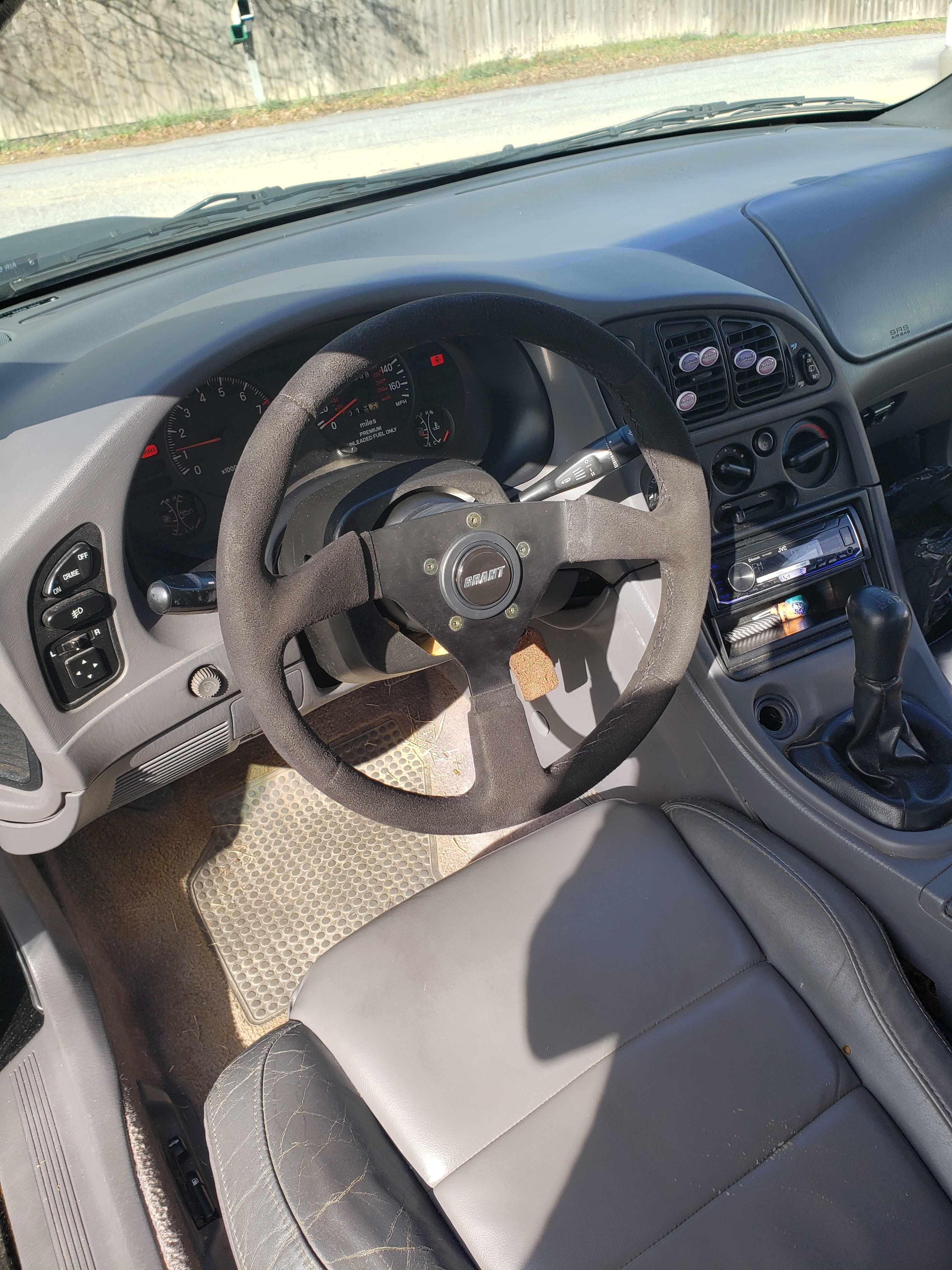

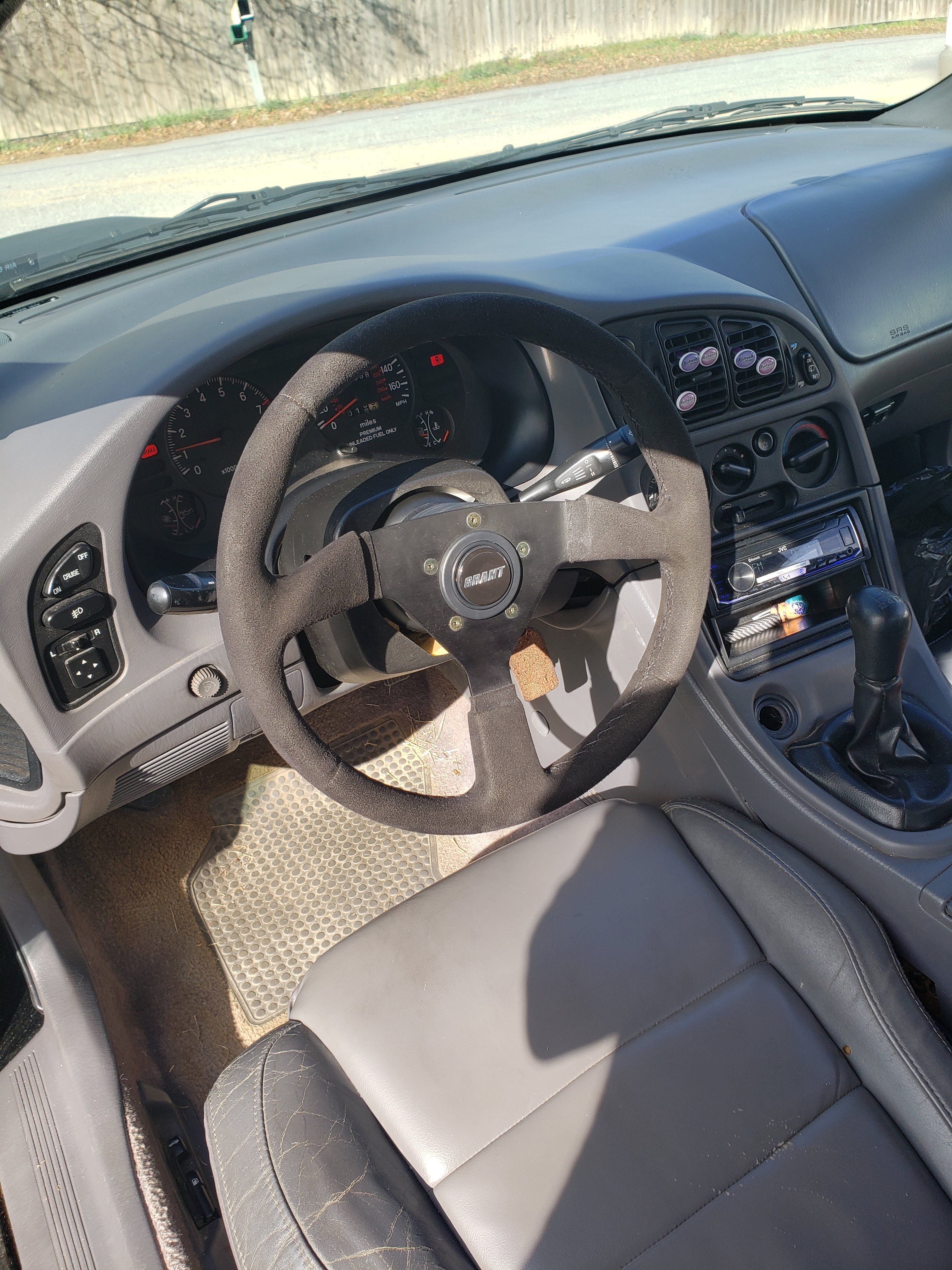

That actually looks pretty good. I'm still trying to decide what to do for mine. I don't want to spend a fortune but I also dont want something cheap and ugly.
The more I drive it the more I'm liking it, seems so much smoother than the factory wheel.
