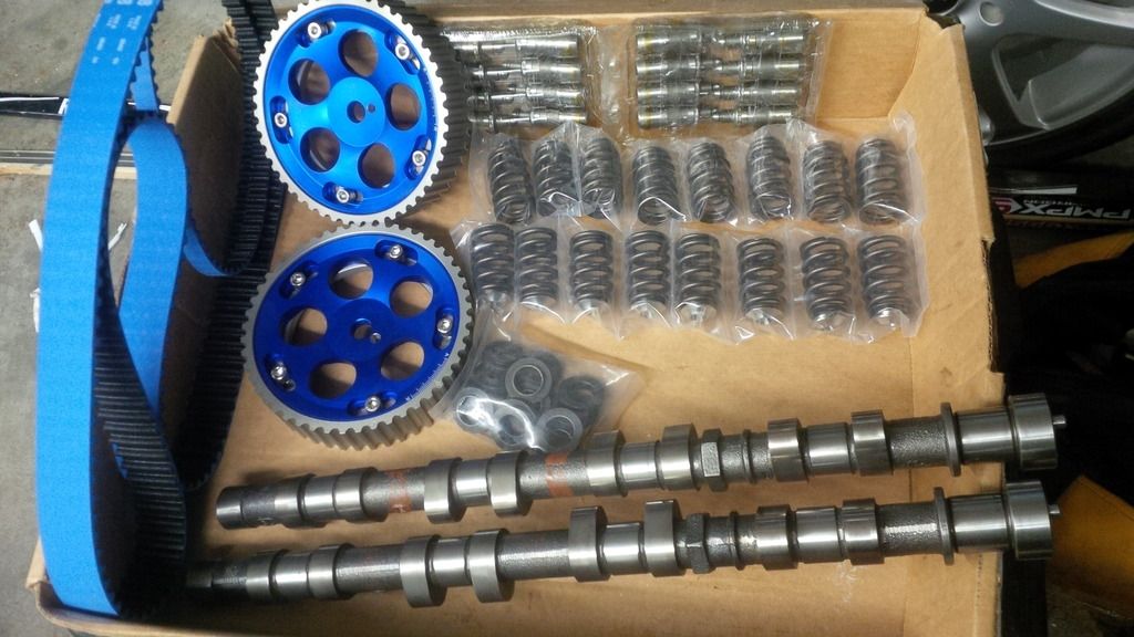

-GSC S3 stage 3 cams
-Kiggly beehive springs/titanium retainers
-new revised lifters

-gates kevlar timing and balance belts w/ zaklee cover

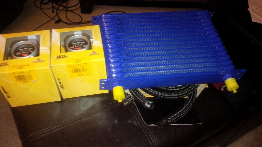

-external 15 row oil cooler with 10AN lines/fittings

-autometer volts
- autometer boost
-autometer electric oil temperature
-autometer mechanical oil pressure
-autometer electric coolant temp
-autometer full sweep 2000F* pyrometer with warning LED

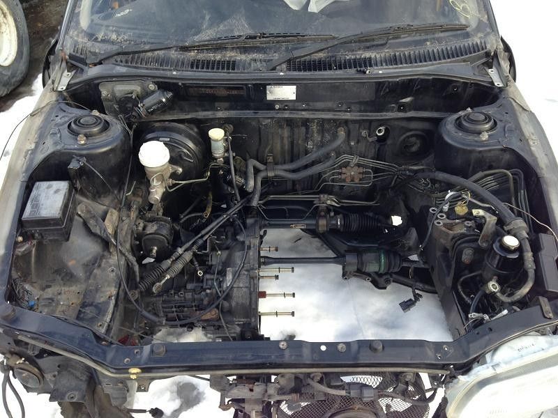

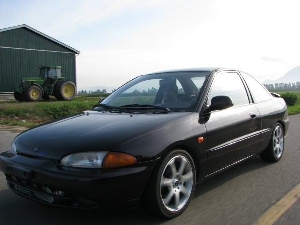

PIC of the colt that will be used in the build (pic from 5+ Years ago)

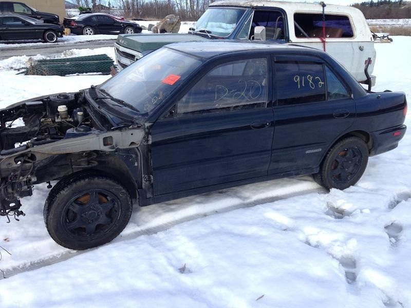

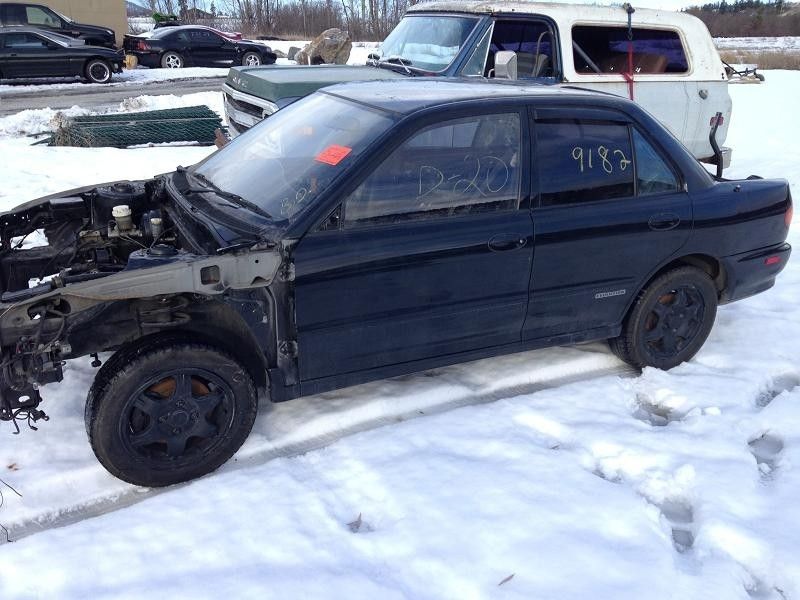

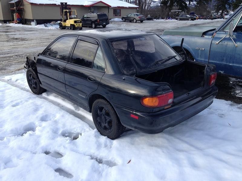

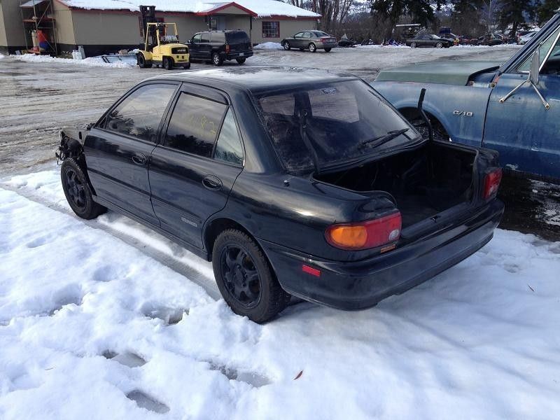

This is the parts evo I have sitting waiting to be torn apart. I also recently acquired the complete engine/drivetrain/subframes/suspension/wiring harness/ECU from another written off evo. I didn't keep the chassis on this one, but grabbed all the goodies and drivetrain parts so I have no shortage of spare parts for my build!

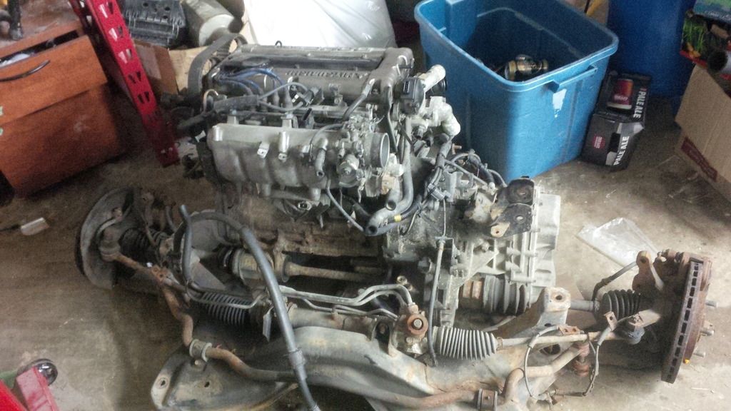

front subrframe and engine/trans/tcase from evo1

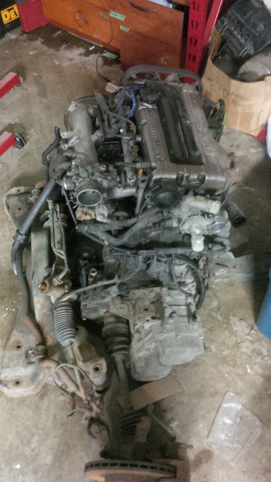

evo 7 bolt and trans

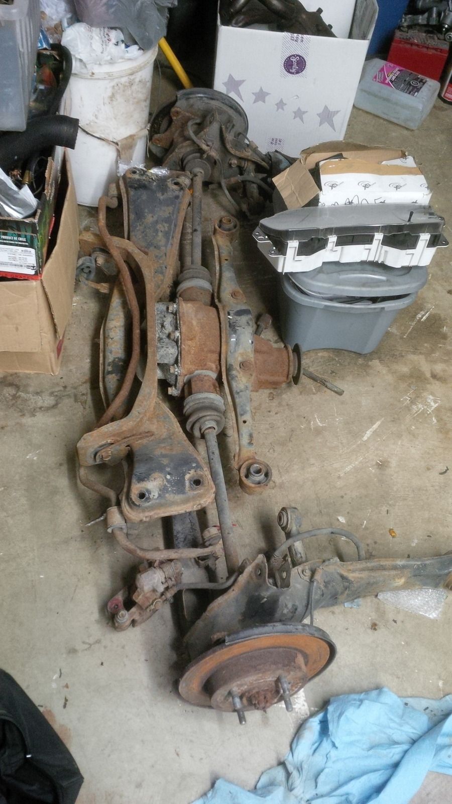

rear end and subframe

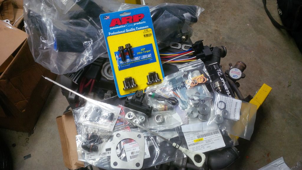

And the goodies, almost got everything, time to start tearing into her!

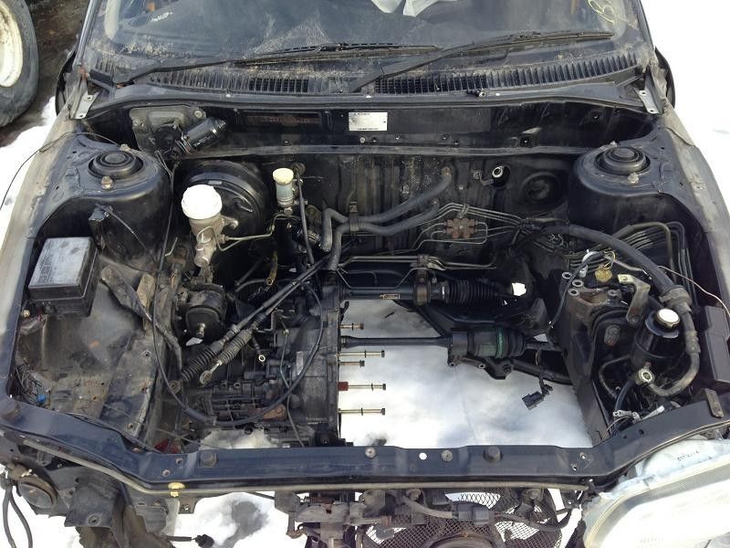

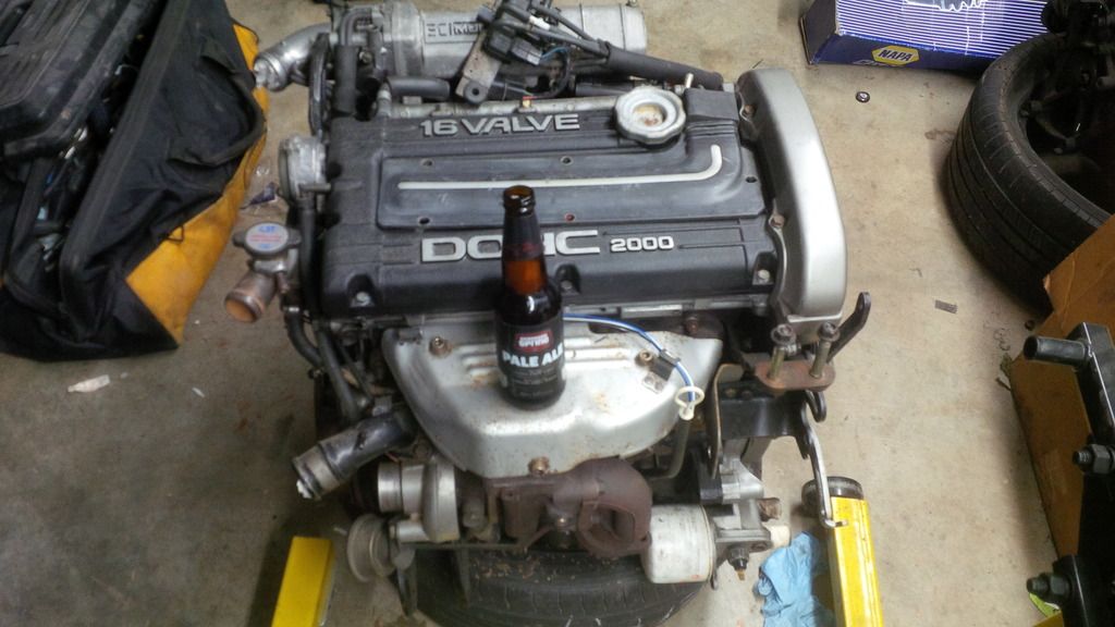

6 bolt going into the new build...going to get new goodies!

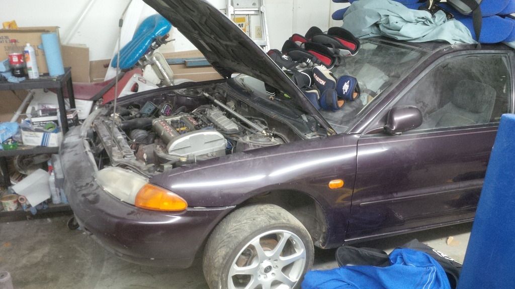

and here is how she sits currently. waiting for the original 6 bolt i swapped in 10 years ago to be pulled, and turned into a stroker build maybe :)
