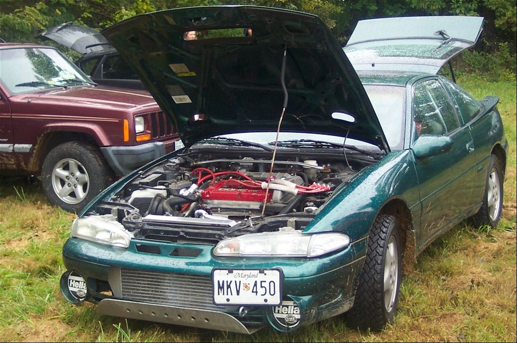

Old engine compartment pic. Will update w/ fresh one shortly.

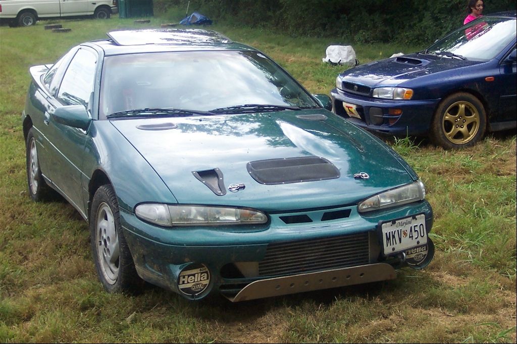

Where did you get the small scoop on the hood that is in back of the hump, also could a close up of the radiator ducting be possible, on the hood and from front.
Thanks

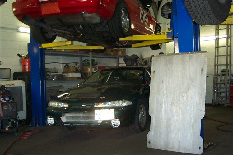

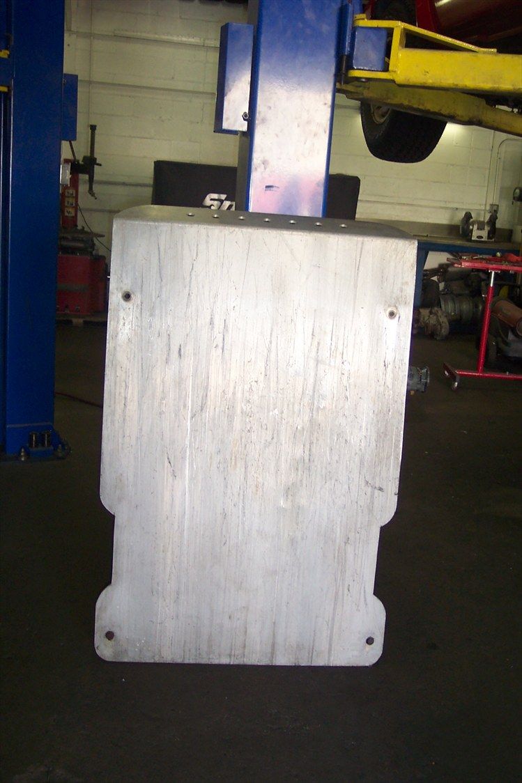

Can you elaborate more on how the skidplate is attached? Pics?
Bolts go thru the 2 front holes(upper holes in pic) then thru thick rubber insulator and washer into nuts welded into the bottom of radiator core support. Bolts go thru 2 rear holes (lower holes in pic) and into I think it is the rear A arm mounting bolt holes replacing those bolts.
Took the pic when I totally replacing my bolts w/ new ones. What you want to do is put the bolts thru a washer, then thru the skidplate, then the rubber insulator and then thru a final washer which you weld to the bolt. Whella! Bolts are now part of the skidplate assembly so quicker taking on and off w/o losing any parts.
I want more information on this Rally bumper, this is exactly how i wanted mine
The Hella 500s are mounted to the radiator support by Porsche suspension bracket parts I modded. The stock bumper cover that I modded slips over them. The light buckets are large PVC piping molded to the cover w/ sandable body adhesive in front and flexible Mercedes window urethane in back. I used some Porsche Cayenne bumper cover bits to fill in gaps on the sides. Can you tell I work at a Mercedes/Porsche dealer collision center?
