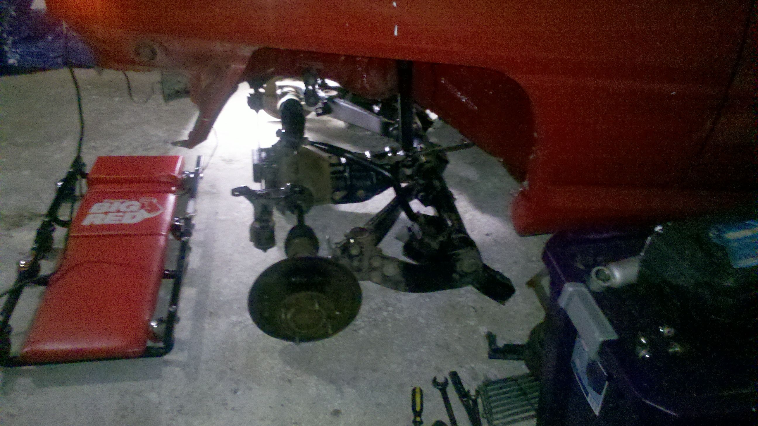

So this is the Donor car! 1992 Eagle Talon TSi!
Last pic is to prove its actually AWD
Thus far I've just been getting all the measurements down and its great to know that the AWD will physically fit in the Mirage! :D

It turns out that:
A) The engine mounts from an Elantra for a FWD swap do NOT work.
B) The GSX mounts DO NOT WORK.
C) The spindles from a GSX/GST will bolt on. HOWEVER! The steering rack is NOT long enough to accommodate for this. You will be pigeon toed.
D) The AWD trans is much longer than the FWD trans and WILL hit your frame rail. I had to cut and weld in an arch to clear it.
E) The throttle cable will slide right in.
F) The factory hole where the brake booster used to be is a great fit for the new GSX wiring harness. (I'm not running a brake booster anymore)
*Side note. I am running Starion wheels. 16x7 +18 225/55R16. front and 16x8 +0 225/55R16 rear. The front wheels will rub horrendously if you don't trim the inner fender where the stock batter sat.
Progress is good, mostly boring grinding/welding where you won't see. Mostly in the rear cut of the GSX. I had to do some major trimming (will post pics) to rid the subframe of rust and crap. Sadly, things haven't been going as fast as I'd like them to be, as money and time have been on short supply.
