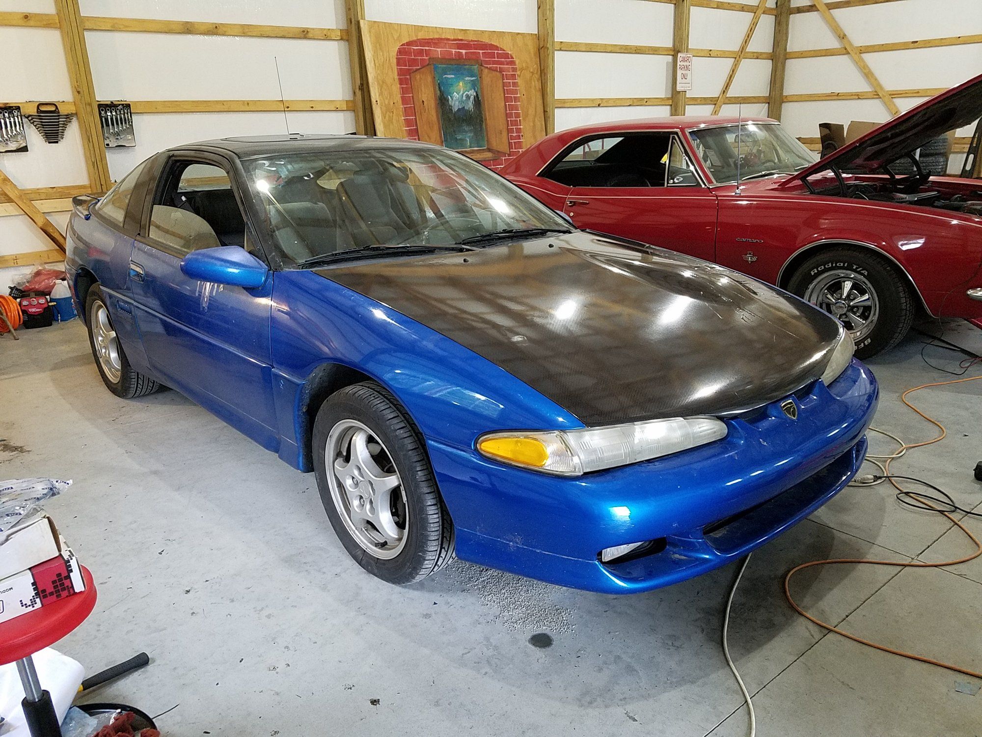

Stock 1992 Tsi AWD Talon 13b, 6/4 Auto car. Cruise, Air, Factory Dealer Window Sticker, Spare tire and jack package. Well maintained. Only mod is emissions delete.
1992 Talon TSI 6/4 AUTO

Mods-Bolt-on
Walbro Hellcat 525, Aeromotive AFPR, Rail to Filter and Rail to Return 6AN line kit, MBC, Cold Air Intake, VRSF FMIC w/1g BOV, Tial 44mm WG, ZEX Turbo 50 shot wet kit.
Mods-Engine
Stock bore, Manley 9:1's on Manley H-beam rods on the stock 6 bolt crank, Kiggly Main Girdle, 7 Blade JW HX40, Morrison Fab Small Tube T3 exhaust manifold, Kelford 264's, Fidanza Timing Gears, ARP Head studs at 105 ft lbs, E85 sensor, IAT sensor, Omni 4 bar MAP sensor, on Speed Density setup. Oil passage mod on block and head. SuperTech single Valve Springs/Titanium retainers and SuperTech valves, Kiggly HLA
Mods-EMS & Logging
ECMLink V3, Innovate LC2 Wide Band.
Mods-Drivetrain
ForcedFour SmartShiftBox 100.1 TCU, Rebuilt W4A33 from DTR, unknown stall converter, TransSlab 175 shift kit, Magnus transfer case cover, Jeff Bush Transfer case brace, Welded Center Differential
