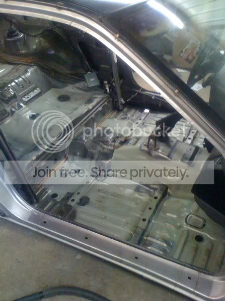

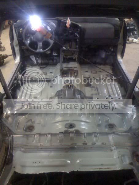

Made a little progress. Pulled the dash out to get the blower crap out of there finally. Also got rid of all the sound deadening to prep for the cage (which is in the mail) as well as the paint for the interior. Also picked a color for the cage.:hellyeah:
Oh and with the blower box and sound deadening, we dropped another 45lbs.

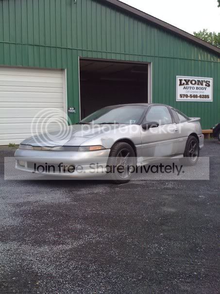

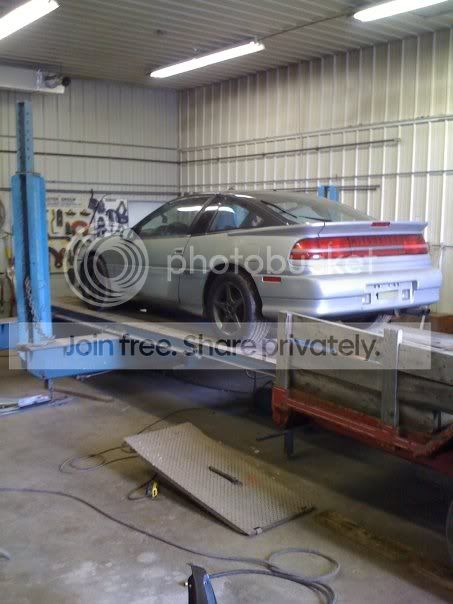

Also dug up a couple pics from when the car was all the way together.

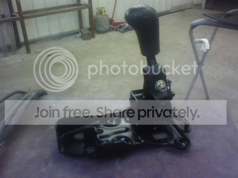

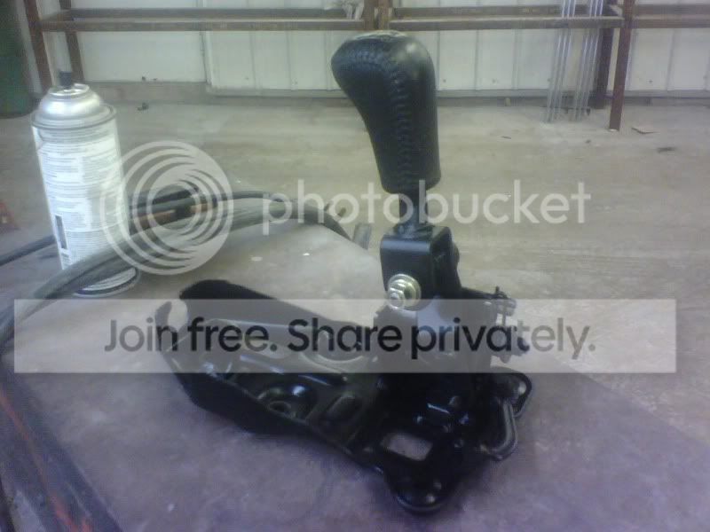

Just finished making our shifter almost 1/2" shorter and it has a solid brass bushing where the shifter slides onto the rod of the base plate now instead of those flimsy plastic ones. Working on solid mounts to bolt the base plate to the tunnel next.
Here's the finished product.

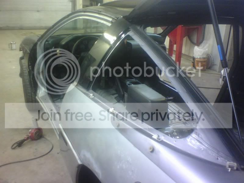

Also Pulled a quarter window. I would not suggest this to anyone. It had so much sealant on it an my hands are completely covered in crap now. I just pulled it so we can get a better paint job and also so we can reach in to weld the upper bars on the cage.

Is this a 90 or 91? I was wondering if the bushings for the shifter were a one off or just something you managed to find at a hardware store?
I'm hella dumb its a 91 but I'm still wondering about the bushings.
We actually turned the bushing on a lathe. I can take a picture if you'd like.
We made the bushing out of a solid brass rod on a lathe. We made solid mounts for the shifter base today. I can already tell this thing is going to feel amazing to shift.
