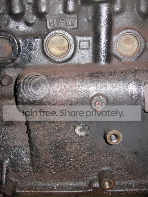

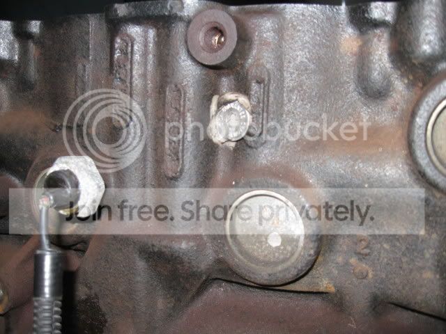

Oh yea, anybody know what this seal is for?
I have them on both sides. The seal says "Guarantee Void if removed." I'm just curious what it is covering,
Those seals are heat sensitive so say you over heat the motor and blow it. You can't bring it back to where it was built and tell them they built a bad motor because they'll know it was over heated.
sneaky sneaky:ninja:
-Frank
Oohhhhh alright. Would you say my block is in good condition then if those seals are still intact? I was going to replace the piston rings incase I was burning oil from there. Thing is, I bought the motor with a 2 yr/20000 mile warranty right? Well, I've put maybe 1-2k miles on the motor since then... not sure if I need to. Then again, I already have it down this far, how much harder is doing the rings too, ya know?
