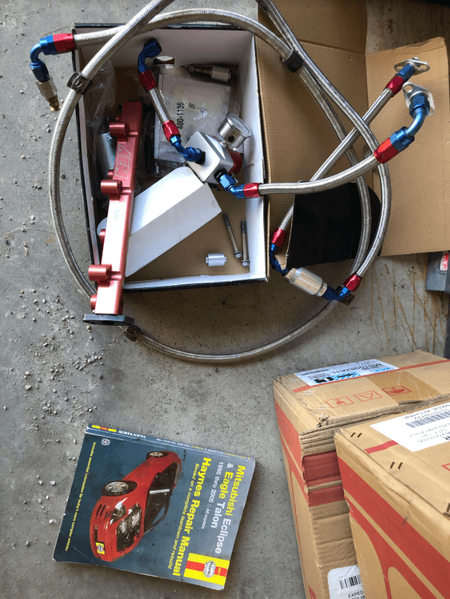

So onto what I've done this weekend. I've spent some $$$. Got some goodies from a friend who is parting his car out. Hoping next weekend to throw in the 450lph pump, all the lines and afpr. I believe it's all e-85 compatible, but where I'm from there is only 1 or maybe 2 e-85 stations. I was about to use a ChrisFix discount code to get a Haynes manual for these cars but that friend was kind enough to just give me his. You can also see two brand new headlights in the corner of the picture there (but that's for the other car ;) ).
From the looks of it, the intake might get held off until I pull the engine for any reason. I picked up the 1g throttle body from pick & pull on the weekend. In true pick & pull fashion I got charged $40 for the body, and another $30 for the TPS. They were about to charge me even more for the IAC but the nice lookin lady at the desk took my side over the manager (or whatever her title was) and didn't charge me. Figured out at the second pick & pull of the day that I get 10% off for being a student, so I know for next time. It's not the 63mm throttle body but eh, it works right? I also gave her a bit of a clean, nothing too special. Figure when I pull the engine to build it, I'll do some powdercoating here and there.

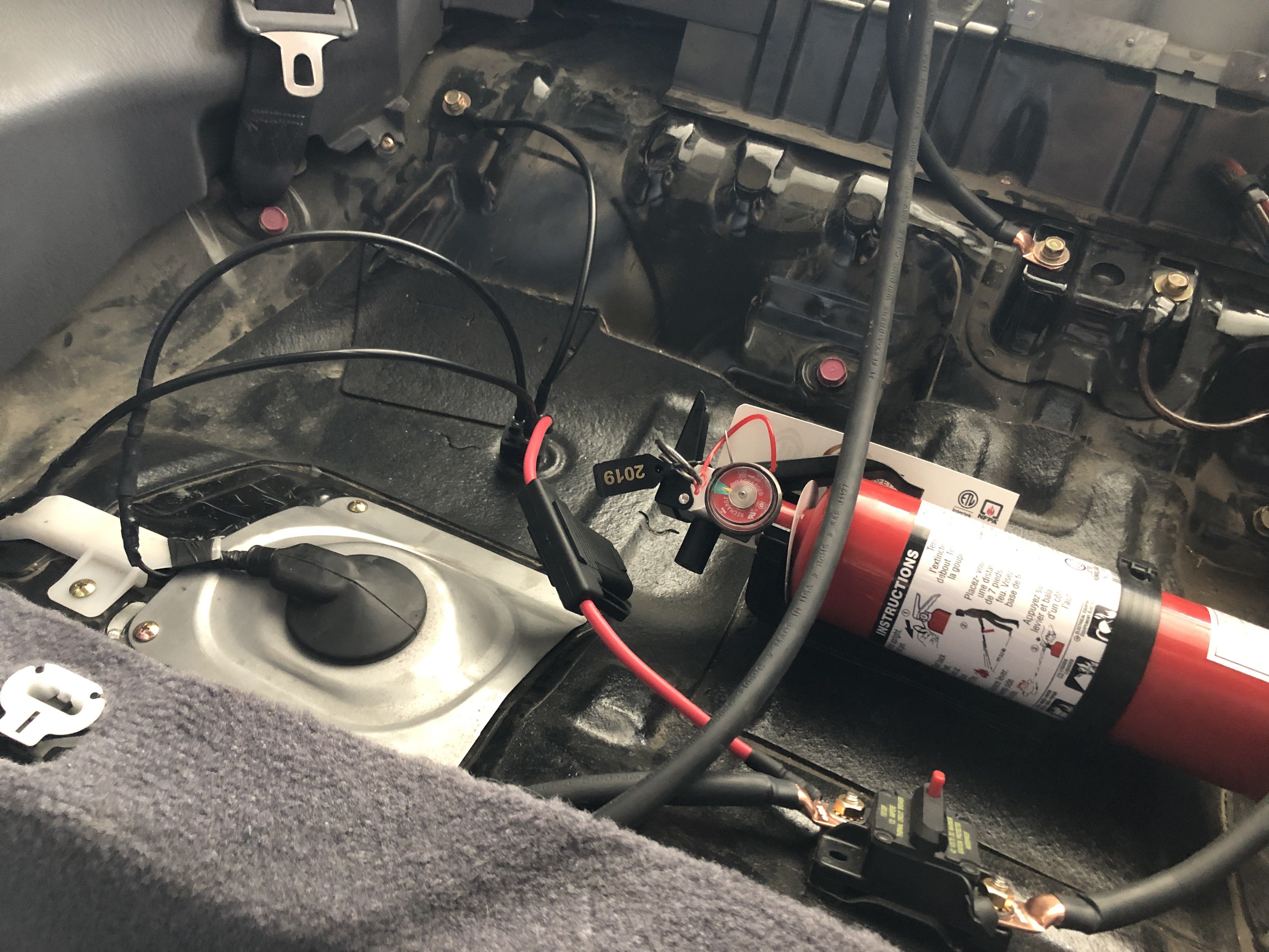

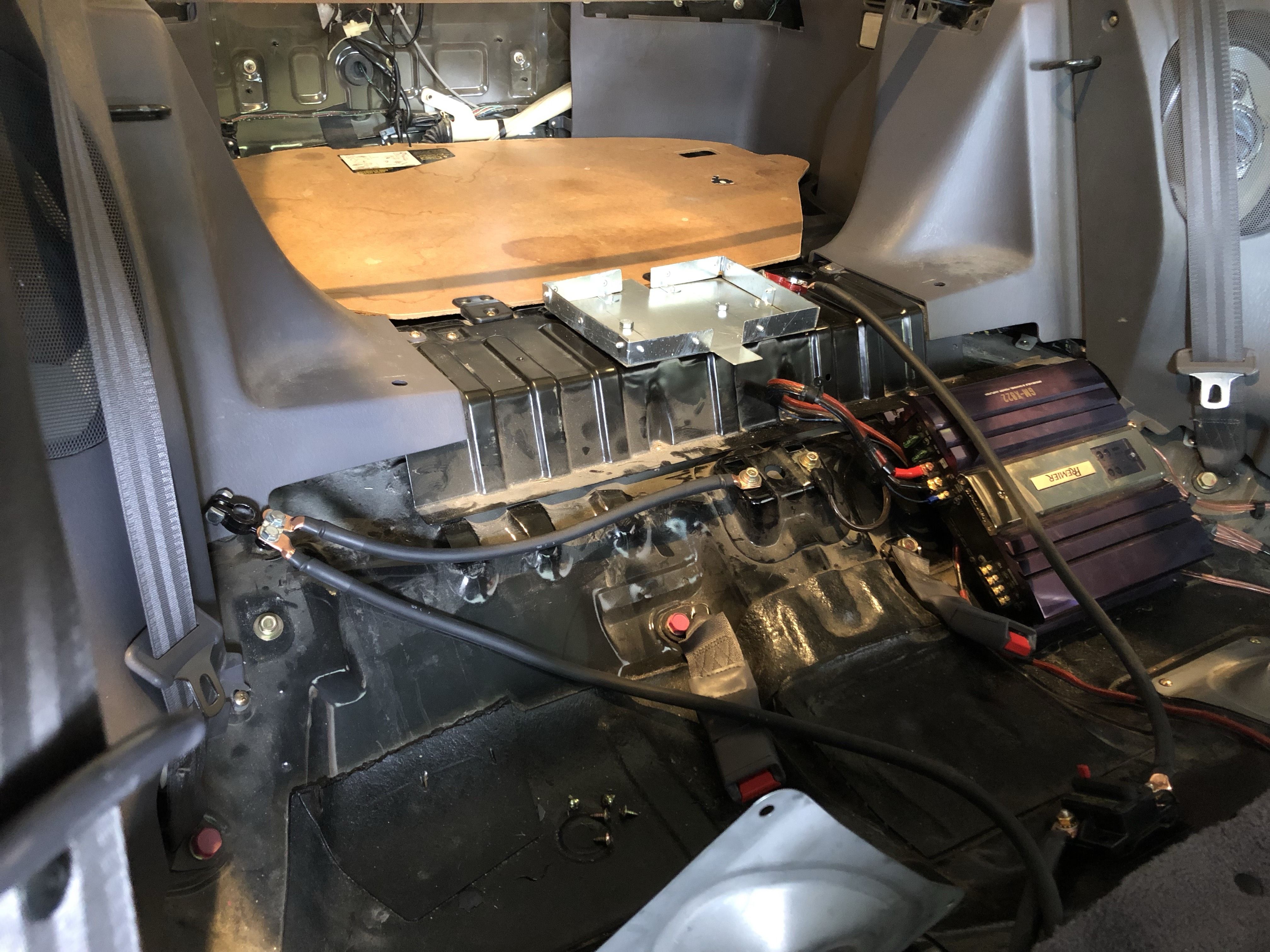

First, I wanted to relocate the battery to the trunk. I didn’t want to buy a premade battery box or anything because I wanted it to perfectly fit an Optima battery. Plus I had a bunch of spare steel sitting in my backyard not doing anything.
The previous owner installed this amp and sub in the trunk. I took the sub out, but the amp looks like it’s wired to something else so I had to mess around a bit with his wiring and find a new spot for it (previously it was mounted to the back of the back seats). The tray has two tabs on each side for when my tie-down gets here, and I can properly secure it. That's when it will get painted too. For rewiring from the trunk, I just bought 24 feet of 1-gauge welding wire from Princess Auto and some connectors here and there. I have a fuse/kill switch within arms-reach of me in-case anything seems weird.

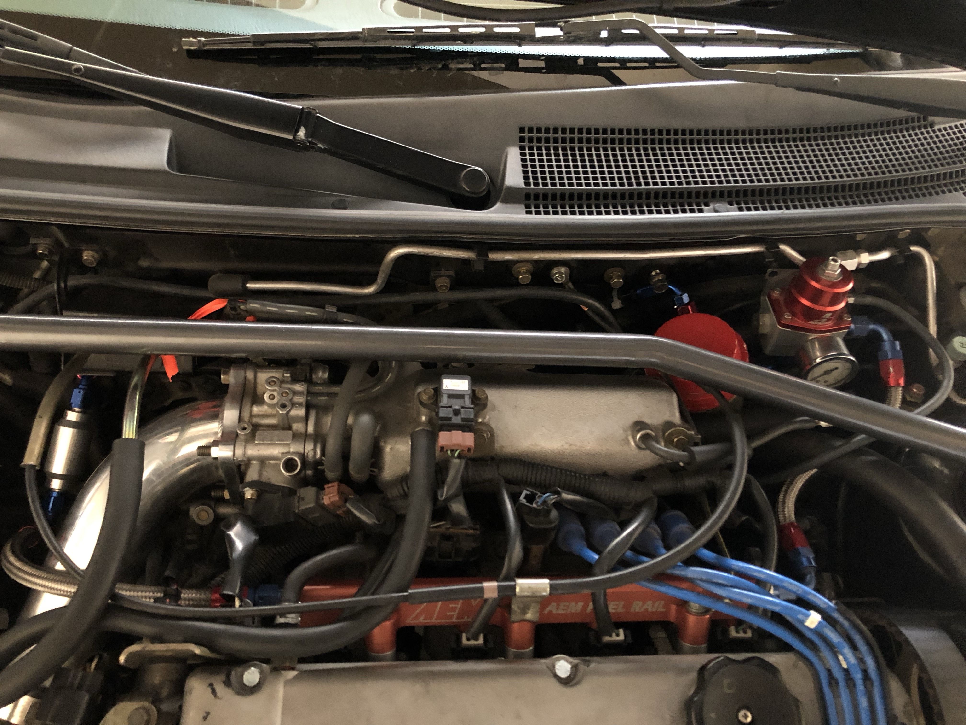

Now I wanted to tackle fuel.

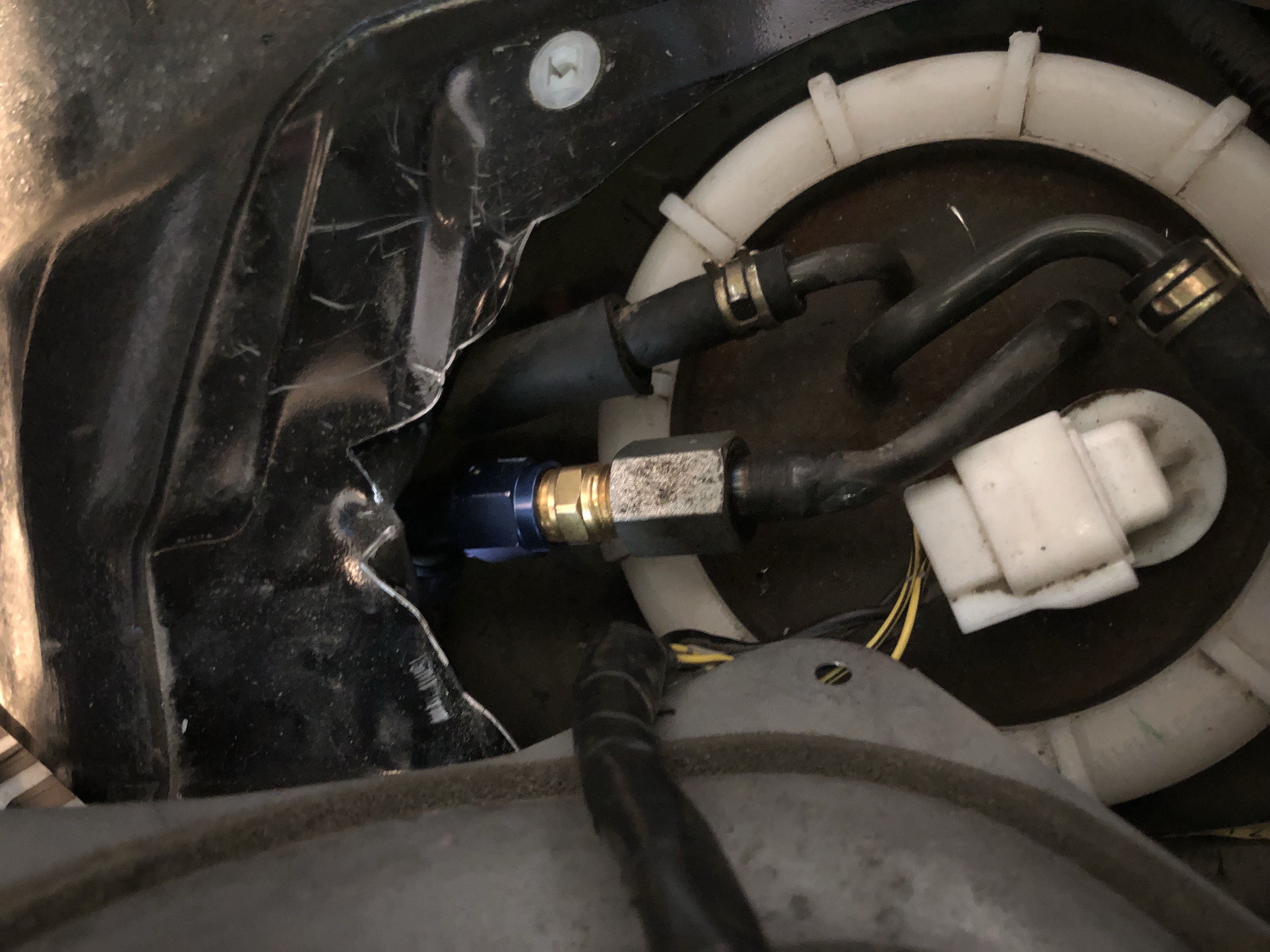

When I took out my fuel sending unit to put in the 450lph fuel pump, I brought it to a welding place to get a bung welded in-place where that 14mm demon bung is (it strips like nobody’s business). Then just a stainless steel line all the way up the car.

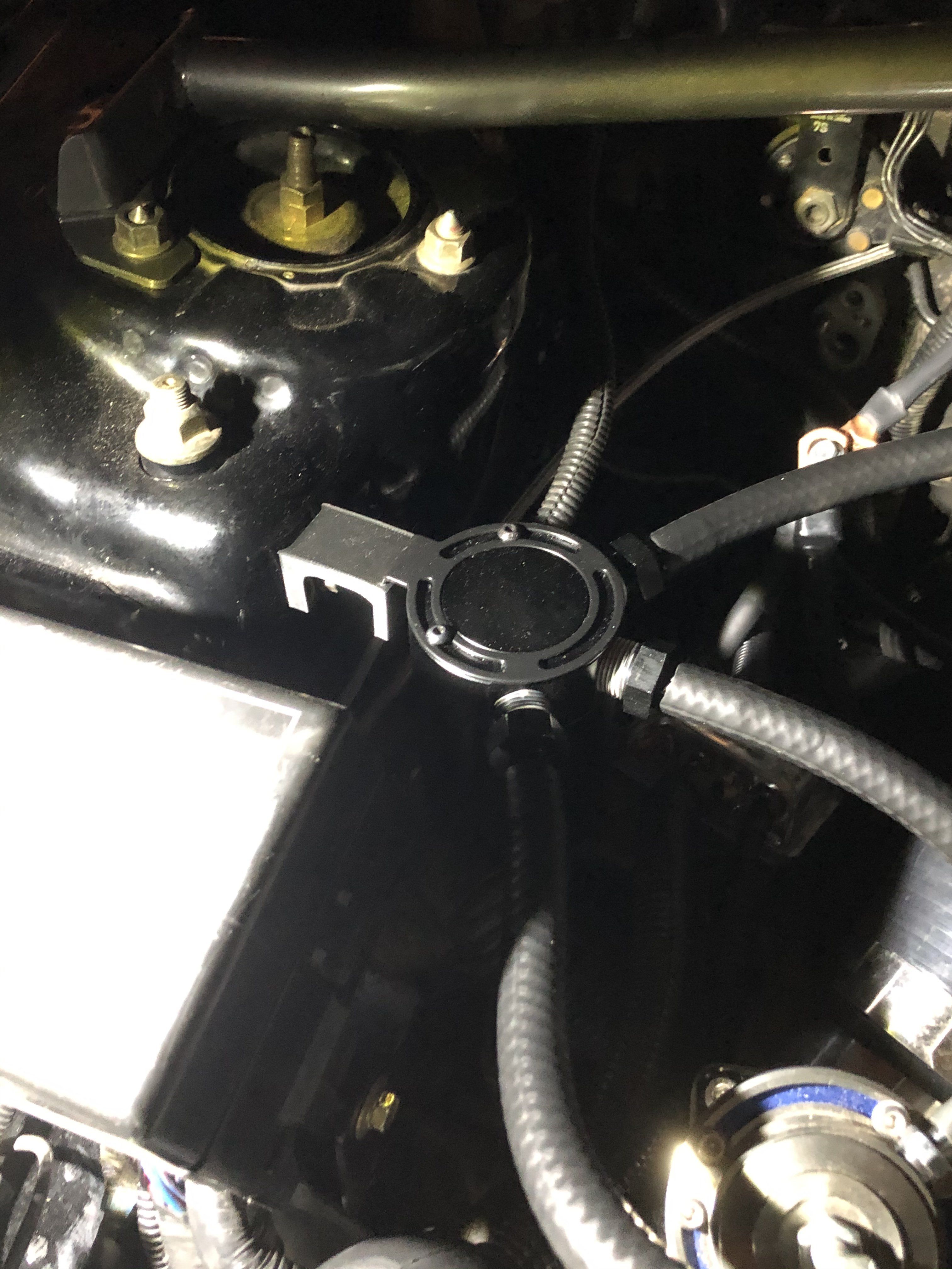

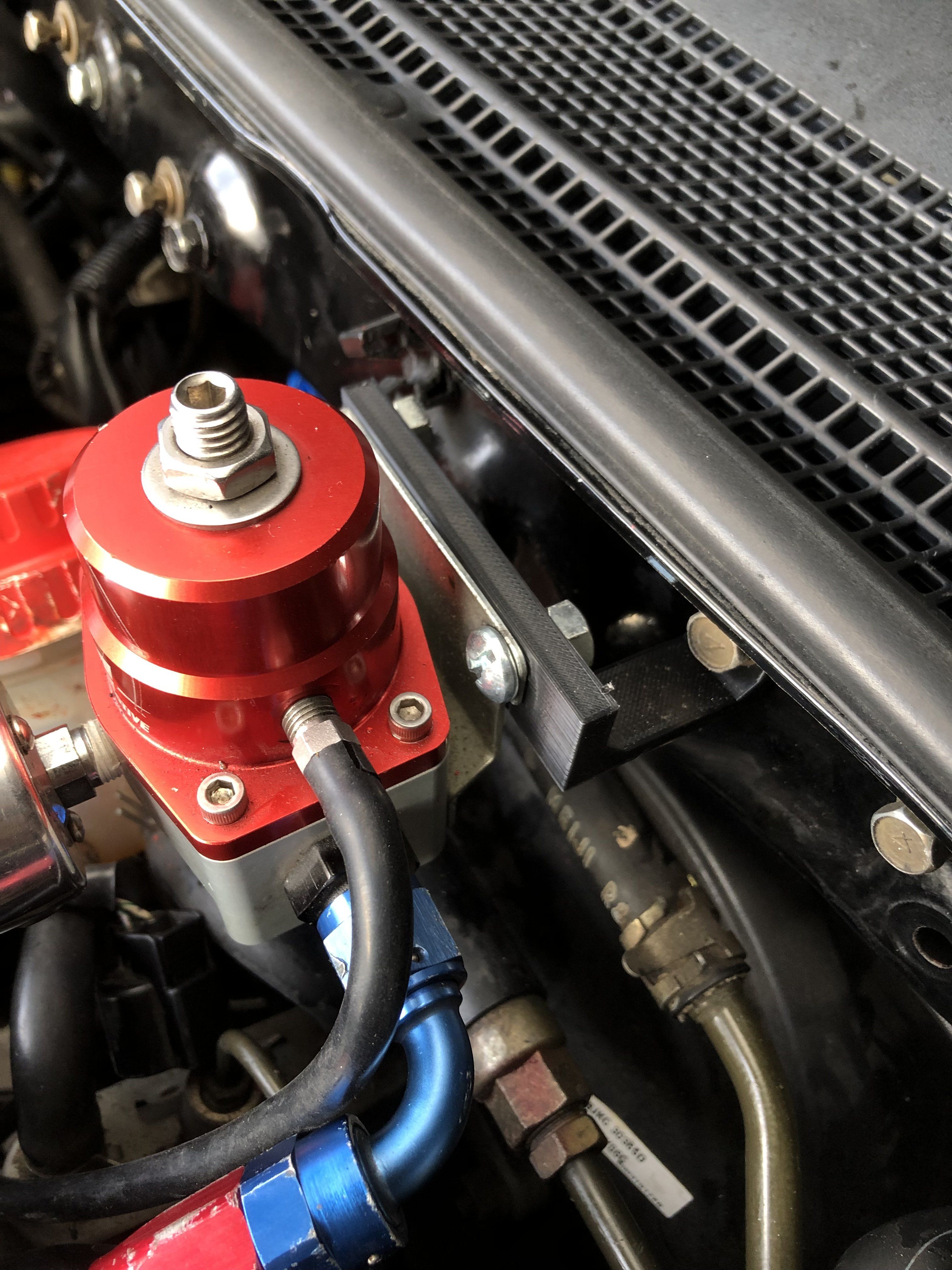

This line connects to a nice salmon-coloured AEM fuel rail, then to an afpr, and back to the stock hardline after some random barb fitting and a Crappy Tire (Canadian Tire for you ‘muricans) fuel line.
Around this point is when I tested the entire system, had to ask the DSM overlords about how to adjust the AFPR, but now I have blessed fuel pressure.

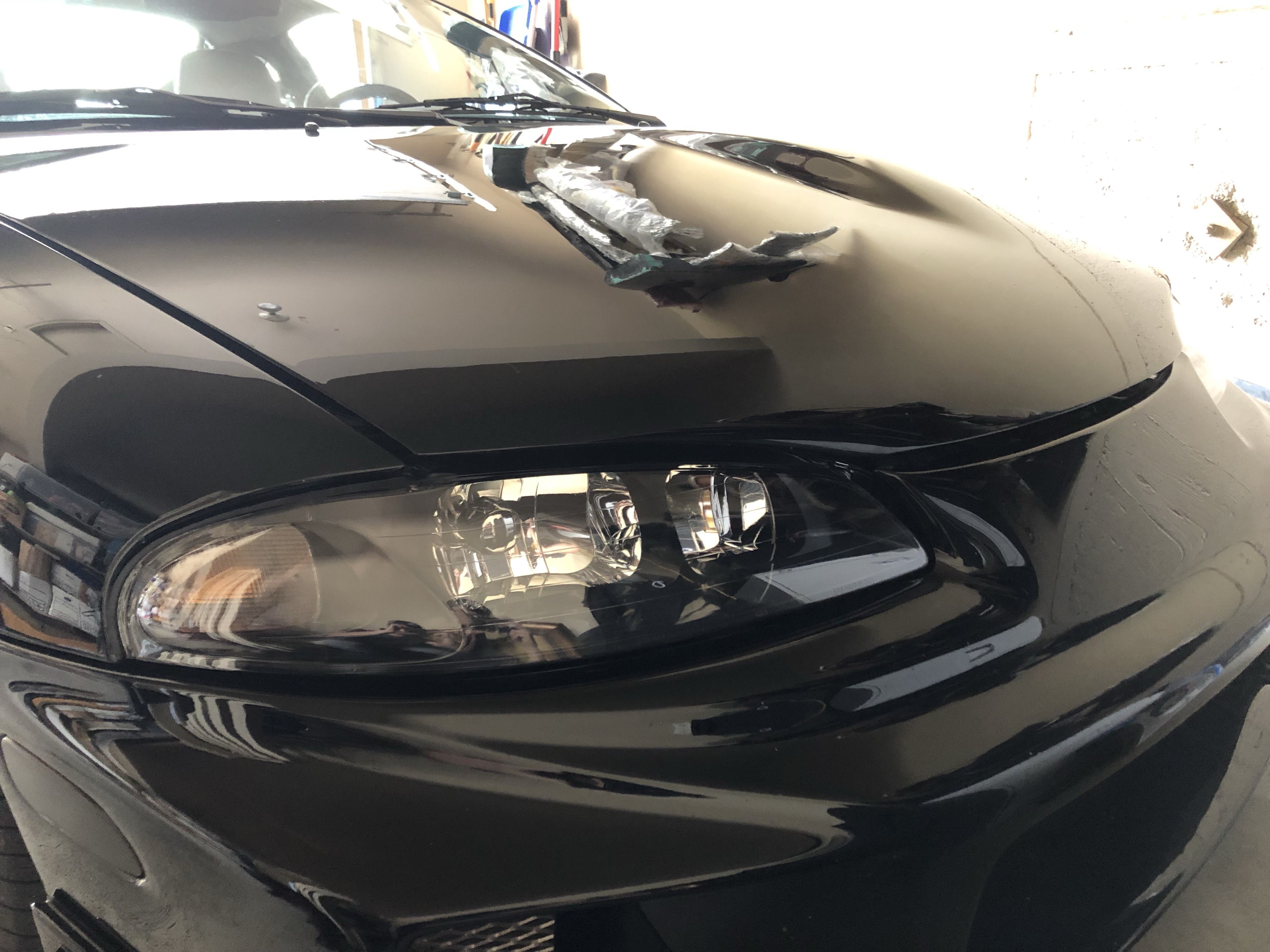

I previously had these tinted halo lights and they were loosing their glam on me, so I changed out to some brand new headlights.

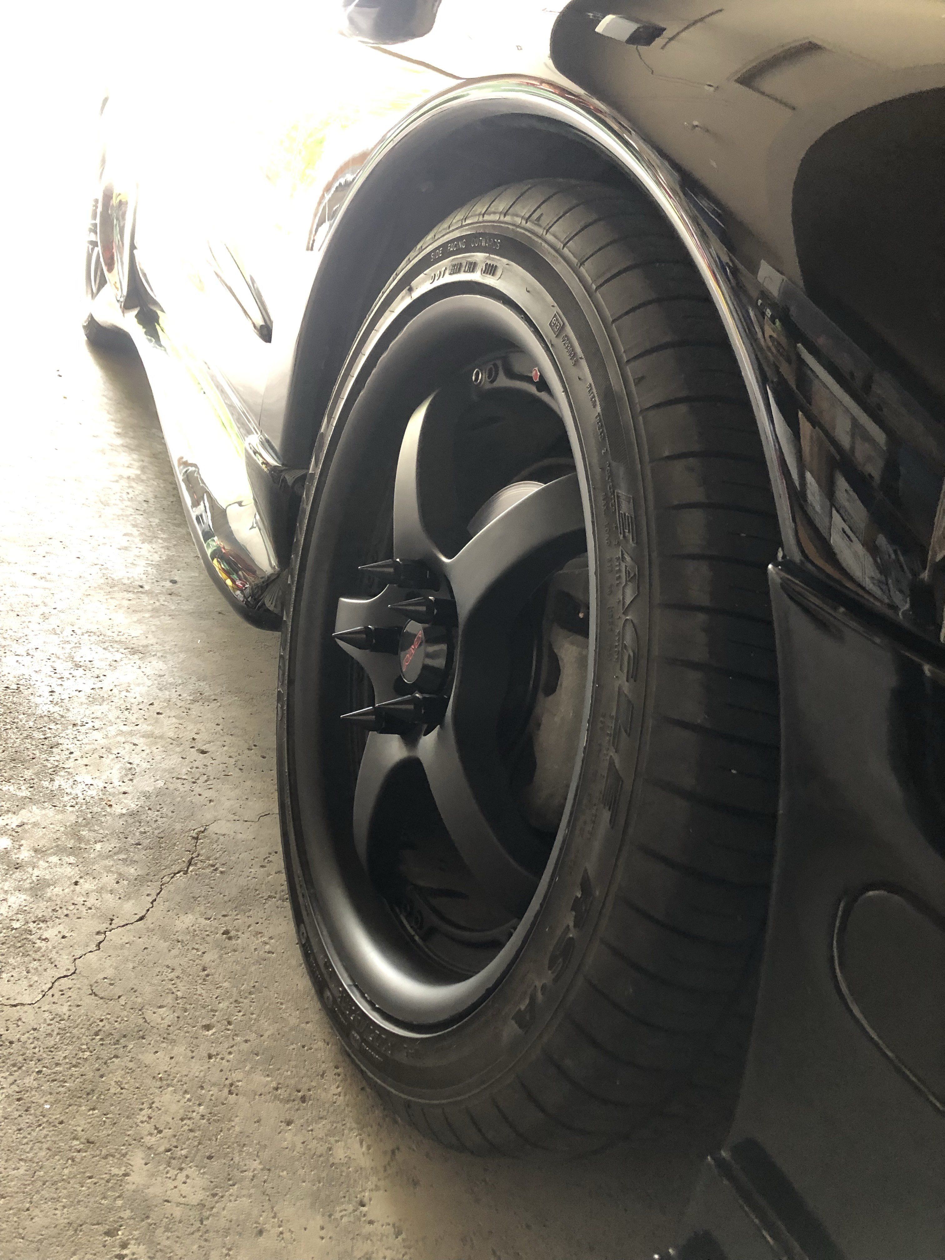

Now this next one might not be a favourite for most of y’all. I picked up some new wheels with a bit more offset and meat to fit the wheel wells better. Since I’m a 12-year old boy I wanted some hot-boi spikey lug nuts. Honestly I’m still not too sure about them. Luckily I can just unscrew the spikes from the lungs and have normal black lug nuts if I ever change my mind.

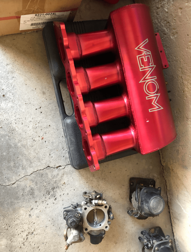

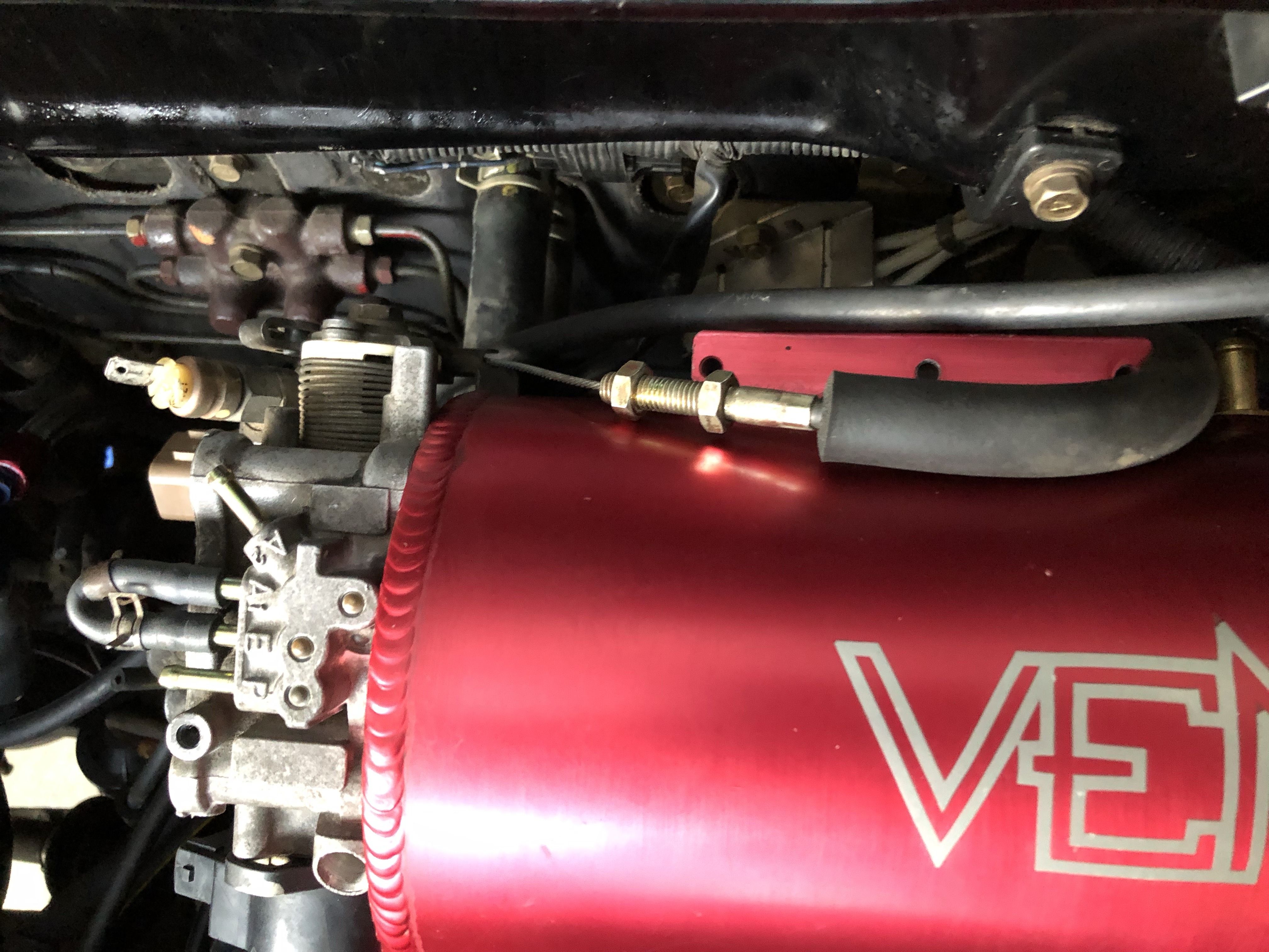

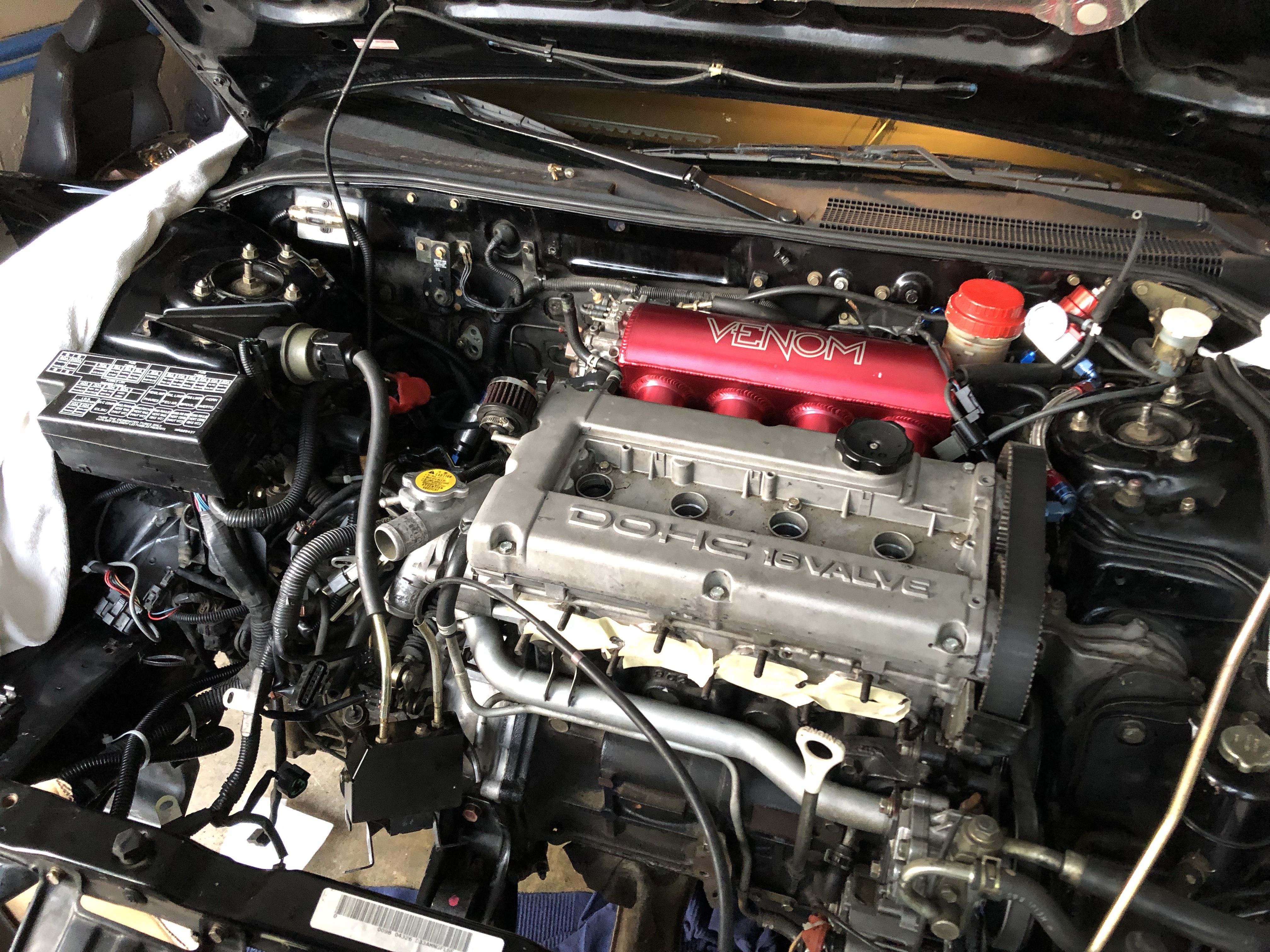

I haven’t installed my venom intake manifold yet mainly because it has issues with the throttle body. The throttle cable thing hits the manifold on both 2g and 1g TBs, which makes them both not bolt up to the manifold. I read somewhere that it’s meant to be used with the Q45 TB, so I’m just keeping my eye out for something at PnP or classifieds. If anyone has one that isn’t doing anything HMU!

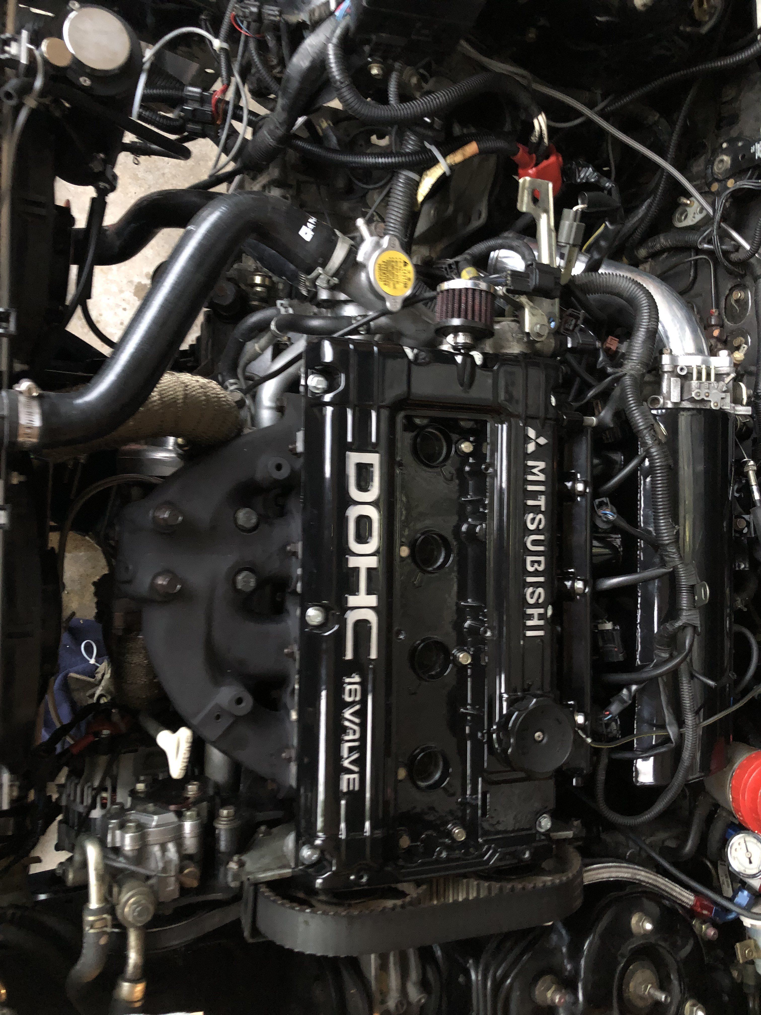

So the car was running really well for a week and I decided to take it apart again. The E3 16g was having horrendous boost creep issues: set at 17psi, would jump to 21psi and settle back again at 17. This is fine as I havae enough fueling but it sucks for when doing a pull because the car feels like it falls flat on it's face.

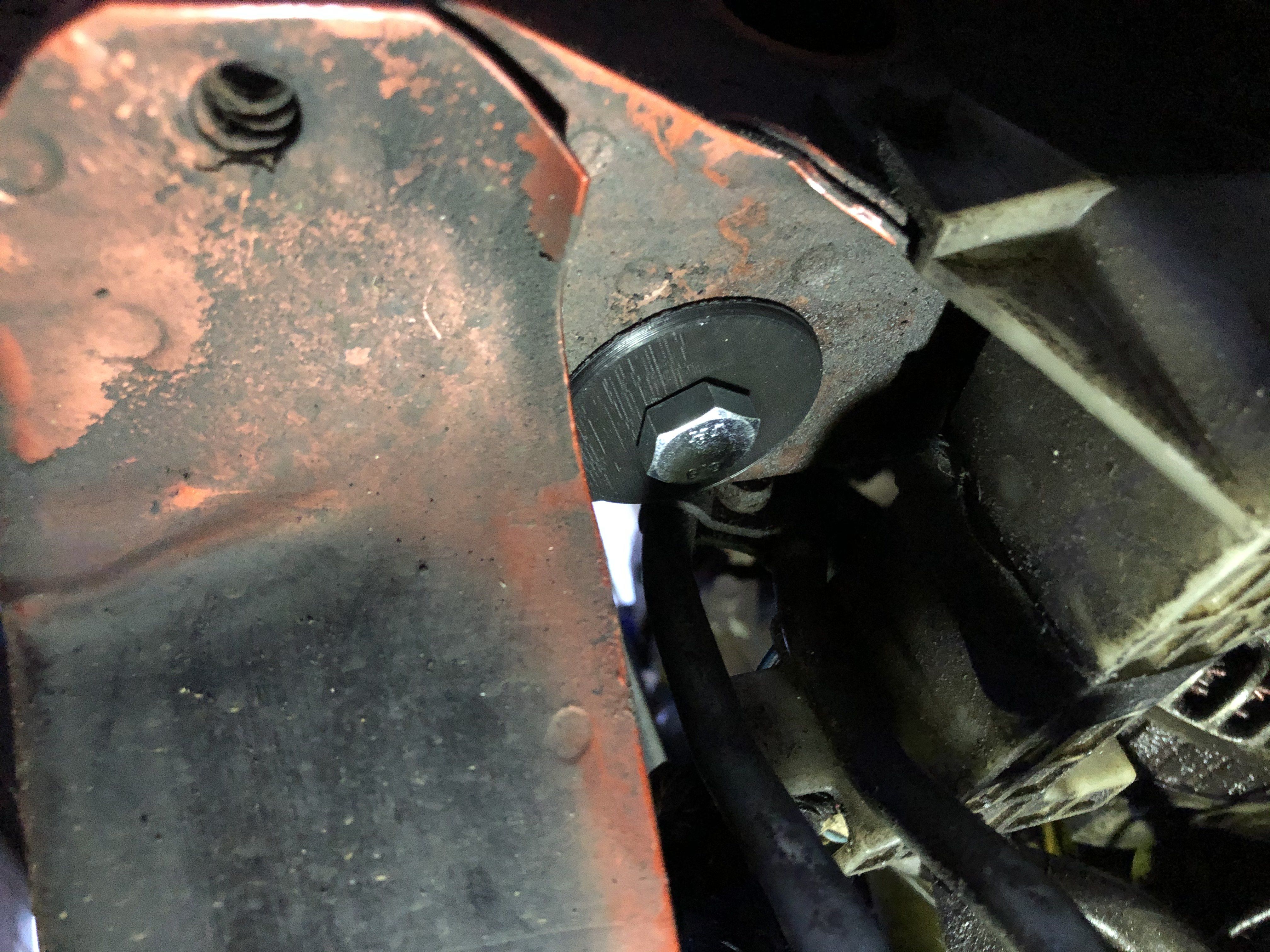

I completely deleted AC becuase, ever since I've owned this car, I've never used it. I salvaged all of the lines just in-case I want to put it back in. There is so much space now! and the AC condensor weighs a ton! I started mocking up the intake manifold. I thought I would need to make a throttle body spacer but it looks like a 1g TB fits really snug on the manifold, the only issue was that it hit that black throttle wire box thing. I've always hated that box, it's ugly and it makes the throttle cable wrap all the way around the engine before coming back to the manifold. It makes sense from a not-trying-to-kink-the-line perspective but what about my beautiful engine bay? Long story short, I'm deleting cruise control, and I am going to try and make my cable go straight from the firewall to the TB.
The idea so far is that where those two nuts are, I will basically make a bracket that gets held inbetween, and connect that bracket to my intake manifold throttle cable bracket thing is supposed to go. This gives me not too much adjustability but hopefully enough. I am worried about this little thing wrapping above the intake manifold in this picture. When I was fitting it up, I didn't want it closer to the firewall for the cable to pull itself out, and it was almost too long if I put it under the intake manifold. So I put it above like this and it was basically perfect, just worried about if bending the line that aggressively is a really bad idea or not.
Well today I'm hoping to drop a bunch of engine bay stuff off for powdercoating (intake mani included) so I'll have to continue that later anyways. I have an OFH leak (honestly not even sure from what gasket or oring) and some very minor rust appearing on the front end that I am going to clean up and paint over. I HOPE this car will be up by this next weekend, I suppose it depends how fast these RTM gaskets get to me.
Getting closer to this whole problem being finished. Needless to say, the intake manifold was not easy to bolt-up. I had to get a 1g throttle body, and delete the black throttle cable box (I was already planning on deleting cruise control, but this brought a whole new challenge of creating a bracket to have the throttle cable go directly to the TB. The intake manifold puts the TB at a steeper angle so my TB elbow is far from bolt-on, It's almost hitting the tranny. I figure I'll connect the intake piping with that flex pipe of whatever and drive the car to a buddy to weld the elbow at the proper angle. While everything was apart, I decided to get a few things powdercoated:

So I had an extremely hard time fitting up this manifold, turns out it has a crack somewhere and is creating a vacuum leak. Whatever, I threw it to the side and put the stock one back on. One thing I’m getting really invested into is 3D printing mounting solutions in my bay. This is only the first iteration, which means they aren’t perfect but I made a mount for my AFPR, catch can, and TB cable.

Funny situation happened last night, the AFPR mount was half an inch too high, so when I put the hood down to test drive last night, I completely snapped the mount (wanna guess where is snapped? Hint: it’s 90 deg and a corner). Guess it’s good I was planning for revisions.

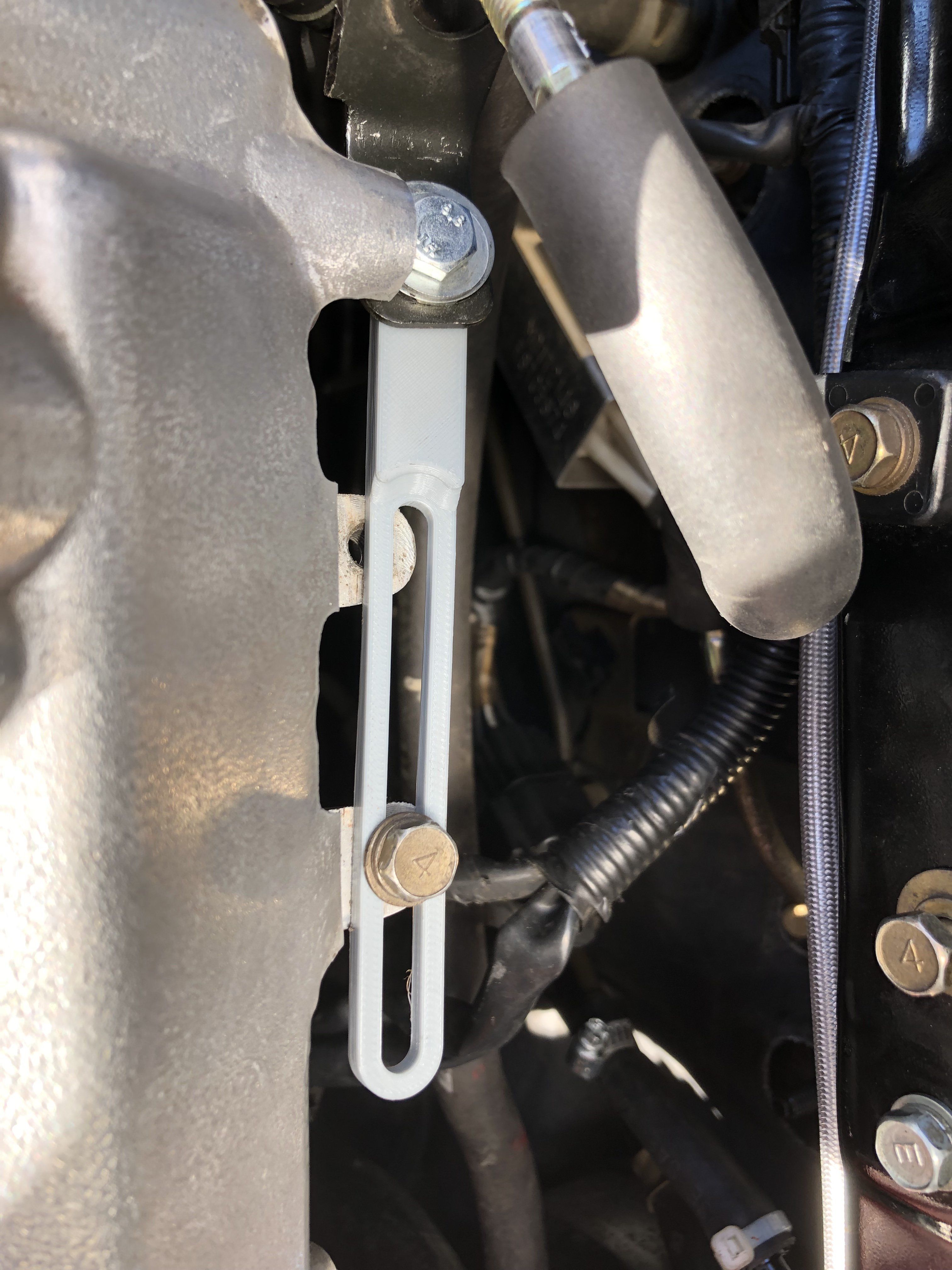

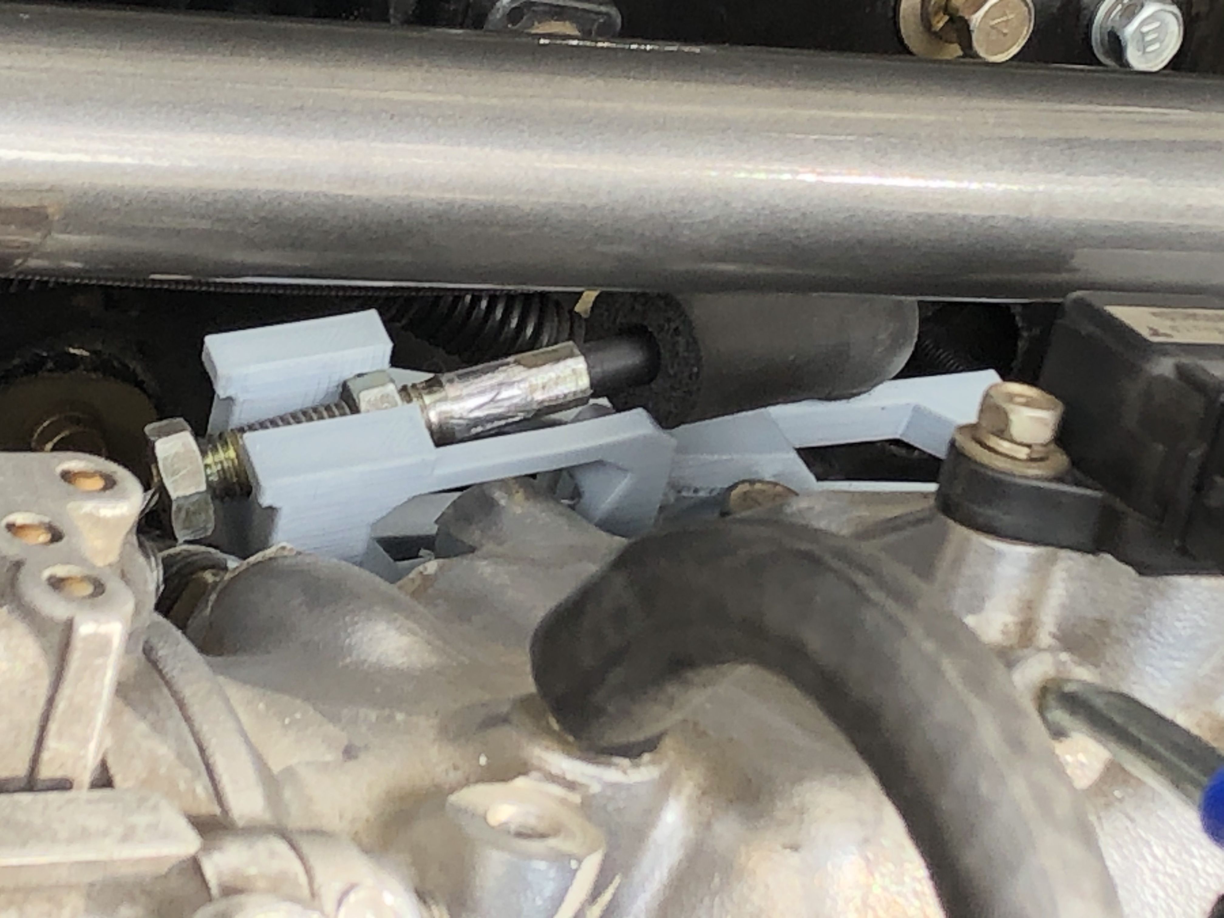

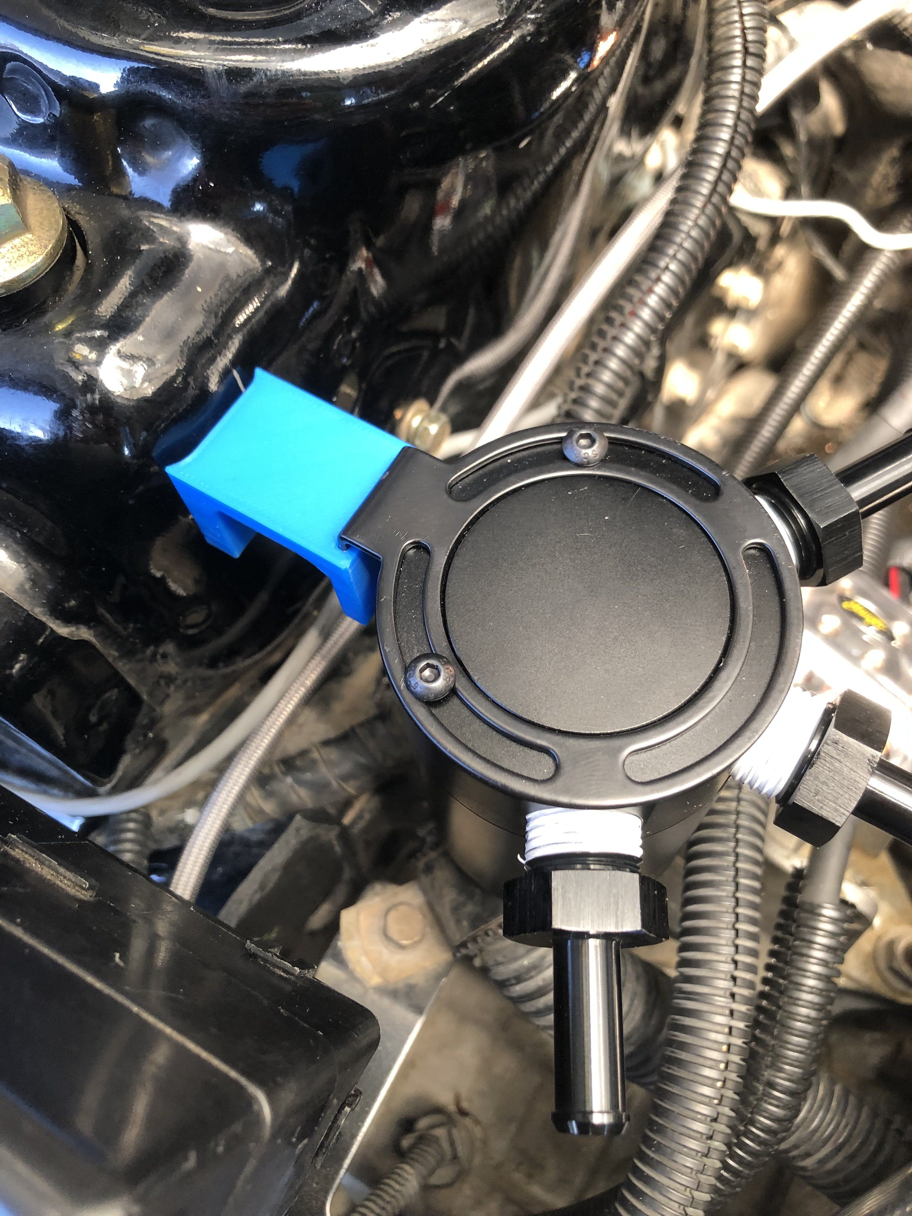

I’ve been working a lot on this 3D printed throttle body bracket. It’s a good alternative to buying the $200 non-cruise control cable. It’s on it’s 10th design iteration and finally good enough to drive around. I still want to do some more revising before I forget about it. The main thing I have to battle is the flex in the plastic.
I had an issue with one of the designs, where the throttle cable would pop out of the bracket, but now it has a little roof thing that keeps it in place. I finalized my catch can bracket, looks pretty clean imo.

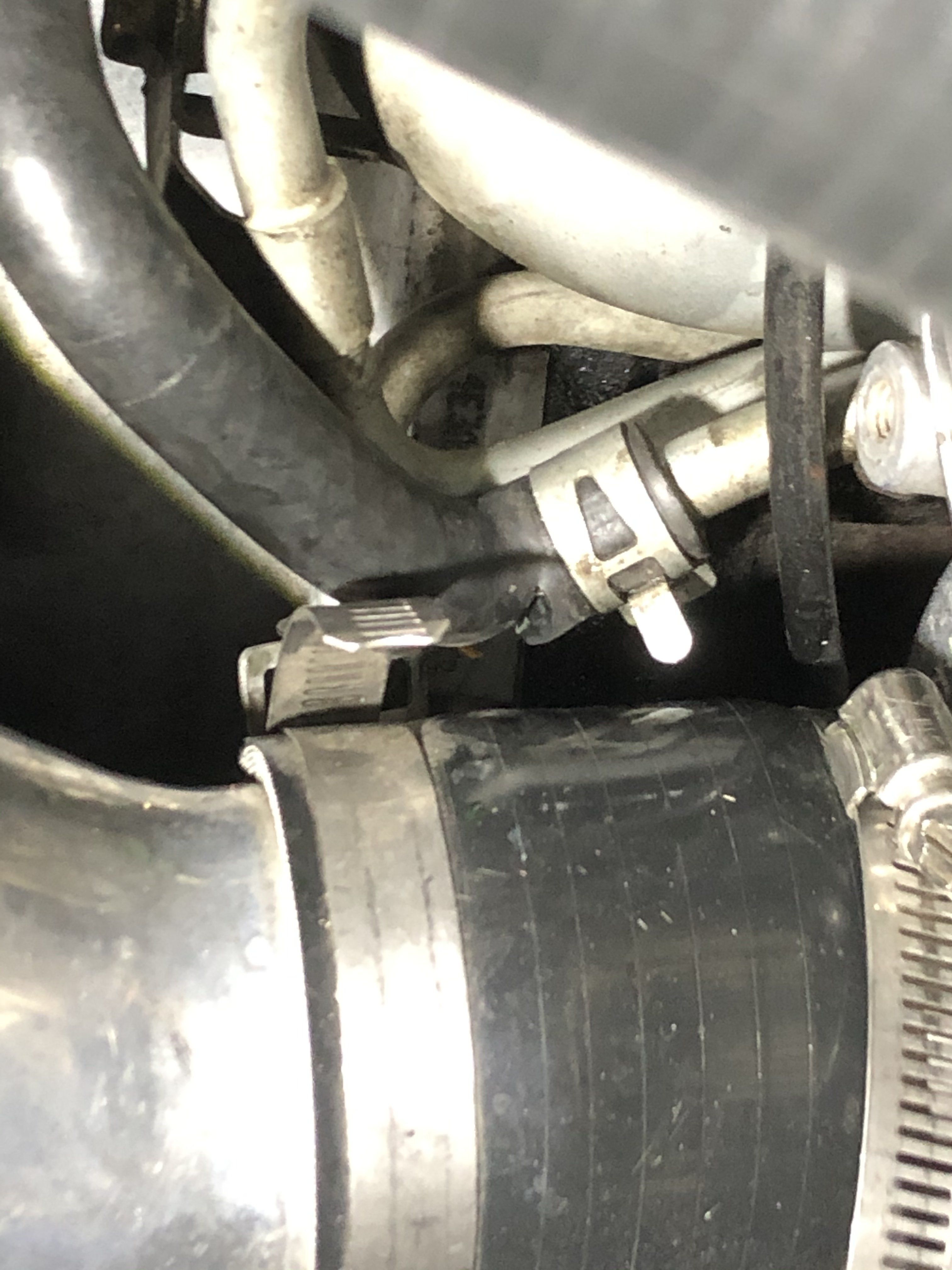

Never had this kind of issue before but basically I called the tow because I started leaked a ton of coolant, and I didn’t want to deal with it in the middle of downtown. I thought it was much worse than it was, but it was just this little hose that split because of too much pressure? Either that or heat but pressure seems more likely.
It was awfully lucky, just a 5 minute fix this morning. Next on the list for this car is figuring out why my Wideband is not reading anything, getting some headstuds, and tuning her. I will make a few more changes on that TB bracket and might offer it to people if there is any interest. It’s not the most formal solution but it’ll be a way to do a cruise control delete without having to buy the $200 (CAD (RTM)) non-cruise cable and it’s cleaner, the cable just goes from the firewall straight to the TB.

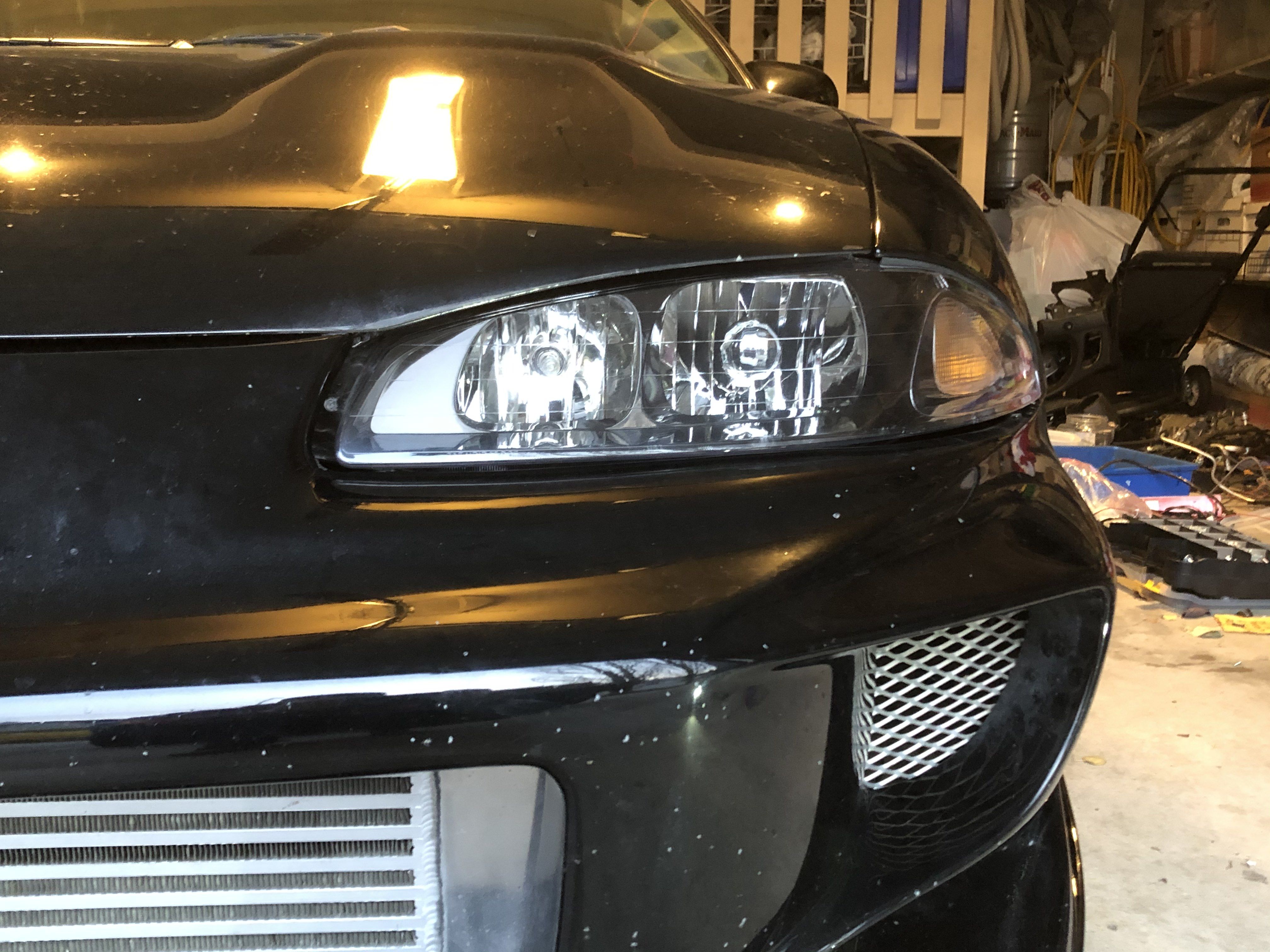

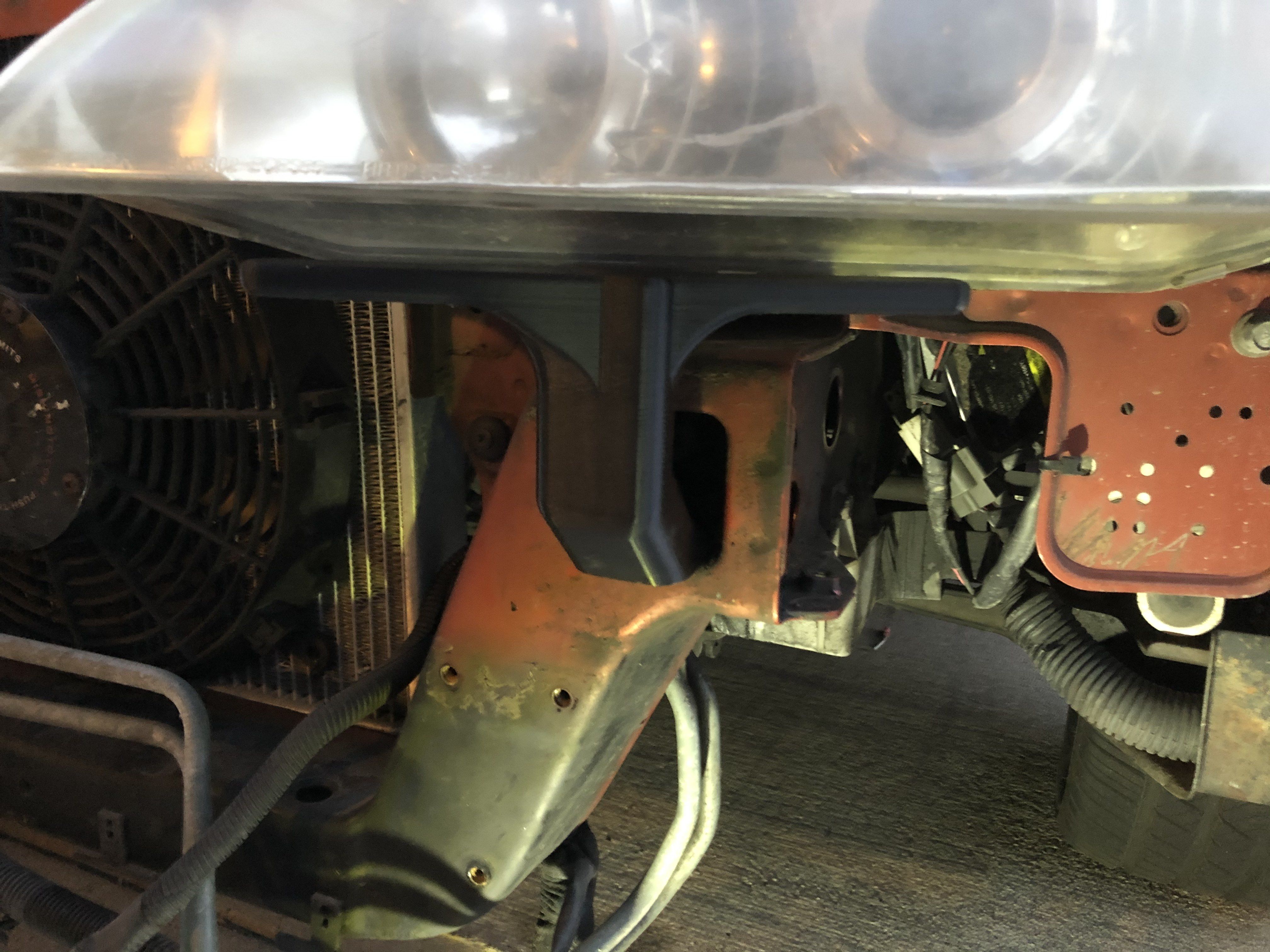

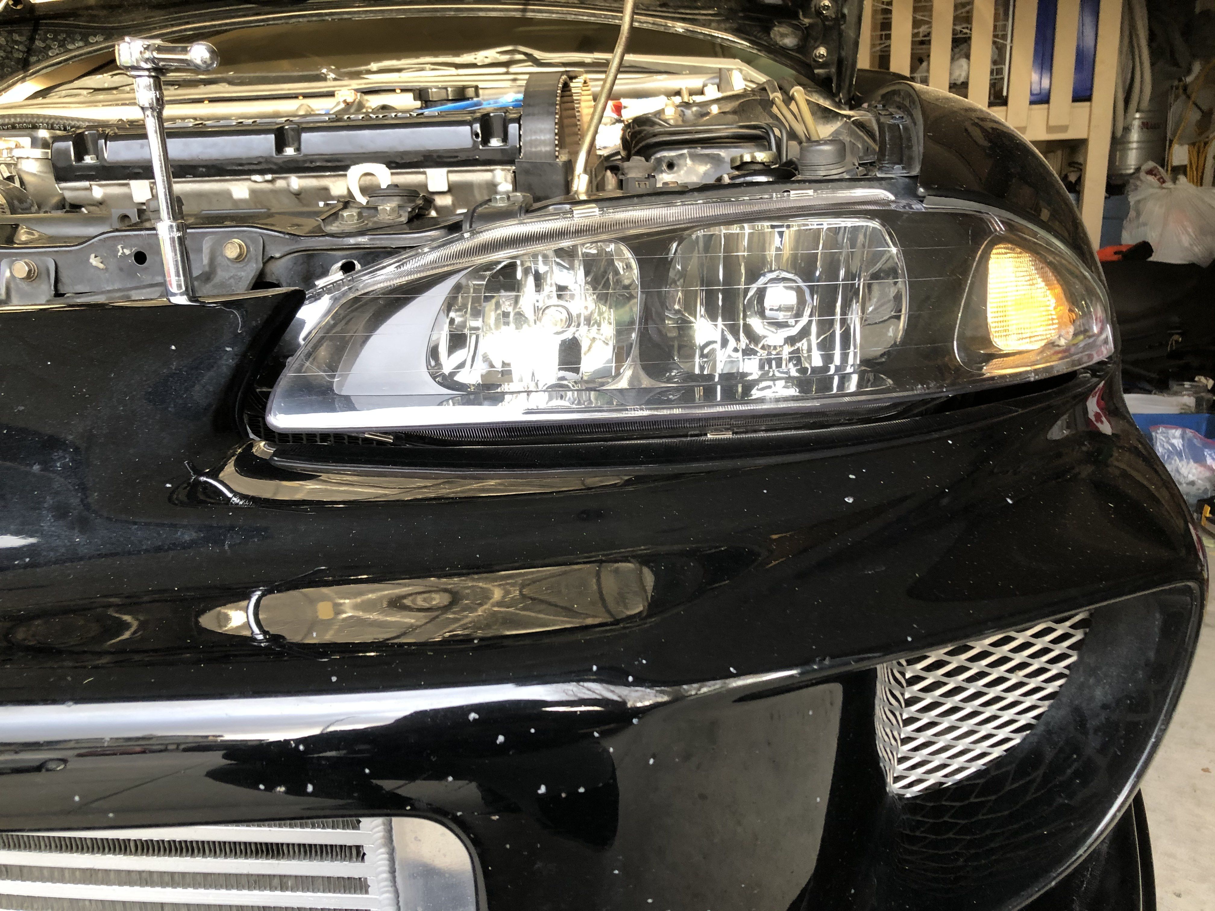

Don't mind my gap in-between the side of the headlight and my bumper, the bumper is made for other headlights but I make it work. I'm thinking I might offer this as a cheap, adjustable (slightly), and on-demand option for bumper-risers (as opposed to those metal ones). I'll make a formal interest thread once I print out a bunch of different colors and choose which ones I want to offer (I also need to fit it to my eclipse to make sure it fits an oem bumper, but I'm pretty sure it will considering I took the measurements from the eclipse in the first place).
Also: don't make fun of my rock chips :( I live in rock city and I just don’t care.

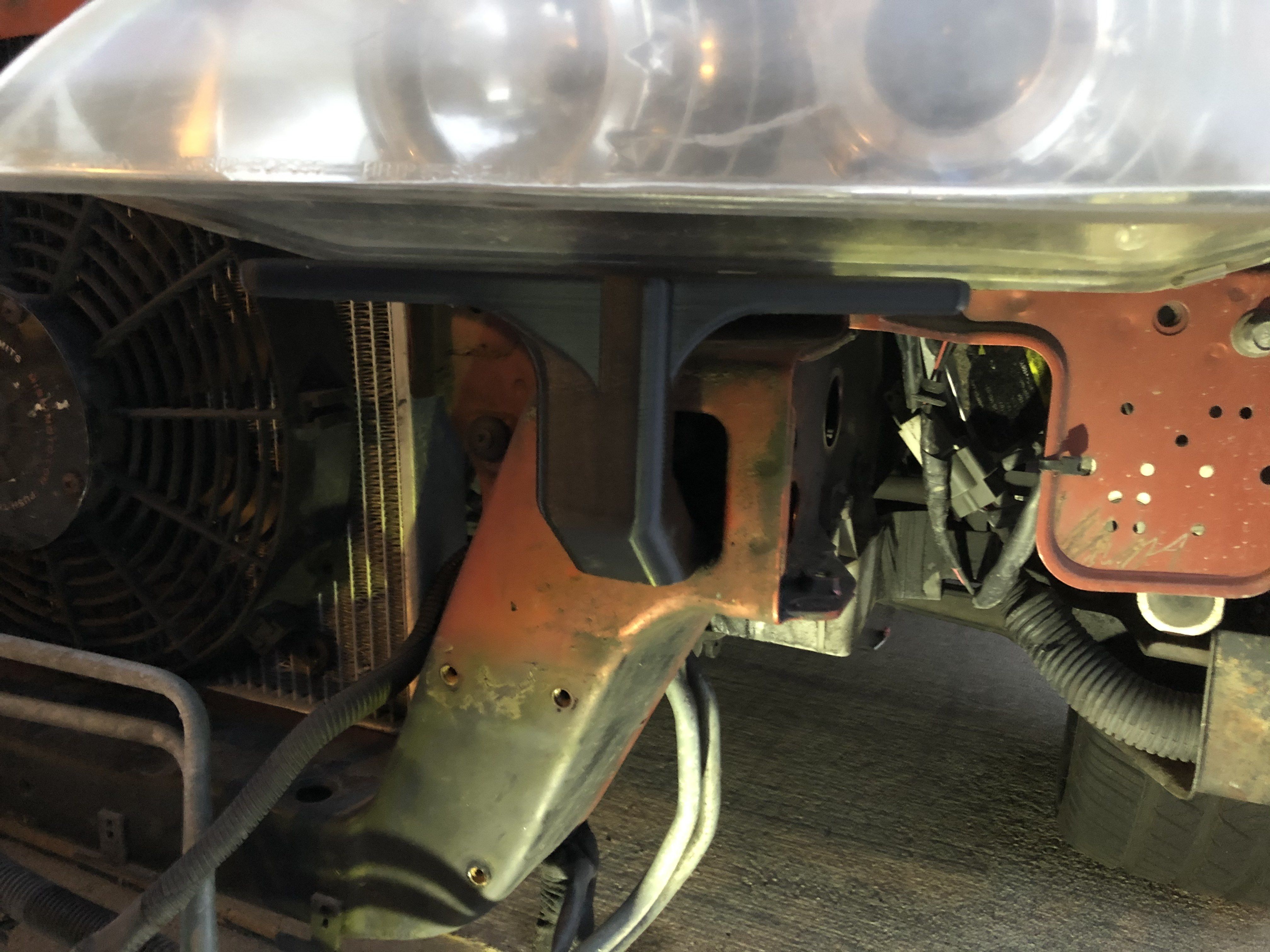

Sorry for the late reply. Didn't want to take off my bumper another time to show the part so I fitted the risers on my eclipse. Here are some pics. When I start offering them, they will come with all of the hardware pictured. Took me a total of 1 minute to install once the bumper was off.

Excuse the mcnasty frame. This is my long-time project car, just sits outside and collects grime (for now).
So I see that you have deleted your bumper support rails, as this would not work if you still had them. Just hope you don't get into an accident, or it'll tear your bumper right off.
Ahaha, yeah. Have to delete the front crash bar to fit an FMIC. People debate about it, whatever, I feel like my metal fmic will probably do more in a crash than the fibreglass bash bar. This is for people who have an FMIC, deleted the crash bar, and don't have that stryofoam thingy that supports the bumper anymore.

This must only be for body kits because I ordered a bumper from Ebay, stock replacement, and it fits very well. Not a noticeable gap there. Less than a half inch anyway.
That was a good idea though!

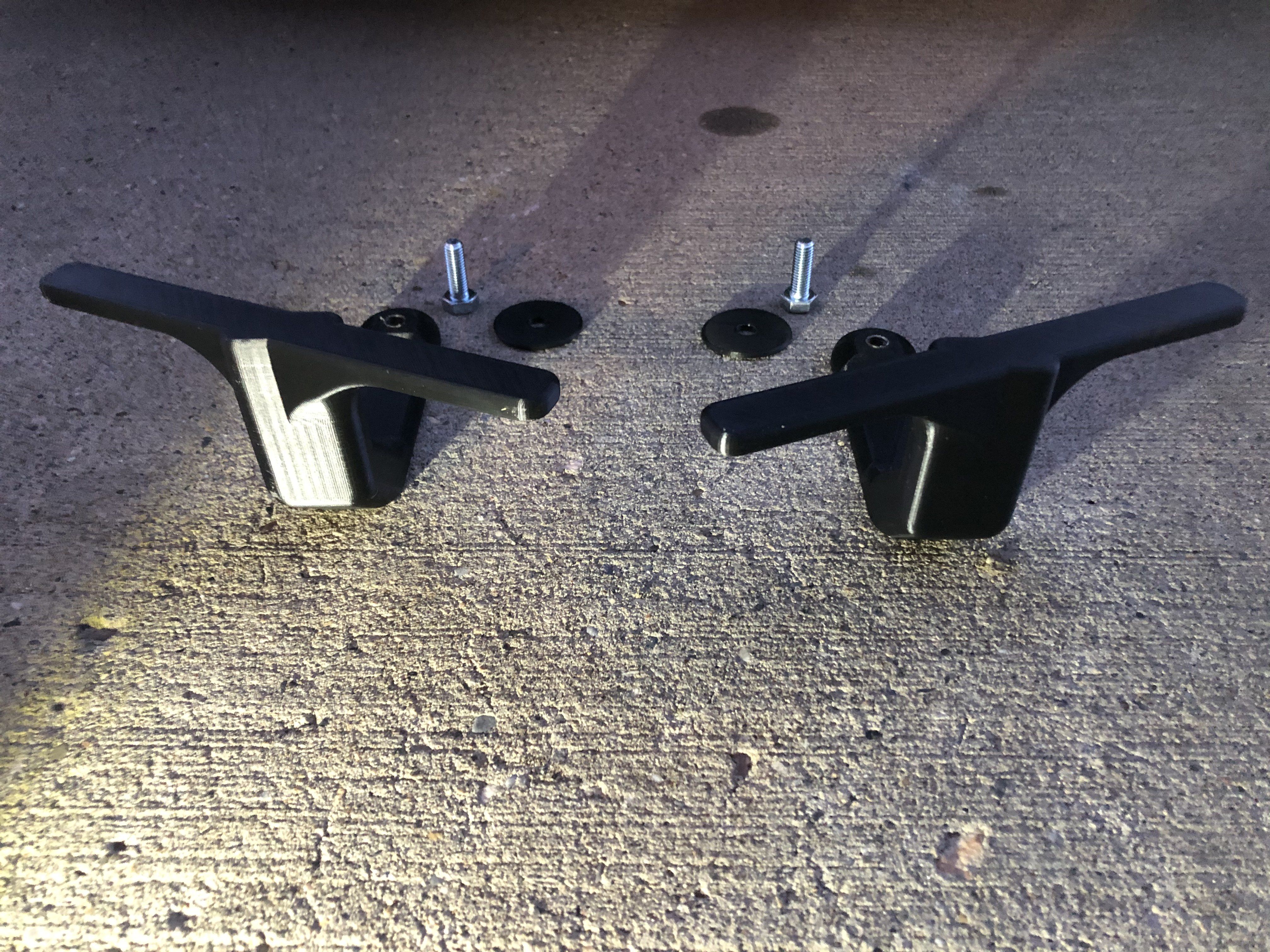

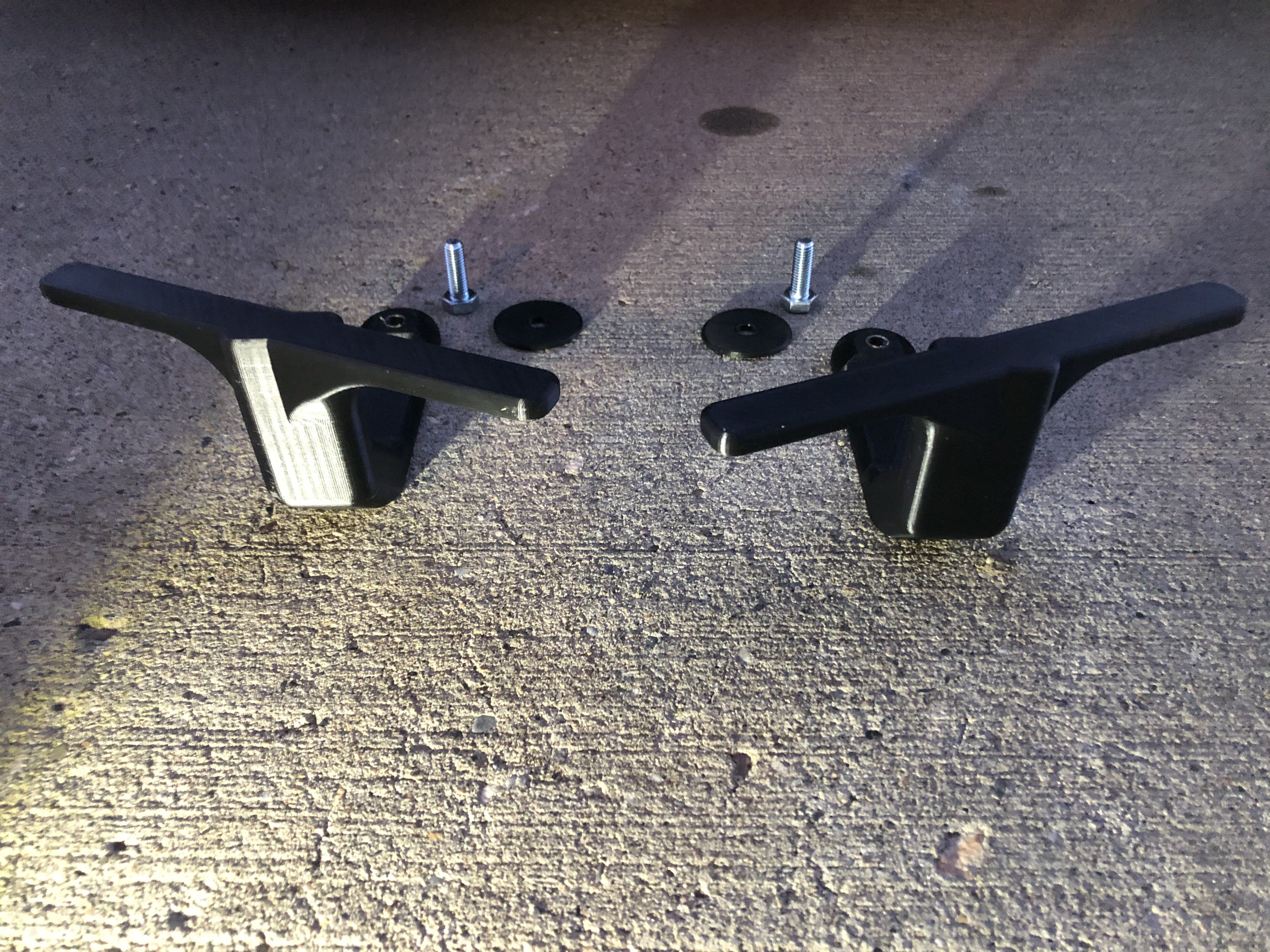

I haven't figured out shipping and stuff yet. I'm hoping ~$60 USD shipped for the pair + hardware. I will make a formal interest thread once I get a bit of stock because they are convenient to print, however, take some time because they are a big, and 100% infilled parts.
Some things to note:
They are designed to be a bit flexible, but have tension upwards to pull the bumper towards the headlight. It may take some getting-used-to to get the bumper on/off.
They are 100% infill, which means you can freely drill holes or shave stuff down to fit your setup.
This must only be for body kits because I ordered a bumper from Ebay, stock replacement, and it fits very well. Not a noticeable gap there. Less than a half inch anyway.!
I have a stock 2gb eclipse (with a crash bar delete obviously) and it has the same gap, even worse than my talon actually. Do you still have your crash bar and styrofoam? Pretty sure the styrofoam is what holds up the bumper stock. If not, there is chance you just have a pretty rigid bumper and those side bolts are holding yours up. Also, if it's worth the half-an-inch, in your case, is totally up to you, my gap is ~1-2mm now.
I do still have the foam crash support, I didn't consider that that helps some.

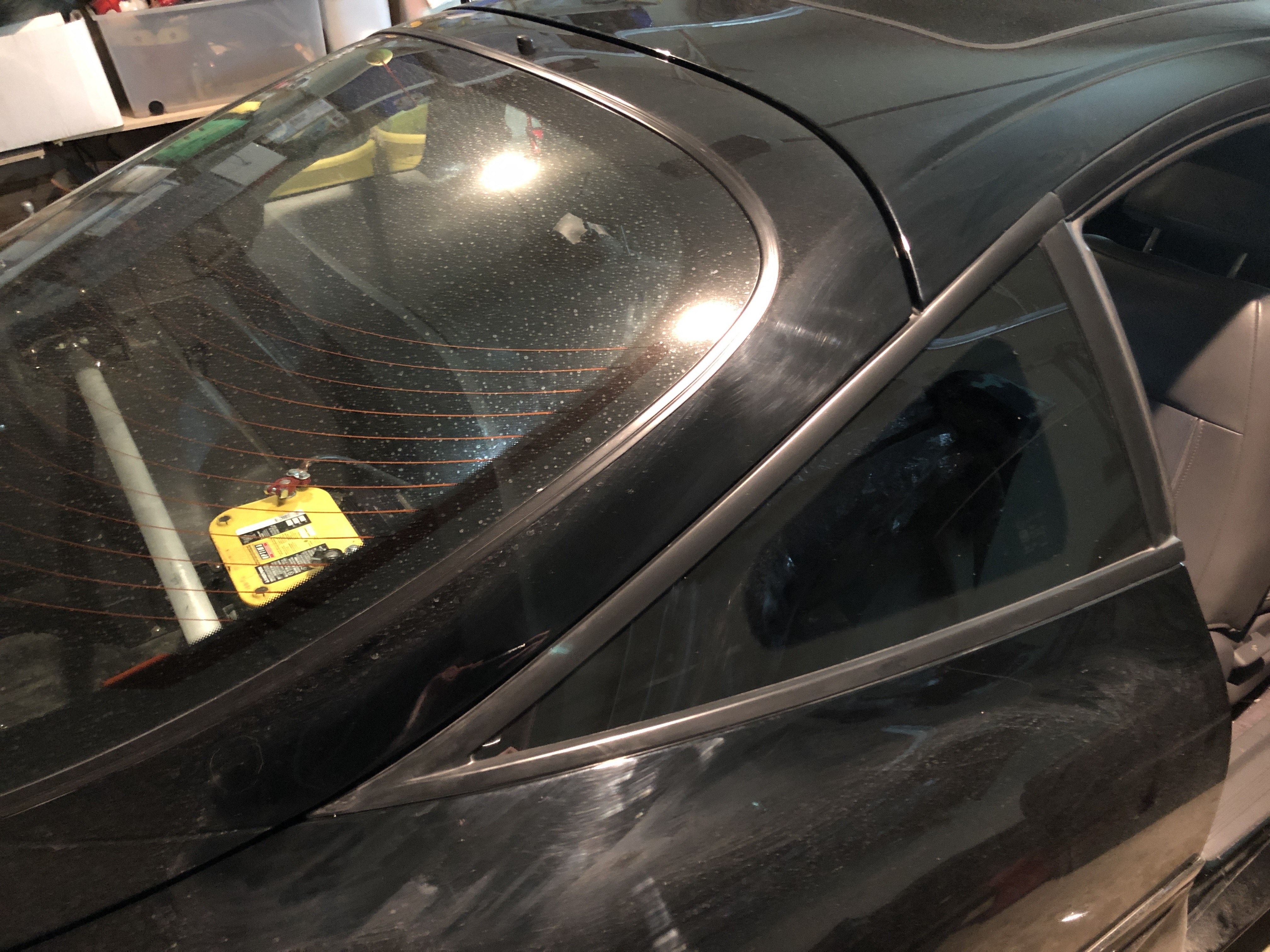

Oh I also wanted to try out tinting. I got some of the 5% heat blocking stuff and I want to put it on all the windows that I legally can. I already used some tint for another house project so I had some practice and enough left to do both rear-quarter windows.
The finished product is great. I'm surprised at how easy it was. The only thing that bothers me is the factory black stuff. I'm not sure if I should have taken it off, then put on the tint? Can I even take that stuff off? I figure it would look a lot cleaner all-tinted. I'm considering on making 3D printed rear quarter windows. I'm working to see if there is any way I can make them clear, and pretty lightweight, so I'll probably just hold off on the tint dilemma for now. Either that or just basic polycarbwindows.
Also, I would do the hatch window to completely eliminate the fishbowl but the tint I got from crappy tire isn't wide enough to cover the entire window. I don't want any lines or anything so I either have to go a different route or really finesse two pieces of tint on the hatch.
