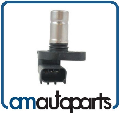

Just because I did it on my Avenger... Is the crank sensor plugged in? It plugs in on the back of the block near the alternator. I am pretty sure the ECM will not power the coil if the crank sensor is not plugged in and functioning correctly.

Did you check the crank sensor while you were out there? I am not kidding about no spark if the crank sensor is not plugged in.
it is plugged in. Can I check it for power like with a volt meter? If I can and it doesn't have power then what? If it does should I replace the sensor? Thanks a lot man. I have dumped so much cash into this car this year. Wife is about over it. :sosad:
umm, im not sure, the CPS is located right at the crank, it should be a hall type sensor. you know what that is right?
