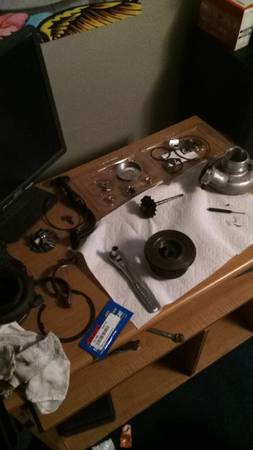

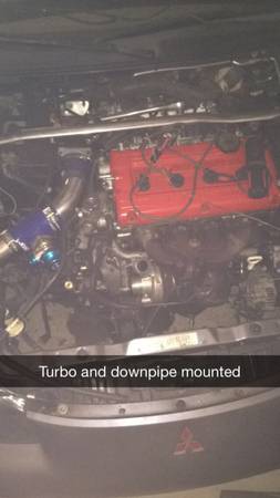

After ripping everything off I dissasembled the turbo carefully remembering where everything went
Now I started bolting it back on and after putting it all together it ran good!

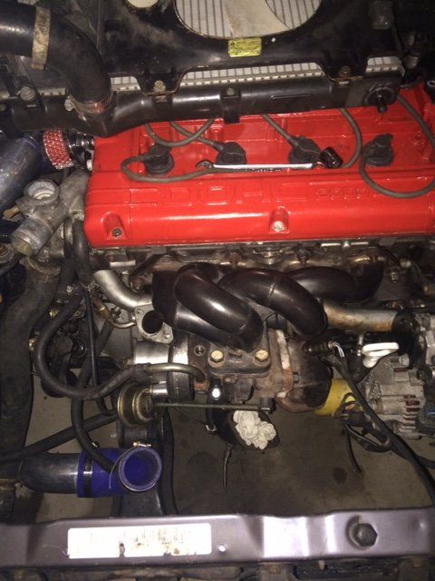

Now after having the car for a month I scored a deal on an ebay 20g and a cool manifold. I know I know I paid for the mistake. I also got a new j pipe perfect for the setup from a 1G friend. Basically I ended up getting a 14b on it to daily. Plus too many oil problems of leaking and stuff not sealing.

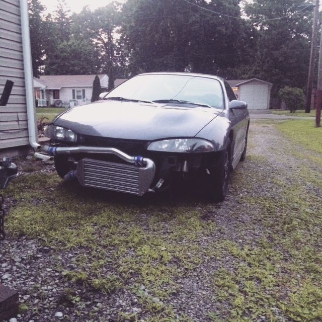

So I swapped the 14b on and started to daily this DSM. Through out these months I have been cleaning the car up a bit and cleaned the interior up and bought new carpet. Also have been making the hack stuff go away and make things right. ALSO I traded my clean 2004 cavalier daily for a 1992 Laser AWD. Has a small handfull of mods but was for sure taken care of from past owners, the PO not so much though. All he did was drive it till the 14b died and the downpipe rattled itself off and the VC gasket leaked all over. Moving on to the car in this story though haha.

-14b setup

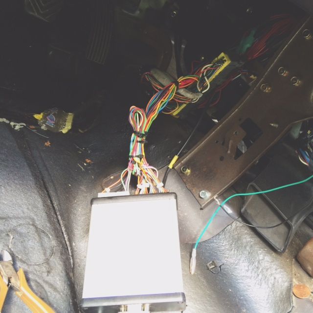

-un hacked GM maf setup and all wiring
