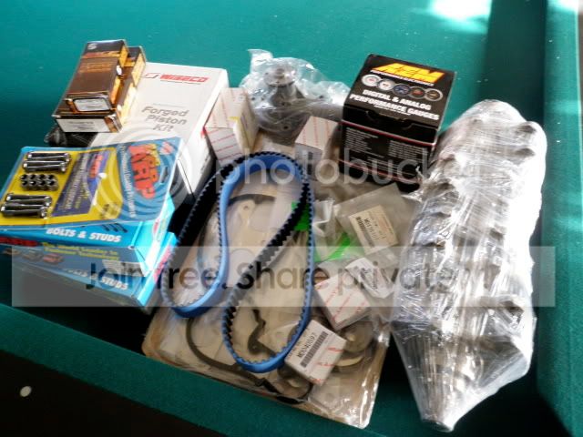

Everything is here!
Mitsubishi 6 bolt crankshaft
Wiseco .20 over 8.3:1 forged pistons
ACL Race main and rod bearings
ARP main and head studs and rod bolts
Gates Racing timing belt
Mitsubishi BSEK
Mitsubishi tensioners and pulleys
Mitsubishi water pump
Mitsubishi engine gasket kit
ITM 3g lifters
One big (and expensive) step closer!!!
