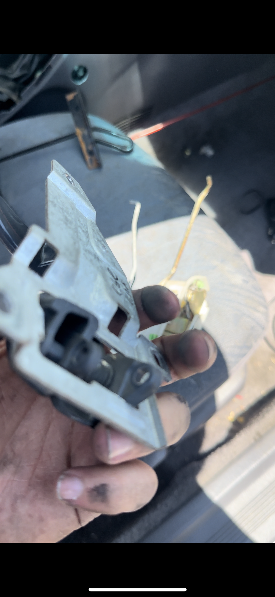

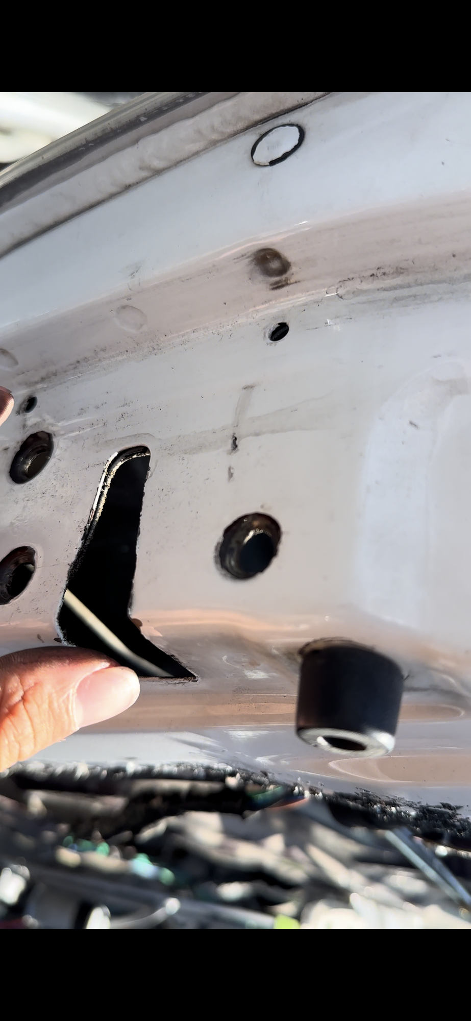

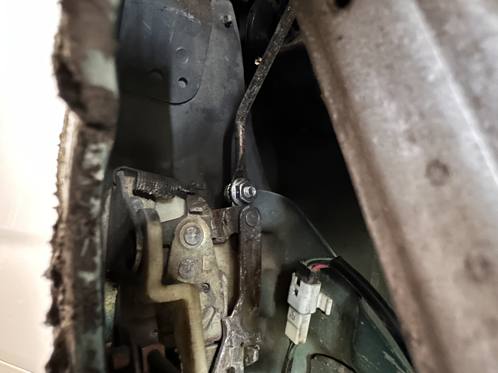

I got to fixing both doors that don’t wanna open. I added a 6M 1.0 10CM bolt to give it a better latch grip you can say? So it’s not much slack. Both now open but I’m stuck with a broken lock switch. Only able to unlock and lock from the inside on driver side door. Passenger lock works but clip is broken 😞 might just replace both entire doors LOL

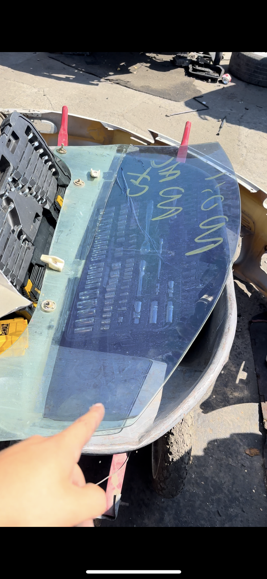

Picked up a window at junk yard because driver side window is non existent atm.. LOL

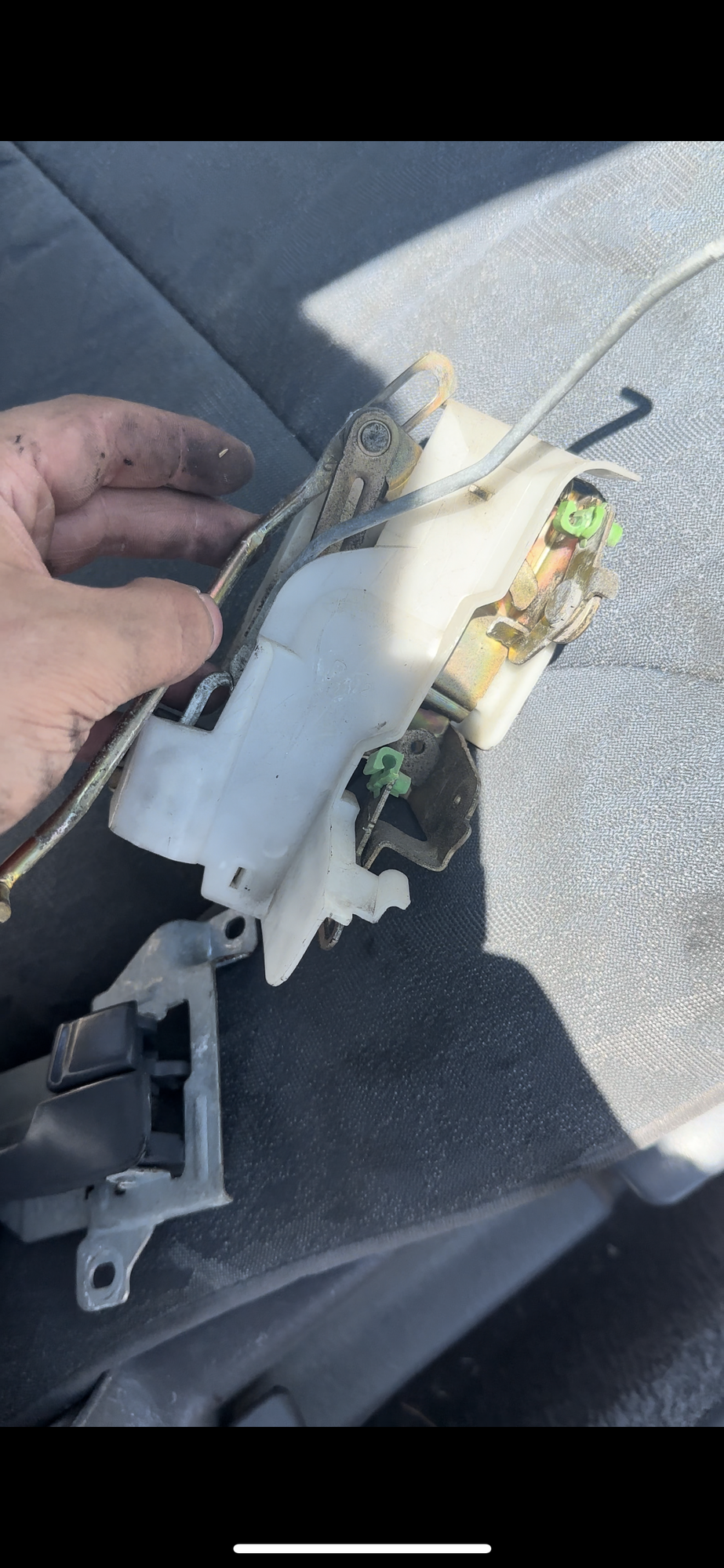

took both door lock actuators and passenger interior door handle because my current one was broken for the tab to hold in place.
Also took all the rod lock tabs I could find because why not LOL

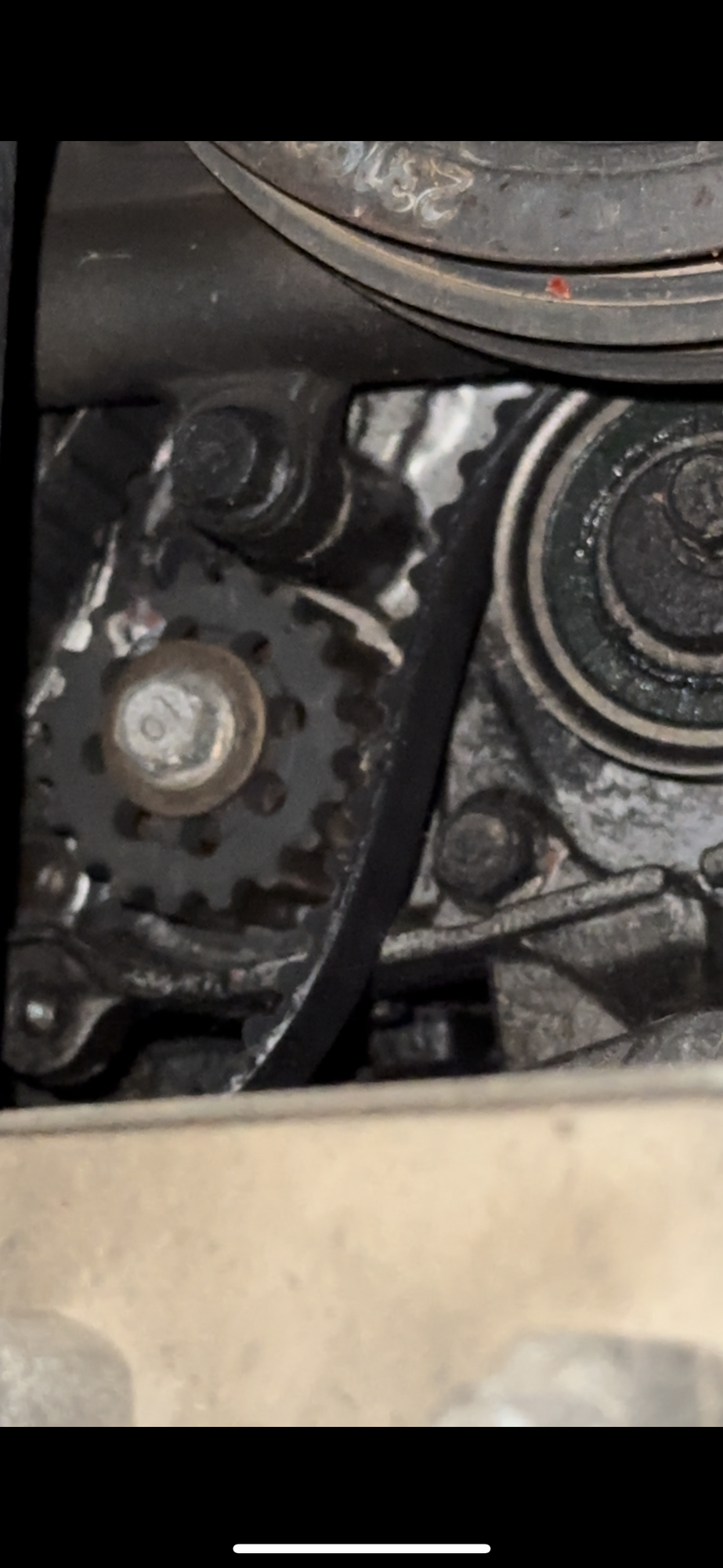

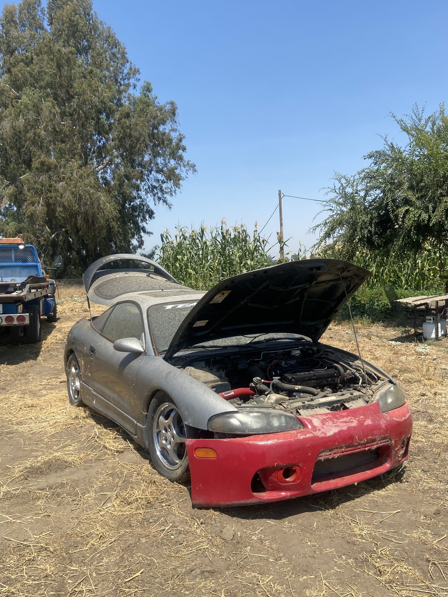

Finally got time to start up the car with a new battery, I didn’t expect anything but past owner said used to run before so it was the only small hope I had that it might start, totally did not and it’s what i expected. Noise was unsure to me , thought it might be bad starter or even a locked/seized engine.
I looked at the belt, I didn’t see the belt was not on, but it was on the cams.. so is why I didn’t expect it to be off.. turns out the belt was off :ohdamn: how did I not see this? I’m not sure I could have sworn I checked. Explains why the engine did not crank.
Next step is to see if motor is not locked. when I have time I will try to spin the crank and hope it moves with no funny noise. Either way the engine will be pulled apart to examine if engine is worth saving or getting a replacement/ rebuild.
That pic just looks like the balance belt. You need to look at the main belt.
Oh okay, will do when I get to working on the car again. What’s weird is I just did a quick check by pushing down on the belt where the cams are and it was pretty tight or normal. Wouldn’t it be loose if it wasn’t on?
It's a whole different belt. The pic is of the balance shaft belt, not the timing belt

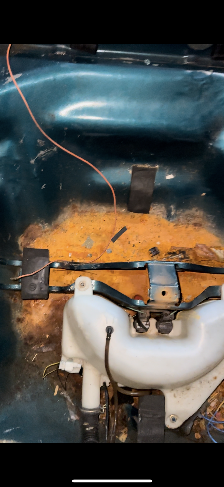

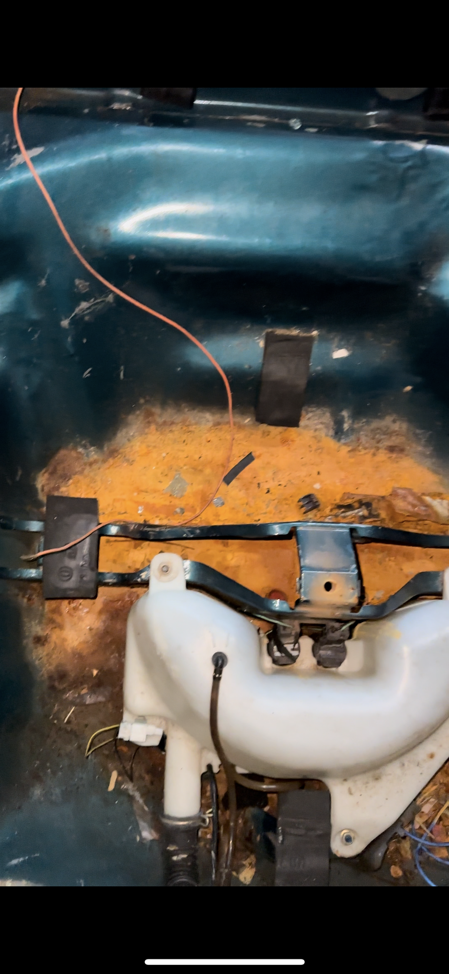

Today I got to cleaning up the trunk getting rid of trash and plastics in the trunk and oh boy I’ve never seen something like this! It’s a good thing I’m going to do a tire well delete anyways. I’m not sure how this even happens.
That's common, even in areas that aren't rust prone. The car now or in the past has a leaking rear hatch seal. The aluminum plate from Archer Fab will solve the rot, but make sure your hatch is sealed so nothing else goes wrong :thumb:
I checked seals and they looks fine, now that I’m thinking about it maybe they had dropped the rear window washer fluid or it leaked and past owner probably never noticed. Car sat 4 years before picking it up so I think that’s probably what happened since seals looked fine. Probably will replace them regardless since it’s a 15 mins job . But yea archer fab will definitely be done:p

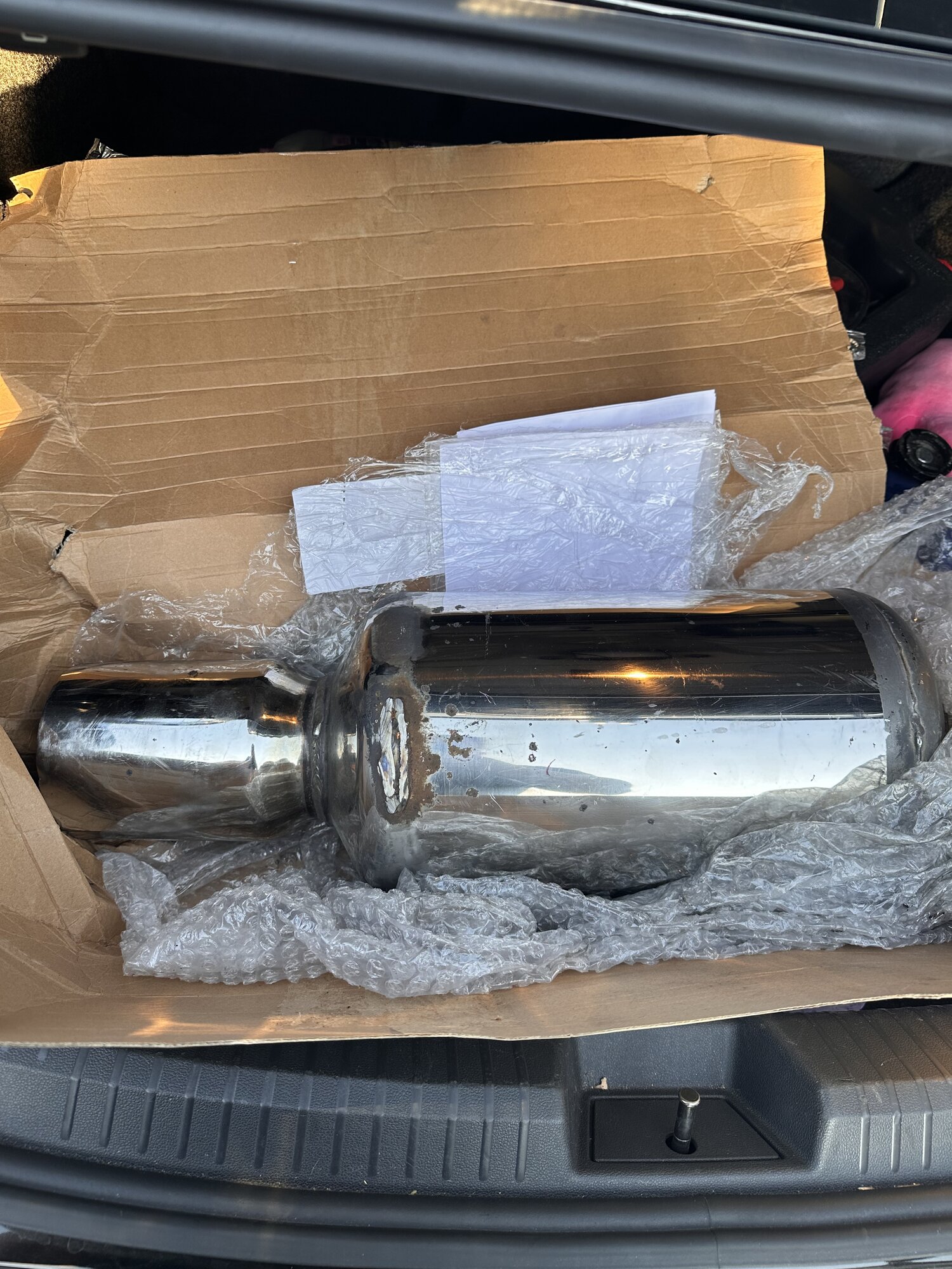

Picked up a turbo HKS Super drager for the eclipse… passes fist and shoe test.. yeah it’s about 4 inch tip and 3.5 from the back of exhaust.
If anyone has ever had a super drager on a dsm pls reply with videos of cold start, fly by or anything I wanna know how these sounds with the 4G63. I had it on my 420a it sounds amazing compared to other fart cans I’ve seen and heard in person. Hoping it’ll do the same for the 4G63.

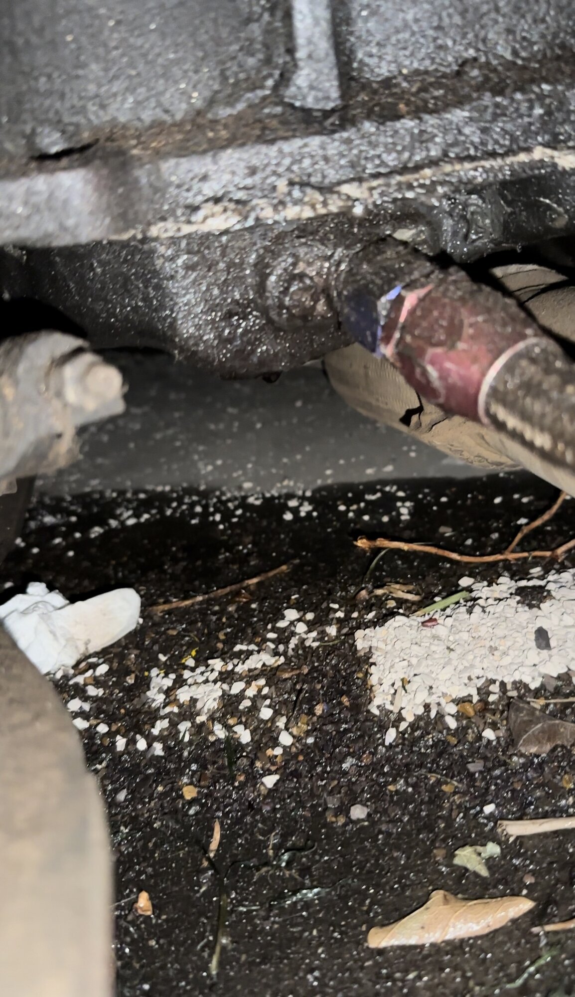

bad news, engine is 100% seized or locked up or the crank welded itself from the past owner probably due to oil leak and owner never realized it.
now how did I come to this conclusion? Where for starter.. engine won’t turn over by hand. Took it to my very trusted mechanic that works on Mitsubishi, evos, BMW, galants, 3k VR4’s.. and he did his tests and he said he couldn’t turn over the engine over as well.
Now I noticed when I added oil into the car awhile ago the next morning it spilled I’d say 90% of the oil the next morning.. it came from this sucker here.. pretty sure that’s not the only spot either from the oil pan.
Now if I piece those two together possibly the past owner locked up the engine because of this leak and never realized it was low on oil or cared to notice oil leaks in his driver way… and maybe one day he was driving and obviously no oil+ heat = welded crank from bearings. note that I did not touch the oil pan, i simply added oil and it drained it all out the next morning so this had to happen in his ownership?

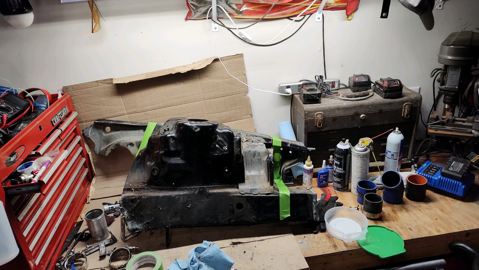

Not sure this is my guess of how it happened but either way engine is F*cked.. I’m now realizing maybe this car was a bad purchase and I’m stuck if I should replace the engine, replace the rusted strut tower and pay an alarm/wiring shop to remove the viper alarm on the car bc I have no experience with wiring nor do I wanna mess up anything wiring or just junk this car and look for a running GS-T/GSX. Losing motivation already just for the fact of the rusted towers, didn’t think shops would quote me 3-4K for replacement.

I thought of that too, but I just decided to try my best and save it before making it a parts car. I ended up buying a strut tower replacement from this guy on this forum and I’m gonna have a shop just do a replacement. It’s Gonna cost me a pretty penny but it is what it is, I’ll do it. The part I got for the replacement Came off a AWD talon .
