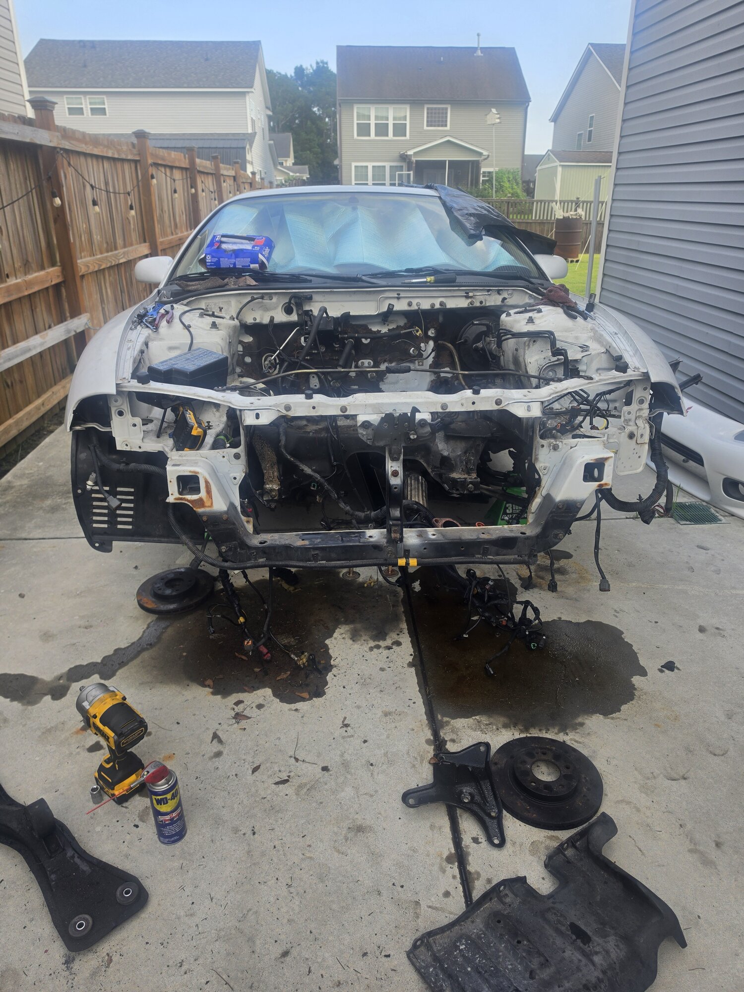

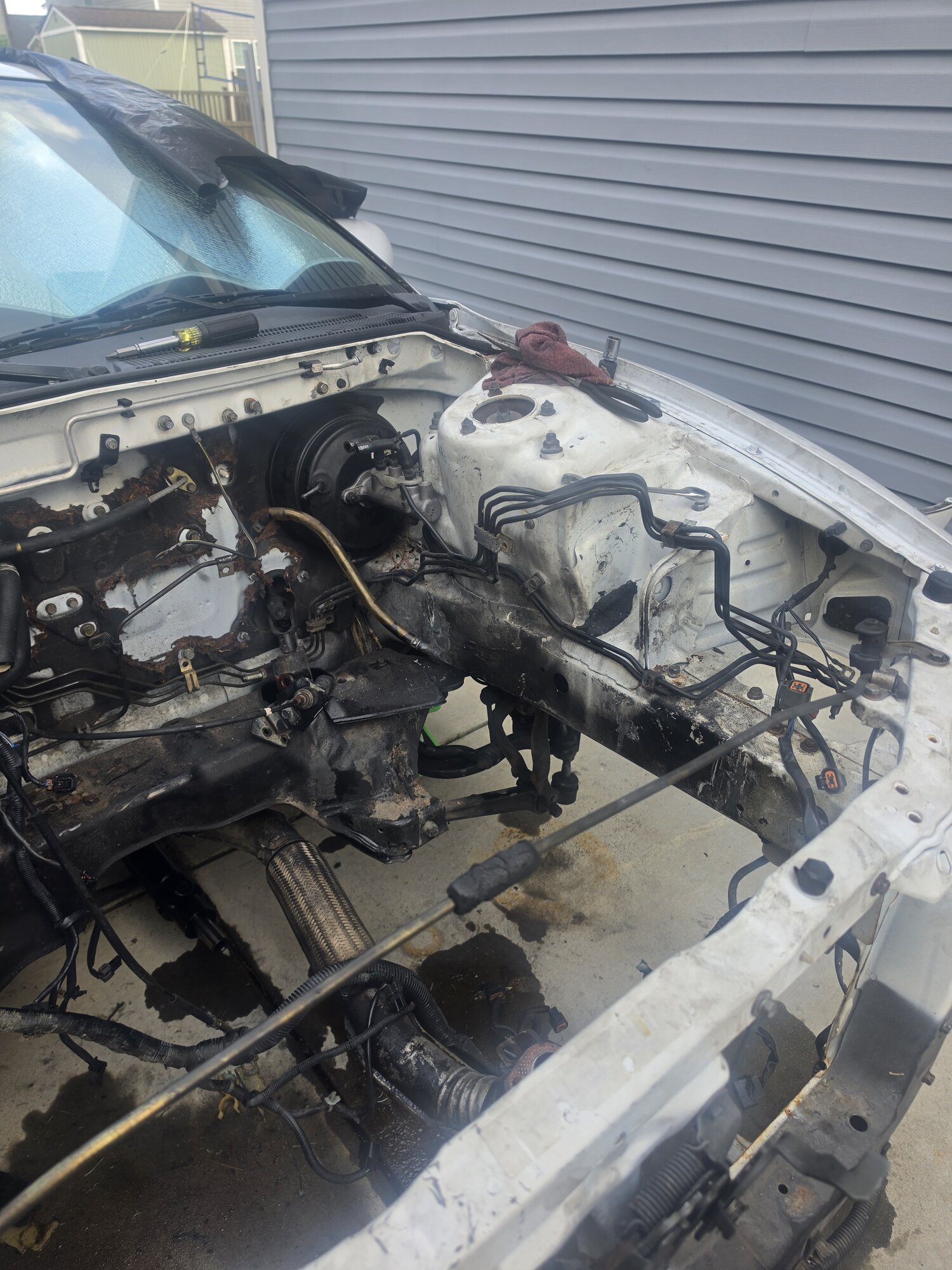

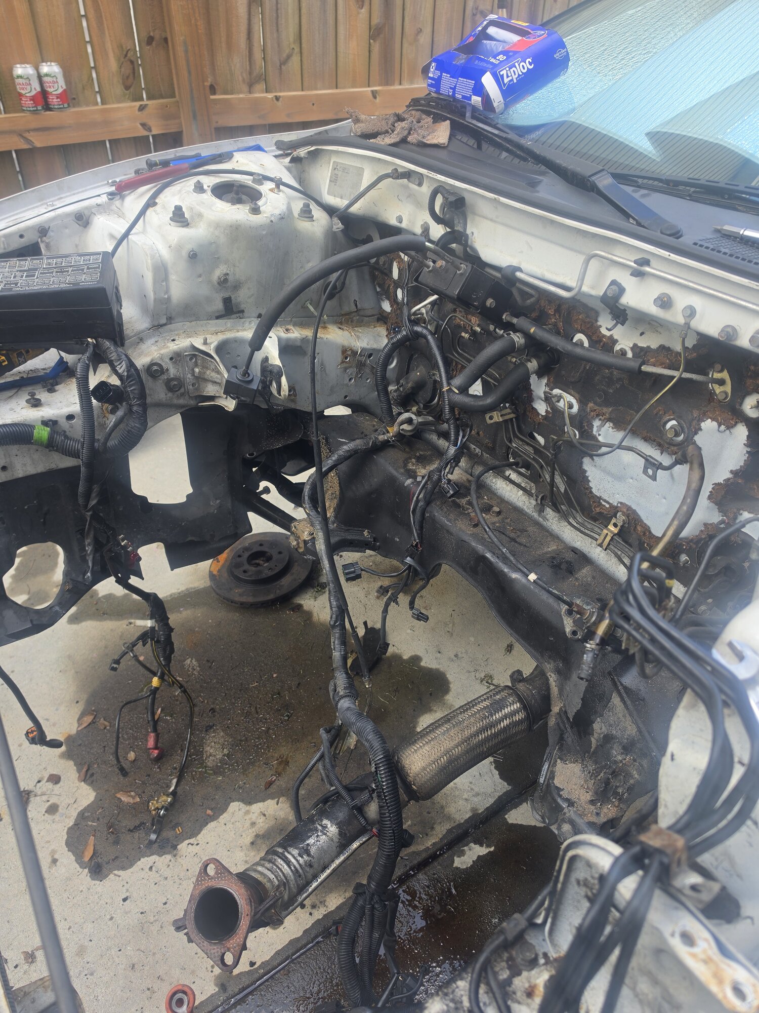

1997 eclipse GSX auto Goal: 500 awhp

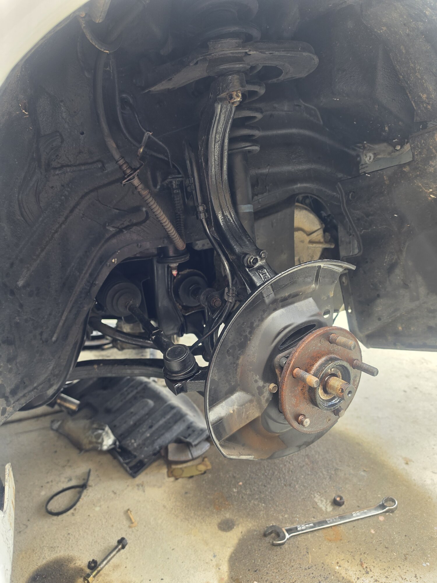

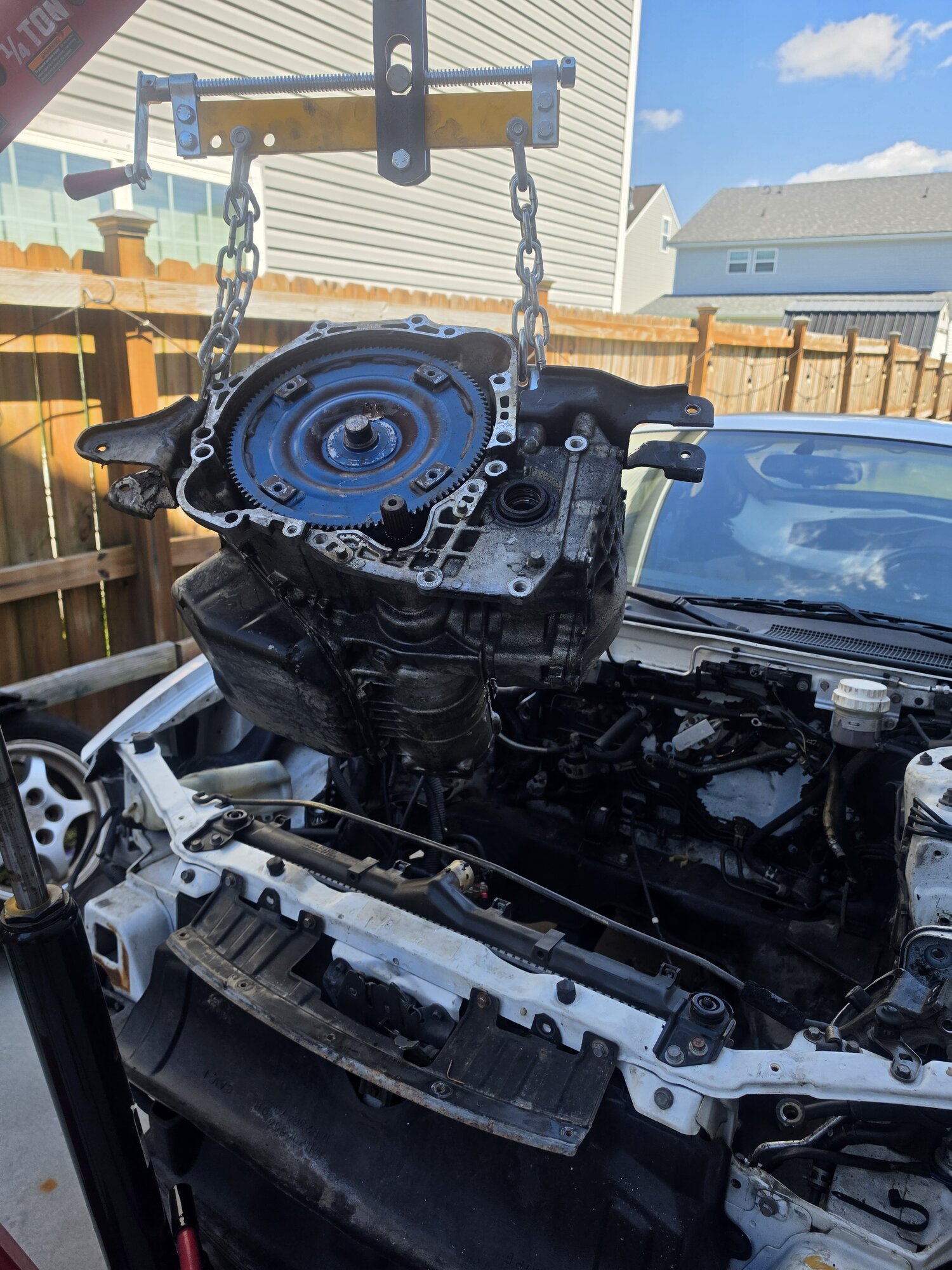

Last weekend I removed the wheel wells to get ready for shipping out the trans. Shocked at the cost of OEM wheel bearings yet again - what is everyone using for rear wheel bearings and cv axles? Are they poly bushings a rough ride? Anyway - somethings to figure out.
Likely will go with wilwood brake kits because they are bolt on & i dont feel like reinventing the wheel for Brembos - literally.

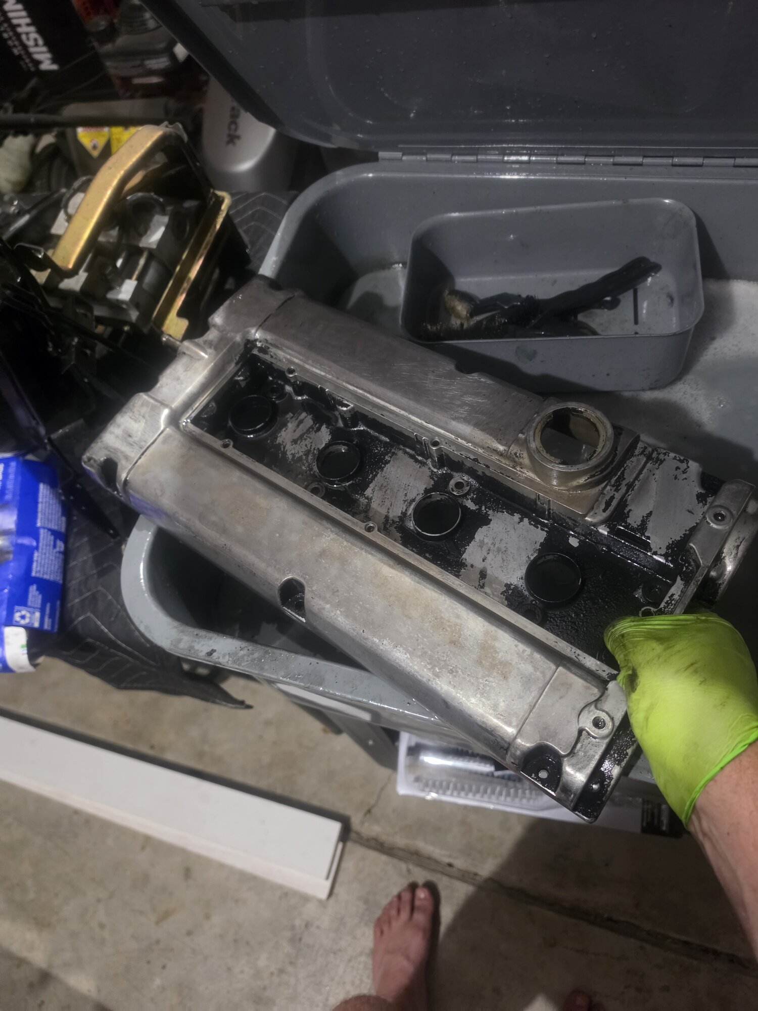

Long block is at the machine shop.
***Full valve train is GSC***
GSC s1 cams
Beehive springs
Brass guides
Titanium retainers
Gsc i/e valves (std)
Bottom end
Stock crank, polished
Wiseco 9:1
Eagle h beam rods

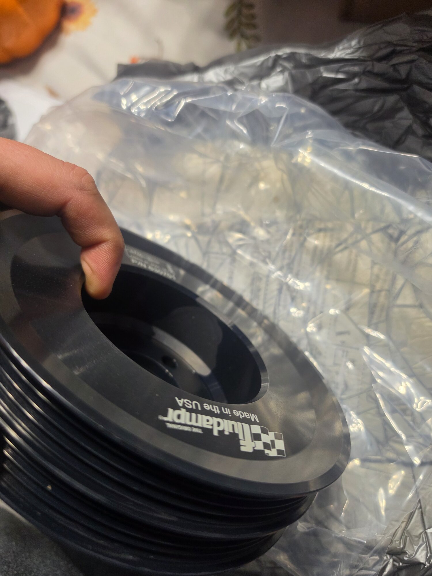

Bolt on parts i have on hand so far are
Jmf intake with s90 70mm
Fp exhaust
Fp green turbo
Oem timing kit
Hks gears
1750 Injectors
525 walbro kit
