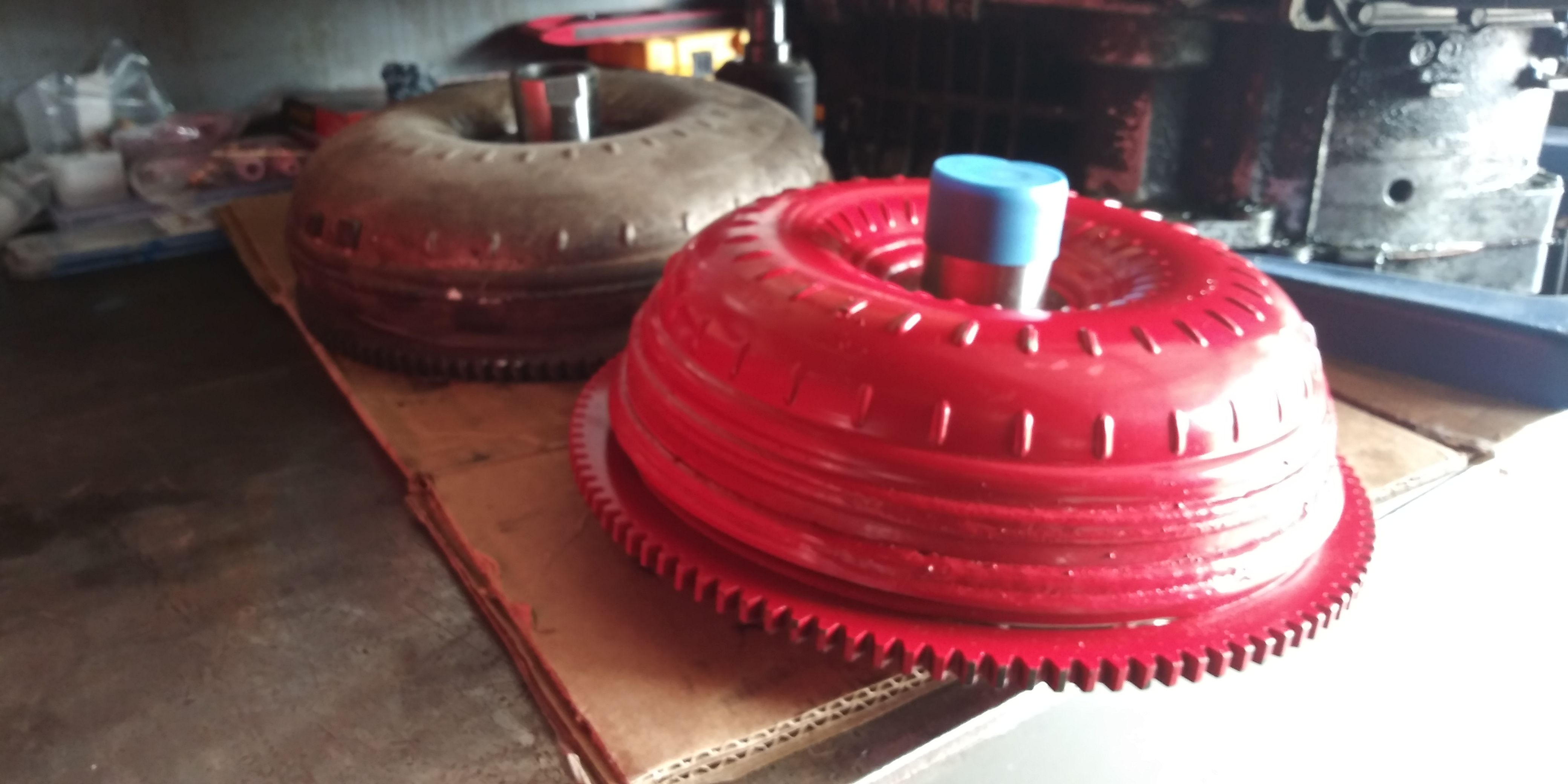

Not sure who told you to use those teeth to separate it but it is easier to use a rubber mallet to hit the end of the shaft which will spate it with ease. My experience is it takes a little persuasion to separate those at first, they few I have separated have all been the same. I would be concerned if I pulled the shaft out and all those parts just fell apart.
Actually your right, but no matter how hard I hit it there was no way it was coming apart. It felt like it was welded together. It took me literally 2 days hitting it with a 3lb hammer to get it apart. Once all the teeth broke all I had was the shaft to hit. The new one I got was like butter no problems at all.
Putting mine together I can pull it together by hand (Still a tight fit) but after its fully seated, I have the smack the end with the mallet to separate. Sounds like you got it figure out! Did you take a look at your rear drum (forward clutch) while it was out? I hear they rarely wear out but mine was one of those rare occasions.
Actually everything in the drum has been replace also with all new clutches and plates. I didn't film everything but I replaced alot of the gaskets and seals. I'm actually really happy I opened it up. It was a good learning experience.
