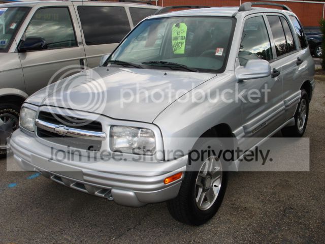

My mom has an 03 Chevy Tracker that has been just sitting in the drive way so I've commandeered it to be my DD for the time being. Here's a picture of what it looks like (stolen from the net, I'm not actually going outside to take a picture of the thing).
It's silver and 110% boring, perfect for a DD imo.

Turbo the Tracker!! It will be less boring. (kidding right... Or am I?)
Keep the power steering btw, its nice to have for driving around and all.
Only mod to that Tracker is studded tires in the winter time.
