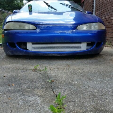

I picked up my 95 gst for a hell of a deal. Always loved the 2g Body style so I decided it was time to get one lol

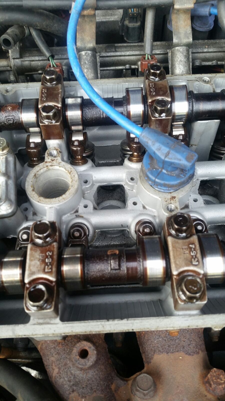

Head is spotless LOL I got the afpr put in.I'm not sure I'm going keep it there though.So I didn't take any pics of it.But anyways....i hooked up the black box ecu and got nothing.but from what I have been reading and searching even more in depth on is the 1g cas. A few ppl have put the black box ecu in a 95 and have gotten it to work.But they never went into detail what all they had to do to get it to work. A few said they swapped in a 1g cas and swapped a few pins and it worked like a charm. So I'm going to try that out and see what happens.if it becomes too much of a problem ill just send my eprom in and have it socketed and do dsmlink.
