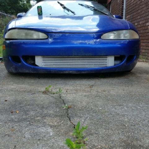

I picked up my 95 gst for a hell of a deal. Always loved the 2g Body style so I decided it was time to get one lol
Looking to make 450ish at the wheels when everything is all said and done. But for starters I need to get a afpr, wide band, boost gauge, and the method I'm choosing to tune is using a tactrix op 2.0 cable and black box ecu. The turbo im wanting to start with is a 16g since I have the yellow top injectors which I believe are 550 correct me if I'm wrong. Already has a fmic installed with a ebay 16g that I don't trust LOL.So I figure that's a good starting point once I put a real 16g there. It's going to be weekend warrior for the most part. So as if right now im going to start purchasing the parts I need so I can knock it all the maintenance that's needs to be done I can start modding. Just the basics like the timing belt(already have a gates ready to go on), unsure on deleting balance shafts or keeping them, head gasket and arp head studs for safe measure while I take a look at the pistons and have a machine shop inspect the head, all fluids and filters. I want to take a air line and blow out the fuel lines in case there us any trash in there..... I'm new to dsm's and turbos but I have a pretty good concept of it. So if you have any more suggestions on what I should be before modding im all ears.
