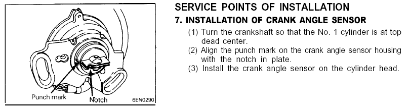

no its all bone stock...could it have anything to do with the way the cam sensor was installed? i just put it on, it wasnt aligned with anything like top dead center or anything...
I doubt it, i would start with the basics first so you dont stress to much, just work on the injector pulse and see if you are even getting the shot. Could be something right under the old nose. Ill get you the schematics for the injectors too.
