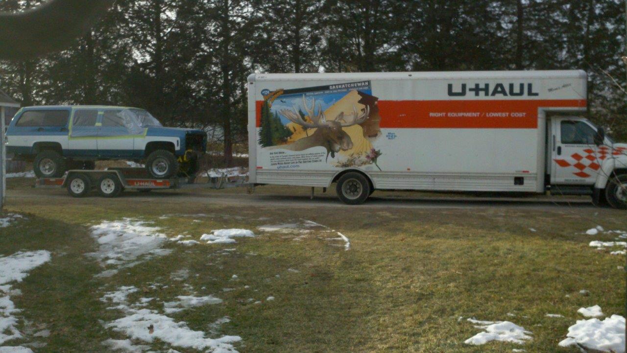

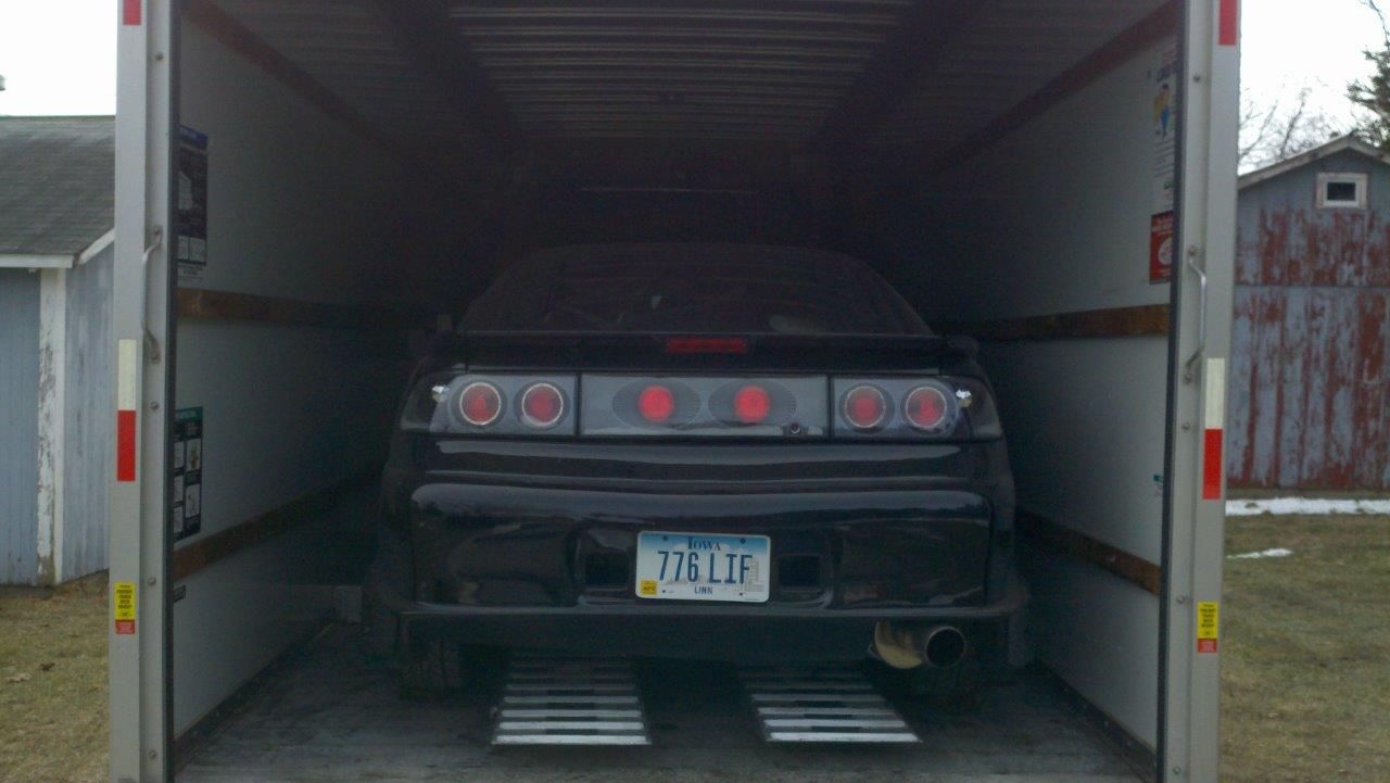

Fast forward to Oct 2014 and I was back in the states and living in VA. I flew home so that I could load the car and my Suburban up and take all my garage equipment to VA. I drove the car maybe 1 mile to my Mom’s house, loaded it up in the back of a 26’ Uhaul, put the Suburban on the trailer, and headed to VA. Roughly 950 miles, about 20 hours, a few Redbulls, and a handful of white knuckle driving in rain and one lane construction zones later I was home.
First to be offloaded was the Suburban. I couldn’t pull into or back into the driveway due to the angle and incline of the driveway, but I was able to jack knife the trailer near perfectly on my first attempt (although completely blocking my cul-de-sac). As soon as I did this one of the neighbors pulled up. He just shook his head and turned the van off. I smiled, shrugged my shoulders, and picked up the pace. I got the chains and everything disconnected with no problem and since my Suburban has 35” tires I just pushed it off the back of the trailer and let gravity take over. Hook the W8 up to it and pulled it up off the trailer and up the driveway as far as I could. Chocked the wheels real quick then moved the Uhaul. At the time I didn’t realize I lived on the cul-de-sac and of course the turnaround was too small for the truck and trailer combination. Made for an interesting experience, but wasn’t too bad.
Next I pulled up along my yard, disconnected the trailer, and back the Uhaul up the driveway as far as I could before bottoming the deck out. Grabbed the ramps I had bought a few years ago and the Talon came off with no issues. Knowing it had no ebrake concerned me, but I checked at every stop and had it pretty well secured so all was well. I was pleasantly happy that within an hour I was able to unload both vehicles by myself and was even able to push the Suburban into the garage. That of course required letting some air out of the tires, but that was to be expected.

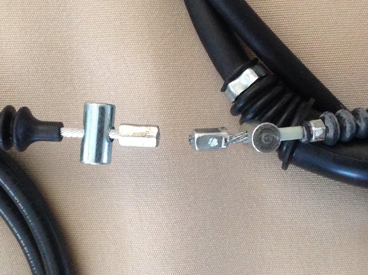

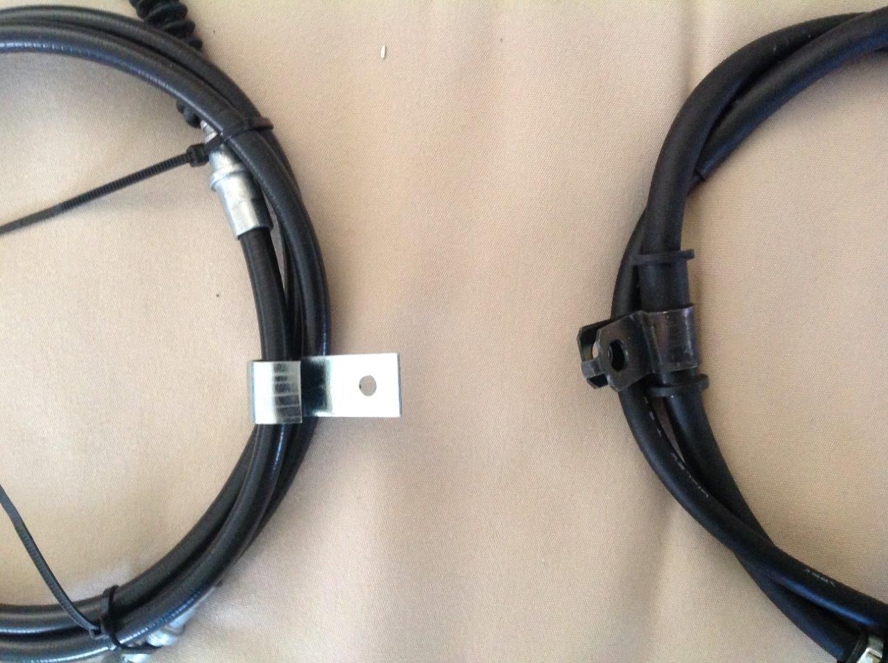

Problem #1) Why do the matching ebrake cables look completely different? The rubber boot on the bad one wasn't sealed, the cable didn't move freely, and the only mounting bracket it had sharp metal edges.

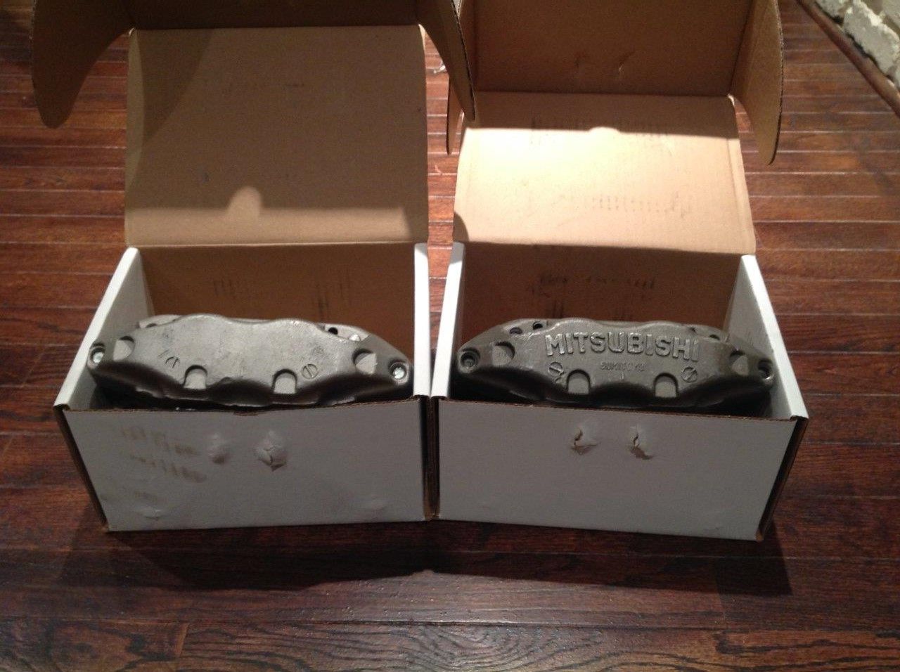

Problem #2) Why do my matching calipers look completely different?

The first thing I wanted to do was fix the ebrake. First off it wasn’t connected so I connected it. Then I realized the previous owner disconnected it because the right line was frozen. The caliper itself was fine so I tried spraying PB blast in the lines. I let it sit for a good bit of time and could no free that line. I thought using the ebrake handle may produce enough shock to pop it loose, but I just ended up breaking the left cable. On the plus side now I know how old both cables are. For anyone that is reading and has never replaced their ebrake cables I’d like to say two things. 1) All the mounts that hold it on need to be saved or replaced. They don’t come with new cables. 2) If you’re like me and threw all the old mounts away with the old cable you can go to any hardware store and buy wire bundle holders and just drill larger holes.

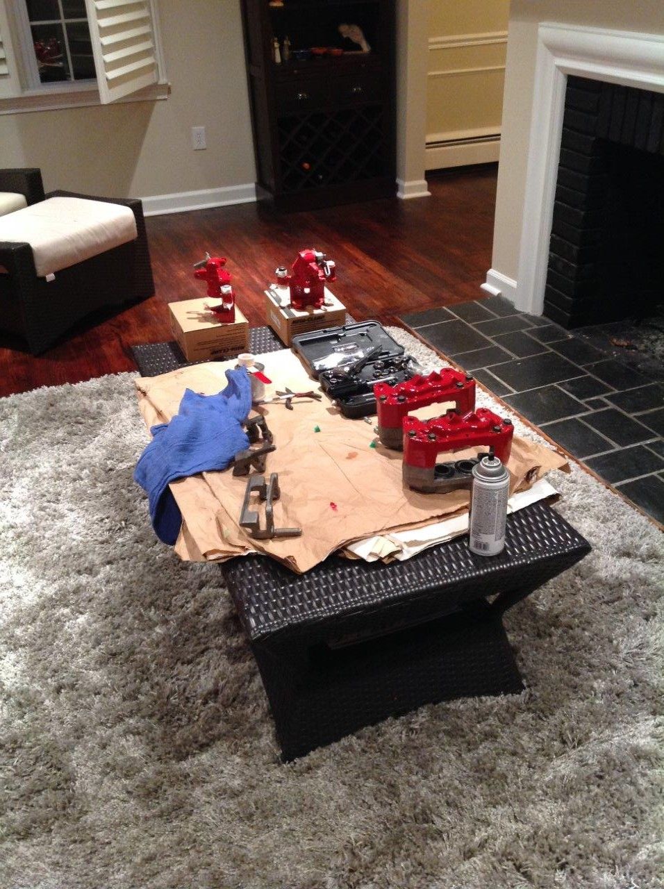

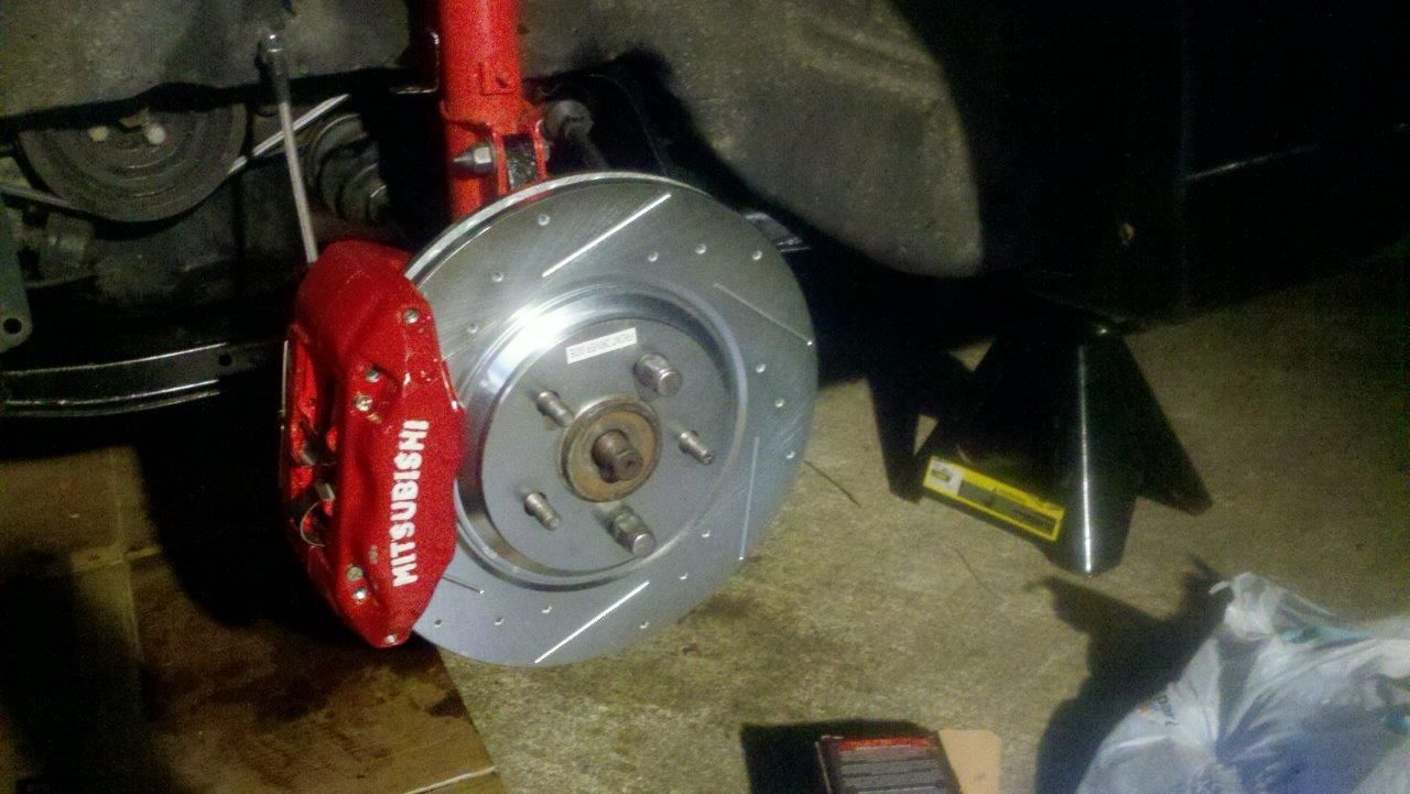

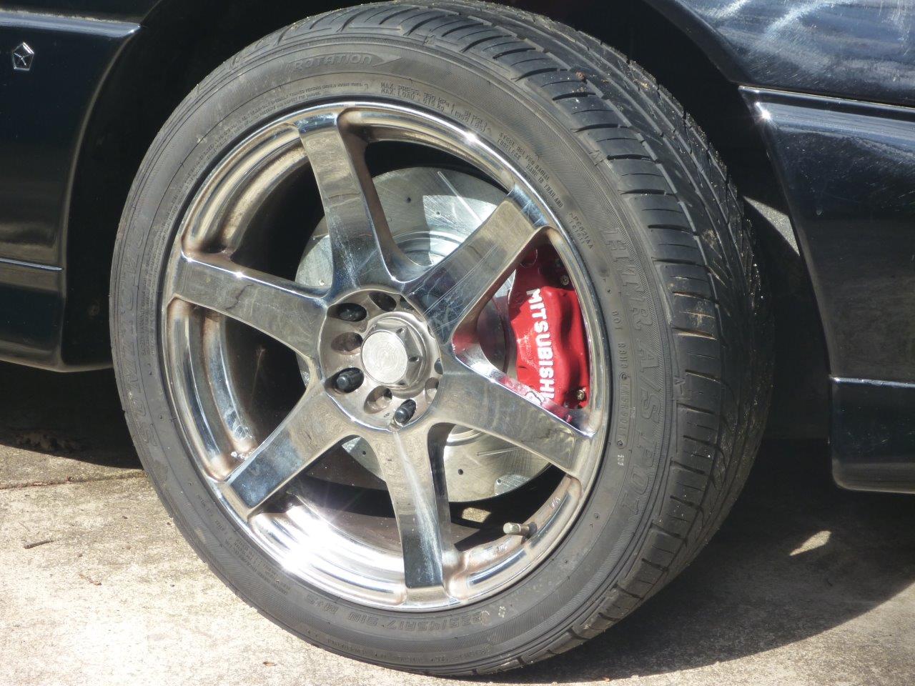

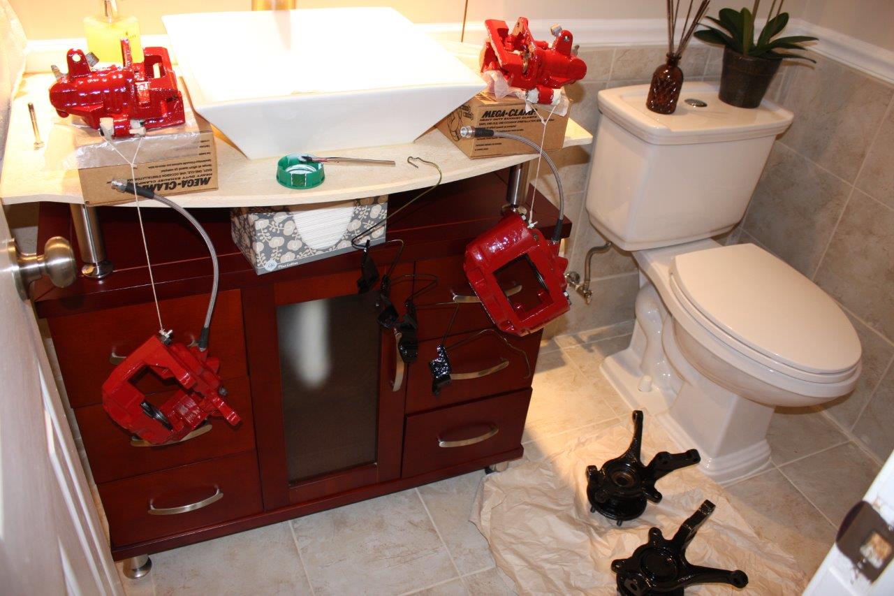

With that resolved, next came painting my calipers. First I needed to get a matching set of calipers. I talked to the vendor and they said I could send one of them back and just hope for better luck the next time. This sounded ridiculous so I called the distributor. They told me that if I put a specific request in through the vendor for either a flush OEM replacement caliper or the actual OEM caliper and the vendor in turn passes that to them then I can get whichever one I want. Otherwise it’s just the luck of the draw. This really didn’t take too long, I wasn’t pleased with having to pay a restocking fee or the return shipping cost, but I got my matching calipers.
I followed the instructions on the caliper paint, but for whatever reason the paint stuck much better to the front calipers than the rear calipers. It took me four days to finish everything. Once you start painting you’re supposed to finish within an hour and then let sit for a day before handling and3-5 days before repainting. I was using the tiny supplied paint brush so I basically did a side a day. Before you start, make sure that the brake fluid lines are capped as the brake fluid will ruin the paint if it hasn’t cured yet. I had remanufactured calipers and didn’t think there’d be anything inside so I learned this lesson after day 1. I may have put the paint on too thick as well so when I laid the rear calipers on a side that had already been painted after a day that side had imprints on it. Because of this I decided to hang the front calipers when they were drying. It was too cold to paint in the garage so I had all of the windows open in the living room and let everything dry in the bathroom which is probably the warmest room in the whole house. It helped that I could close the door and keep the rest of the house from smelling like paint fumes. This stuff was especially strong and I can’t recommend painting inside even with windows open. I got a little lighted headed once or twice. In hindsight, I should have probably had paper on the carpet instead of just the table I was painting on. I didn’t think I would drop anything and made it to the very end before I dropped a caliper. Mostly landed on my foot, but I had to cut some pieces out of the carpet to hide the evidence from my wife. She has yet to notice so I think I’m in the clear. Here are some pictures of the painting process.

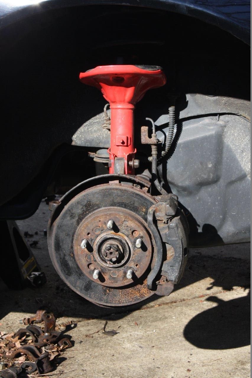

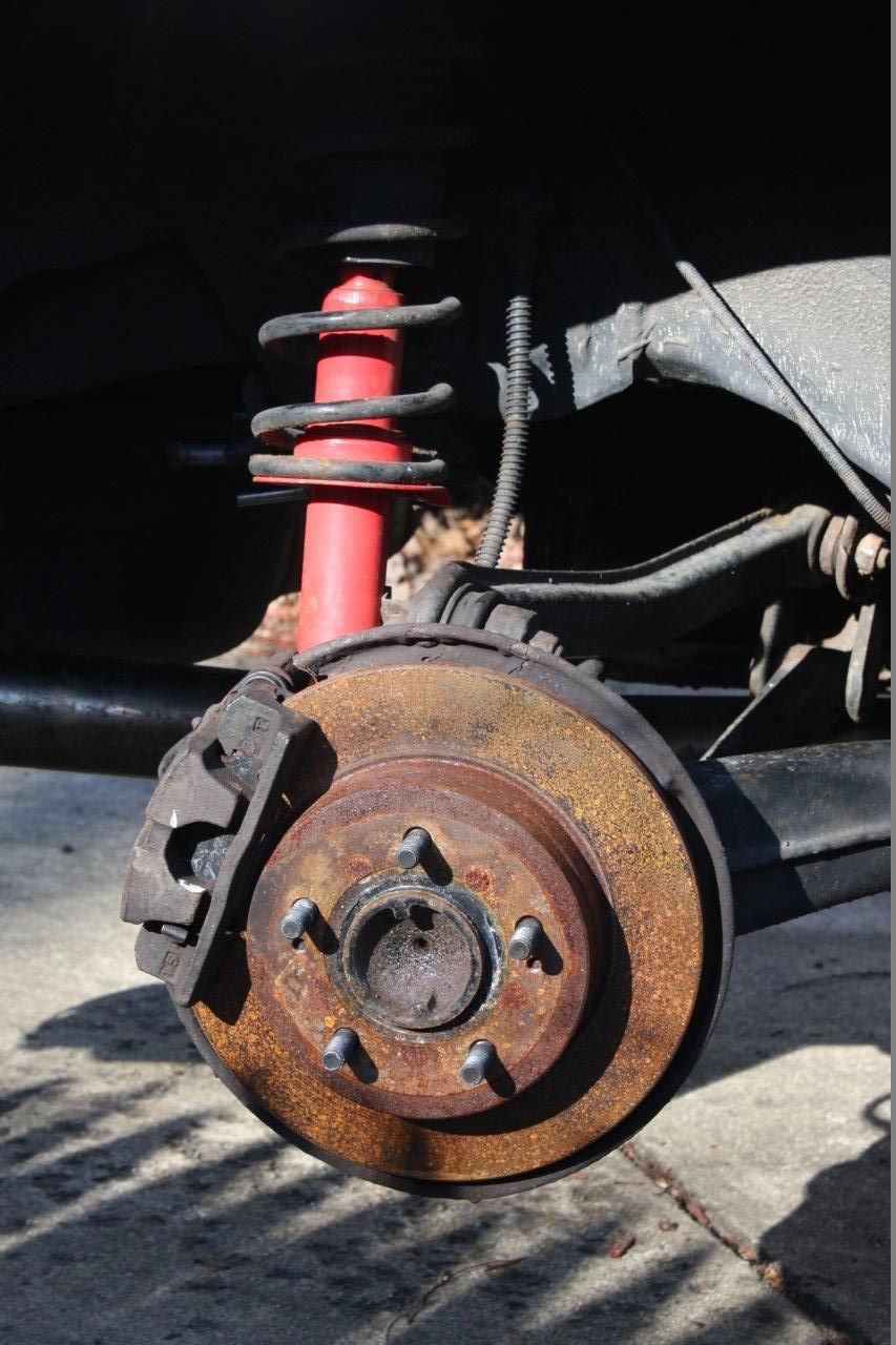

A few before pictures.
Old brakes on car.jpg Old Front Brake.jpg Old Rear Brakes.jpg Old brakes on car with rims.jpg Old Front brake with wheels.jpg Old Rear brakes with wheels.jpg
And a few after pictures.

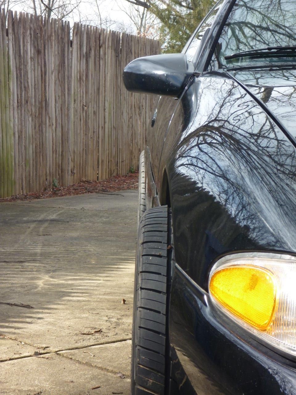

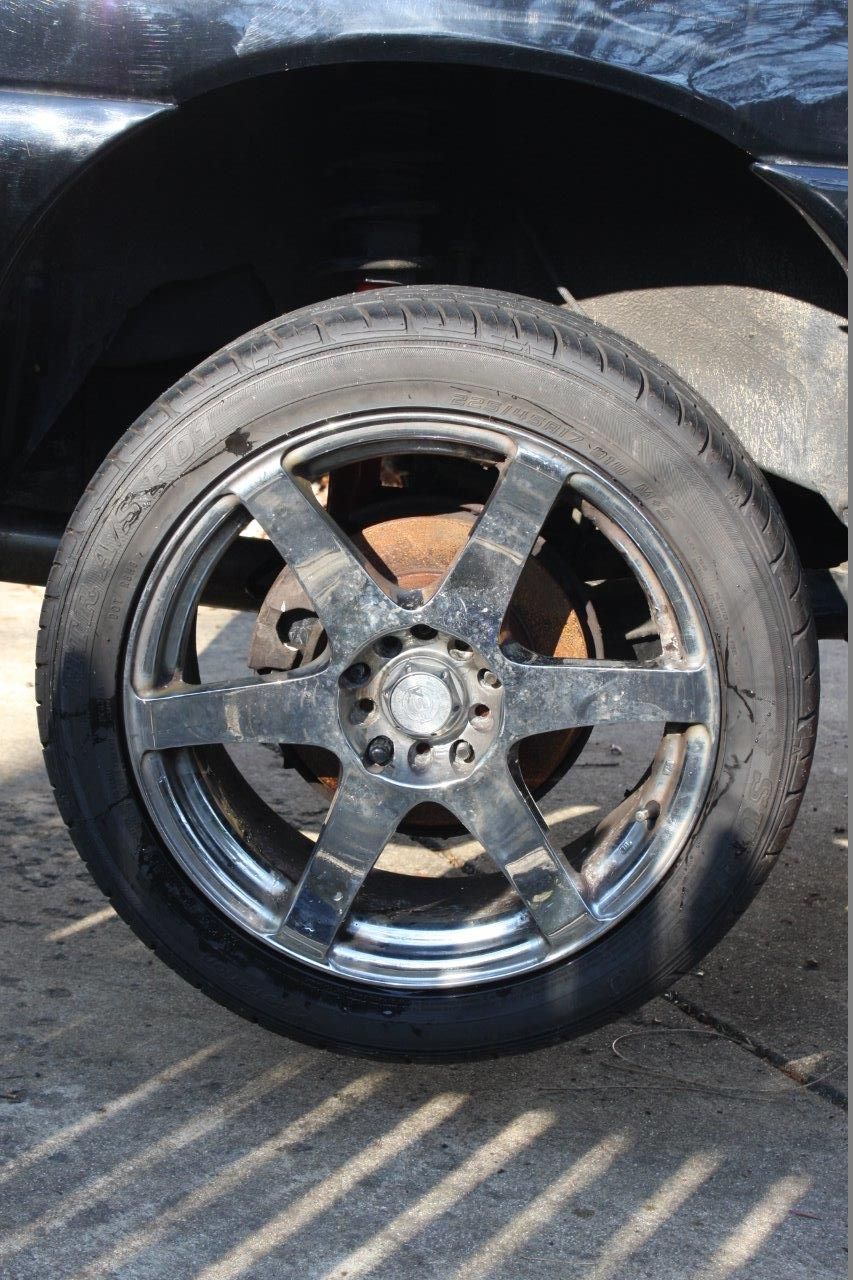

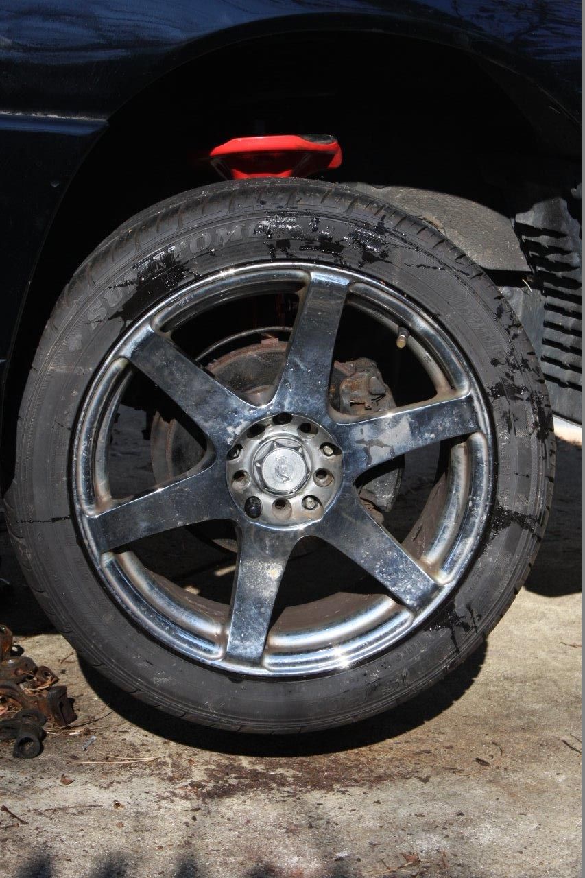

Here is problem #4 or Easter Egg #1. These are the thinner of my two sets of wheels. The spokes of my 17” wheels almost cleared the calipers, but the 18” wheels needed more than an inch of clearance. I ended up buying a set of 32mm hubcentric wheel spacers.
My old 15” Diamante wheels didn’t stand a chance so I ended up selling them and am currently kicking myself for that.

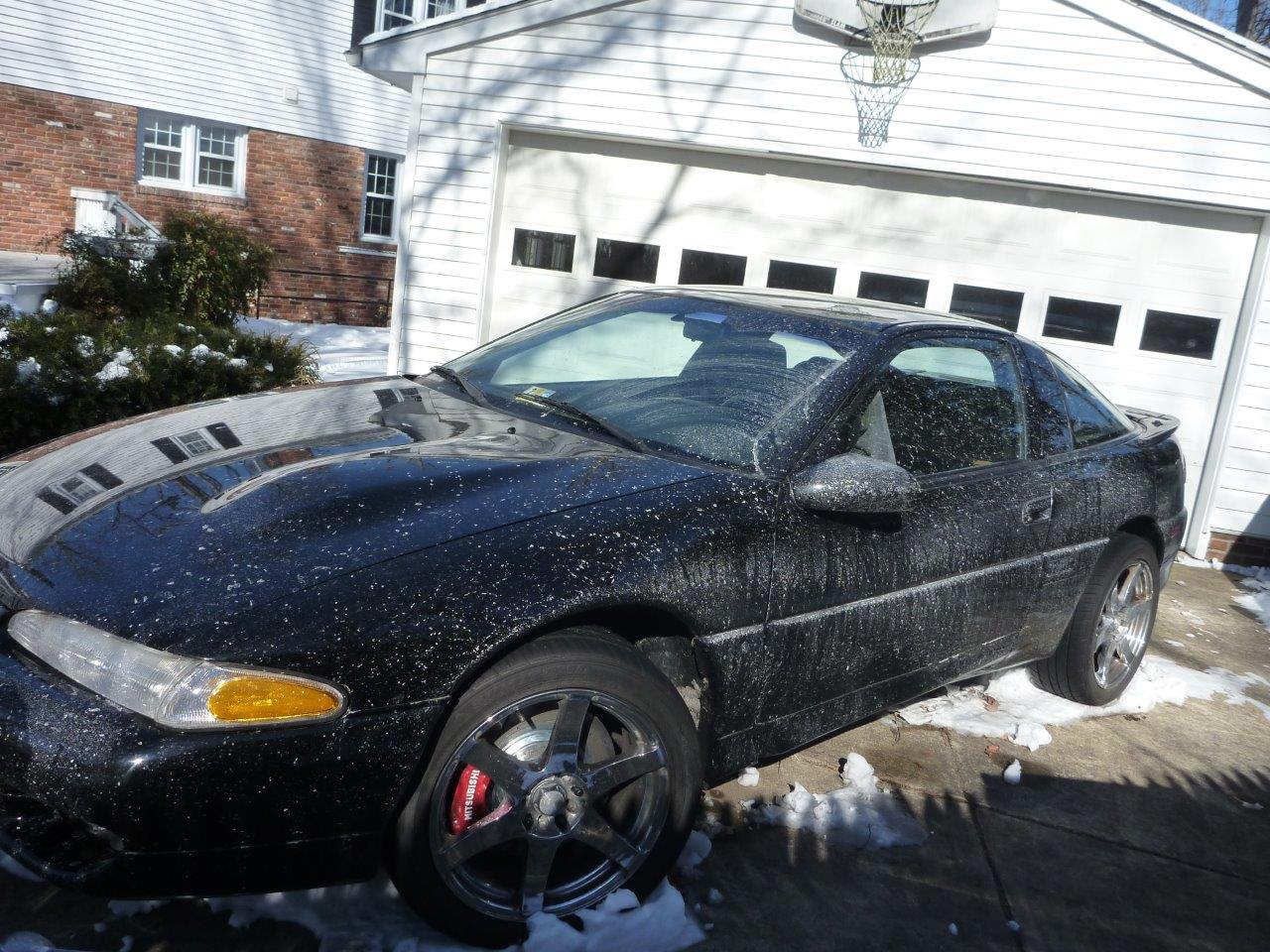

I bought some Rally Art mud flaps that still need to be fitted and installed. I went for a short drive after it snowed recently and the amount of crap slinging off of my tires is ridiculous. I need to find some new wheels that will fit over the calipers and stay tucked into the wheel wells.

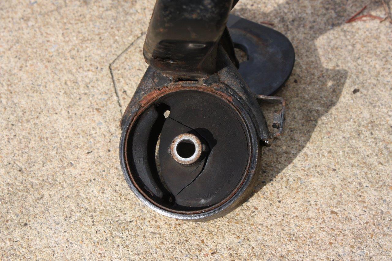

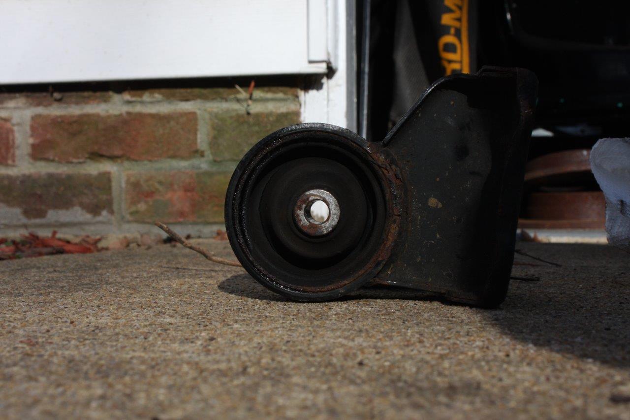

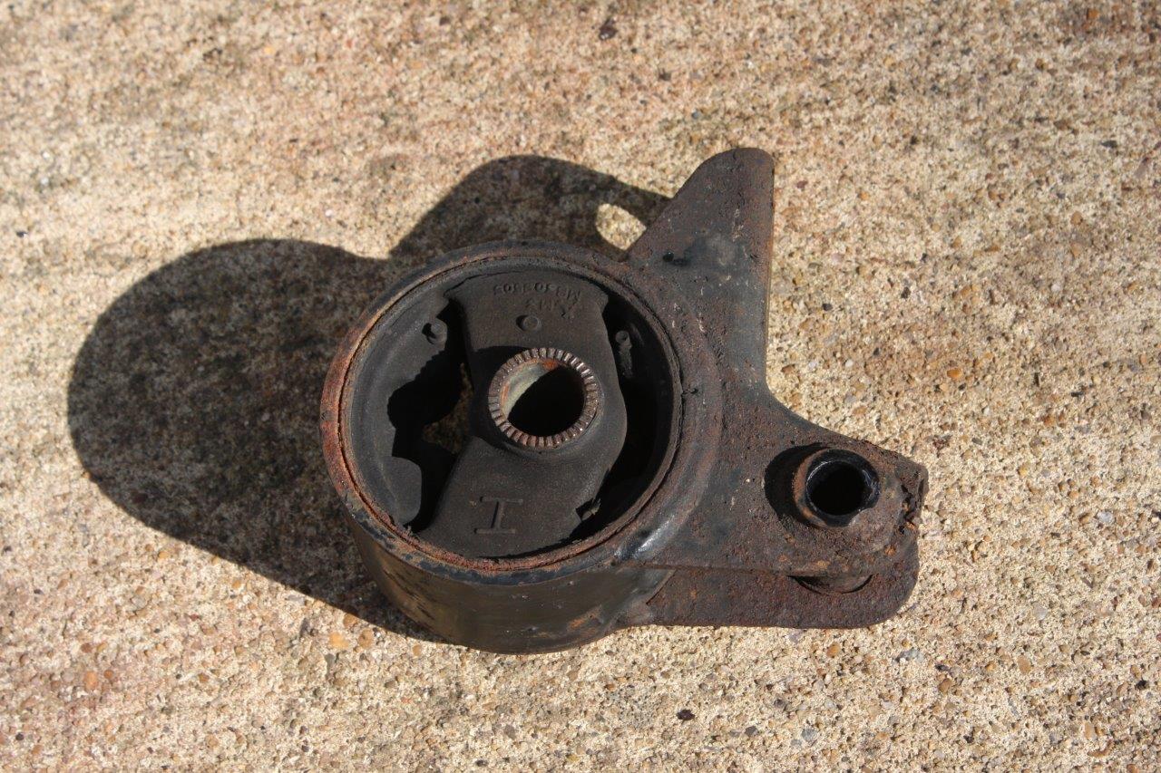

I already did a write up about how I went about installing all of the bushings so I’ll skip that. I will however, highlight the fact that every single one of the bushings was bad and the mount for the xmsn was being held on by just a few threads on each bolt. According to receipts I received from the previous owner, this xmsn was installed in Dec of 2011 by a very reputable shop, but three years later it was hanging on for dear life. The front engine mount was sagging a bit, the driver side mount was torn, and the rear mount was cracked around the entire thin portion.

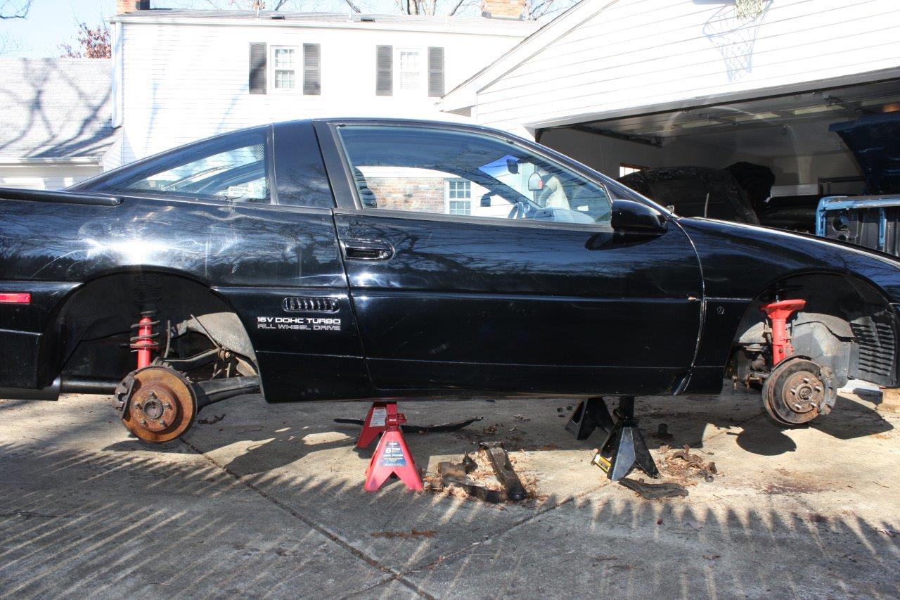

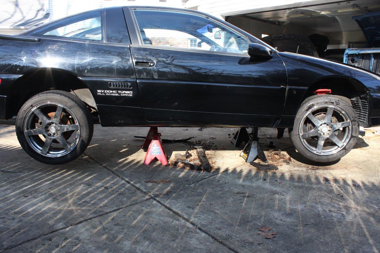

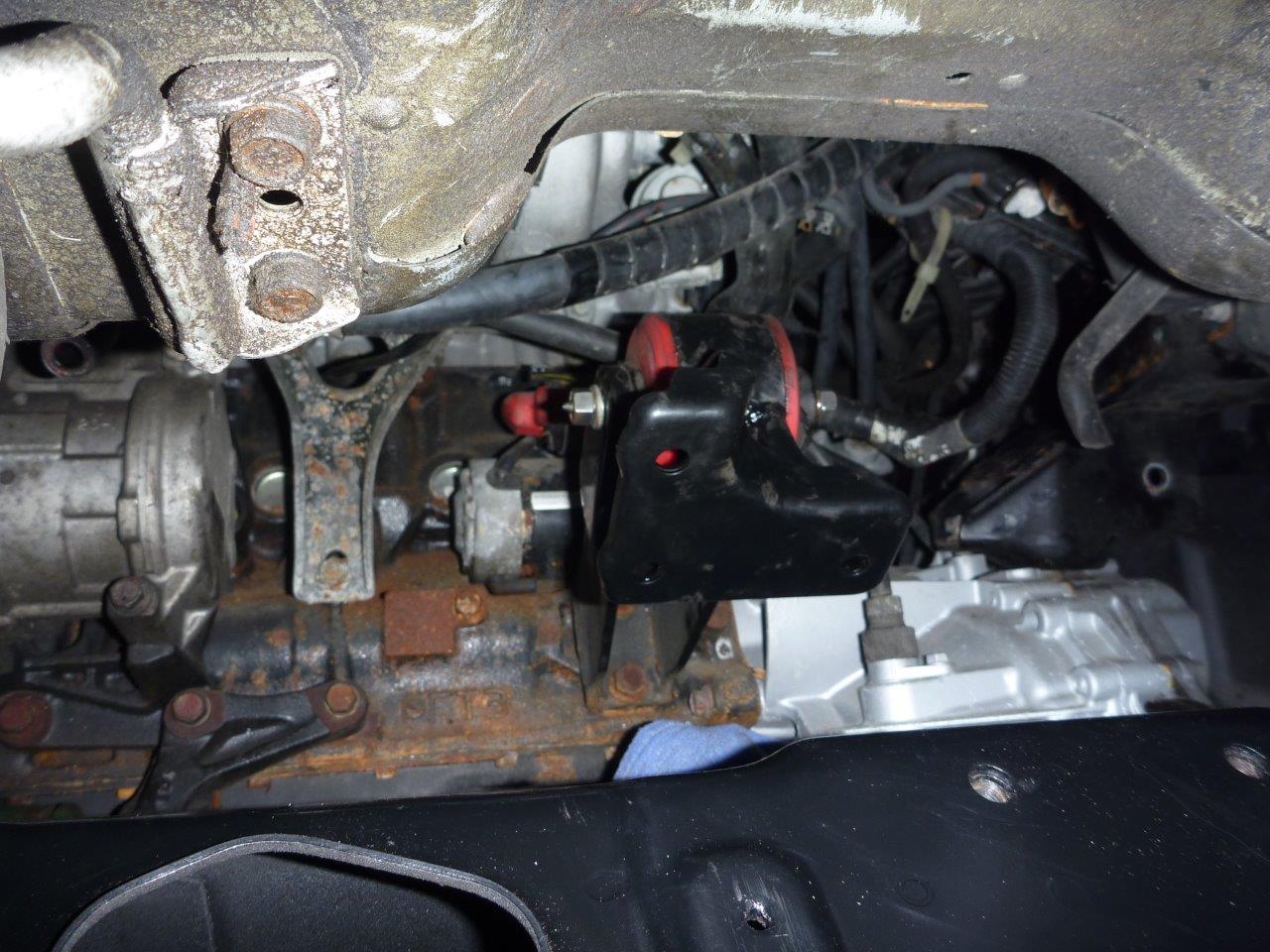

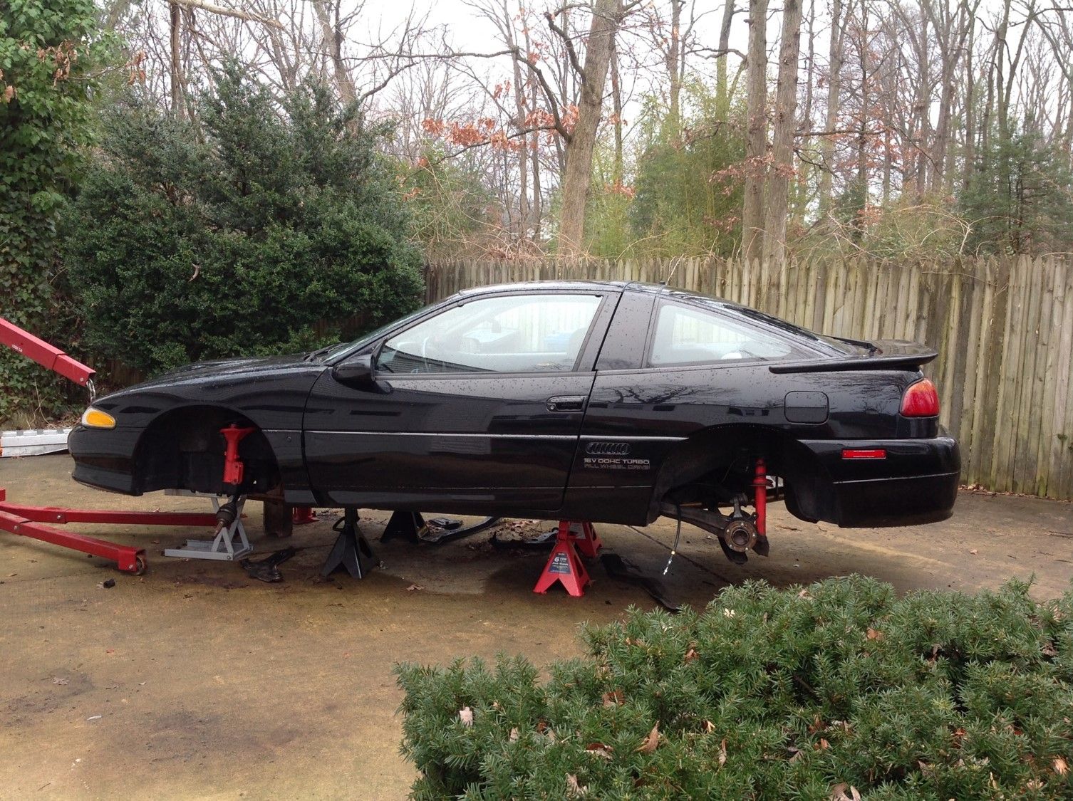

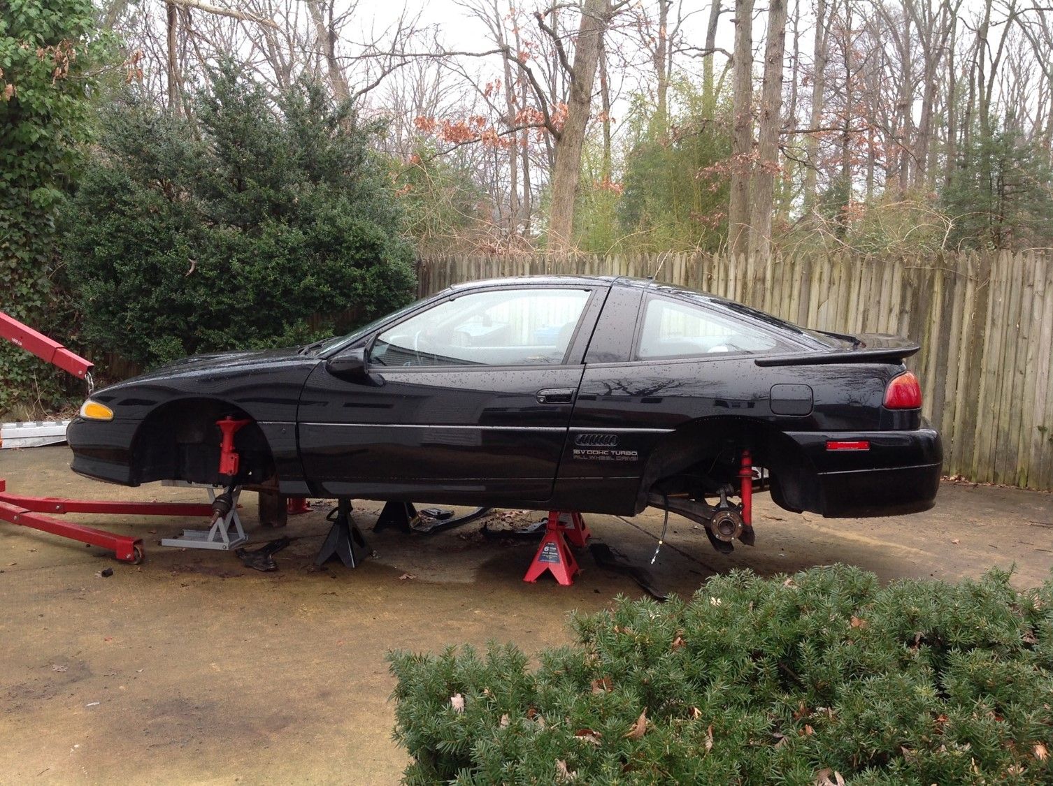

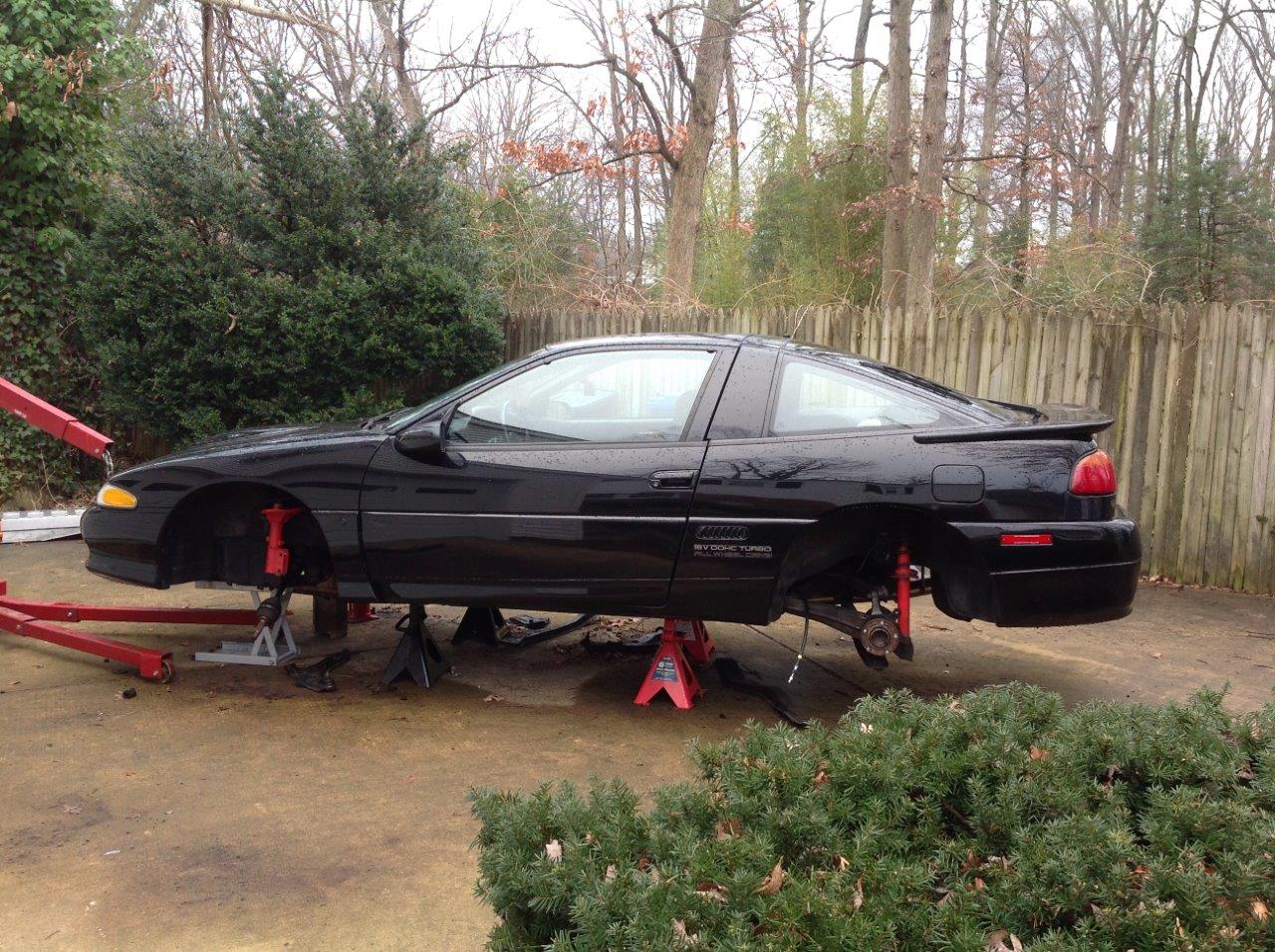

I ended up suspending the engine with an engine hoist and had my motorcycle jack under the oil pan and another mechanical jack under the xmsn. This gave me a little reassurance since I didn’t do everything in one day and made life a little easier when it came time to reinstall everything.

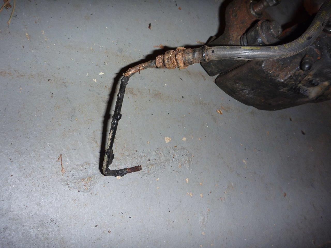

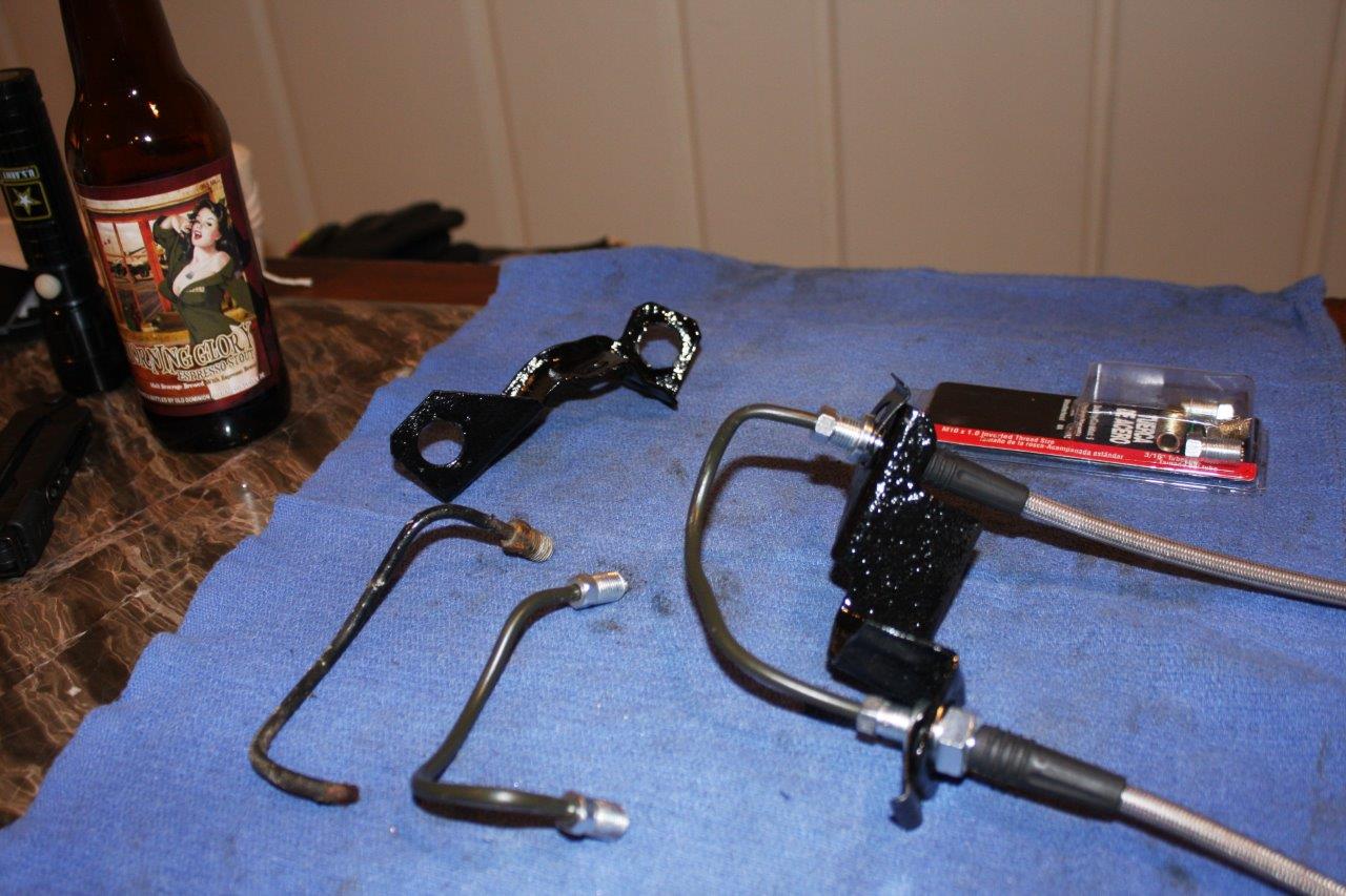

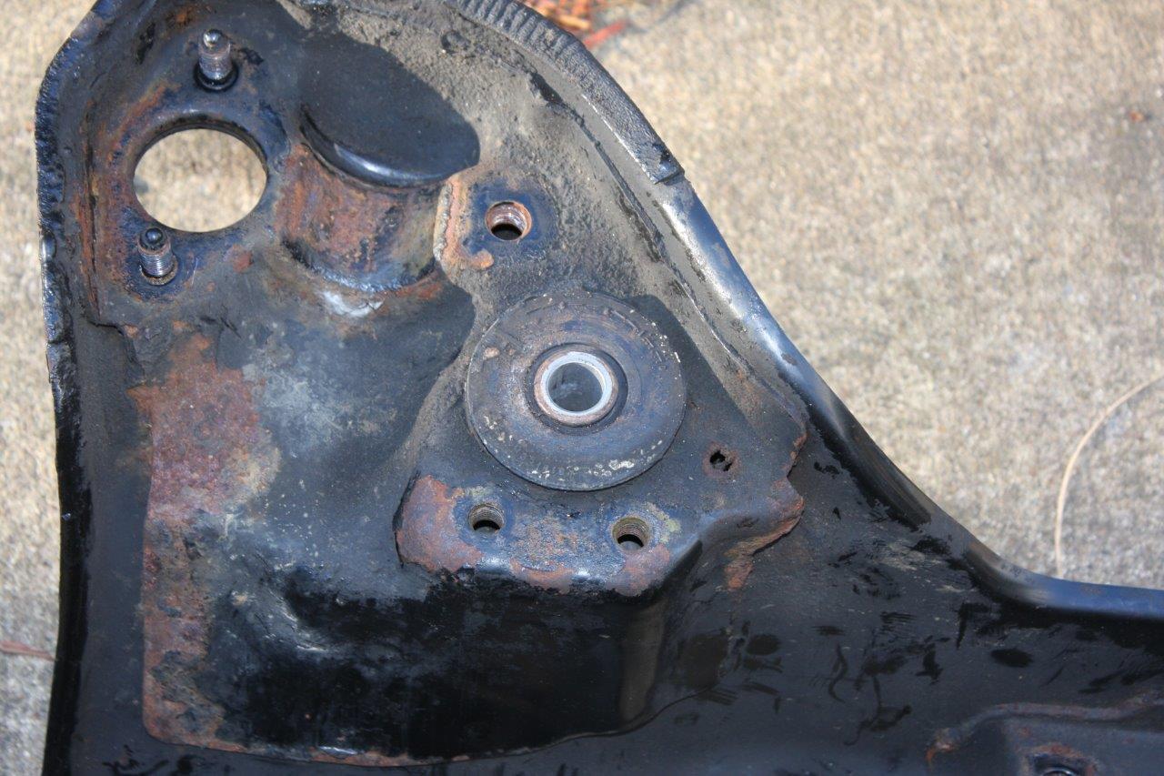

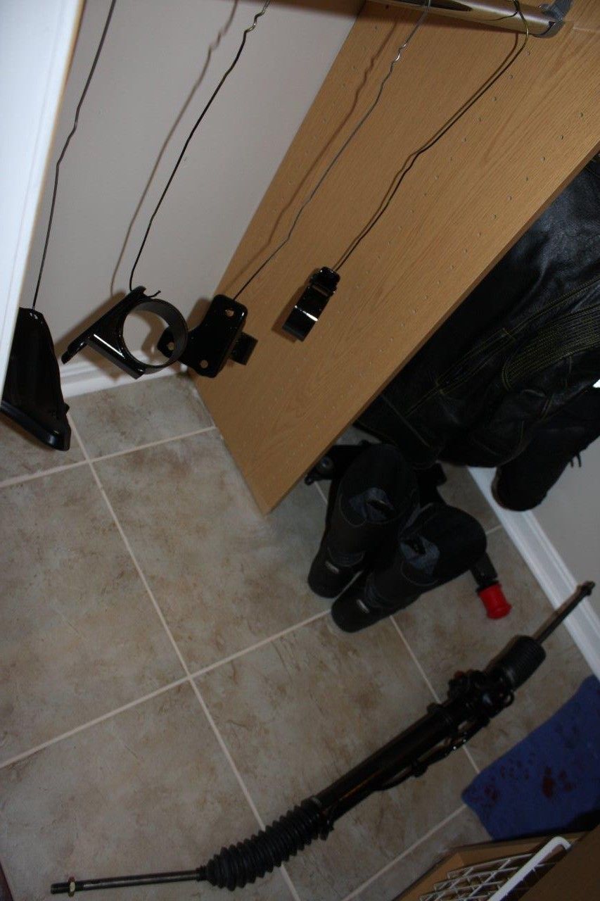

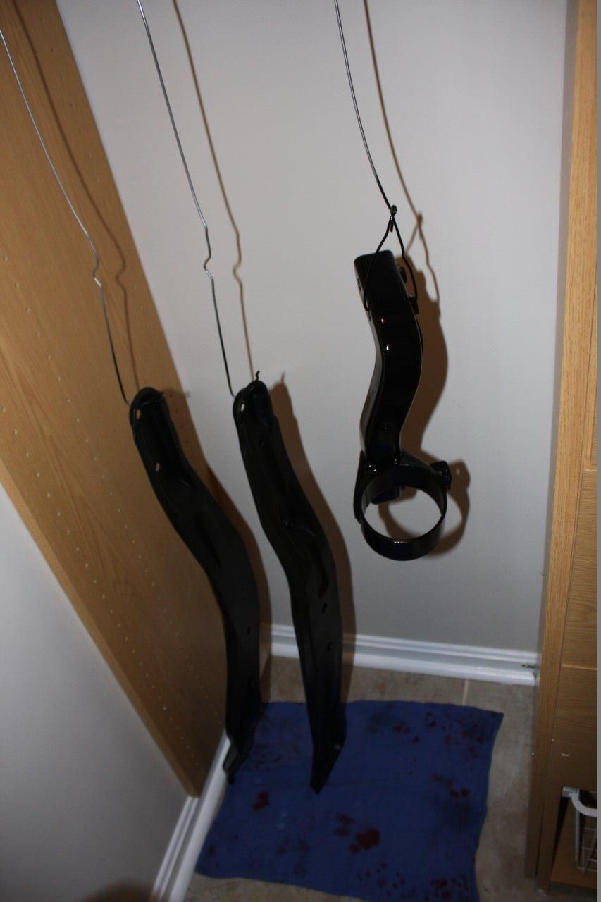

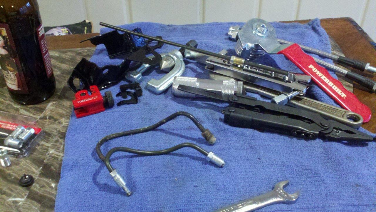

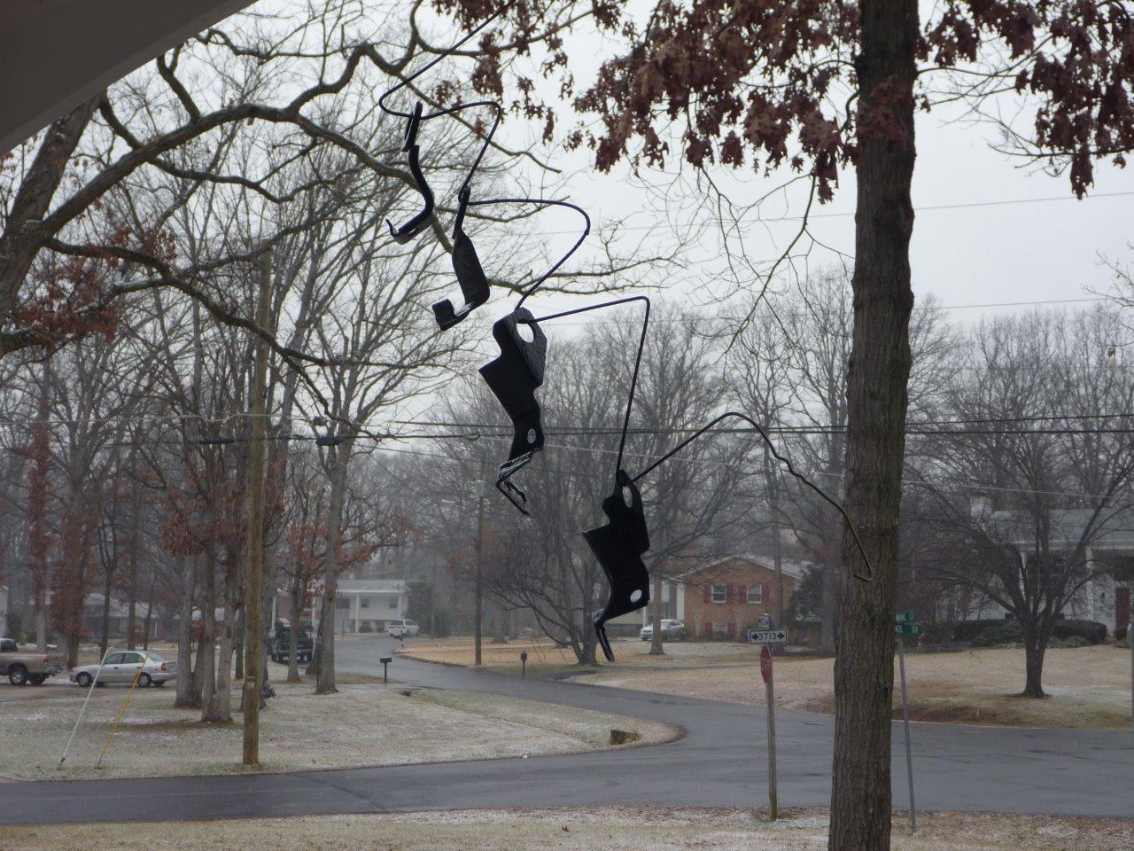

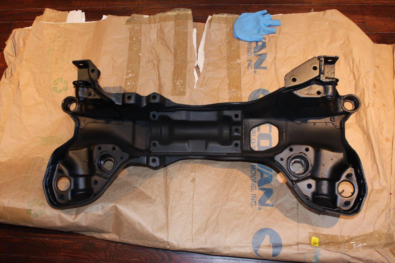

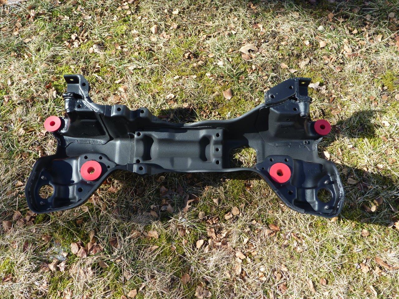

With all of the mounts, crossmembers, and front subframe off I figured I’d go ahead and repaint everything. I don’t know if it was done in the factory or someone did it on their own, but there was a ton of overspray on everything under the car and fenders. This made life a little more difficult than I would have liked. This became the biggest issue with the brake lines. The point where the brake lines from the engine bay pops out into the fender and the points where the soft lines connect to the hard line that runs across the back of the shock were all seized with rust and overspray. I stripped the first set of fittings and ended up resorting to vice grips to get them off. The hard metal lines ended up snapping after I thought the fittings were moving freely too. I went down to Advanced Autoparts, bought some new brake lines, and rented their cutting and bending tools. Worked out pretty well for my first time. If I had to do it again I’d buy two shorter brake lines instead of one long one so that I wouldn’t have to make my own flanges. That was by far the hardest part.
The big sand blasting box at the shop I have access to was down and mine was too small for the larger parts so I used a wire wheel to get rid of most everything. Turns out I wish I had a pressure washer too, but a few cans of degreaser, a lot of rags, and patience was enough to get everything ready for paint. Once all the parts were clean I started with a base coat of Dupli-Color Rust Fix. Some rust converters only work on rust, but this can be used as a primer or rust converter so I used it on everything. I let that dry for a day and then I painted visible parts with some Rust-Oleum gloss black paint and for parts on the underside of the car I used Rust-Oleum Professional Undercoating. I had been following someone else’s build and they tried both sprayable and brushable undercoatings and preferred the brushable stuff after the spray cans clogged up too much. At the time, someone else had mentioned warming the cans in hot water first. I kept all the cans in a bucket of hot water and I didn’t have a single issue.
It was still cold enough for me not to be able to paint and dry the parts outside, but I did at least move to the garage for the painting portion and then brought parts inside to dry. I was able to hang everything except the subframe on coat hangers and hang them from the bottom of the garage door when it was opened and then transfer them right to the coat closet. I initially didn’t plan on covering anything up in the garage and just laid paper down when I was painting, but I ended up covering my motorcycles and am very thankful for that. The spray paints all worked out nicely, but the undercoating comes out with some force and left my entire garage floor cover in a fine dust. It brushed right off with a broom, but I wouldn’t do this inside my garage again.
Subframe before.jpg Subframe after.jpg Subframe with bushings.jpg Painting parts.jpg Drying parts 2.jpg Drying parts 1.jpg
It just so happened that all this painting parts and drying inside the house coincided with my wife’s trip to Phoenix so by the time she returned the smell was gone, windows were closed, the temperature inside the house was back up, and everything had been moved back out to the garage.

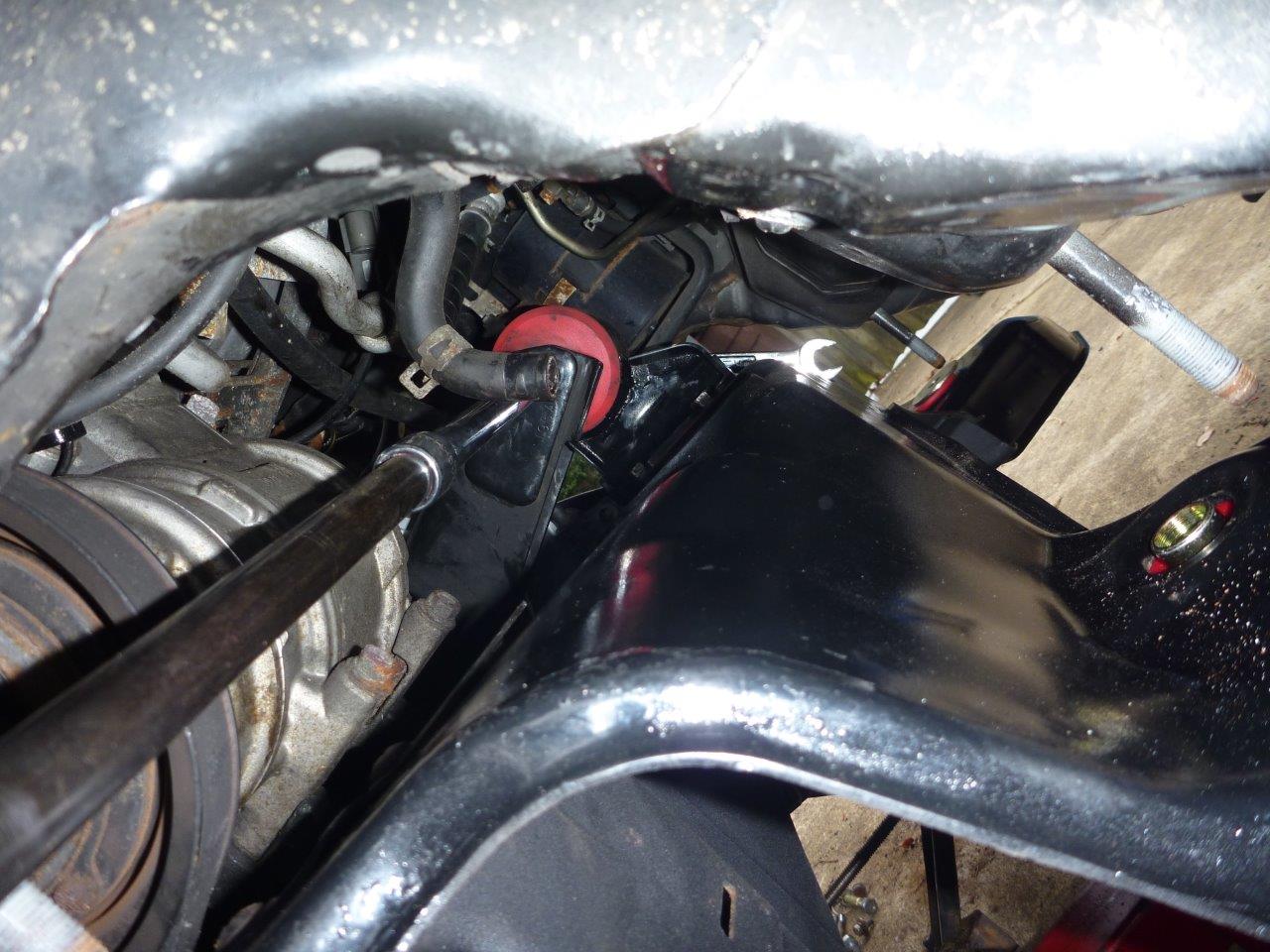

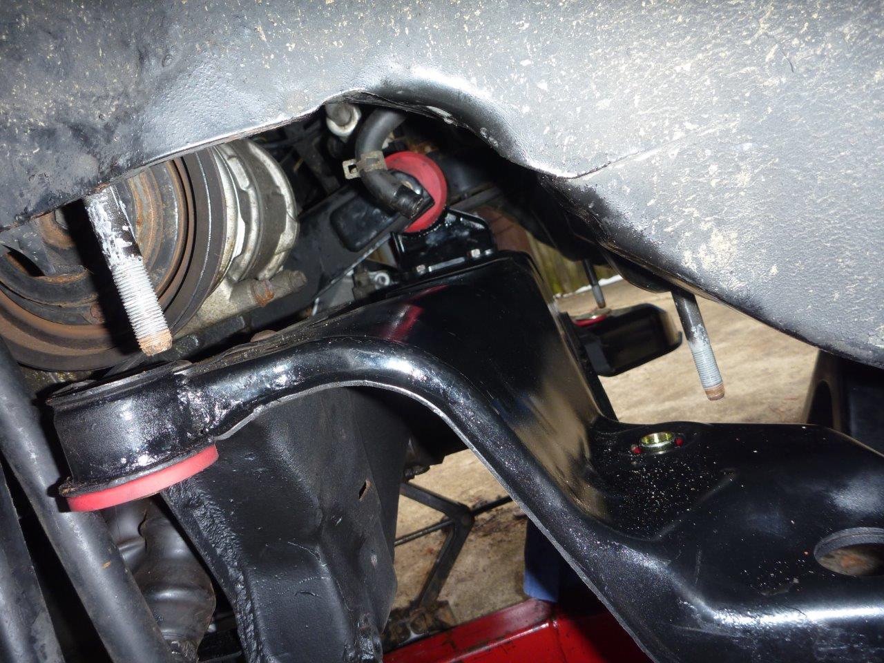

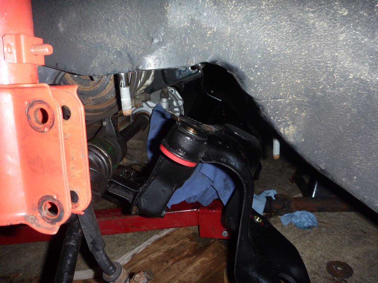

Putting everything back together is always the hardest part. I never did take the transfer case off, but the engine was currently being suspended by the engine lift so I just lowered it as far as I could, hung the subframe on the transfer case, attached the rear engine mount to the engine, and finally lifted the subframe up and attached it to the engine mount. At this point it would’ve been smart to get the steering rack and sway bar between the subframe and transfer case while I could still easily move things around, but I either didn’t think far enough ahead or had already forgotten how difficult getting the steering rack out was. To finish things up I got the subframe lined up with the appropriate bolts, raised the engine up, and installed the rest of the engine and xmsn mounts.
It’s a little late, but as I’m going through some of the pictures I noticed one I took showing what I found to be the easiest way to get the rear engine mount off. If you are replacing all of the mounts and have the engine on a lift you can lower it down, get a long extension and universal joint between the frame of the car and the subframe on the driver side, and a box wrench between the subframe and car frame on the passenger side. This makes removing the one bolt super easy. Having small hands also helps when the space is cramped.
With that all complete I painfully worked the steering rack and sway bar in. Getting the steering wheel centered and aligned with the steering rack seemed to be the most time consuming while getting the sway bar mounted with the new bushings was the most difficult. I finally got tired of centering the steering wheel then getting back under the car trying to connect the steering rack with the steering column without messing up the alignment so I talked my wife into helping me out. Having two people for this makes life much easier. I slid another long extension and universal joint between the car frame and subframe to tighten the bolt for the steering column to rack mount.

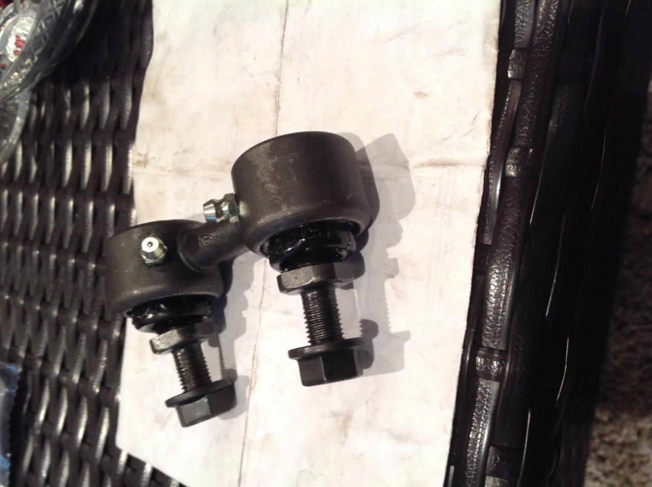

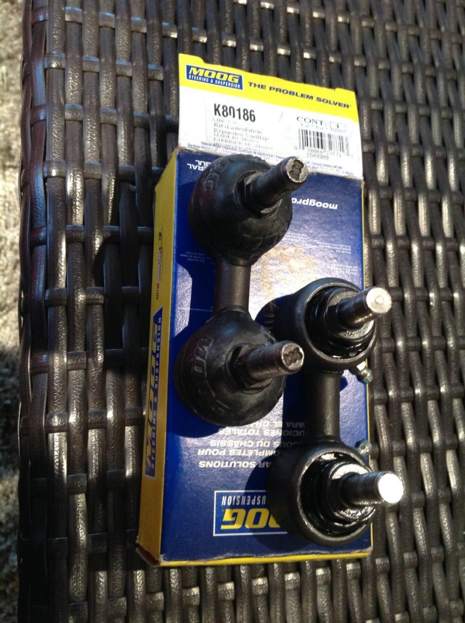

I got the lower control arms mounted and the first sway bar end link when I ran into problem #6 or Easter Egg #3. One of the Moog end links had a cut in the boot. After a few days I got a replacement, but the replacement looked completely different than the first two I ordered and even looked like it may have been a previously returned part. I was told that it was the right part and decided I just wanted to have my car operational so I went ahead and installed it.

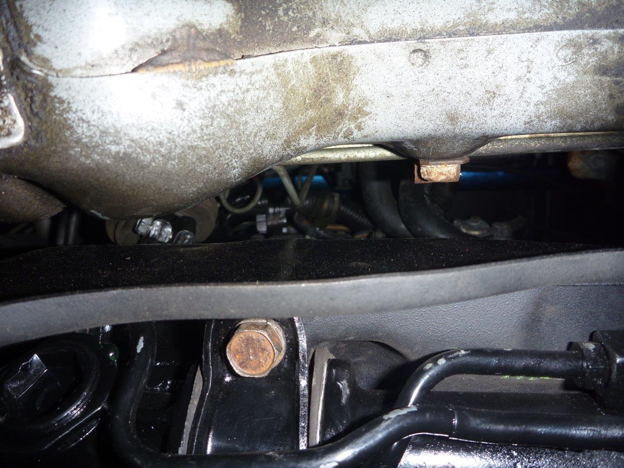

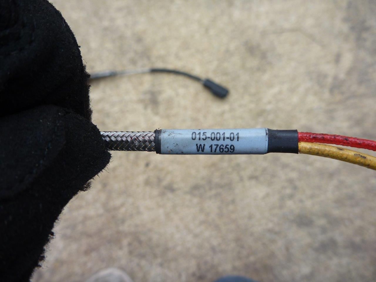

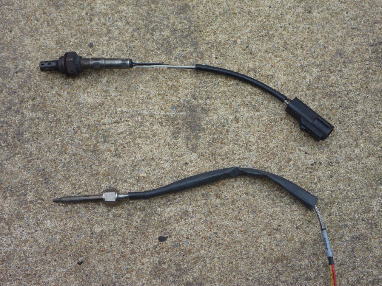

With everything put back together I just had to install the catalytic convertor before I could get my emissions and safety checks complete so I could finally register it. I received a folder with some receipts for a handful of work that was done to this car by the previous owner. One of the items was a 2.5” downpipe and off road pipe from Buschur racing. With that in mind I was going to order a 2.5” universal catalytic convertor and call it good, but something didn’t look right after I pulled it out. First off there were two sensors that were screwed into welded on nuts on the down pipe. One turned out to be a Ford Ranger O2 sensor and the other is an unidentified EGT sensor. The odd thing is that neither one of these sensors was connected to anything. The pigtails were just zip tied to something else. For the time being, I uninstalled the EGT sensor and capped the port, but the Ford O2 was an 18mm thread and I couldn’t find anywhere that sold a bolt of that size so I just left it and zip tied the pigtail again.
The other odd thing was that the downpipe was indeed 2.5”, but it widened to 2.75” about even with the oil drain plug through the flex joint and widened to 3” after the first carrier bearing. I ended up buying a new 2.75” Magnaflow universal catalytic converter and installed it right behind the flex joint. It only took a minute to make the two cuts and smooth them out, then I just slid everything together and tightened the clamps. I was secretly hoping it would quiet the exhaust a bit, but I really didn’t notice any difference.

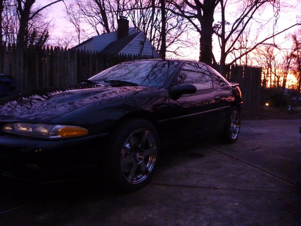

With the car back up and running I took it for a quick spin to break in the brakes. The car runs like a champ.. Something I haven’t experienced with my other Talon in a long time. I did notice that the brakes were “soft” after doing the 3kGT VR4 upgrade, but that was just because I didn’t do enough research and it turns out I need to install a better brake booster and master cylinder. Not a huge deal for the time being. The best part came about an hour later when I passed my emissions and safety inspection.
With the car running and officially legal to drive I figured the first stop should be for a new alignment. In going through my folder of goodies from the previous owner I saw that he had gotten everything aligned right before selling it, but I don’t trust my finely tuned eyeball after replacing the steering rack. The closest shop was a Pep Boys and I took advantage of their online discount to set everything up. They didn’t have a drop down for Eagle so I just went with Mitsubishi GSX and figured it’d be all good. Turns out I was wrong.

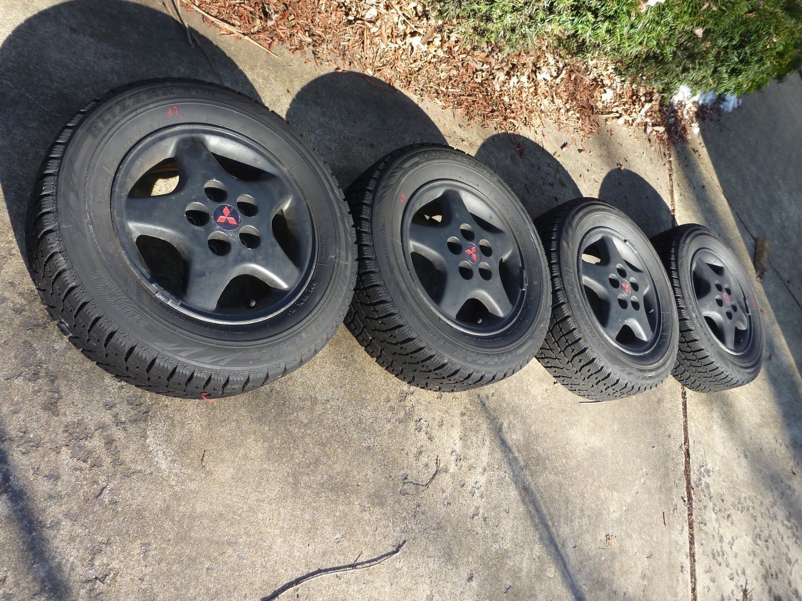

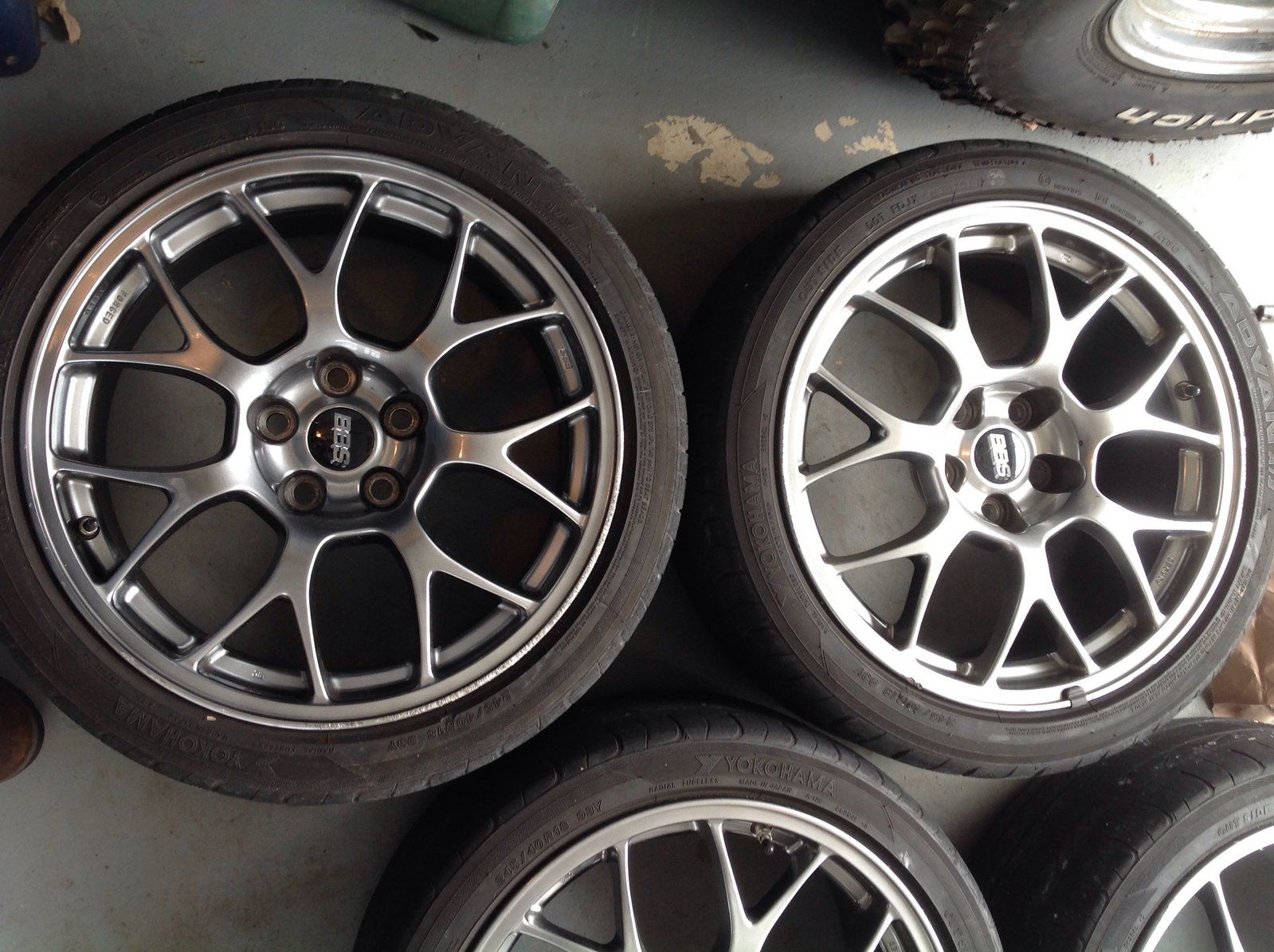

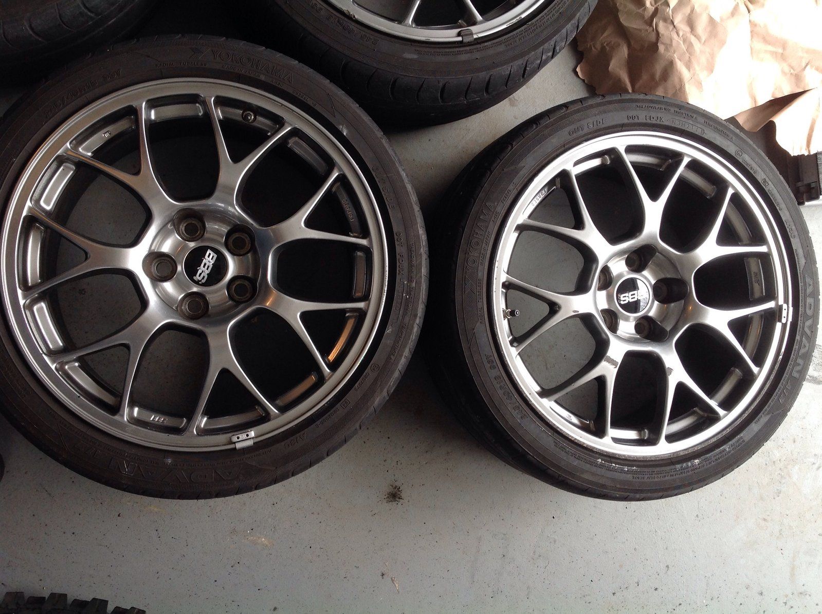

In response to an issue I previously created by upgrading to the VR4 calipers, I started looking for new wheels last winter. I'm not a fan of using hub centric spacers nor was I thrilled with all the crap covering the side of my car after a short drive.
I found a guy up in Baltimore with a EVO MR that was selling his BBS wheels for $1000. I got him talked down and headed up in in Feb. As soon as I got on the road it started snowing and before I knew it there was a full blown snow storm in the DC area with everyone driving like it was their first time seeing snow. I made it about 15 miles in 90 minutes before throwing in the towel and heading back home. I learned two lessons from this 1) look at the weather forecast before driving anywhere in DC and 2) Sumitomo HTR A/S P01s are horrendous in the snow. I barely made it up my driveway and it's not a very steep incline.
I made it to Baltimore the next day, met the seller at his house, grabbed one wheel to test mount, and proceeded to slosh through a snow filled parking lot to conduct my test. Everything worked out and I am now the proud new owner of a set of BBS wheels. The previous owner had lowered his car without making proper adjustments so the tires were garbage so I just reallocated my old tires to the new wheels. He was also unable to avoid the curb and had wheel weights mounted on the outside for whatever reason. They're still good enough for me and they'll give me something to practice powder coating on once I get a few other projects out of the way.
