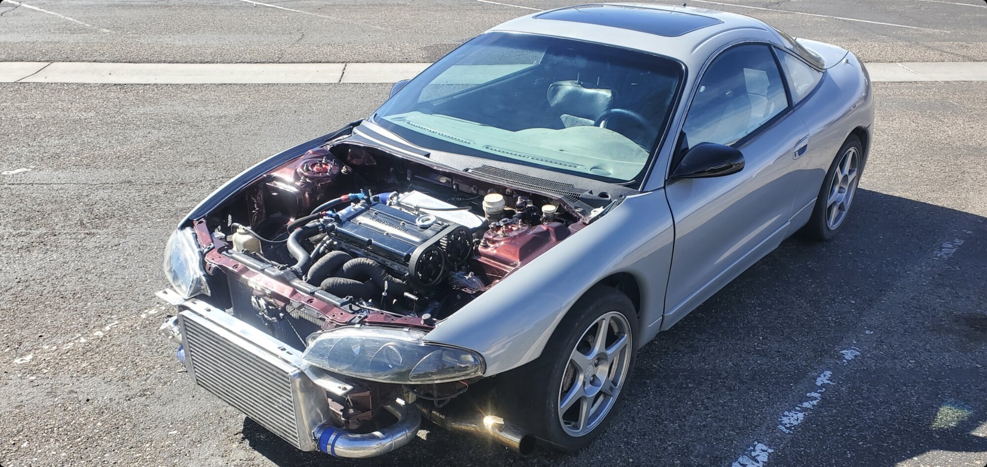

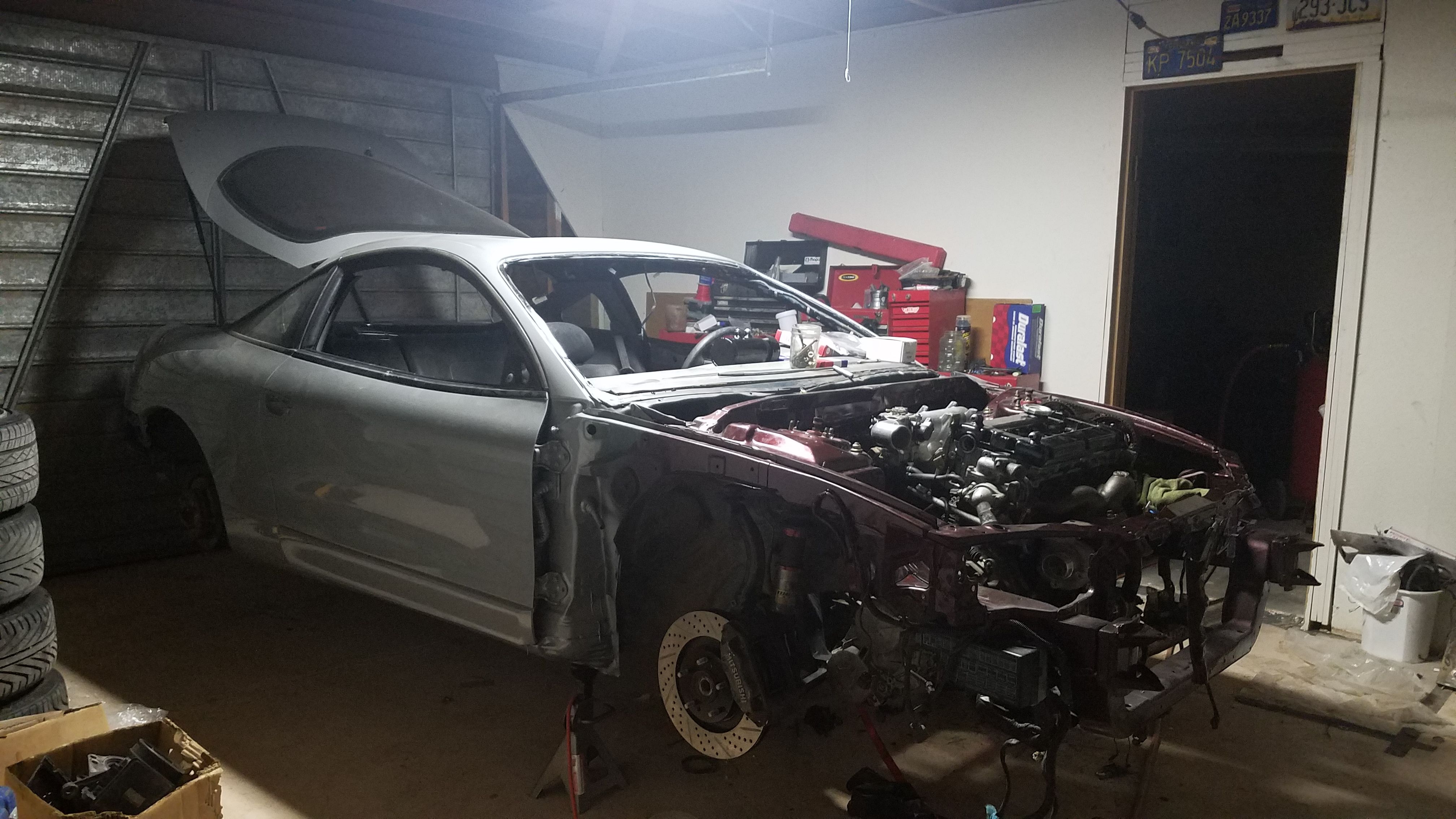

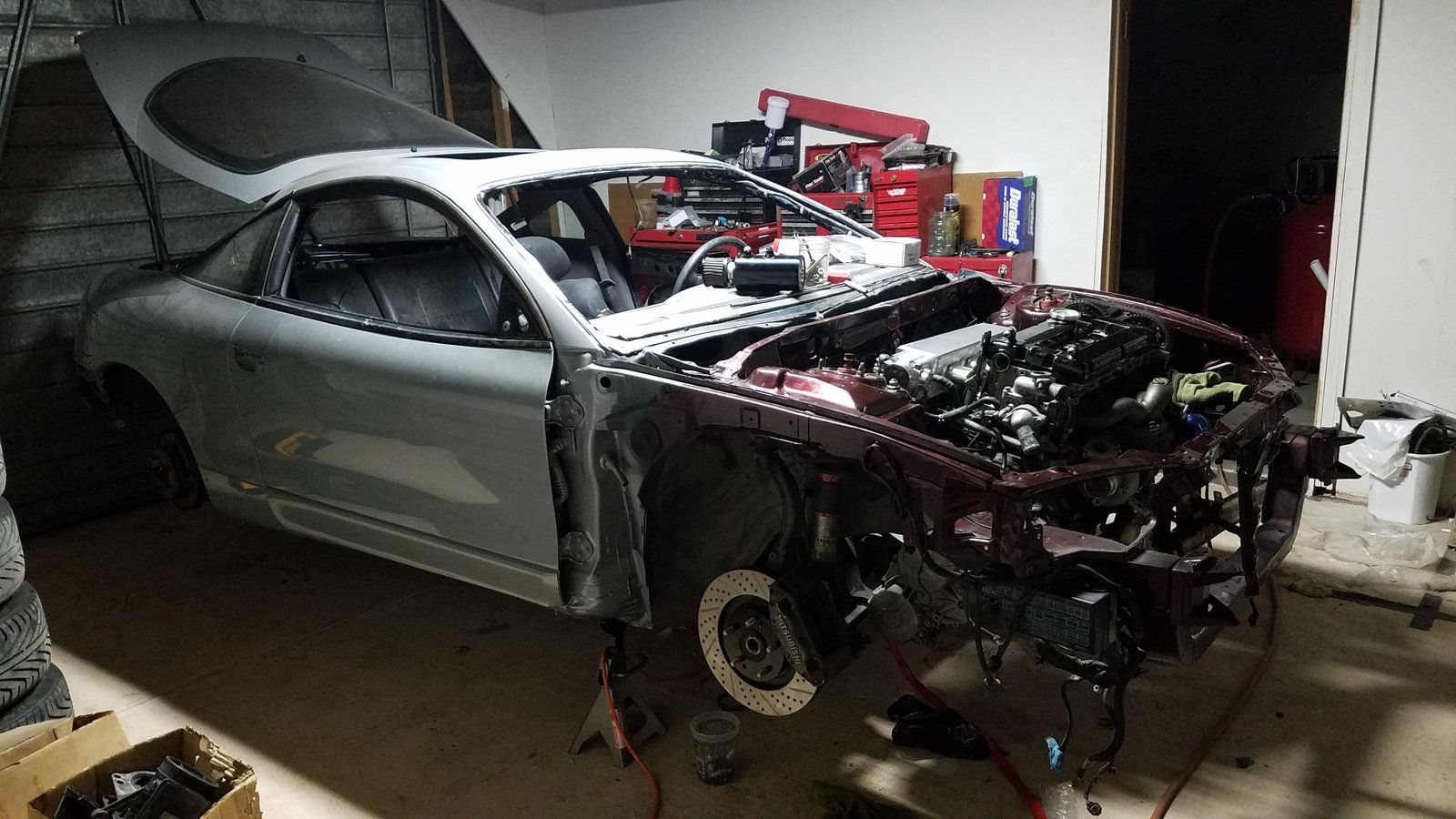

This is the car that I have been spending all my extra money on. Also the same car that is going to put a big smile on my face!!!

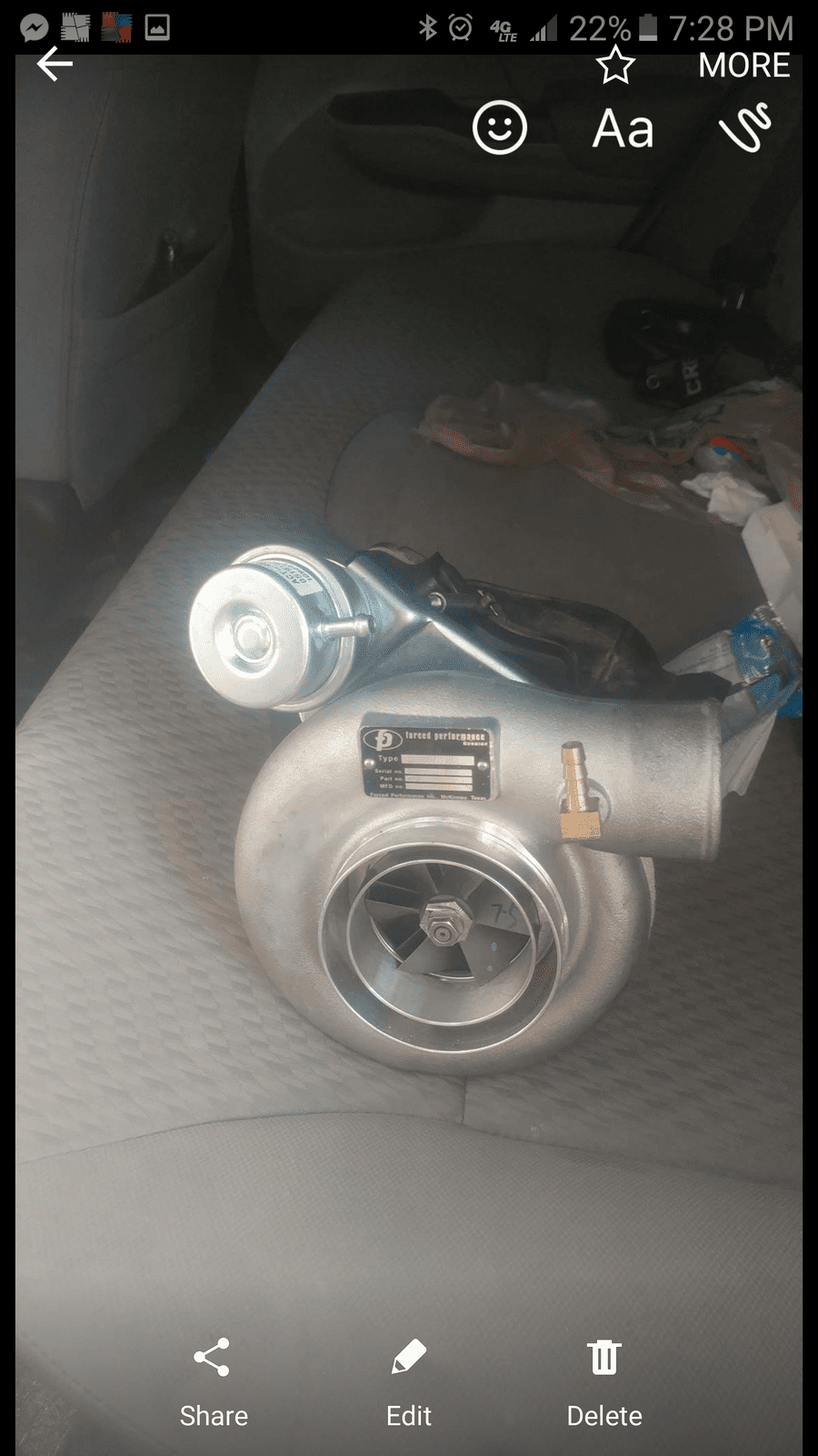

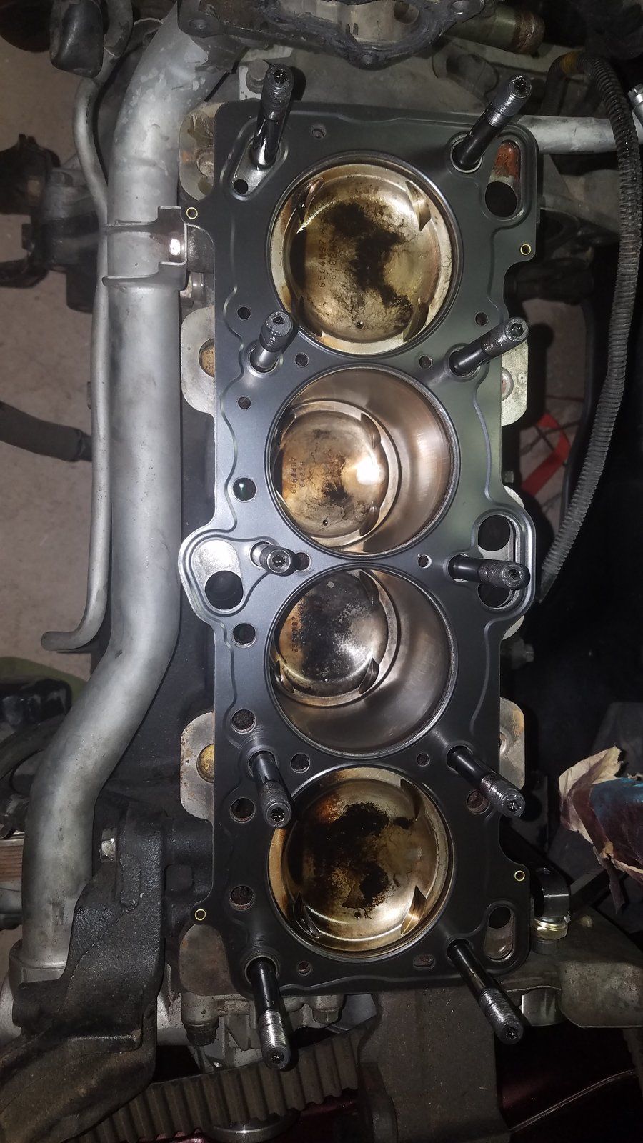

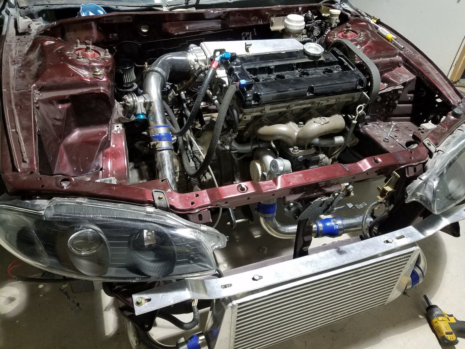

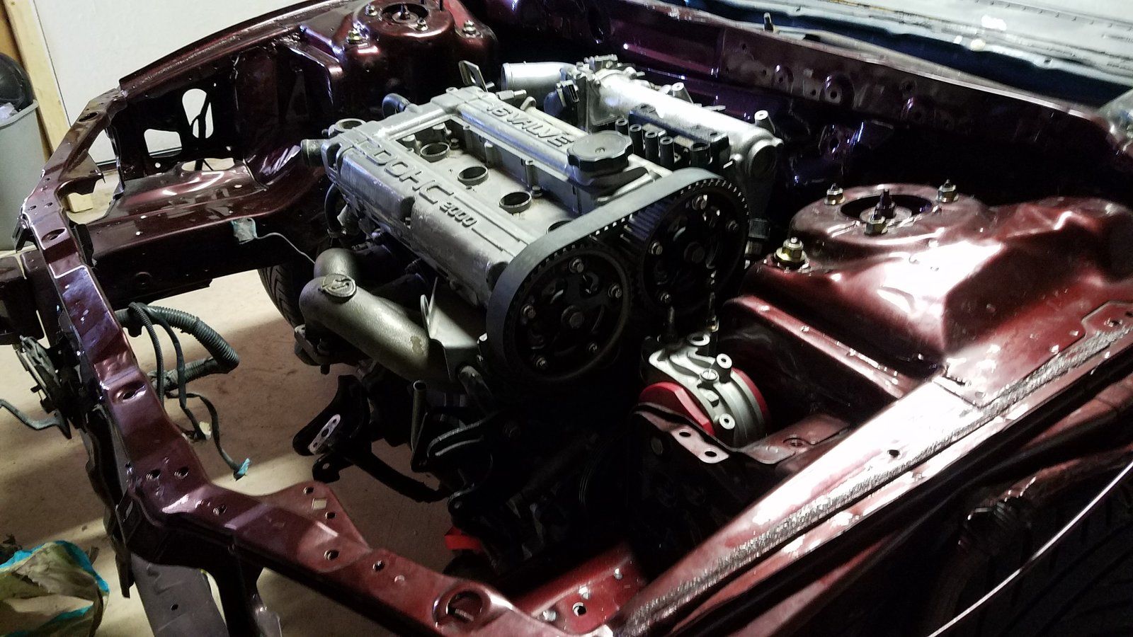

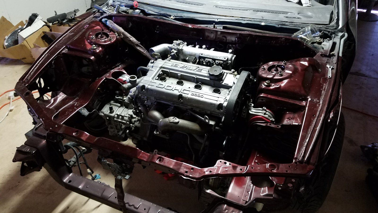

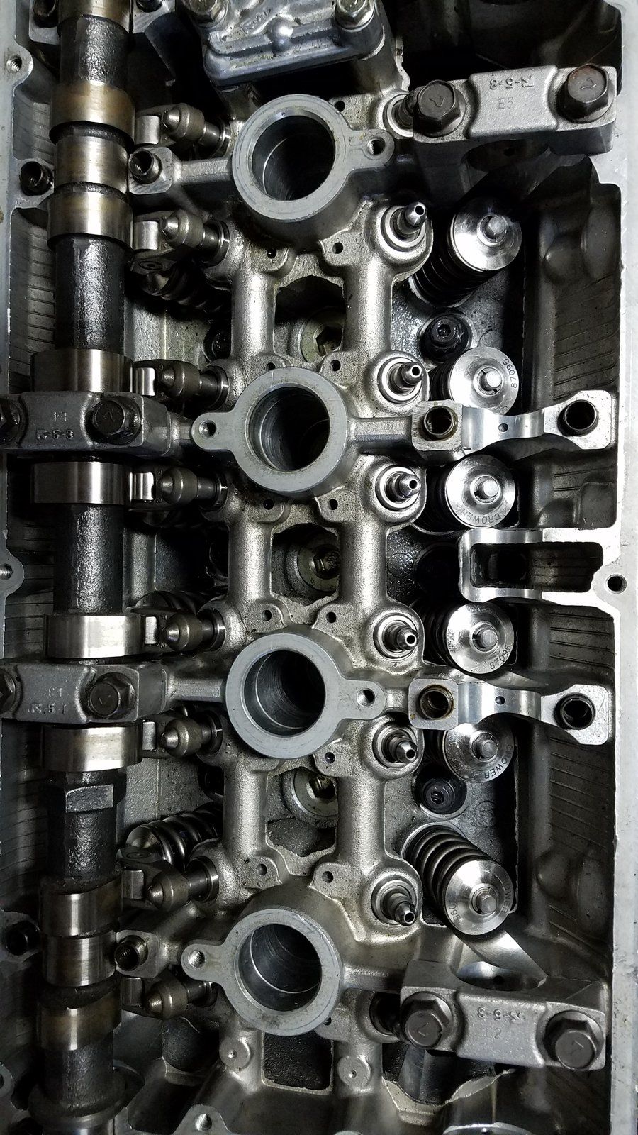

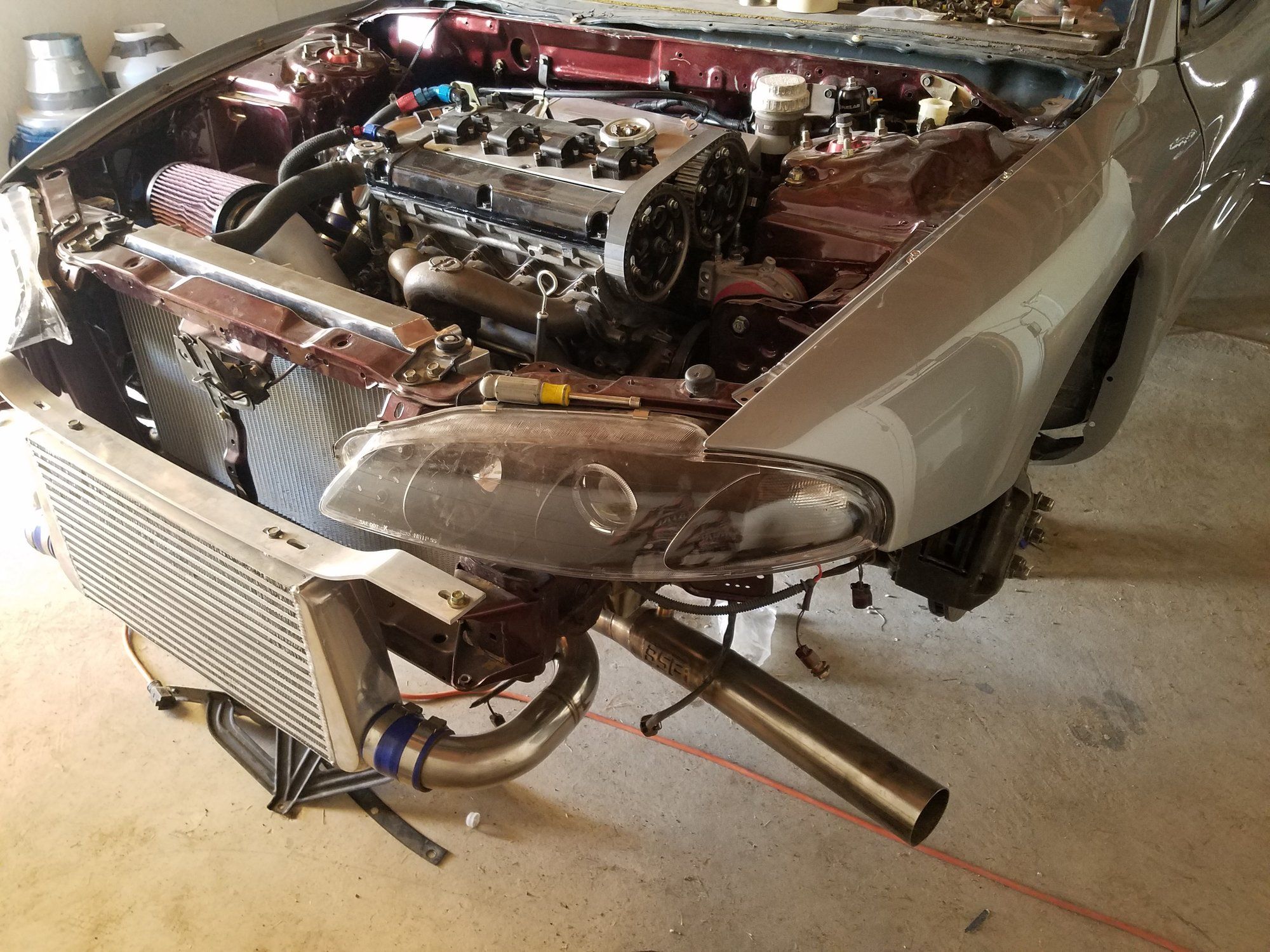

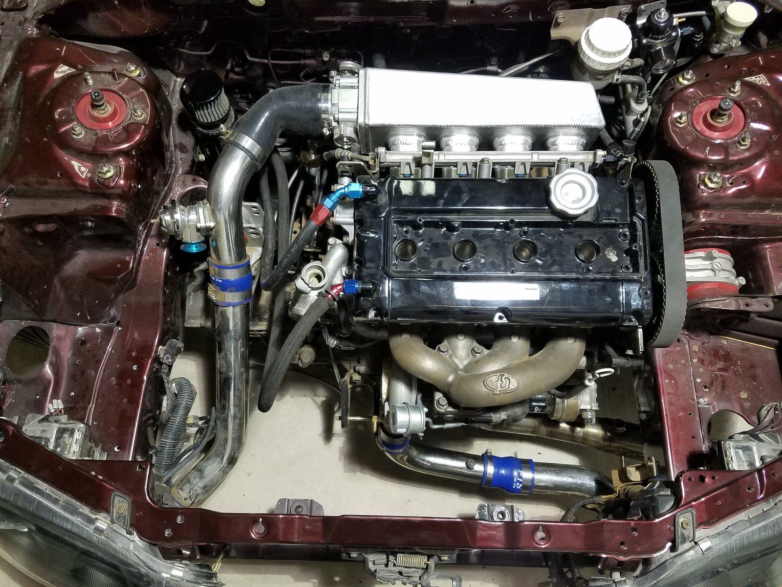

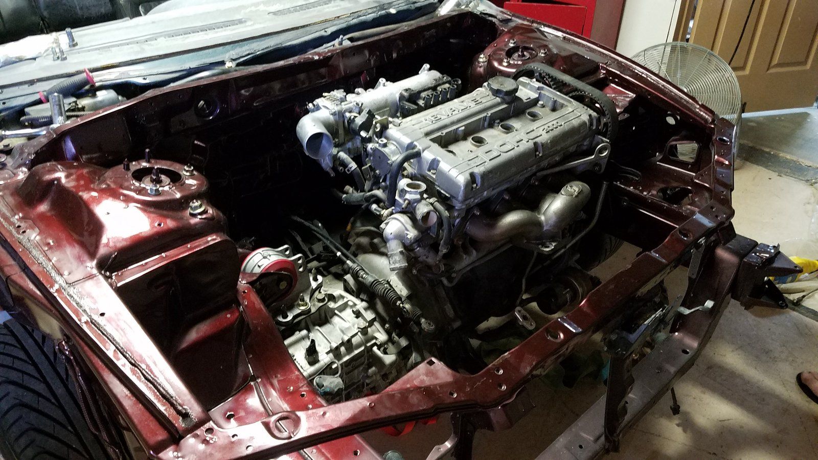

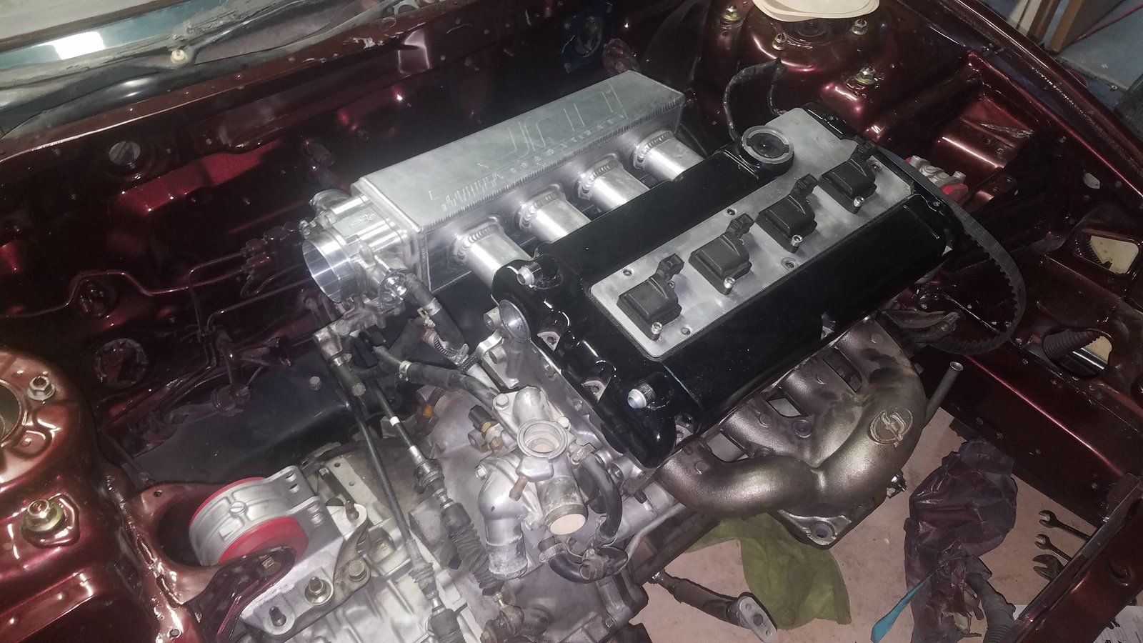

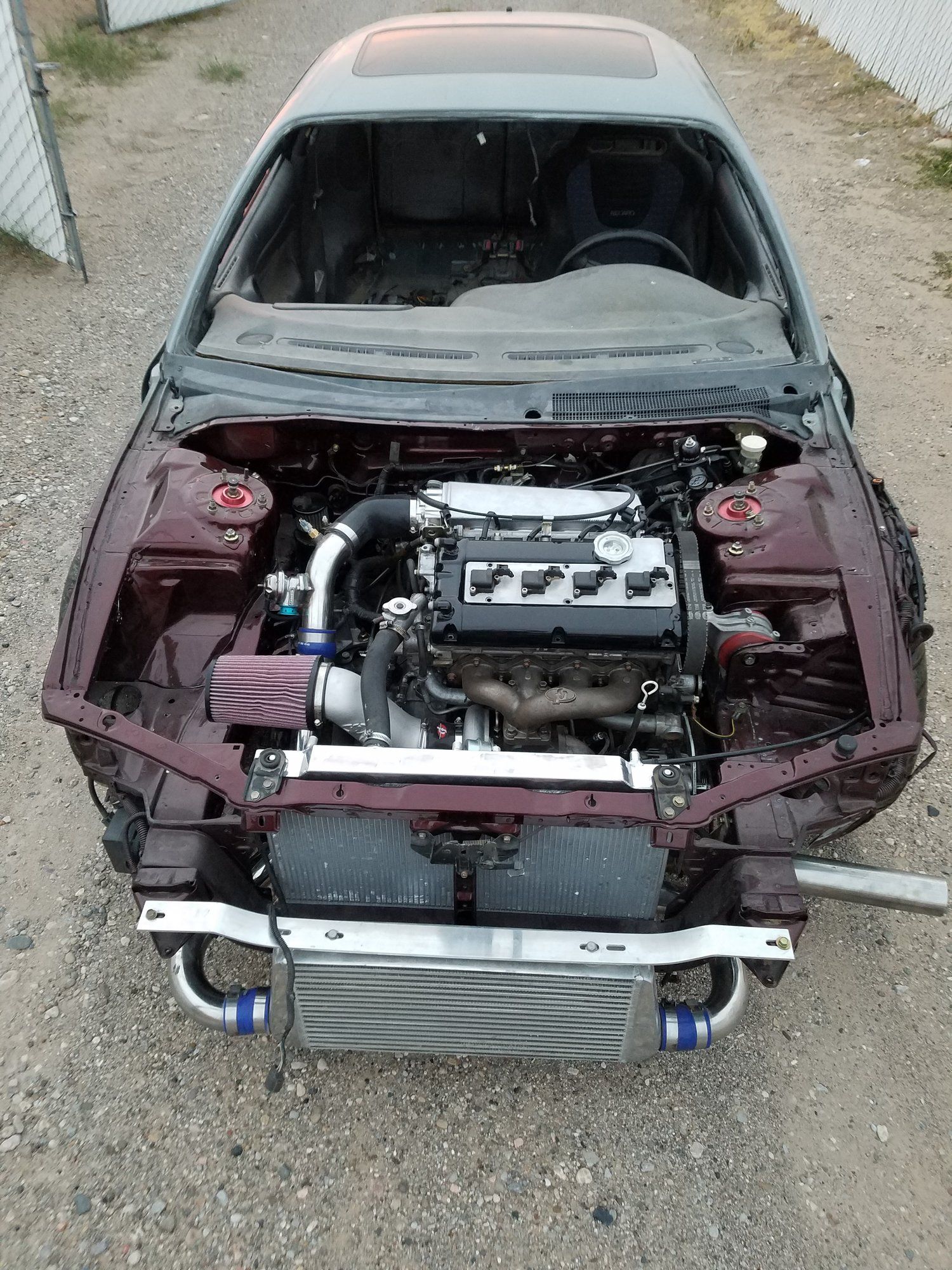

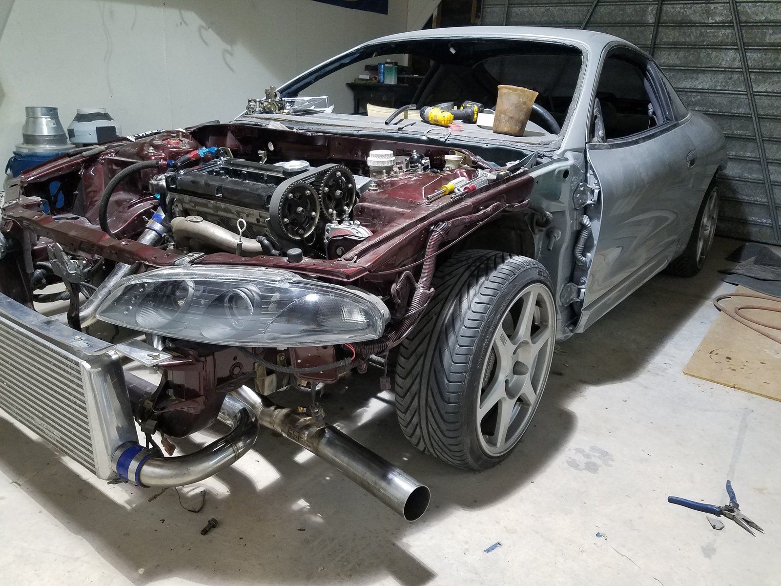

I have made quite a few changes to my build that I will add to my mod list. I recently traded my fp 68hta for a ported old school fp red with gt35r compressor wheel rated at the 65 lbs/min. I also had a stock head with crower 264 cams which I removed and put my built head on with 1mm over valves, crower springs/titanium retainers and crower 280 cams.

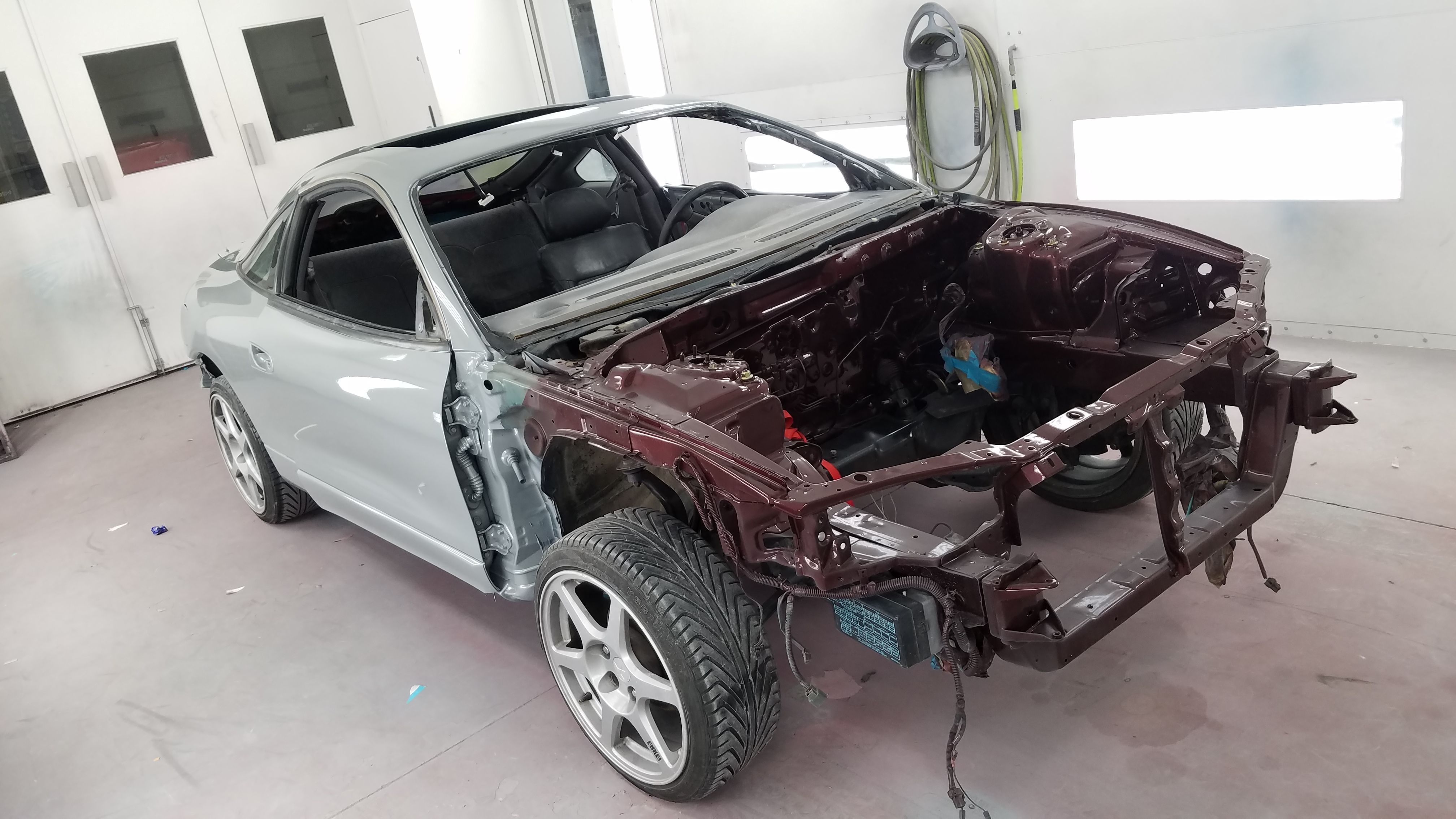

Finally got some time to work on the dsm after a bunch of life stuff happening so I'm pretty excited about it. I'm saving up for the tune now so should have that done in the next couple weeks. I really enjoy how the car has come together so far. Even with all the set backs and misfortune along the way I still love this car

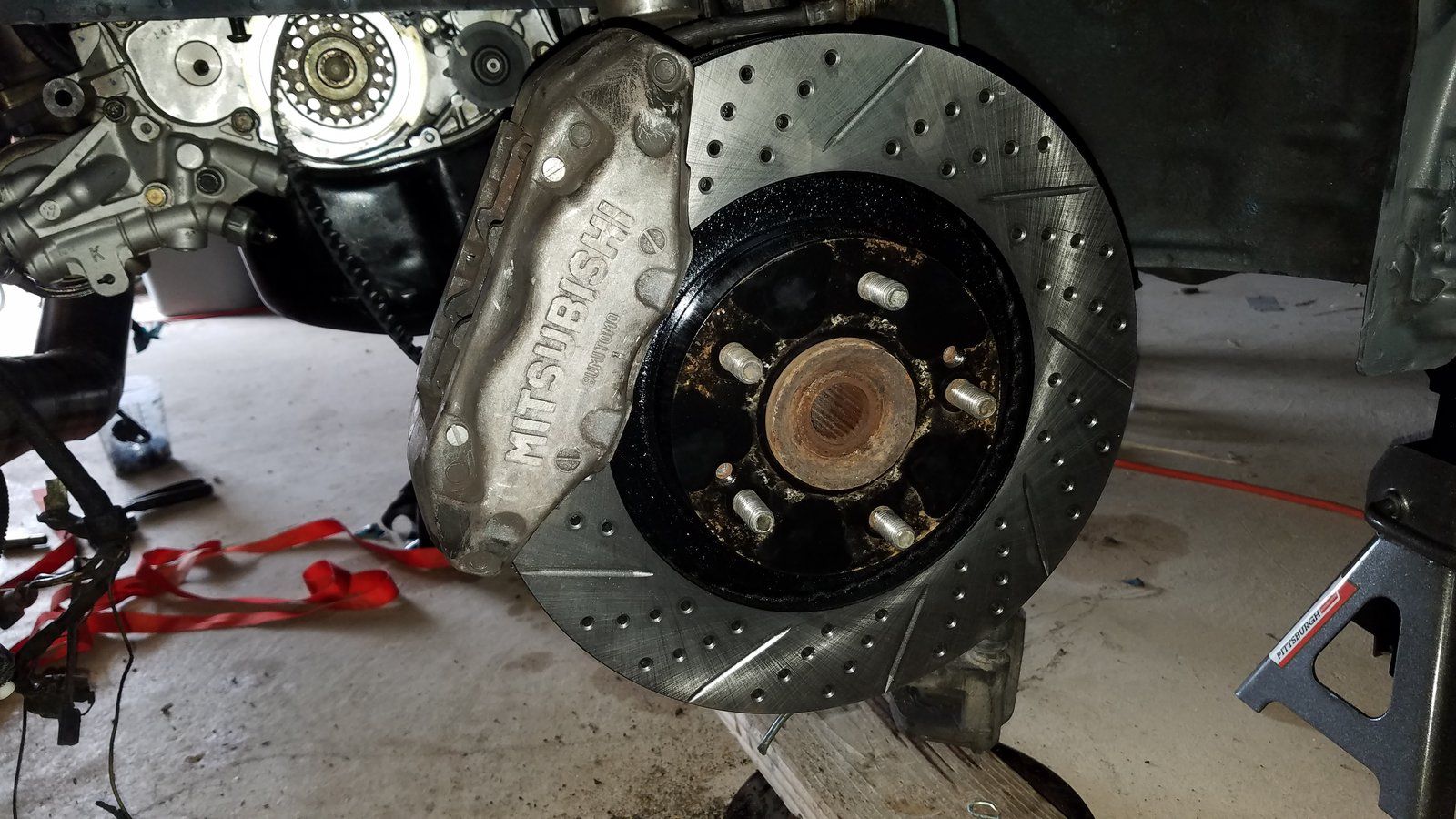

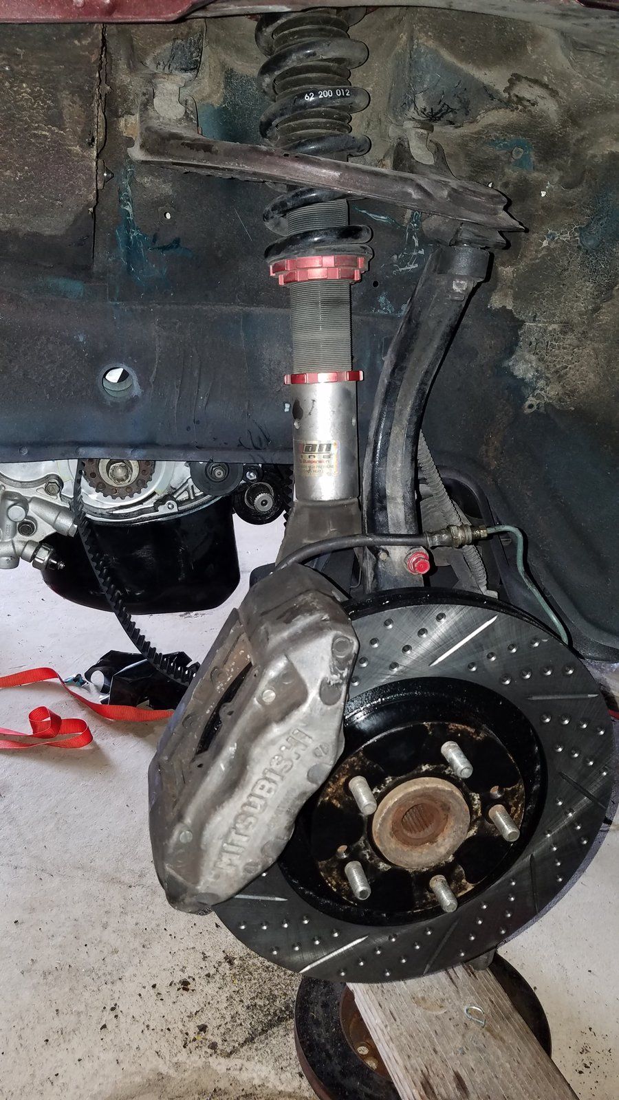

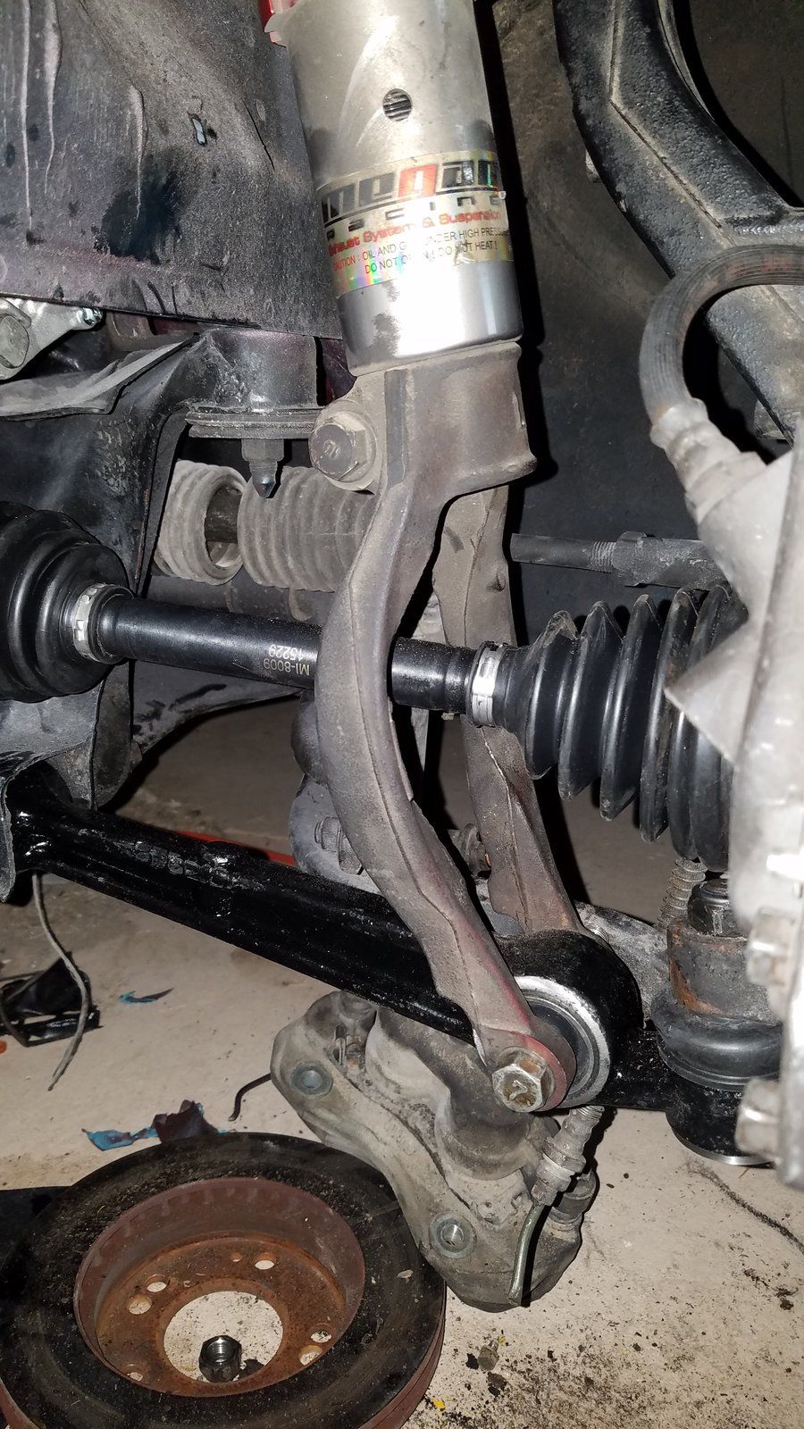

Great progress! How much of a PITA was doing the VR4 Calipers? I eventually want to upgrade my brakes but really there is only aftermarket kits (as far as I can tell) for the front calipers.
It was actually super easy. The only thing I did was cut the stock banjo bolt down so it would fit all the way into the caliper. Bertha smith but known chinaloa69 on here makes the brackets. These brakes utilize the 2g 3kgt rotors with 1g 3kgt calipers
