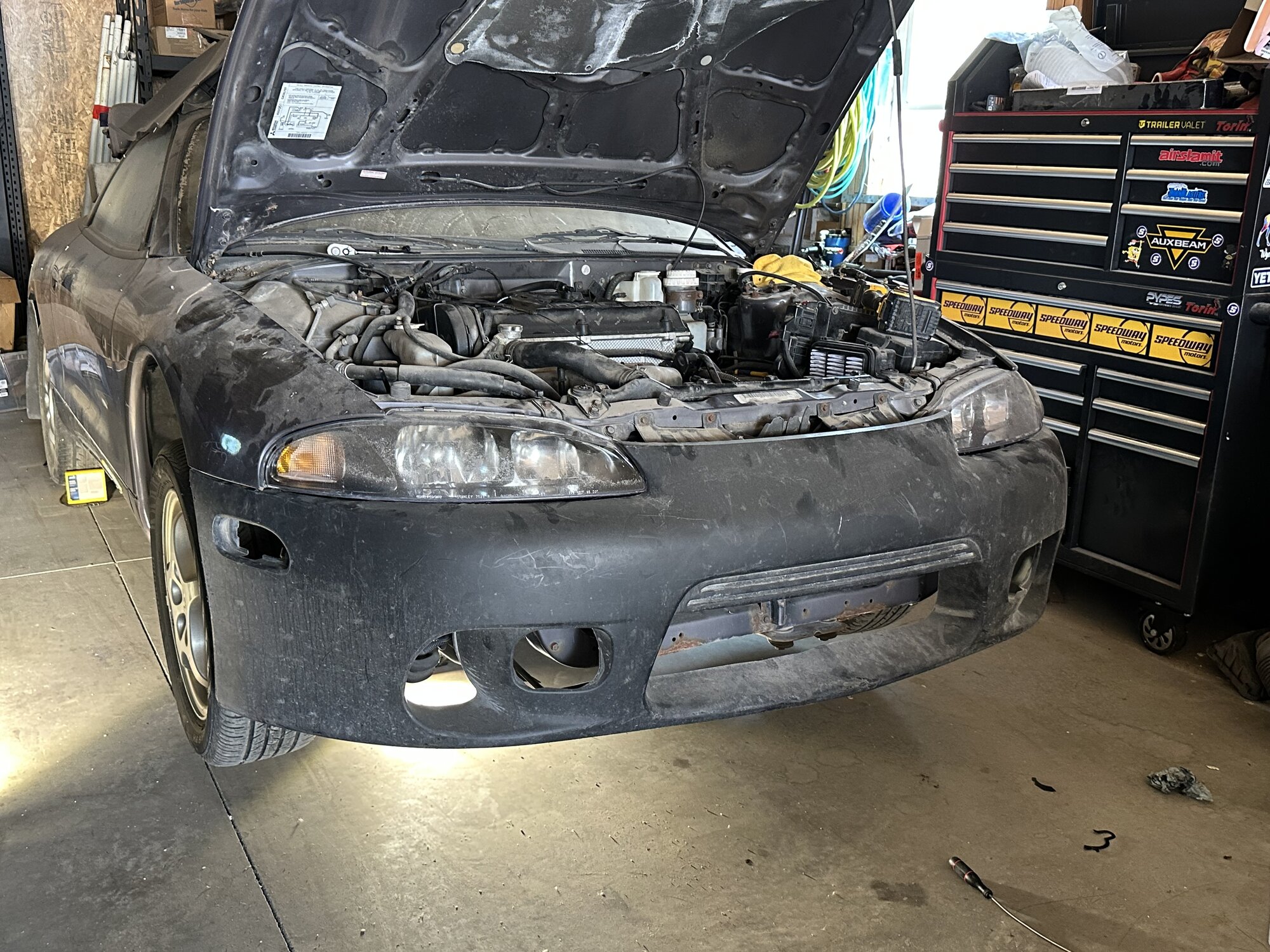

Ok so this isn’t my gsx, this is the first eclipse I purchased before I knew there were two motor options. For the past couple of weeks I’ve been working on the fuel system to get this thing running. I replaced the fuel pump and fuel filter. Dumped the gas went to start and found the injectors were clogged/rusted shut. I ordered new injectors and it started right up. I’m honestly surprised at how well it’s running after sitting for who knows how long. Then I spent some time shampooing the carpets and seats cleaning the interior up. Now I’m waiting on the fuel gauge sender. Apparently they only make them in Japan now 😂
