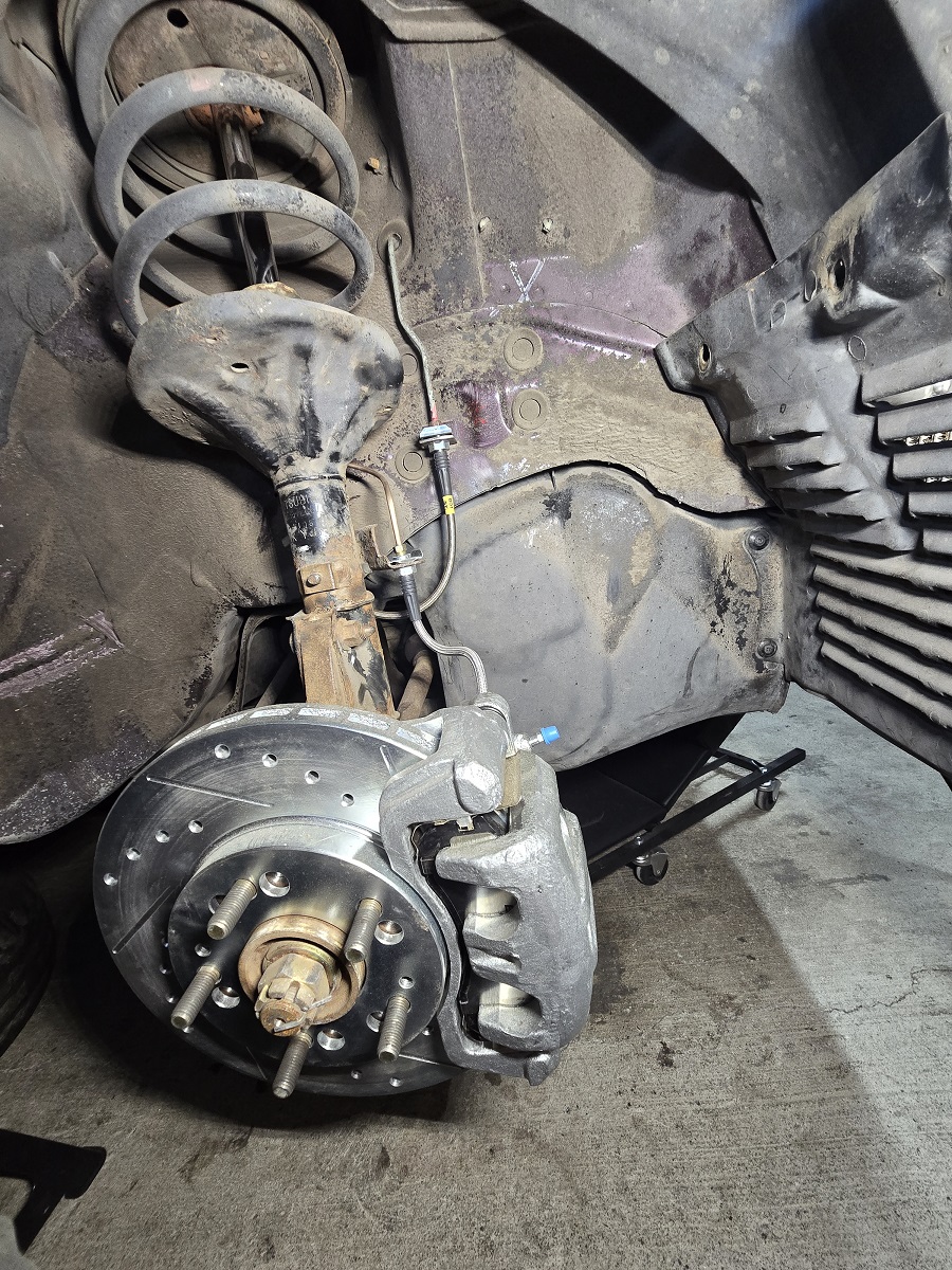

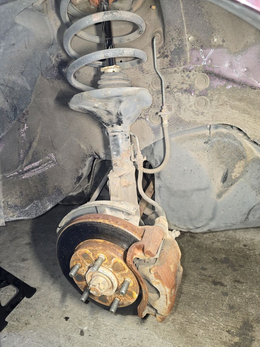

sorry i havent been keeping up with my build on here at all... but im gonna try to do better from now on. heres a quick update and a couple pics of what i did today. changed the brake rotors calipers and lines all around. went from the stock 1g front brakes to the newer 2 piston calipers and slightly bigger rotors. in the rear i used 1g fwd calipers slightly modified to fit my awd. drilled/slotted rotors, pads, and braided ss lines bought from stoptech.
heres the before and after pics (of just one of the four corners).
What did you end up using for front calipers? I'm thinking about doing the same but I already have 1g SS brake lines, so I'm trying to avoid the 2g banjo fitting.
I used 2g front calipers which with everything I've read, the banjo bolts are required apparently. I didn't try to make it work with straight fittings, so I can't say for sure they wouldnt be a problem unfortunately.
