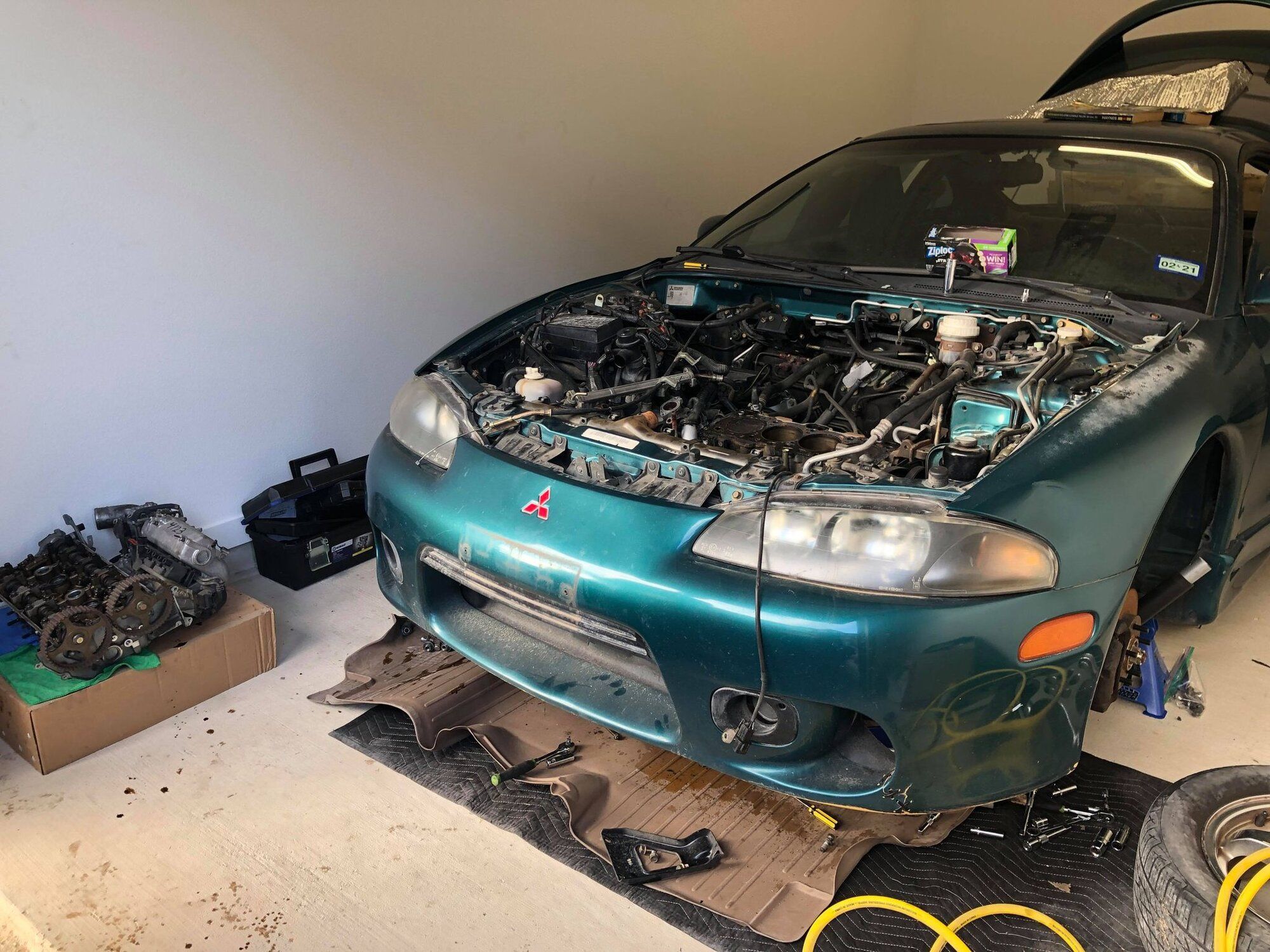

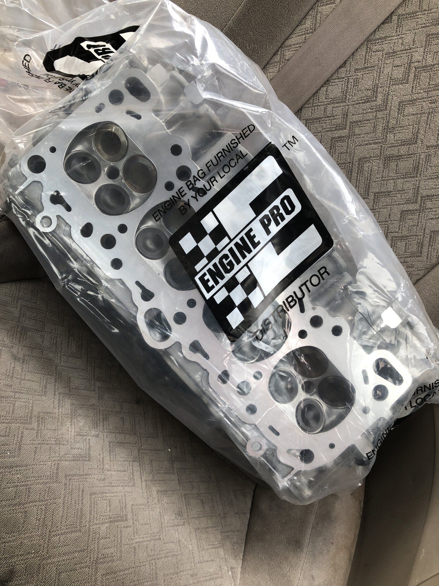

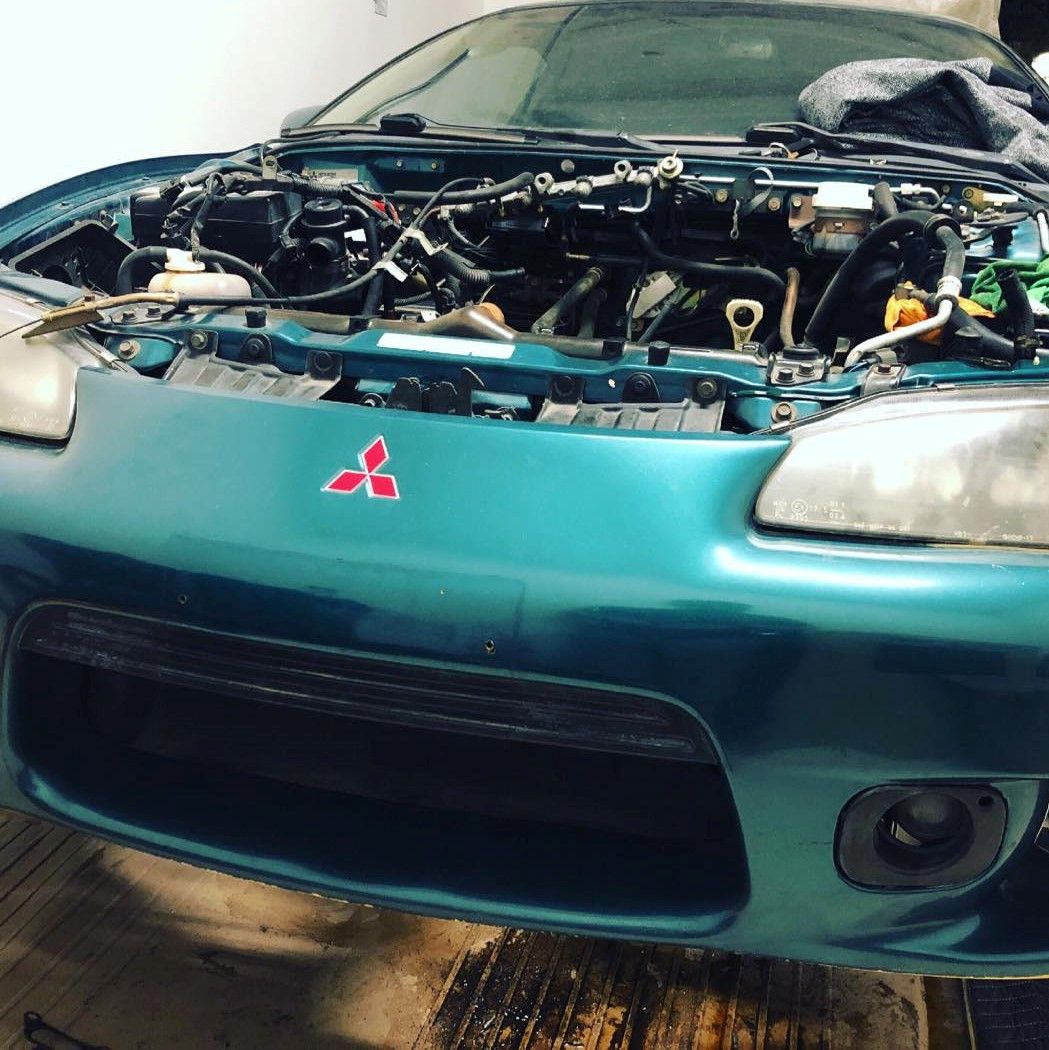

Got the head off my new GST the other day, valves are bent sadly. Owner must've been driving when the tbelt snapped. Ill be looking for a complete good used head if someone has one for sale! Need new timing components as well, belts and pulleys. And need a new Drivers seat as the one that was in the car was totally destroyed.

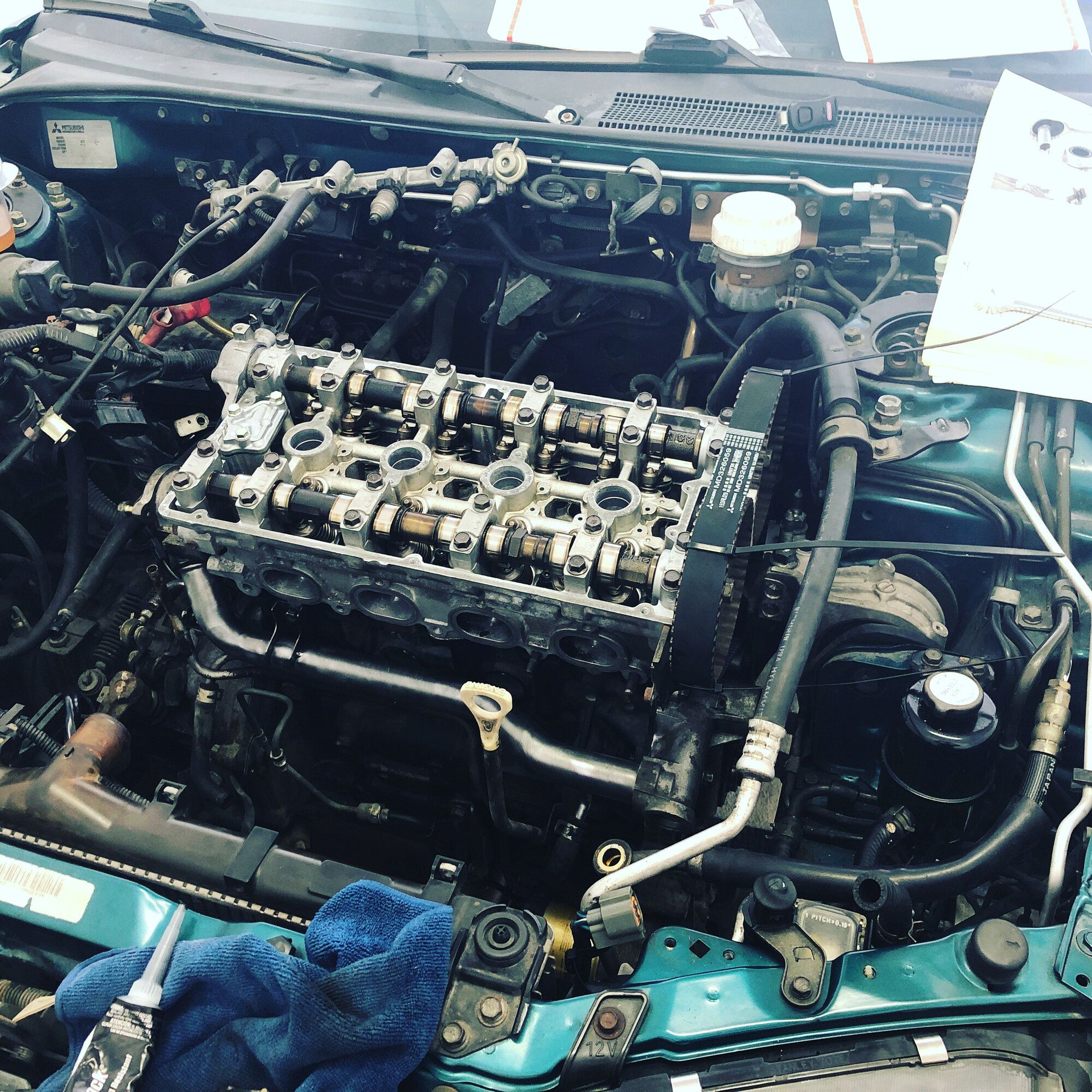

Got everything nice and ready for new parts. Got timing components and gaskets and such all on the way and should be in next week! Need to install rockers, lifters and cams in the new head and then we are good to go! Cant wait to listen to this thing run and move it under its own power!

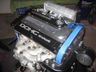

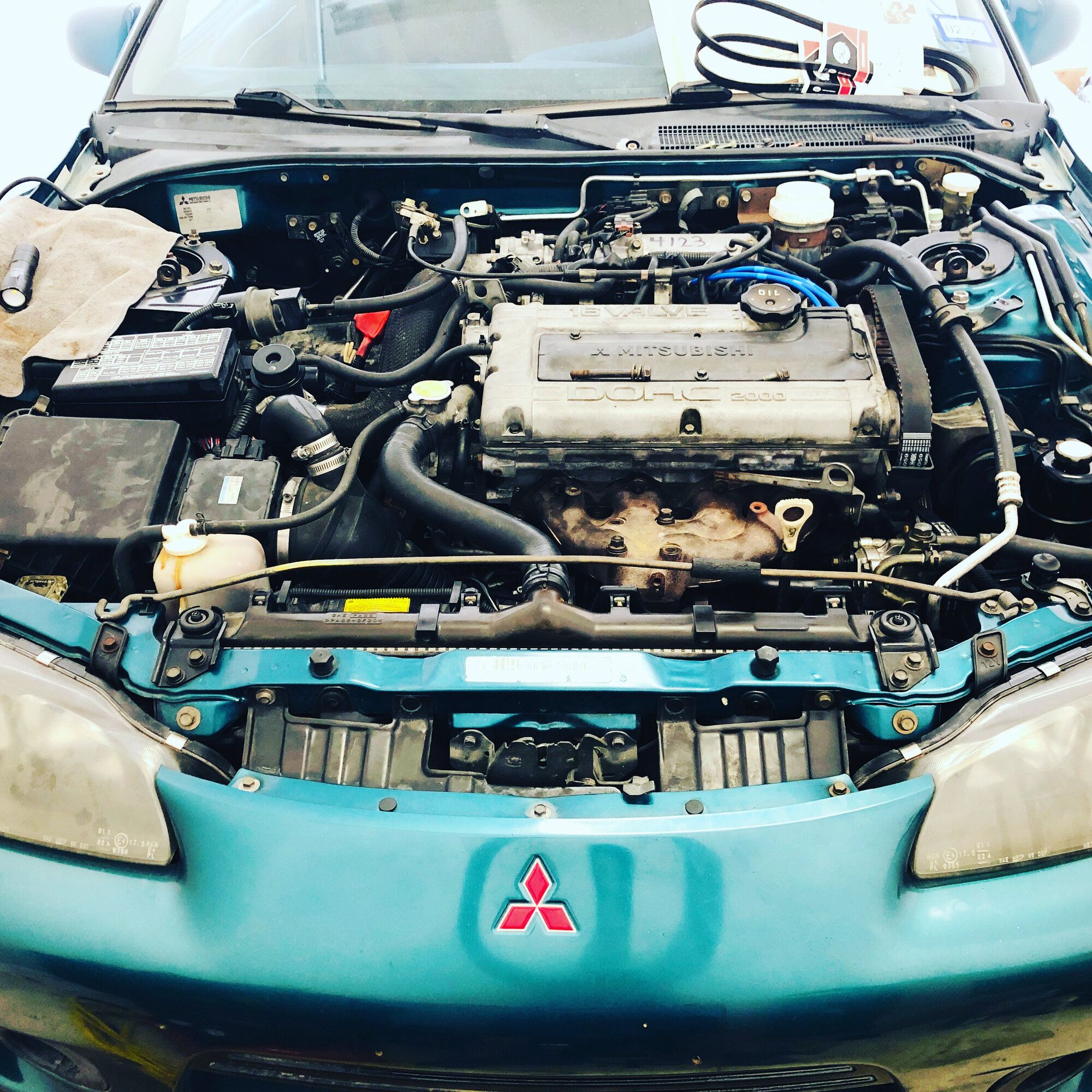

Got all the new parts for timing and gaskets and so fourth. Got the beautiful new head on and assembled. Almost done putting everything back and going to be doing a first start tmrw hopefully! I have a broken off exhaust bolt from the manifold to the hot side of the turbo housing. It sucks. But hey otherwise it’s all going smooth! I plan on trying at it tmrw to try and get it 100%. But I haven’t even heard her run yet! So I’m excited for that.
