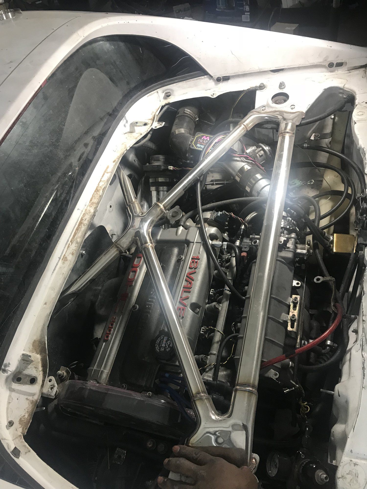

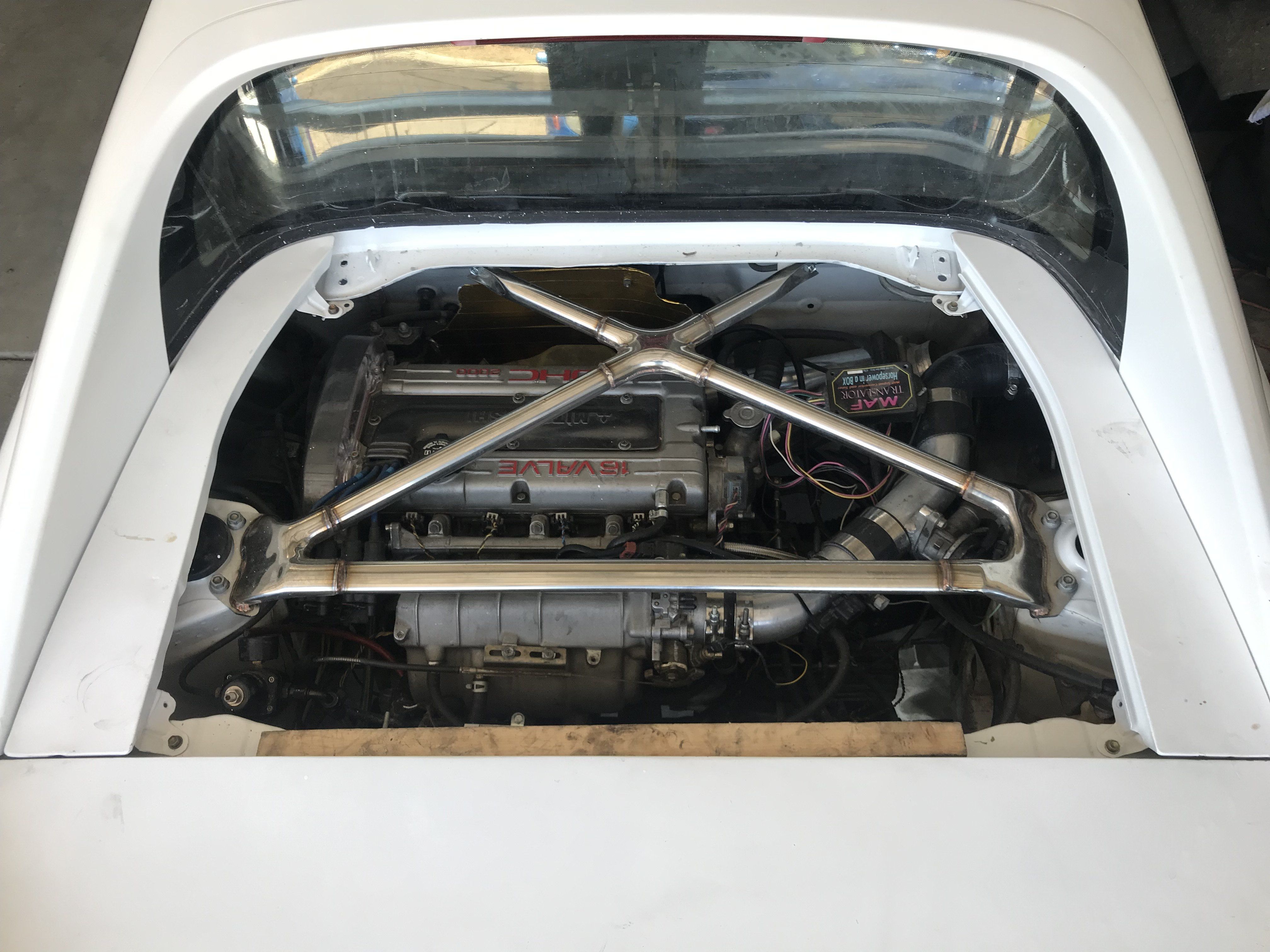

so I ended up finding reasonable cables from https://jb-custom-fabrication.myshopify.com/. 96" cables seem to work best as far as wrapping all the way around. One had to be cut and modified for the 2" stroke and rod out length. The cable holder on the rear also had to be moved back at the transmission. I will have pictures and hopefully a driving video up this weekend. once I get it driving and at least the cluster working I will break down all the components with details. here is the current layout with the TCS X-bar held up for the likes:

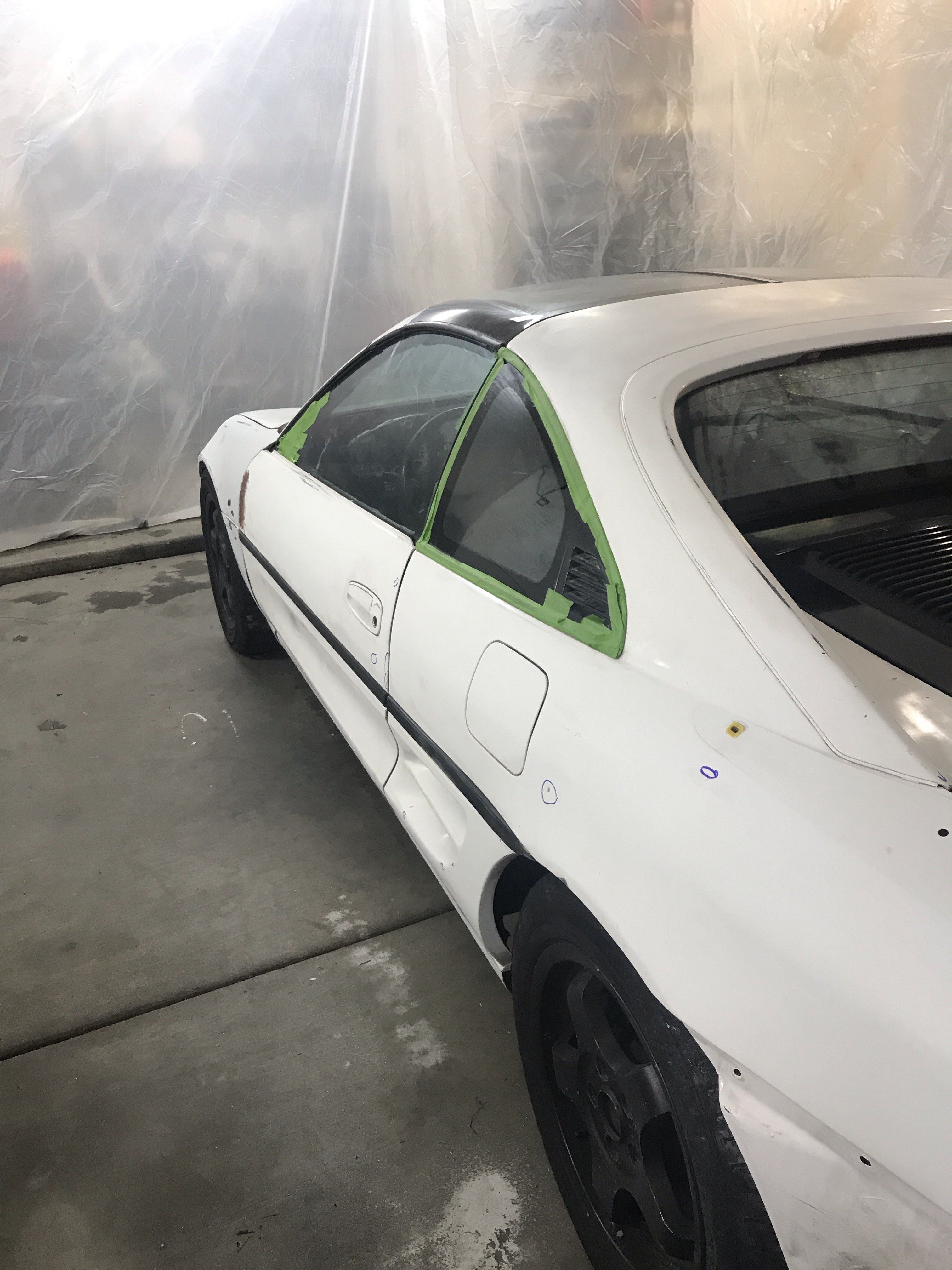

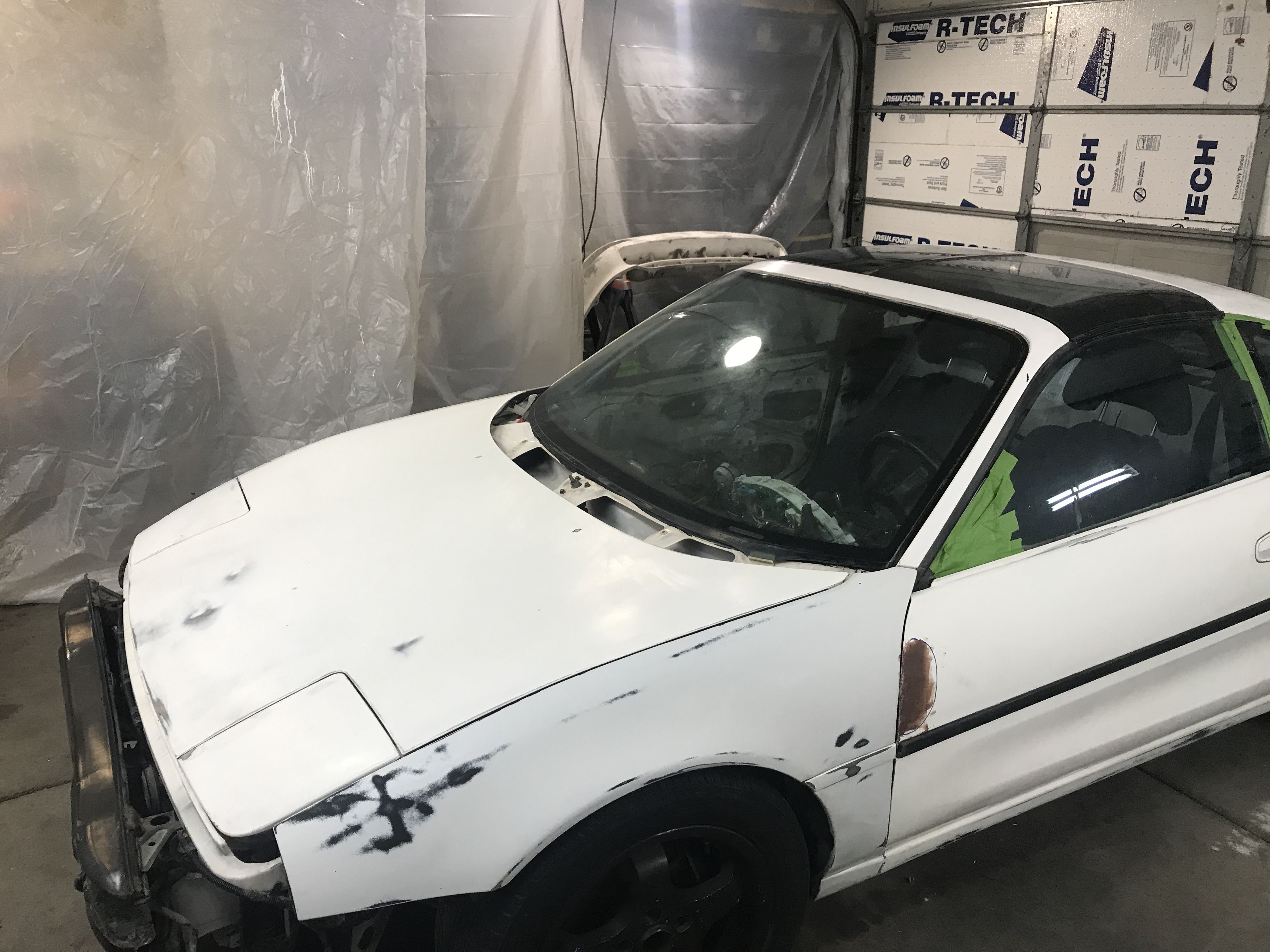

I bought paint I opened the can and the paint looked weird I thought it was just the light so I filled the gun and I sprayed a large portion of the car before i was convinced it was the wrong color. Not only was it the wrong color the chemical make up was all wrong it made runs all over I will post pictures when get the runs and paint to look decent.

Paint is good from far but far from good.

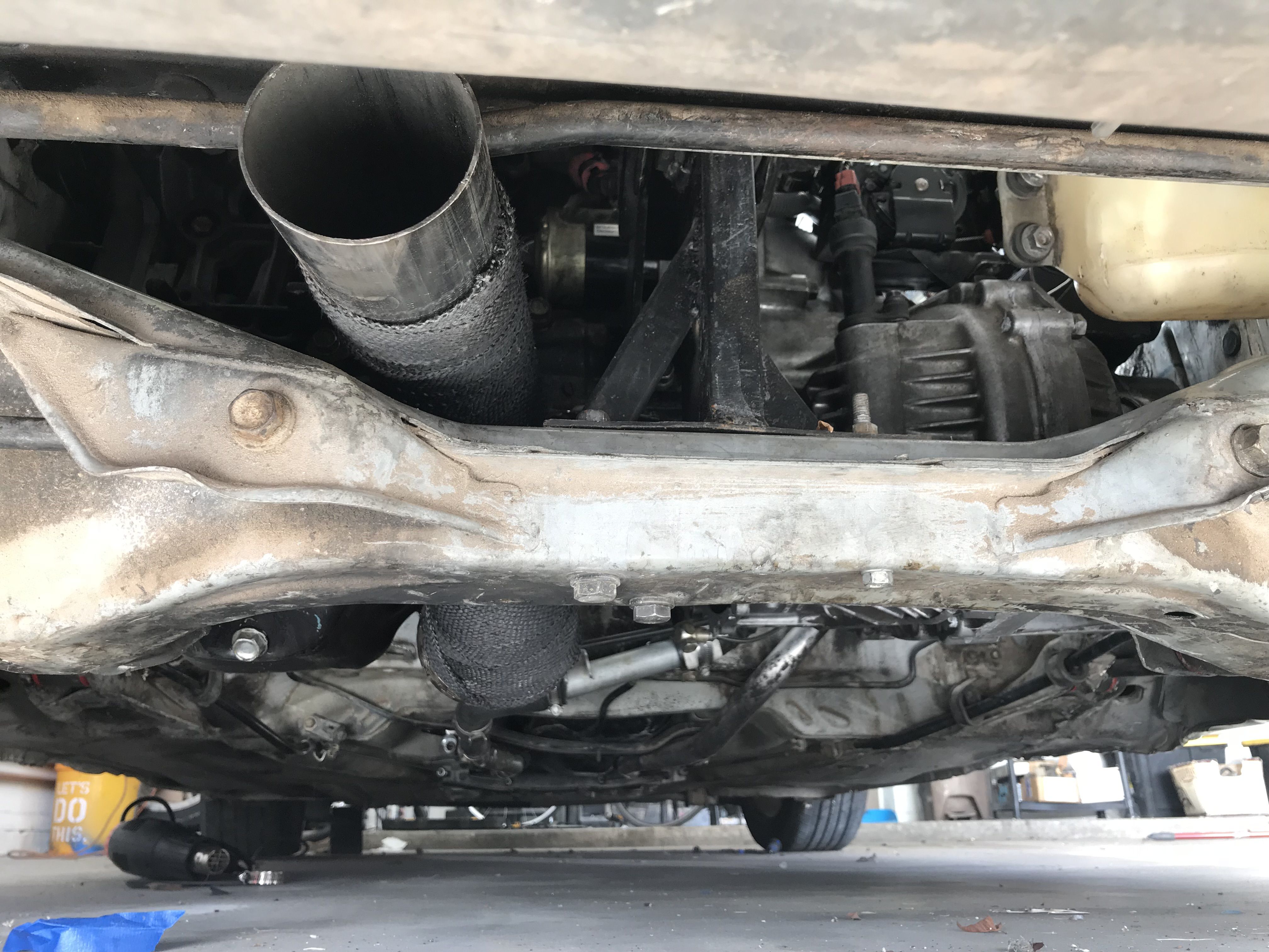

exhaust + one of my ugly mounts as long as they don't break i'm good. Function first then I will slowly clean everything up.

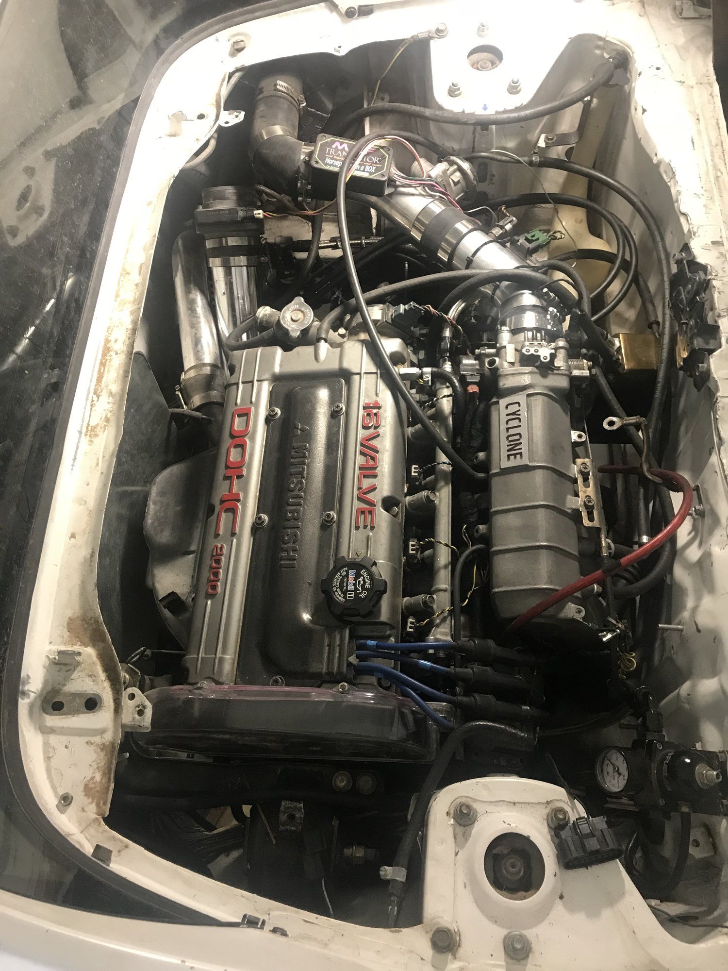

another engine bay photo not much has changed but that is soon to change. Looks kind of crooked but i promise its not I Measured a hundred.

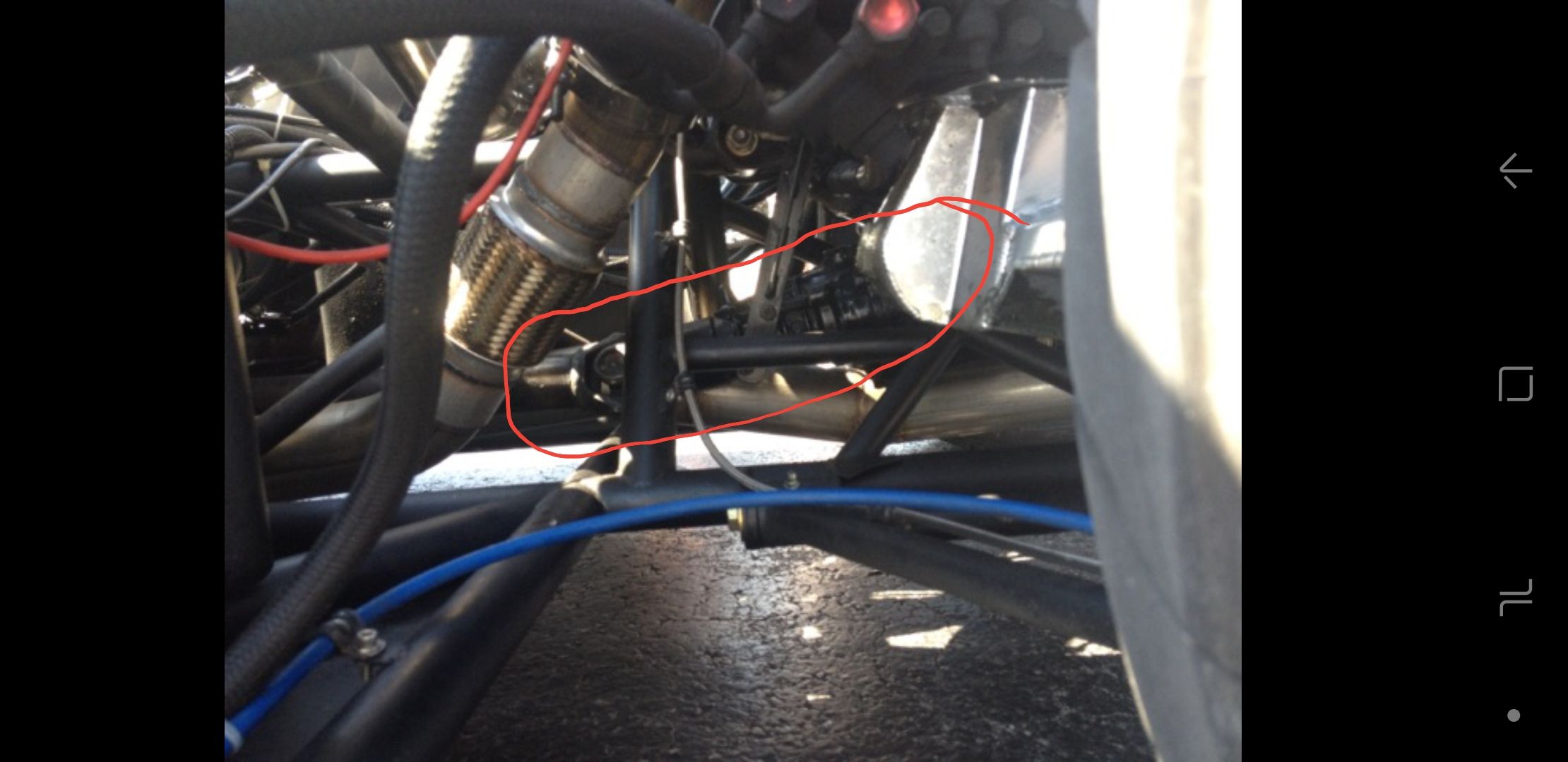

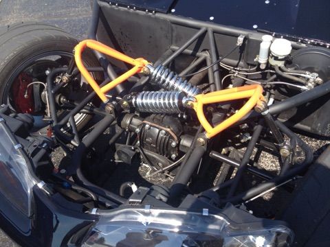

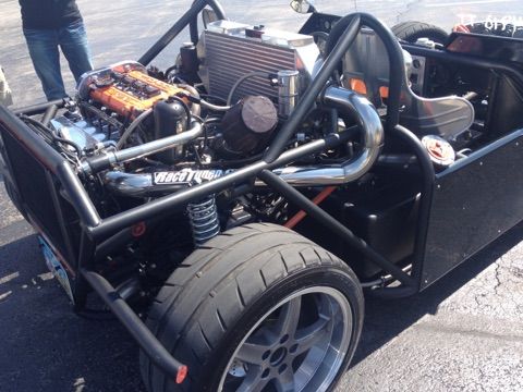

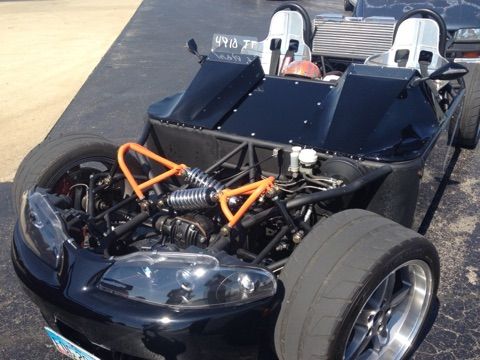

What kind of alignment or clearance issues do you see for rotating the tcase forward for a mid / awd layout like this?
You'd need a custom adapter plate and probably some extra bracing for the case to have it output to the front, as well as address any rotational issues with desired diffs.
Honestly I don't think it'll clear the oil pan area without some serious mods.
I have looked at this arrangement with this idea in mind and with this specific chassis. I think the oil pan needs to be clearanced some but not as much as I initially thought it might. Obviously it has been done successfully. It would definitely need bracing with any kind of power but the elegance of this arrangement is unlike a standard dsm loading the rear tires harder with load transfer and with it the tcase and driveshaft, any load transfer rearward would actually unload the tcase going now to the front axle.
I can't attest to how light the front of a fast mr2 gets in a hurry as well. I never got to the point of actually mocking it up in the chassis and obviously not nearly so far as this project. Which is why I am asking here, does it seem feasible to run a driveshaft forward through the fuel tank area as you have the engine mounted now?
S
With Trying to go AWD in an mr2 it is going to require a custom casing for the gear box as well as some good reverse engineering since the rear diff and transfercase are completely opposite side on a dsm. You will also have to run a fuel cell or something since a driveshaft is not going to fit under the tank and it would be highly dangerous if the driveshaft were to break.
It's possible but will require alot more cutting and fabrication than I have done here
