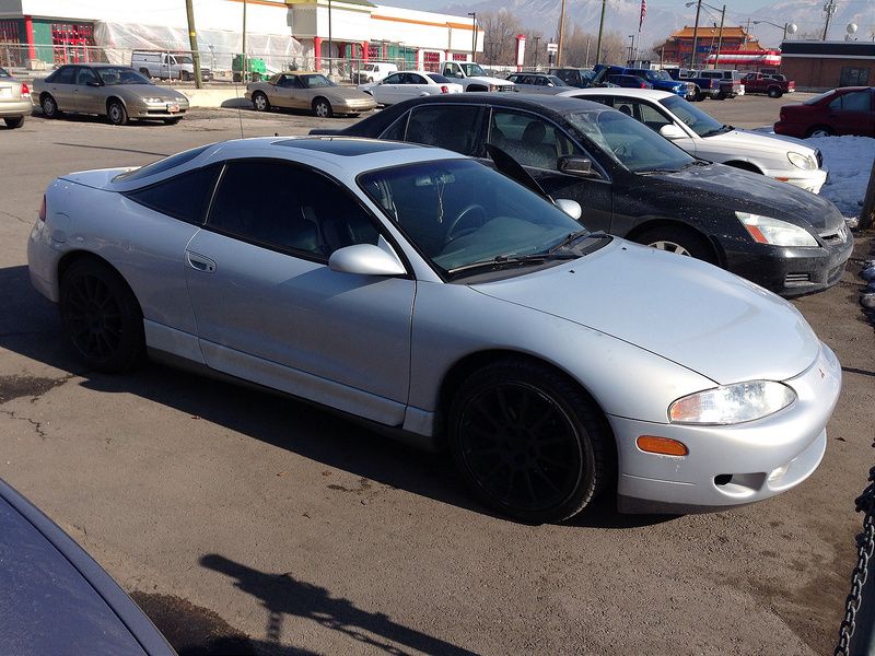

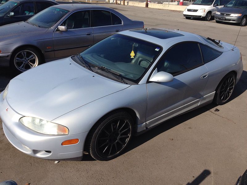

My name is Josh and I come from the Utah area in the US. Just recently picked up a 1995 model GSX in silver w/ LSD.
After reading the forums for awhile, I thought I would post up my new find. Last year I picked up a 1998 GSX with 28k original miles that was just too clean to tune.
So I let that one go last fall and early this year found an early 1995 GSX with 105 K that wasn't running too well.

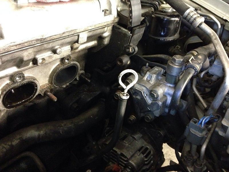

So I decided to do the leak down today and go from there. Checked every cylinder at TDC, twice to make sure...
Only finding air escaping up top near the spark plugs on the 2-3 cylinders.
Just started disassembling to inspect the valves, head and gaskets since I want to drive it. Considering just pulling the engine for ease tomorrow unless anyone points out otherwise. Josh

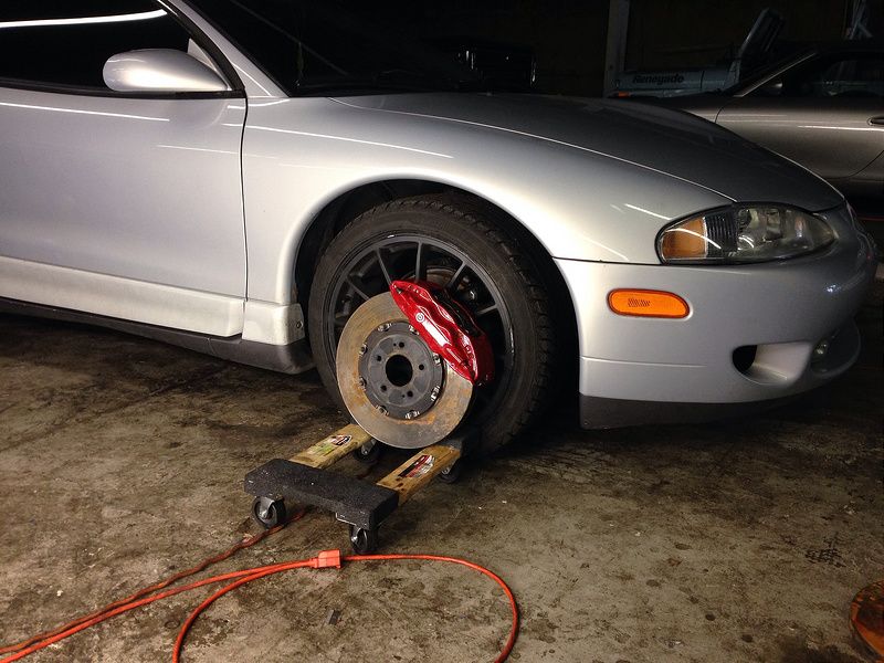

Just getting ready to pull the engine and came across a set of brakes for a deal and a 1/3. So going to upgrade to brakes to a set of front/rear Brembo brakes while at work.
More tomorrow....

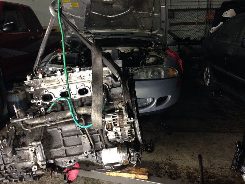

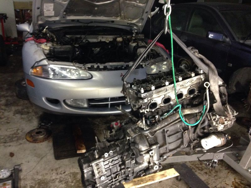

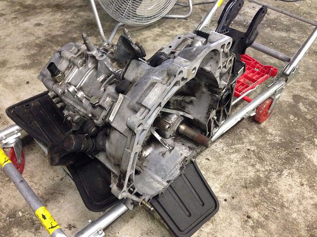

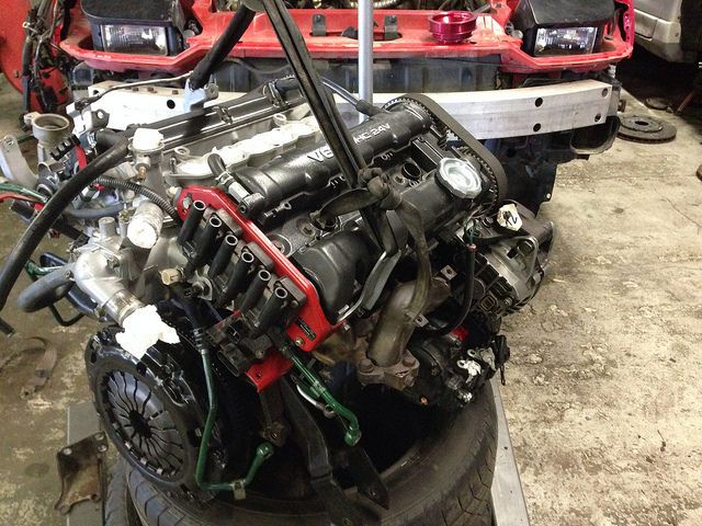

Just decided to pull the engine and transmission together. Just read the various ways to do it and separating the transfer case while removing the transmission seemed to make most sense, for me.
Now just need to decide how much of the engine to refresh. I definitely want the engine to seal up well as I don't want to do this again in a few months.
Brake brackets should be here by the weekend and I will convert the brake set to Brembo Evo X's.

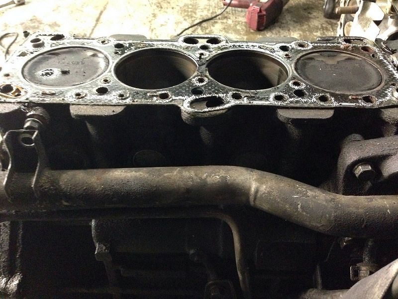

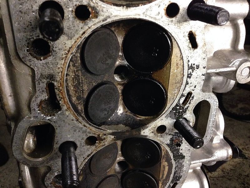

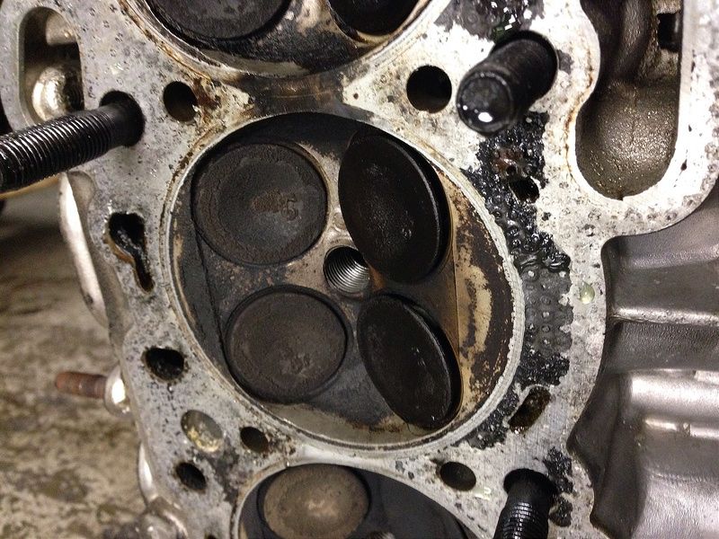

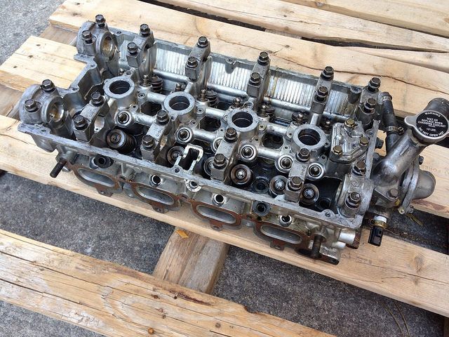

So just before I left work yesterday I separated the block from head to see what is up.
It looks like there are most definitely valves hanging open upon initial inspection. Also the head gasket has given at the 2-3 cylinders as previously thought.
Going to clean some things this weekend, but I am hoping for some opinions before reassembly.

Today the pistons and rods were pulled... Along with the camshafts to gain valve access.
The pistons are not vertically scored, and you cannot hang a fingernail on the cylinder walls.
Now decisions for the rebuild....... Josh

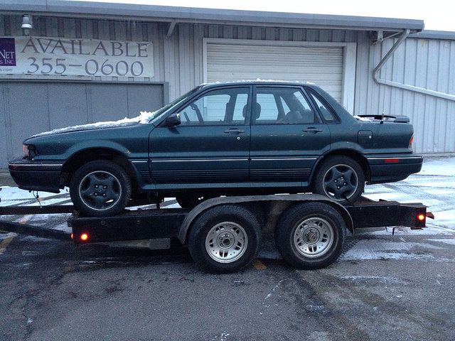

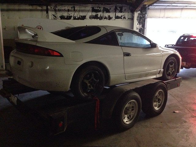

Soooooo... Just couldn't pass up a GST locally that needed quite a bit of love.
1997 2gb GST auto. This one will probably be a longer project.
But should be fun to get on the road again. Josh

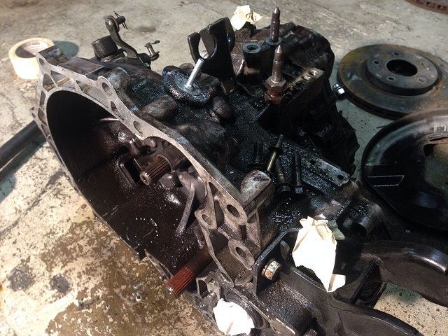

I really need to invest in a load leveler.
Don't know about you guys.... But my bell housing/transmission is dirty.
Time to get the transmission cleaned up and ready for upcoming work.
Just wrapped up the sensors, splines, seals and hit it with some orange degreaser and soapy water.

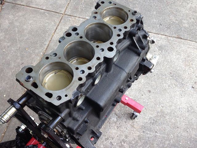

So here is the block I will be using.
*2.3 Stroker block set up
*OEM 4g64 crank
*I beam rods
*Wiseco HD pistons
*Kiggly girdle
*ceramic coating
The head will just be a stock 2g while I work on a race head.
The holes have been opened 1mm for the 6 bolt swap.
Just going to get it hot tanked, pressure tested and the head checked for flatness.

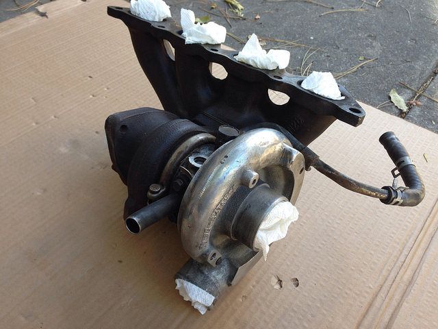

Going with an MHI 20g for the first while while I gather add on's for the HX35 and consider transmission options.
Plus DSMlink, HKS Bov, FMIC, FIC 750cc injectors, Walbro 255 fuel pump. Full Apexi downpipe to 3" exhaust, Injen intake.
Still need an external wastegate set up and a fuel pressure regulator among the other small thing.
Hopefully this is a good way to start because it has been pushing this project back getting the right parts. Josh

•DNP tubular manifold with the external waste gate (looks like it may need to be braced further).
•ECMlink V3 with cables, ECU.
•MBC
•FMIC
Plus a few 2g heads, various parts, intercooler piping.
Still, the list is quite long of parts needed.
