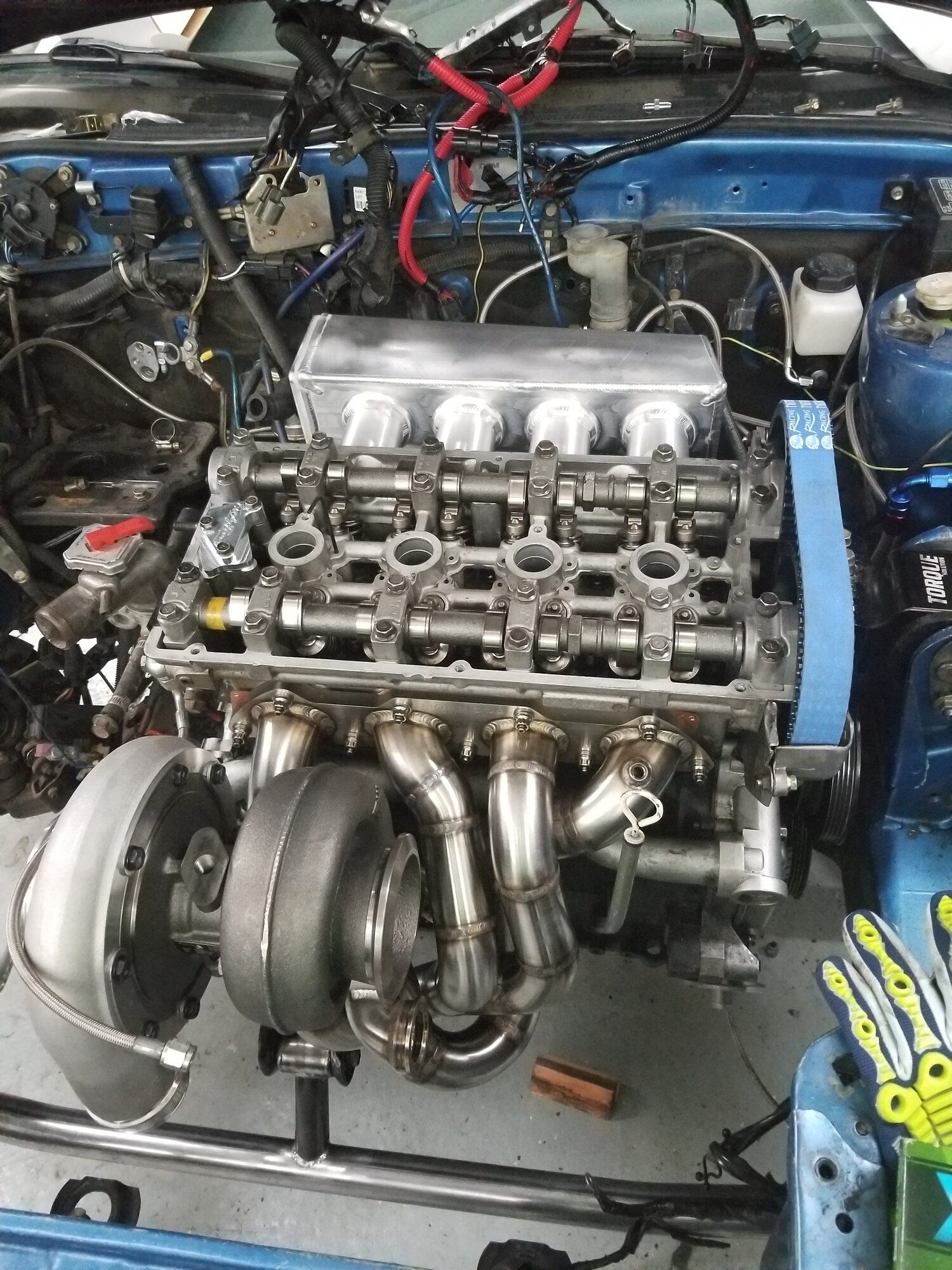

Decided to take out the motor and throw all my parts at it right from the get go.

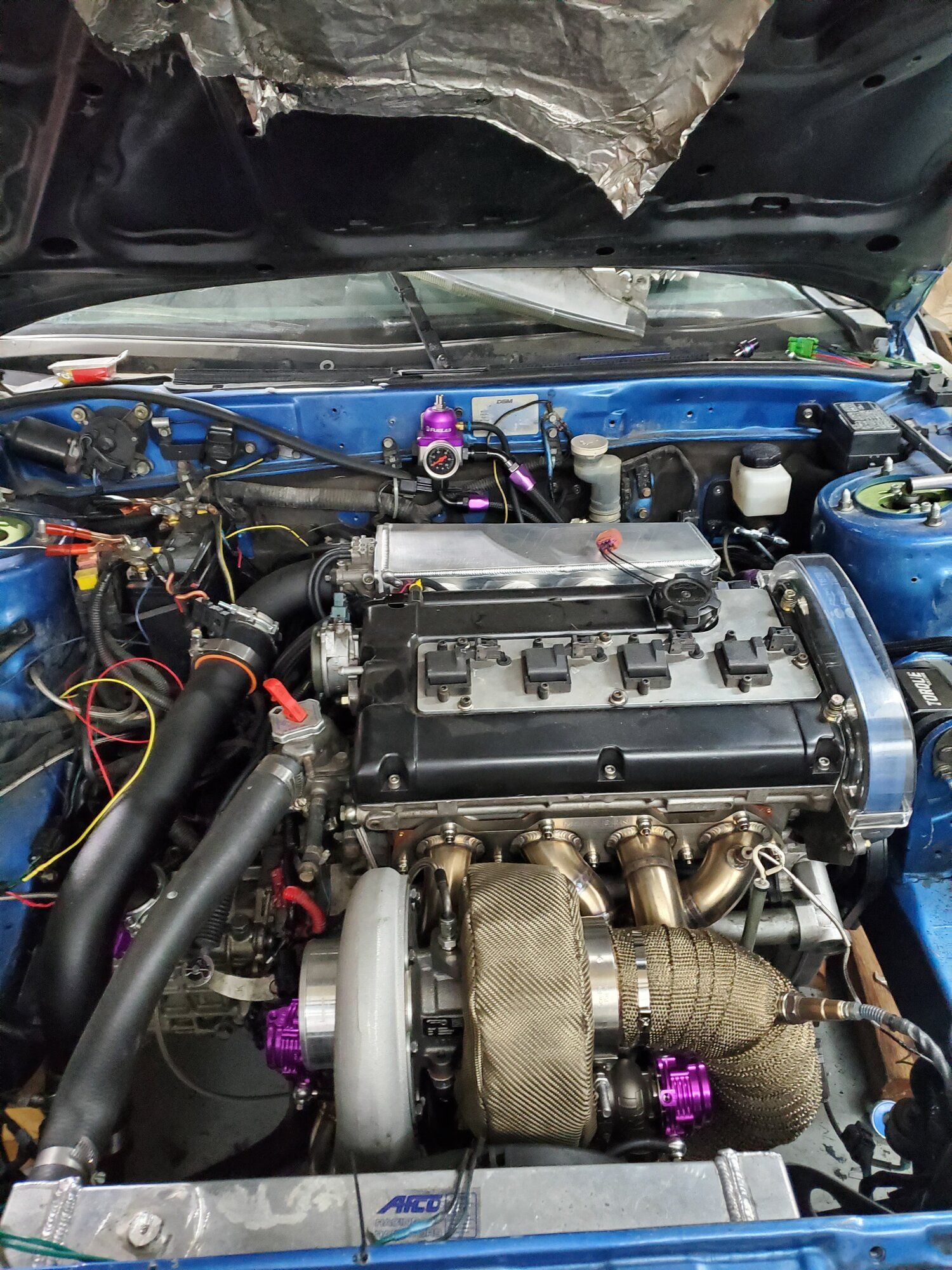

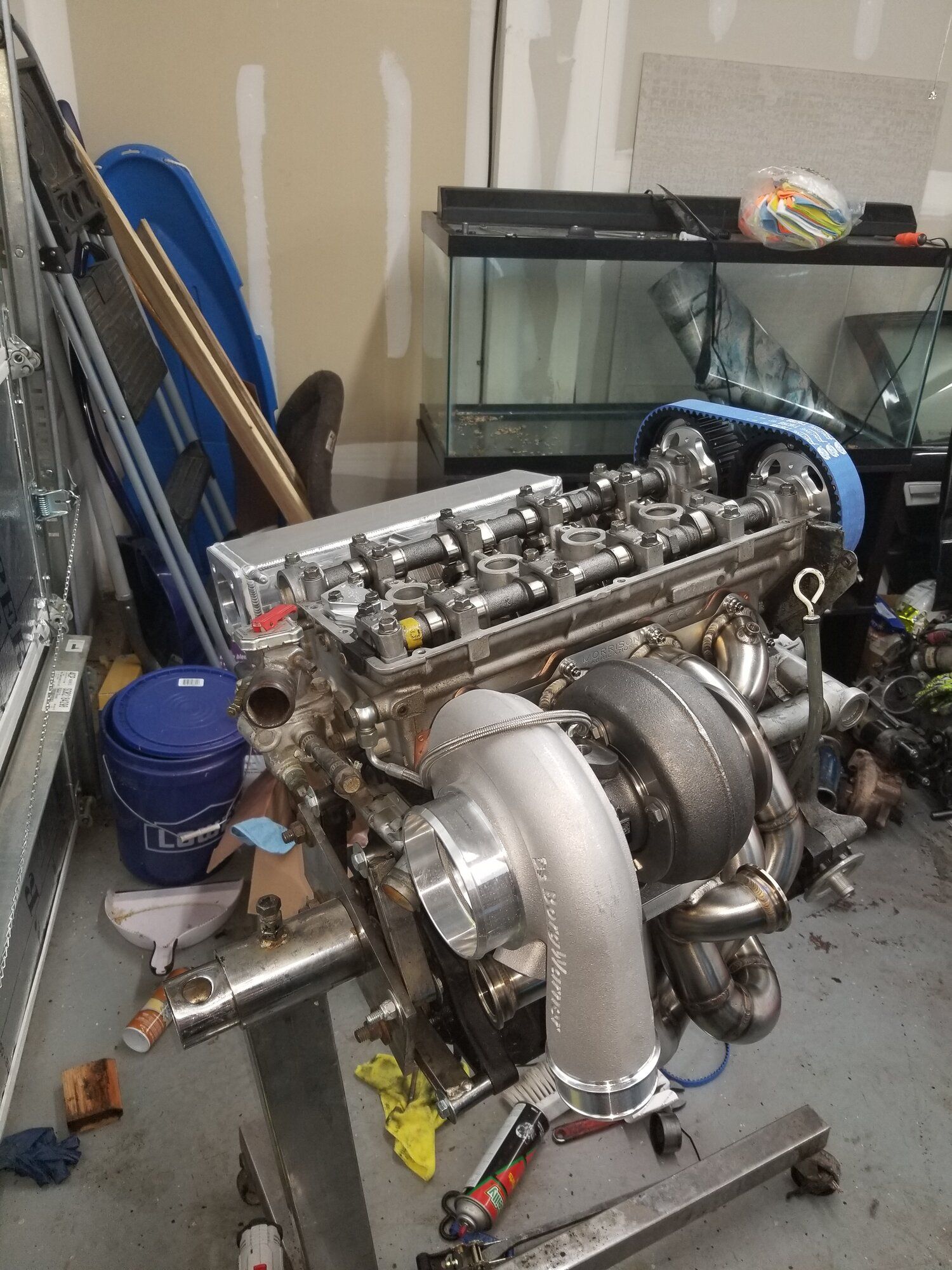

Unfortunately I don't have many pics from throwing all my parts at it but it got the old buschur block and head
Jm fabrication race smim.
Ets 3.5" race intercooler and piping.
Morrison consolidated top mount t4 with the s369
Fic 2150 injectors, magnafuel pump, 10 an feed and 8 an return with a jm fab 10 gal fuel cell. 40 micron filter infront of the pump and 10 micron before the injectors.
Feal coil overs and Ingalls upper control arms
Dss 3.5" driveshaft
Kept the clutch that was in it but added a fidanza aluminum flywheel.

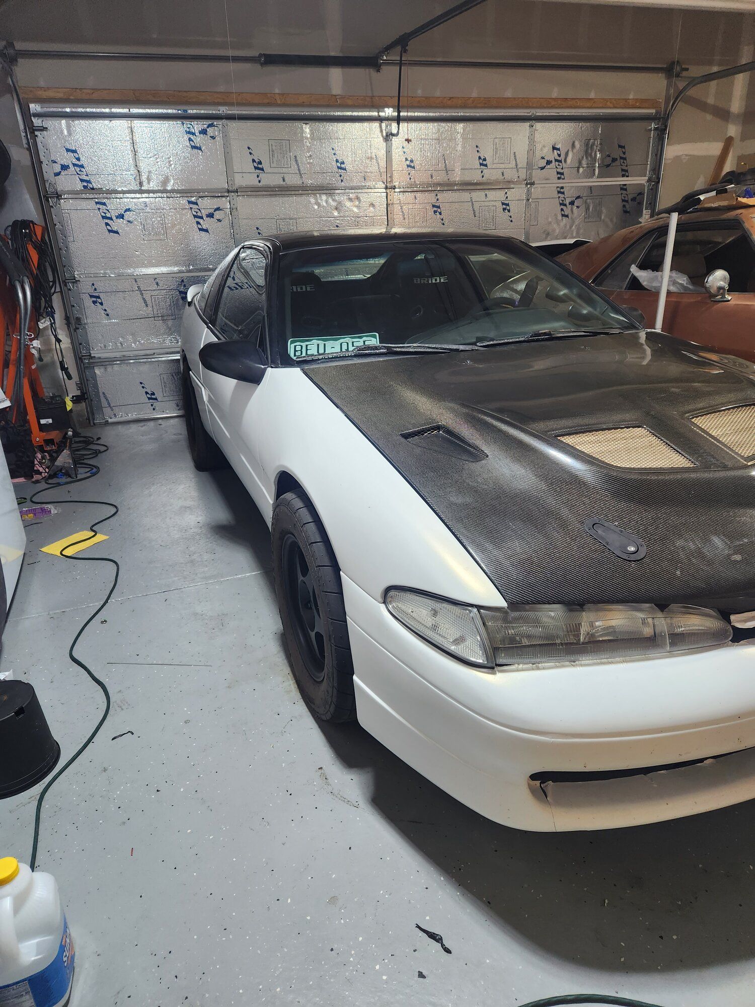

Not a big fan of the weight the auto added so I put on some carbonetics doors, tce front drag brakes and bride rep bucket seats. Also did a wrap with 3m satin frozen vanilla white to hide the carbon fiber doors and just because I've always loved the panda 1gs
