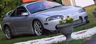

I bought my 1995 tsi lowered, the inside of my rear tire wore down abnormally. I installed the adjustable upper control arms and when it was aligned they Big O told me it couldn't be adjusted in to the proper range because my car was lowered and I have 17in wheels :confused: So the the tires are still wearing on the inside......has anyone else seen this problem w/ a lowered TSI? Is there another part I need to get so it can be set into the proper range? Any help will be greatly appreciated.
