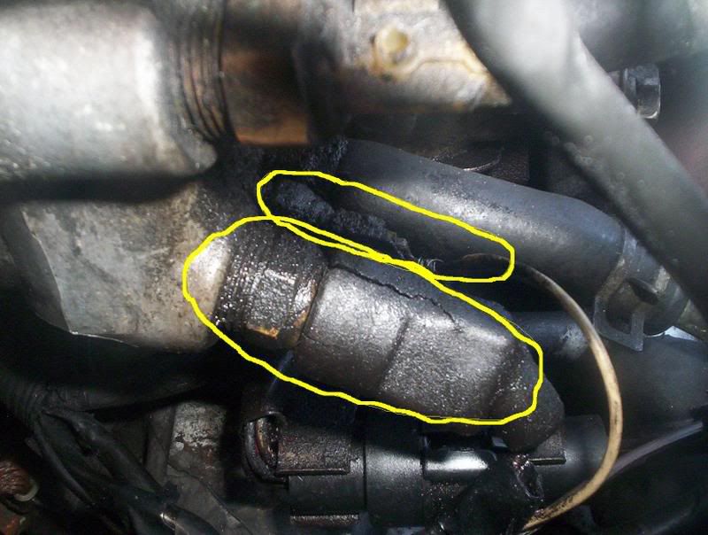

The ecu looks brand new, everything is good i cleaned and reinstalled the tb, but I found these two sensors on the thermostat housing that I missed before, could they be causing the idle surge? What are they? Heres a pic of them:

Those sensors are coolant temp sensors for the ecu and the dash etc. I doubt they can cause idle surge but you should clean them regardless :)
