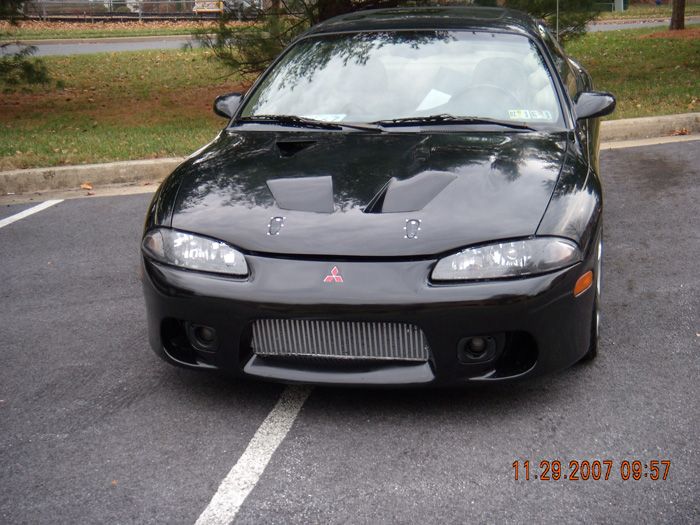

This thing is starting to piss me off. After dropping about $4k into the Spyder this year, I'm ready to drive her off a cliff. The car is only driven in the summer and it just so happens it was up on jack stands most of the time waiting for parts. I think I've put about 200 miles on her this year and it's almost time to put her back in storage.
First it was the clutch that went right before the timing belt job. Then it was having to pull the tranny a 2nd time because the 6-puck chatter was more than I wanted to deal with. Next was the new WBO2 that kept reading lean because the flex section in the DP was leaking.
Then we move to the busted exhaust manifold stud that lead to a busted turbine bolt in the turbine housing. Let's not forget about waiting 7 weeks to get parts from Extreme and finally having to threaten to file a fraud report. Then there's the crushed oil cooler from all the problems I had with my mechanic screwing up the timing belt job.
Oh, and now my WBO2 is on the fritz again and pulling the same crap it did before I installed the new DP about 30 miles ago.
Anyone want to buy a Spyder. :rolleyes:
